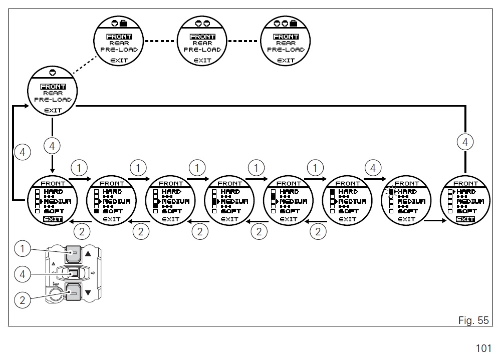

  1. Hmm... I cant find how to adjust the individual parameters .i.e if say I wanted a fast rebound and a slow compression. All I can find is
    To me this is just picking a factory default and not each individual setting for rebound or compression DDS3.jpg

    sorry what I meany was the setting changes available seem to make little difference and are not a great help, a forum member has got an upgraded new rear spring made,but the original should be good! I fail to see why a lot more money should be spent to replace a part that is not performing adequately.

  4. in your diagram above, 'front preload' etc. Have you done it on the bike? The manual isn't very well described imo I had to have a play first to understand. You can adjust it all@ preload, comp, reb as a setting ie softest to hardest

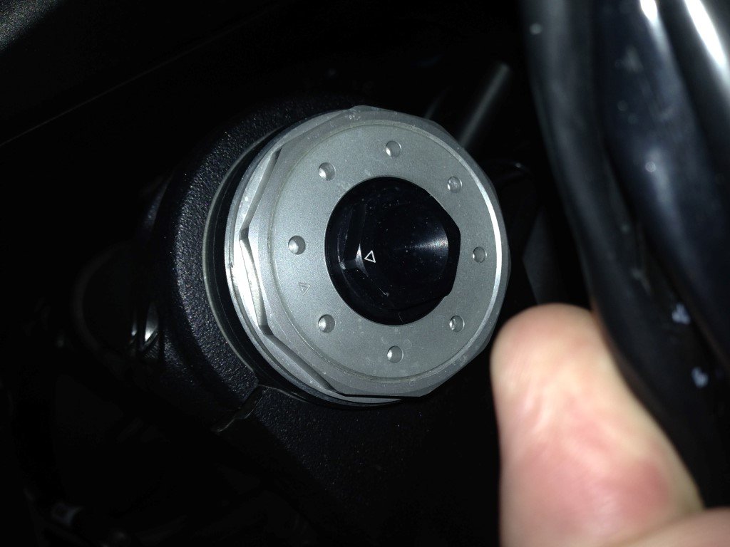

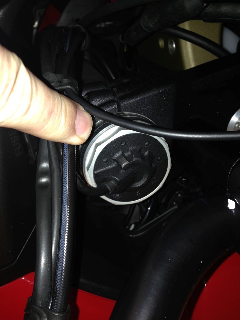

  13. Not much different only the blue nut is black and the electronic one is on the left and the preload is on the right. I had noticed the arrows but it hadn't occurred to me that it was for the preload.

  15. I set the preload on my (Ohlins) forks to maximum preload, using the blue hexagonal adjusters. It is OK, and better than before, but still not quite hard enough even solo let alone pillion. Then again, I am a big chap.
  16. You need the strength of Sampson to turn the blighter.the front I can live with,it is the rear I find disappointing and ultimately I think performs poorly.
  17. Steve I have just checked my front pre-load and when I turned the nut anti-clockwise with the intention of reducing the pre-load it hit the end stop in about half a turn. So I have turned it clockwise a few turns and though not certain feel that it may have reduced it - no chance to try on the road yet.
