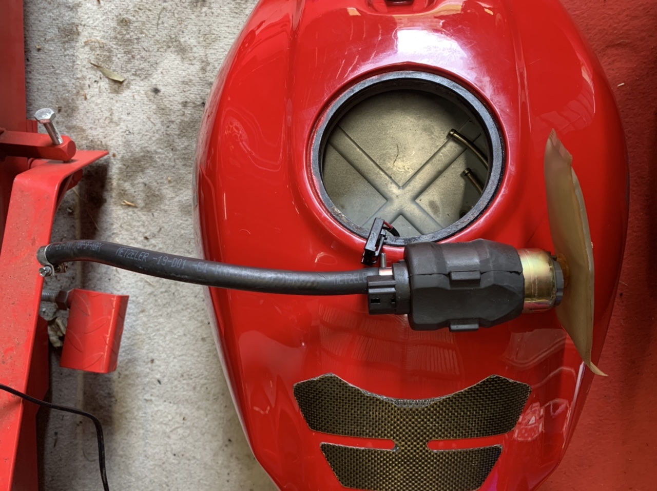

  5. Hi, I’ll take a look inside the tank but to the best of my knowledge the hose clips are still attached to the pipes either side of the new fuel filter. I know that if one comes off, you would see petrol spraying under pressure from the pump ( inside the tank)
  6. I don't think I hose has come off completely as you wouldn't have any fuel at the injectors at all. My guess is either a hose is not sealed properly or perished. So the pump builds some pressure but it leaks away back into the tank almost immediately. You have enough fuel pressure to make it want to fire but not to make it run. The original Ducati fuel hose doesn't last too long when immersed in fuel containing ethanol. They perish from the outside in and eventually you get a leak. They last forever when not immersed. My external hoses are 25 years old and still as good as new, no signs of age. If and when you replace the internal hoses make sure you use submersible hose, the specification is SAE30R10. Standard high pressure fuel hose is R9 spec and not suitable or immersion in fuel. Even the correct spec is relatively short lived. MV Agusta have them on a 3 year service schedule.
  7. If you need to replace the hoses on the fuel pump, ensure you obtain and use pipe that is petrol proof.
    I had a problem on a MG Griso, where the previous owner had fitted griflex, and the petrol had softened it to the point it came off the connector.
  8. Hi, just removed my fuel pump from the petrol tank and all of the hoses were attached correctly and no signs of degradation, result :upyeah: C0E96D5E-025F-476A-A827-685BE8EF22F0.jpeg
    Hi, I have got some SAE J30R6 rated fuel hose and this is suitable for leaded, unleaded, ethanol and diesel fuel, however inspection so far has shown no degradation of my current hoses inside or outside of the fuel tank :upyeah:
  9. Good news that it isn't the hoses, well good and bad as it has to be something. SAE J30 R6 is not suitable for use submerged in fuel by the way. It's the outside of this type of hose that degrades when permanently in contact with fuel.

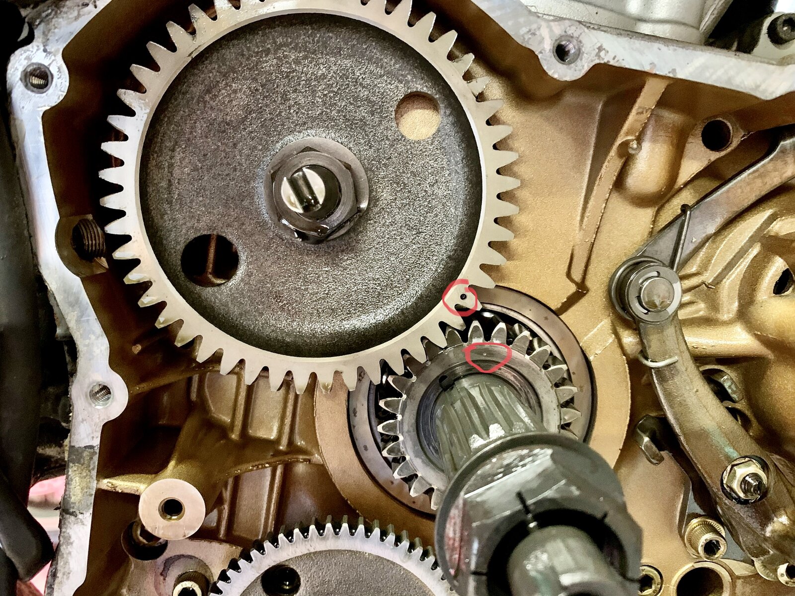

  11. Quick update regarding this ongoing non starting saga. Replacement CPS sensor arrived this week and I had to remove the alternator/water pump cover to gain access to the sensor from the inside, so that I could hammer it out because it had been glued in FFS !!! Replacement alternator/water pump cover on its way too as the CPS sensor holding bolt had sheared off inside the original cover FFS !!! again. The good news is that I could remove the flywheel and check the timing marks (photo attached).
    Once the replacement alternator cover arrives I will be able to put the CPS sensor in, fit the cover and check the sensor clearance :upyeah:
    Will keep you posted as to my progress next week :upyeah::) 5FB56C29-DA7B-4C9C-A9B9-96D133FE5A62.jpeg

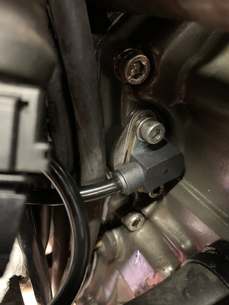

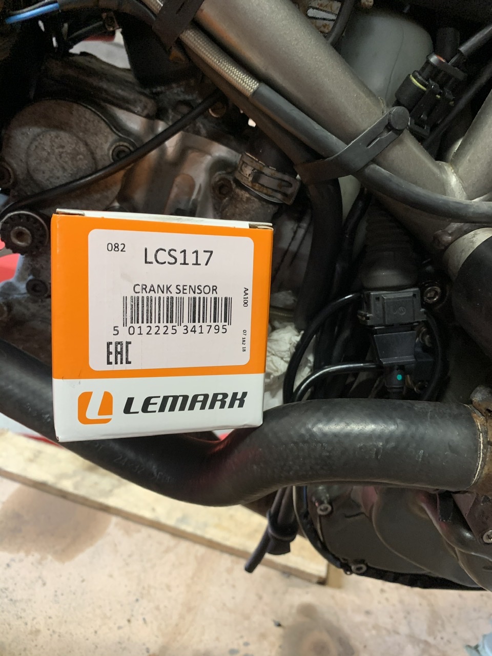

  18. New update regarding the non starting Monster S4.
    Since my last post I have sourced a replacement alternator/water pump cover and secondhand CPS sensor + shims ( thank you Peter). The replacement cover was from an earlier Ducati and had the right angled and 2 bolt fitting sensor and not the original single bolt fixing as on my bike.
    Sensor was fitted and shimmed to provide a 0.6mm air gap, brand new Champion (Ducati sourced) spark plugs fitted, usually £22 each but sourced from Laguna Motorcycles for a shade under £17 for a pair.
    Bike was then switched on but had exactly the same problem, misfiring and backfiring FFS !!!!!
    I then replaced the secondhand CPS sensor for a brand new EBay sourced Fiat item (£18) :upyeah::):) and removed a 0.2mm shim to close up the air gap.
    Yay, happy days, bike started and runs, not well, but it runs, video link below.
    So, what are my thoughts ? I believe that the original problem was CPS related and I therefore had no need to replace the fuel pump and throttle bodies. This had the potential of being a cheap fix but ended up costing more than I expected but I was not going to be beaten.
    In conclusion, It’s been an interesting and disheartening few months but I would like to thank everyone for their thoughts and comments and I now have the bike booked in for Throttle Position Sensor adjustment and injector fine tuning.
    HAPPY DAYS NOW ALL BEING WELL
    Photo of Fiat CPS sensor and location 8F46DBF7-EED6-4B71-87E2-90619E951B15.jpeg 853BD0FF-5CE3-47B1-BF42-17CB7C7B700D.jpeg
