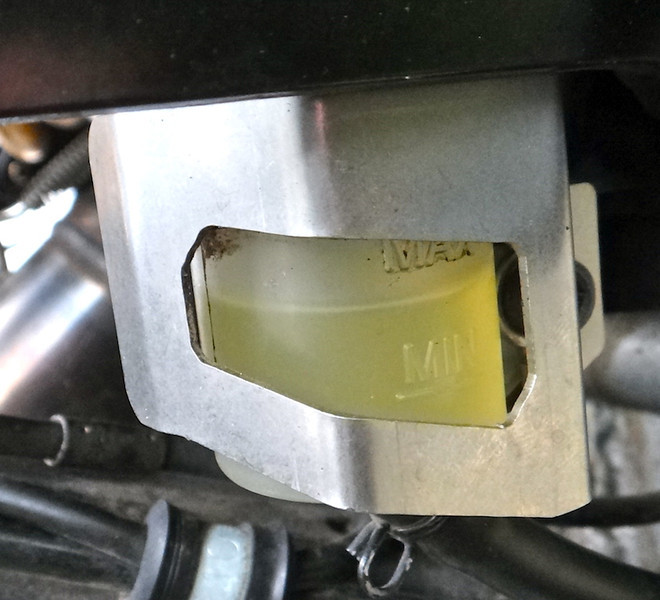

  4. Running standard exhaust set up, have heat shield fitted and rear brake bled again and just had first MOT. Brake not brilliant. Will report in a week to see if it's gone AWOL again!! 4th time now. :Bawling:

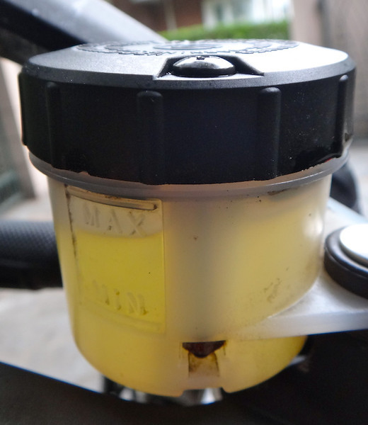

  7. I've just fitted the ABS bleed nipple, the stuff that came out when I bled from the pedal to the ABS unit was a horrible milky brown colour mixed with air.
    To say that the new version of my rear brake is an improvement is the understatement of the week.
    £5.00 and 10 minutes with a bit of new brake fluid = :) and a brake that does what it says on the tin!

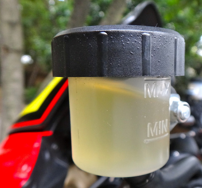

  11. Just remember to change that RBF more frequently, once a year min.
    Sucks up moisture like a sponge.
  12. Due to high humidity in our region changing oil & filter and clutch / brake fluid every 6000km, no dramas here ~ preventive maintenance.
