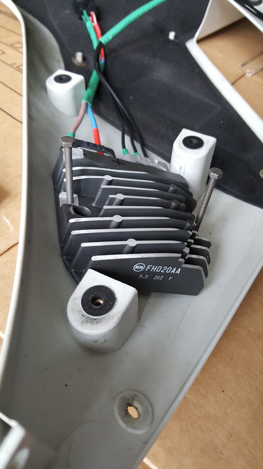

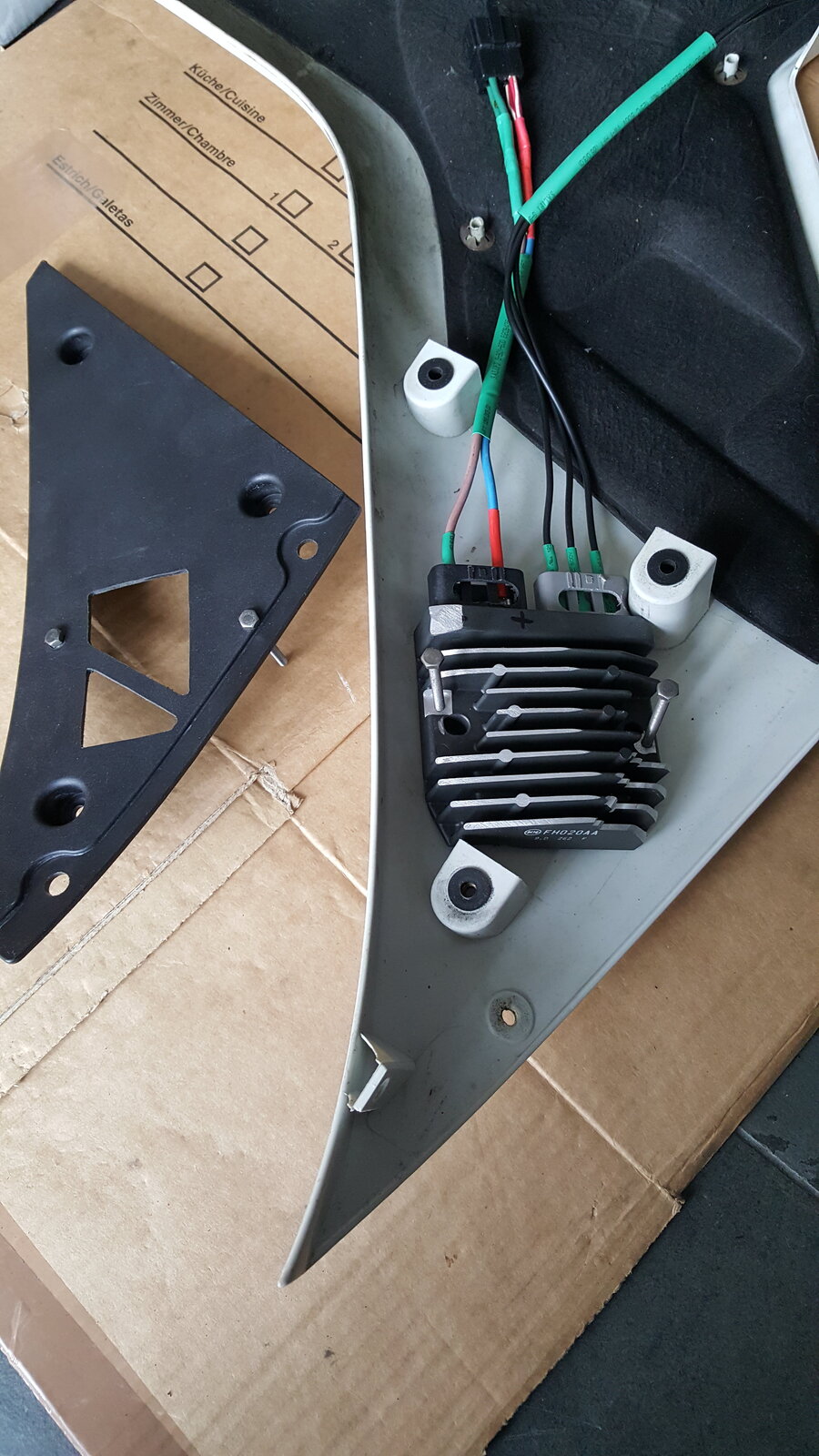

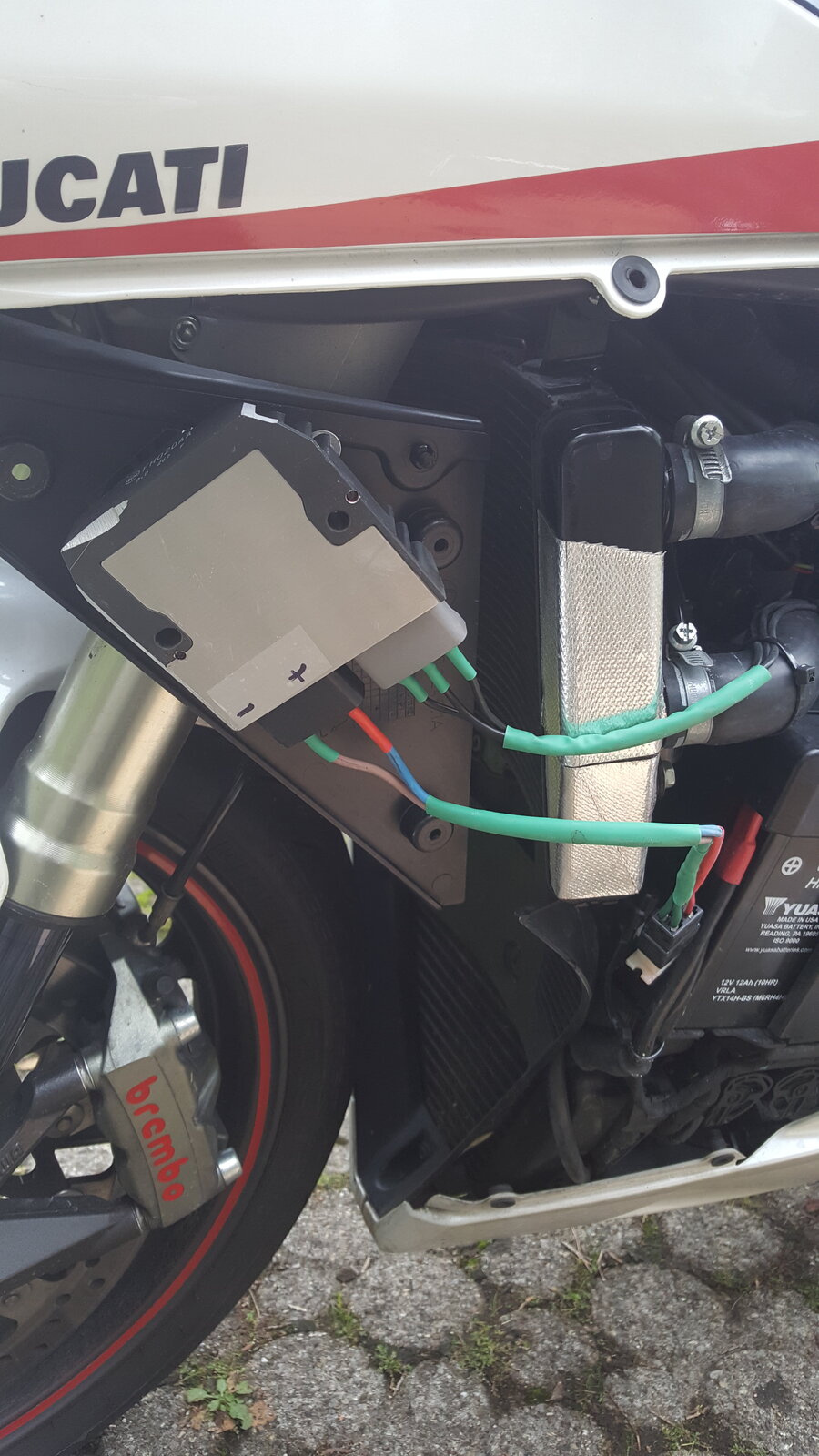

  12. Inspired by the great original post of Robanaro, I wanted to find an even colder location for the regrec, and that's what I found. I thought sharing some pictures in case they might inspire others.
    I used an angle grinder, a threading tap, a milling machine (even though not strictly necessary) and some other standard workshop tools.

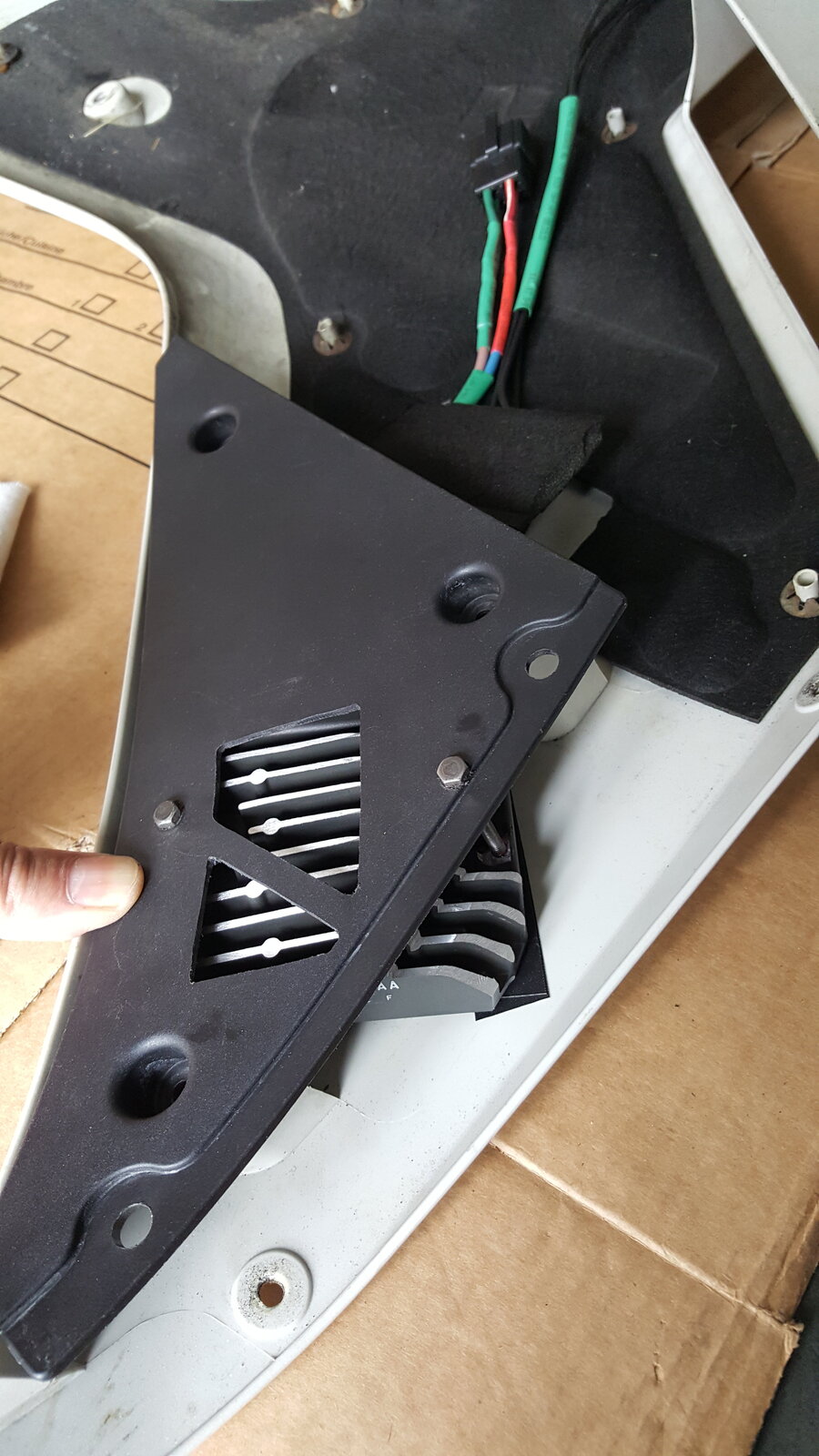

  13. That’s nice but does it mean you have to remove the reg/rec when you take off the fairing?

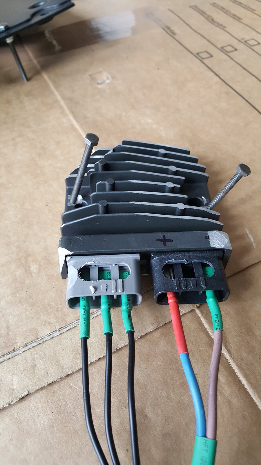

    Also, why did you cut holes in the connectors?

  14. There is no need to remove the reg/rec when removing the fairing as far as you leave the inner black-plastic triangle attached (as in the first image).
    Just because I initially planned to solder the wires directly on the reg/rec, but finally opted not to. The cleanest solution would be to buy the corresponding adapters, but I just wasn't patient to wait.
