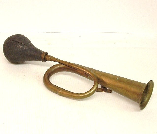

  10. I dare you to fit this next time (beat me to it @Tobytyke)
  11. Those bulb horns are legal on older vehicles. I`m not sure what year a single tone horn became law, I`m thinking maybe some time in the 70`s.

  12. Only in theory. Every mot tester without exception will accept any type of horn on a bike, even the squeaky ones, unless they're on the make or miserable old tosspots.
