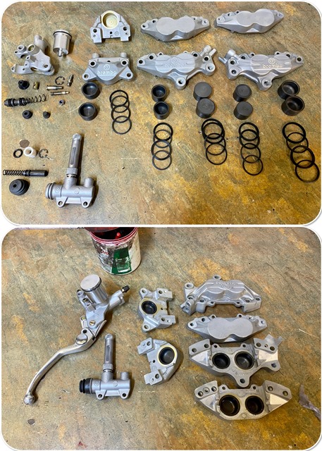

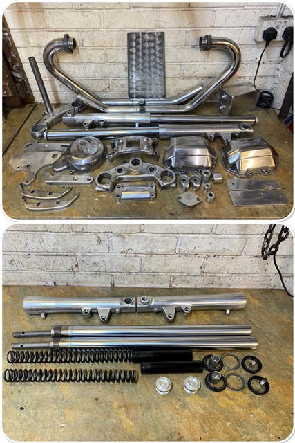

  1. Time to overhall the hydraulics… just waiting for some new bolts to assemble the callipers. everything was in surprisingly good condition, just a strip and rebuild needed. Then onto the job I hate most… Polishing! I have a 2 HP 3000 RPM motor I use for this. Its a long, filthy and somewhat dangerous job. I try to do it all in one day as you get filthy, and its the sort of dirt that won’t wash off with hand soap, so I have to use washing up liquid!
    I have also rebuilt the forks and put in new seals and dust covers, and some fresh oil. they are very simple forks, no where near the sophistication of the Ducati ones I normally do!

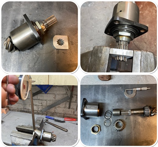

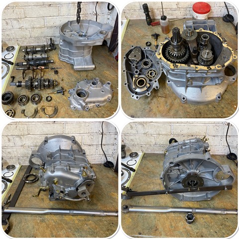

  2. I have read on a few forums that over the miles the preload on the pinion bearings gets loose, and sure enough it spun Just a little too free. So I removed a thin shim and re-torqued it up after inspecting the bearings which were like new. I couldn’t use a torque wrench so I used a balance on a long spanner and calculated the pull needed for the correct torque.
  3. Heath Robinson would be doffing his cap.

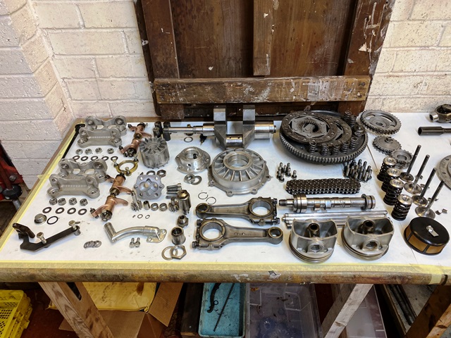

    I am amazed at how little wear there is on the engine and gearbox components. there is no disenable wear on the crank or bores, pretty good for 30k miles! I cleaned out the sludge trap in the crank but it was clean, glad I did it though as the bung was far too lose for comfort! it has a dab of retaining compound on it now. the only wear I have found so far is a roller bearing in the rear drive, and as you can see there is pitting on the inner race. this will be replaced.

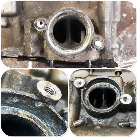

  6. While everything is on hold while I wait for the cases to come back ( blaster has Covid and is really poorly...) I agreed to help a friend of a friend who was struggling with two broken studs in a cylinder head, so I though I would share my knowledge on removing them...
    removing broken studs is always a problem, especially where someone has had a go first! in this case they had drilled off centre and then broken an easy out in the bottom! in 50 years of doing this stuff I have NEVER seen an easy out remove a broken stud in alloy… My technique for broken stud removal is to first clean the head of the stud with a burr in a Dremel to get it nice and clean. Then use a half nut the same size of the stud, but drill the threads out so again its nice and clean.
    Place the nut central on the stud and start off with the TIG on low amps and just puddle the weld on top of the stud.. This permeates the heat down the stud… Build up the weld inside the nut until its flush. I have the electrode sticking out a bit more than normal to get close to the stud top. You can use MIG, but TIG is FAR better... Once its cooled a little, give it a tap with a small hammer for a bit of shock. then try working it back and forth… its its too tight, or squeals as you try to turn… it stop. Then if its possible drill a hole into the alloy from the side and JUST into the stud. over a couple of hours feed some Plus Gas (wonderful stuff!) in the hole and work the nut back and forth… I have had great success removing studs this way in alloy.

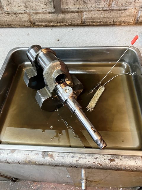

  8. All the parts are back from the blasters, so its cleaning time… nothing scraps an engine like leaving glass media in there so its important to get it all out. I have a process I use for this. First I wash it all off in petrol… paying attention to all nooks and crannies, holes and oilways with a long thin bottle brush. then I jet wash it off, and blow it all off, including all holes. (you need goggles for this!) then its into a stainless steel tray and another wash off with petrol, and then I use carb cleaner with a long spout into all the holes and oil ways… if there is ANY single bit of media in the tray, its back to jet washing and blowing off again. Its easy to see any media in the stainless tray. Here is the gearbox in the stages of being built up.

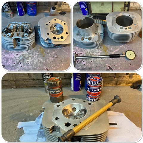

    next the cylinder heads… it took three attempts on these to get the bead out of one oilway! note the new tin of grinding paste, the old one has run out of the fine end, but it was 50 years old, I can remember my Dad buying it me as a teenager! Good to see the company is still going and using the same tin! Just to be sure I checked the bores for wear… there is none at all! Got to love Nikasil bores!

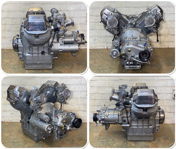

    here is the engine and gearbox all back together… I decided to add some accurate timing marks on the flywheel for each cylinder so I can use a strobe and see what’s happening in reality. used my new digital DTI gauge… not sure I like it… watching that needle go round is far more satisfying!
    and finally its all back together and ready to go into the frame

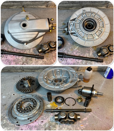

    Here is the finished final drive with a new bearing and seals.

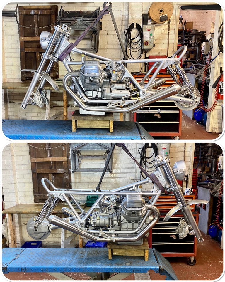

  13. The engine is now back in the frame, a nice and easy job with the removeable bottom frame rails…

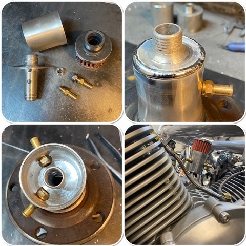

  16. I didn't want to use the frame as a breather as it can rot them out, and rust partials can drop down so I am told... so I decided to make a new breather the vent the crank case and also the heads. Here is is... will it work? Who knows, we will see!!
  17. Two jobs today... first was to make a paddock stand. I hate the universal ones as they are very difficult to get a bike on one on your own..., and often not that secure. this one positively locks onto the wheel spindle, and when its on the lift I can clamp it to the top so its nice and secure.
    The second was to make some bushes out of bronze to take the play put of the clutch lever as the hole had worn oval. I drilled it out and made some over size top hat bushes. Finally, here it is on its wheels!

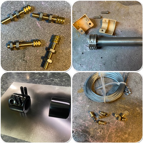

    I pondered for a long time on the throttle arrangement for this bike… I wanted to keep the pull to open, pull to close for a couple of reasons… First, its safer… manufactures didn’t go to this arrangement for no reason as bikes evolved. Second, it means you can have much lighter return springs, which in turn males the throttle much lighter, particularly if you are going for a quick action. . A light fast action action throttle feels like you have 20 BHP more!
    I couldn’t find a 4 cable throttle anywhere, so I ended up making one from scratch…
