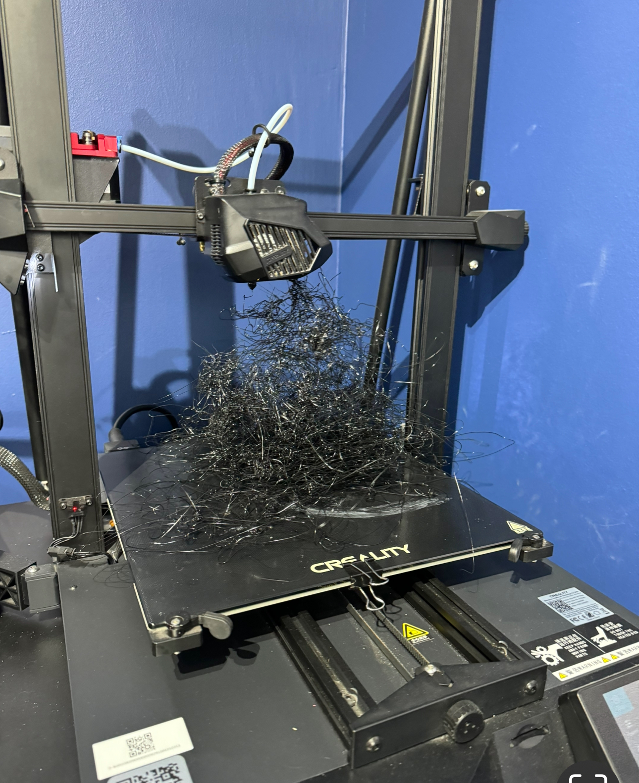

  8. Printing the left side of the rear seat is proving challenging, think I’ve found what the issue was with the part not bonding to the printer bed… falling over and then some filament spaghetti :rolleyes:
    this is what happened when the melted plastic has nothing to be printed onto, as you can imagine you can’t print onto thin air. But we live and learn.
    But seems to be printing ok now and should be done tomorrow :upyeah:

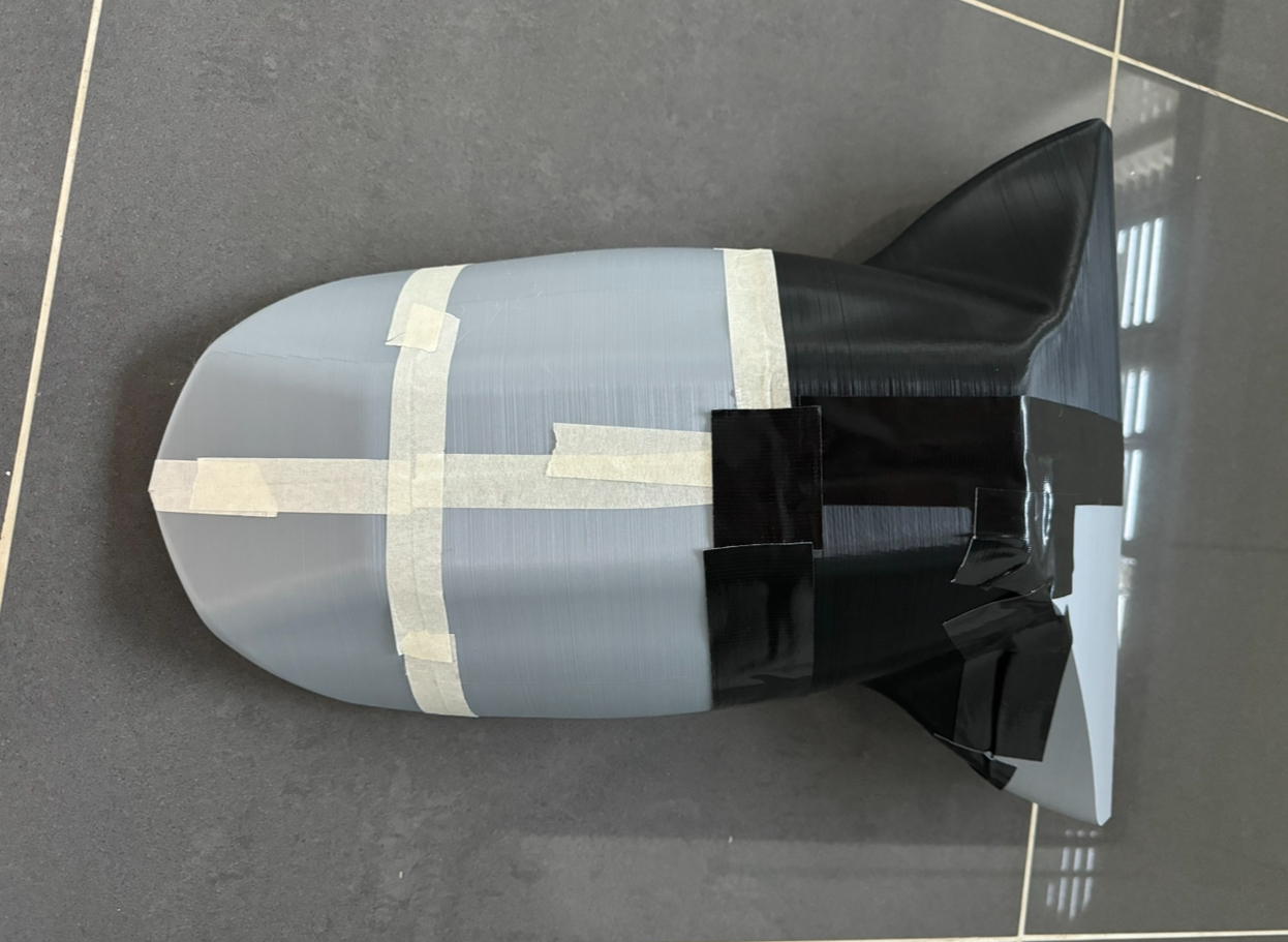

  14. Finally printed all the sections for the rear tail upper panel. Taped them together whilst debating the best way to fibreglass them. And doesn’t look too obnoxious when I try and marry it up to the bike.
    Now the printers are on with printing the 6 lower rear fairing (lunch box)

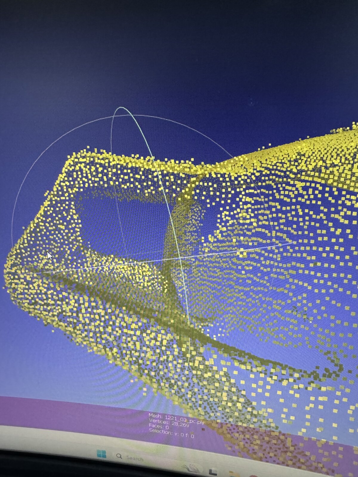

    scanned the right upper fairing wing today so nearly modelled the nose cone so that’ll be next to print.
    Took a picture of the cloud points the scanner picks up just for those that haven’t 3D scanned anything. I still find it amazing seeing the detail.

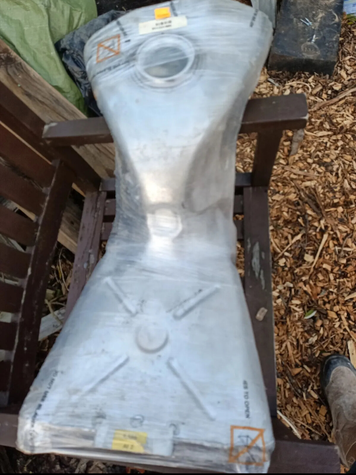

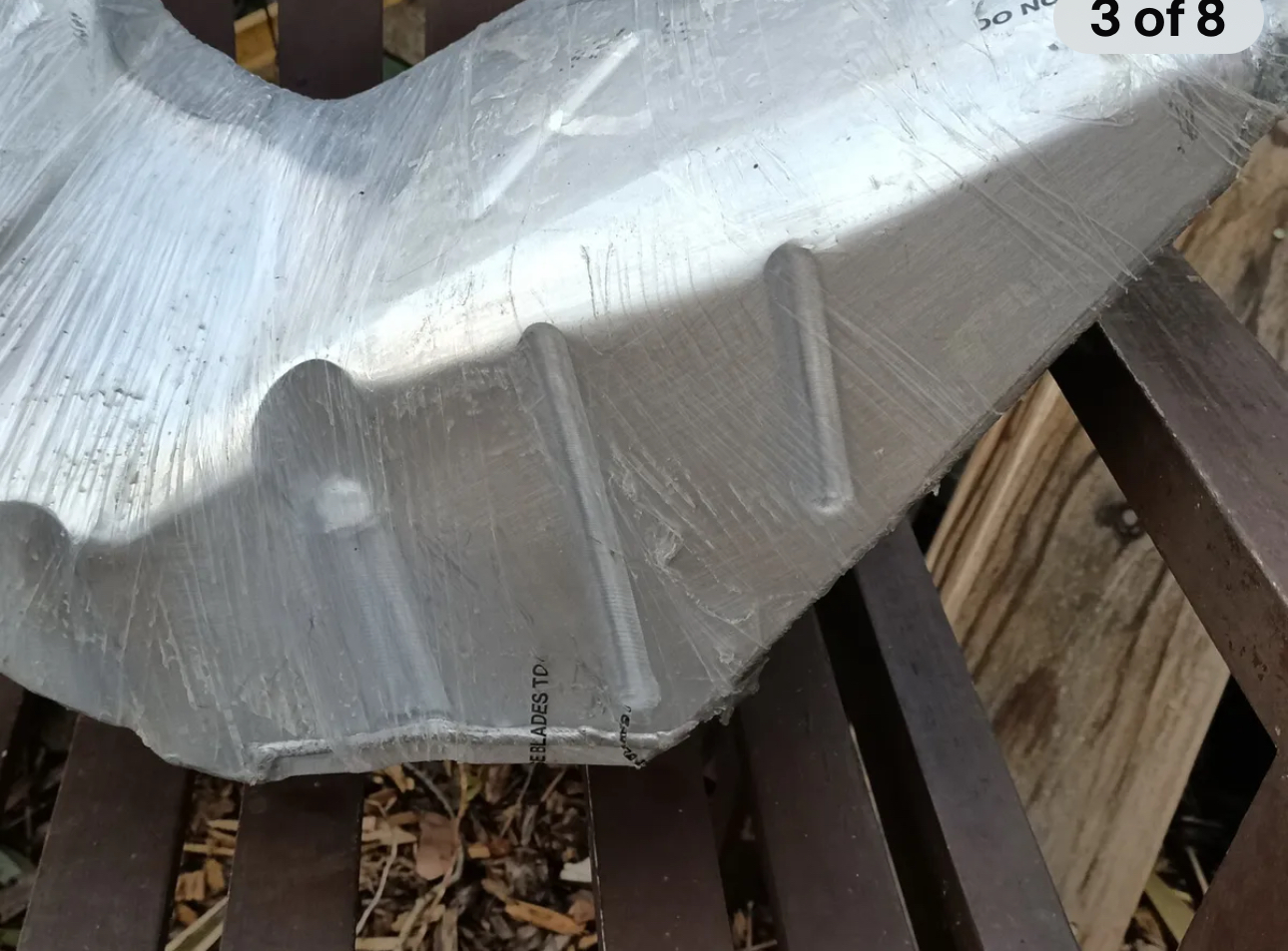

  15. Still part of the project but not specifically 3D printing… I was looking for an ally tank to possibly remodel to use on the build and stumbled across a tank on eBay advertised as a Ducati Streetfighter tank. Anyway I won the tank and got bored so tried to find what bike it came off originally as I don’t think it was a streetfighter ….
    I found out what bike the tank came from…
    Does anyone want to have a guess before I put up the answer? And it really makes me wonder whether I should be contemplating ‘modding’ it o_Oo_O

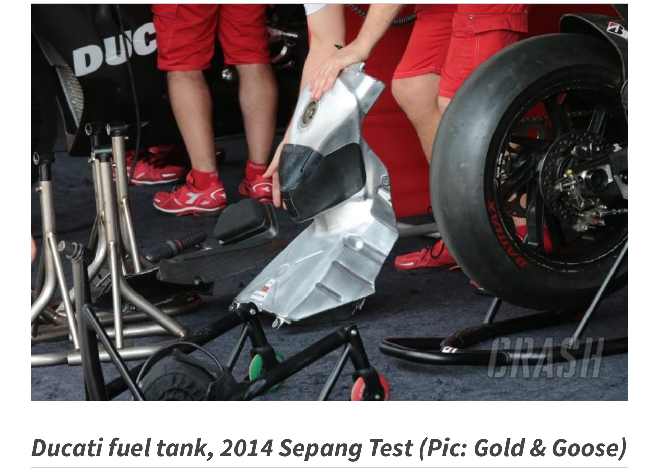

  19. I’ll give you that :upyeah:, definitely the right bike and maybe used on the 16 as well, the only picture I could match it to is this one from the motoGP test in Sepang in 2014.

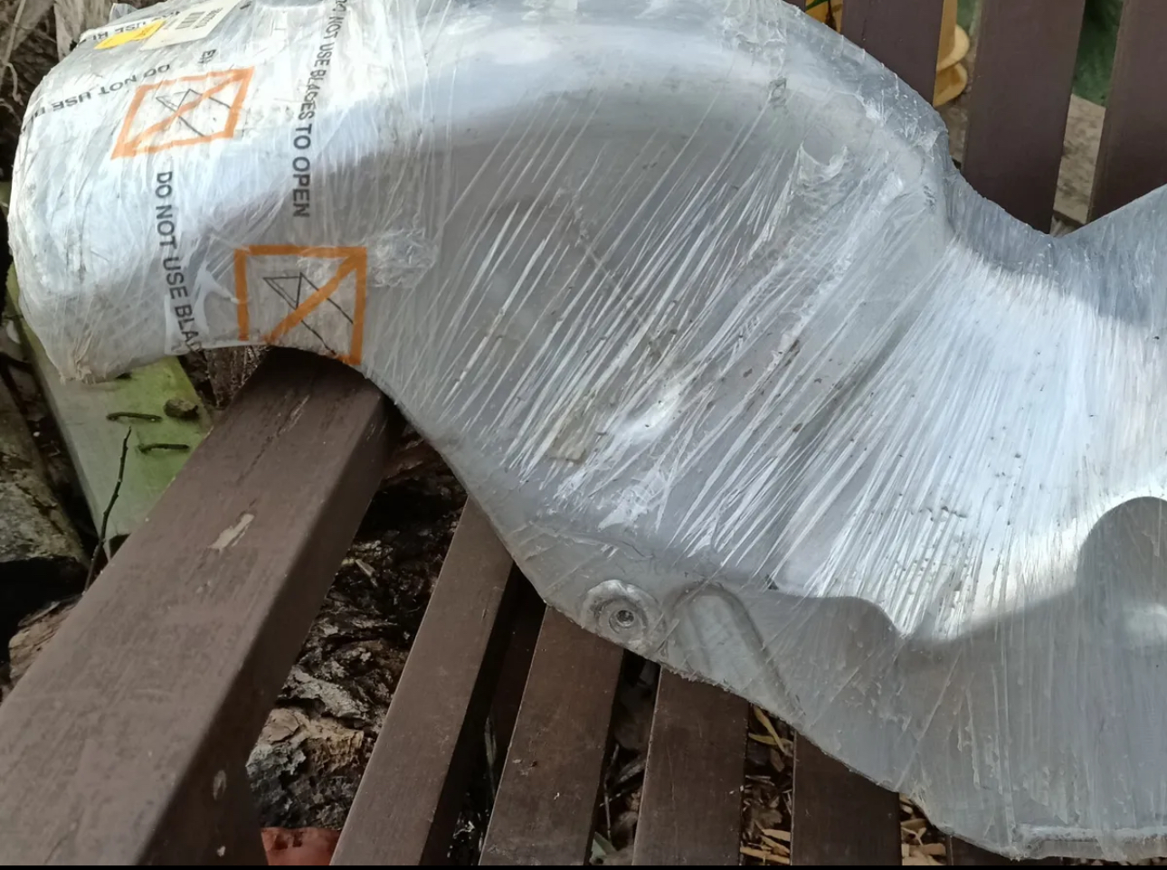

    Couple more images of the tank to compare…
    I’ve pinged Ducati a message just in case it’s a crime to possess and/or modify a MotoGP part :grinning::grinning:
    the more I think about it the more I need to see if I can make it fit and work on the project… without destroying it
