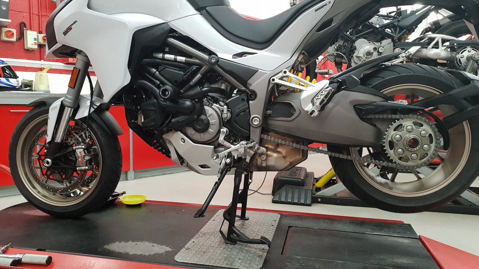

  3. Think yourself lucky... DMC Stoke made my old 1260 up from an regular S to an S Touring by fitting parts from their parts store... At the time I parked on a gravel drive but really struggled with the centre stand elsewhere. Ducati Coventry did the 600 mile service. I was called into the workshop to see this...
    DMS Stoke had fitted a centre stand off of an Enduro! I was wondering why it touched down so easily... They sent me a std 1260 stand after I complained. I couldn't be arsed to ride back to Stoke to have it fitted by them.

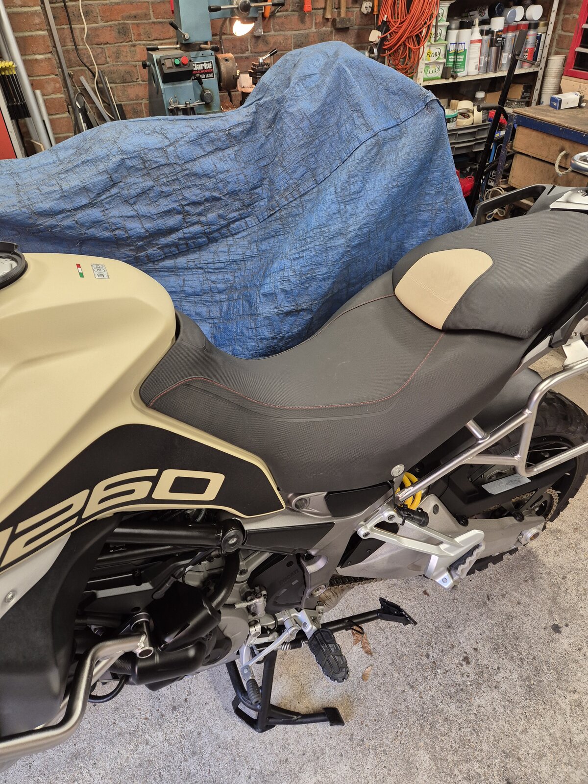

    I also swapped the riders seat for the all black one which looks much better, I'll post a pic tomorrow.

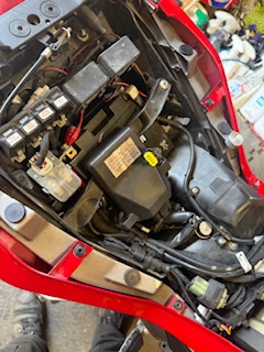

    Whilst changing the saddle I found the Sat Nav power feed has been taken all the way from the wiring at the rear of the bike, and spliced really badly into the wiring leading to the USB socket in the under pillion seat tool tray.
    I've checked and the handy switched power feed under the cover at the headstock is there ready to be used, so I'll rewire that soon.

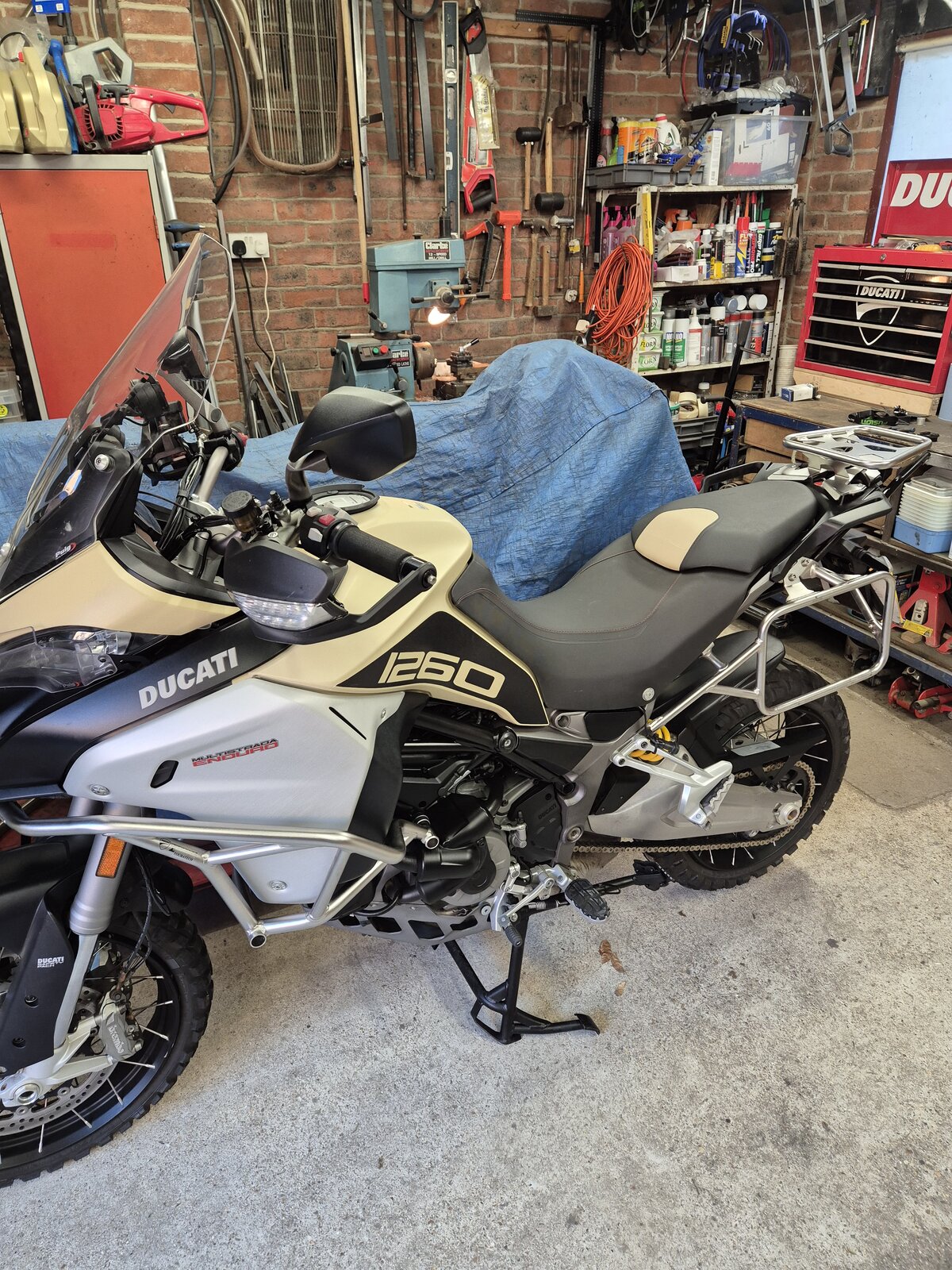

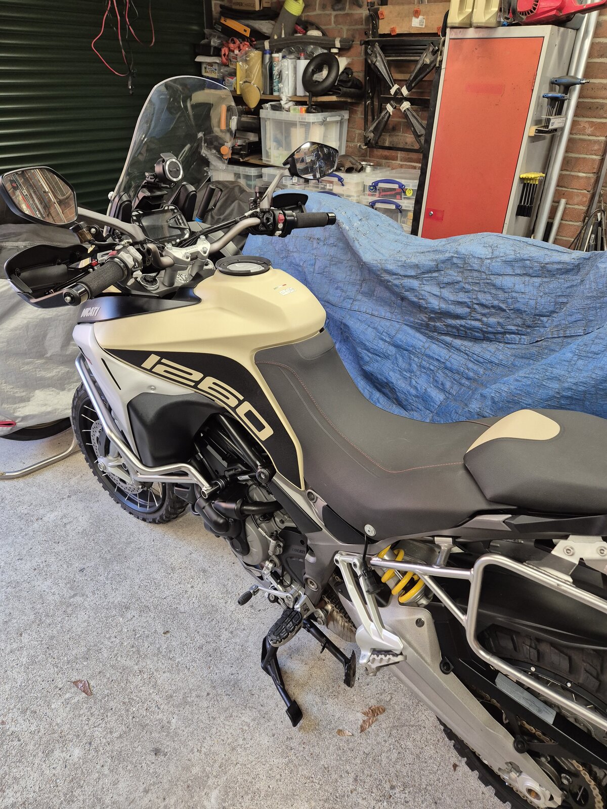

  16. The bike definitely looks better with an all Black riders saddle than the original with body coloured panel through the middle.
    And I don't actually mind the small body coloured panel in the Pillion pad with the all Black riders saddle:
