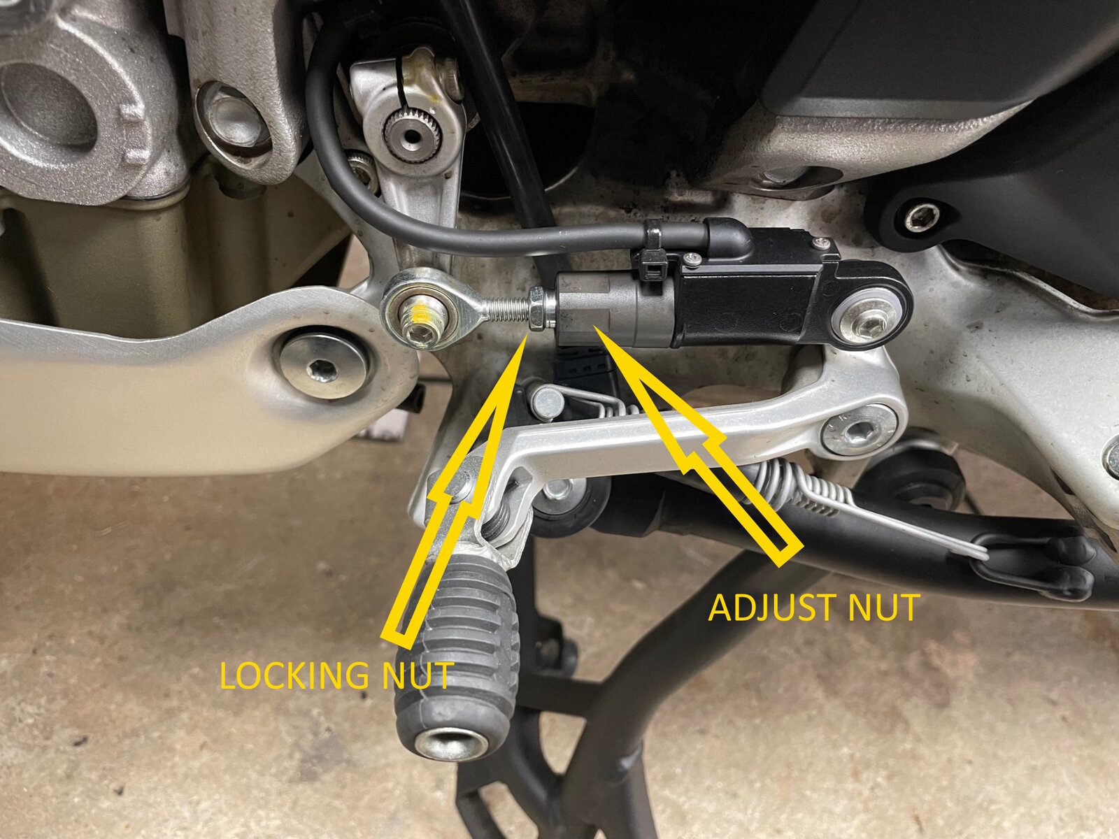

  12. Guys, these boot with high insoles etc..., are you able to use the gear lever ok? Do they interfere?

  14. Yes, the gear lever can be operated, you just have to adjust the height a bit, I don't know if you've seen the video that I posted above, I've been with them for 18,000 km, I raised the position about 1.5cm with the regulating nut that it has, and ready.

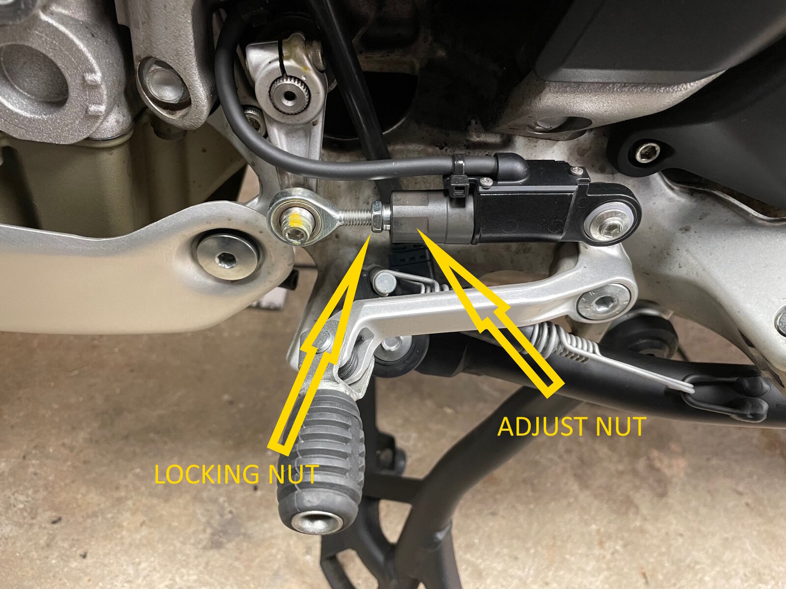

  15. I'm hopefully picking up a pair of these Daytona boots tomorrow. I've attached a photo of how I think the gear lever adjusts, is that correct what I'm thinking? Release the locking nut, then adjust the larger dark nut to the right?
  16. this is the adjustment, you loosen, unscrew, and tighten where it asks you

  18. Unless, I'm mistaken, your arrows are pointing to the quick shifter, to adjust the gear the lever, you loosen the bolt on the actual gear lever and simply raise or lower it.
