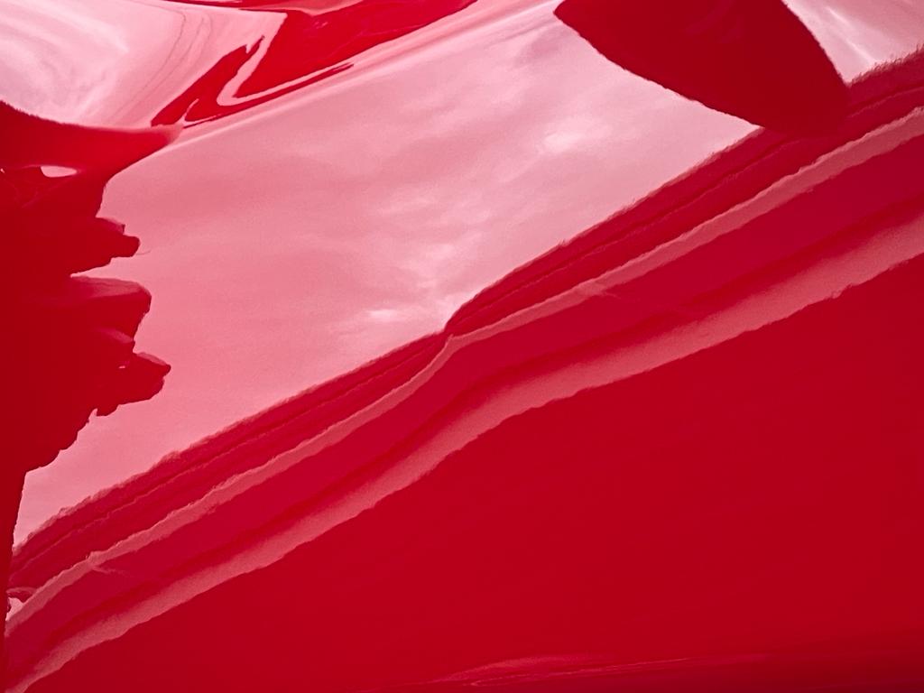

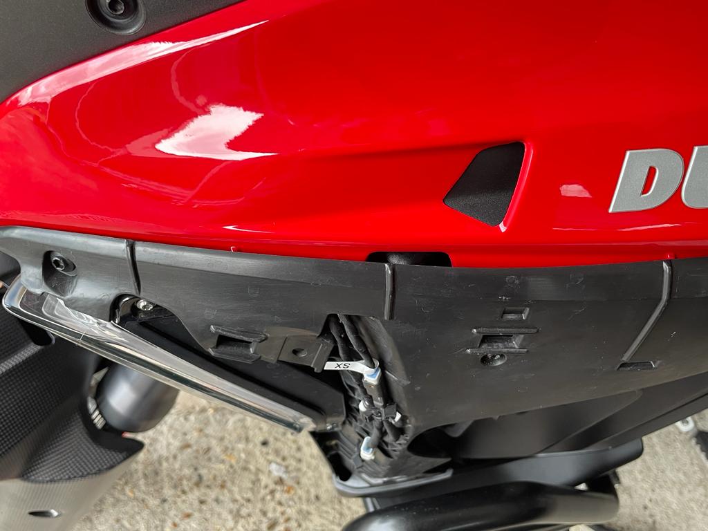

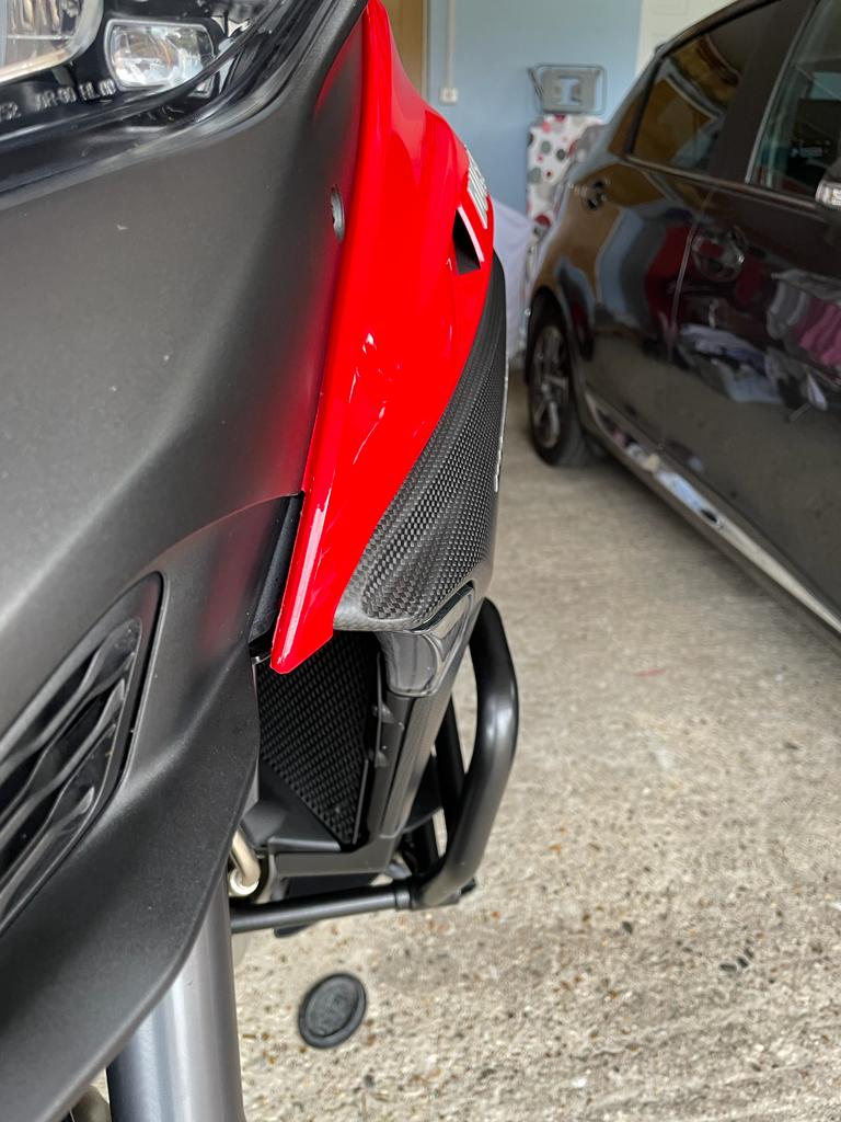

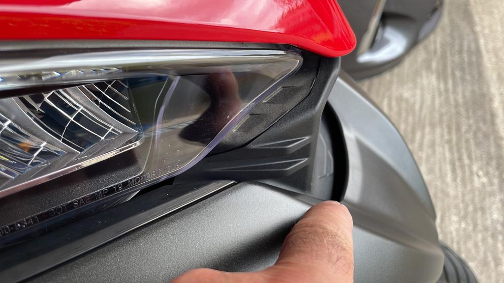

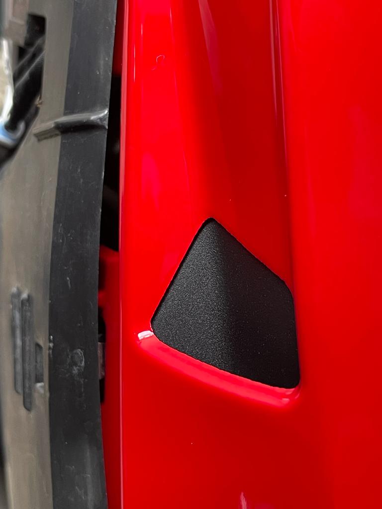

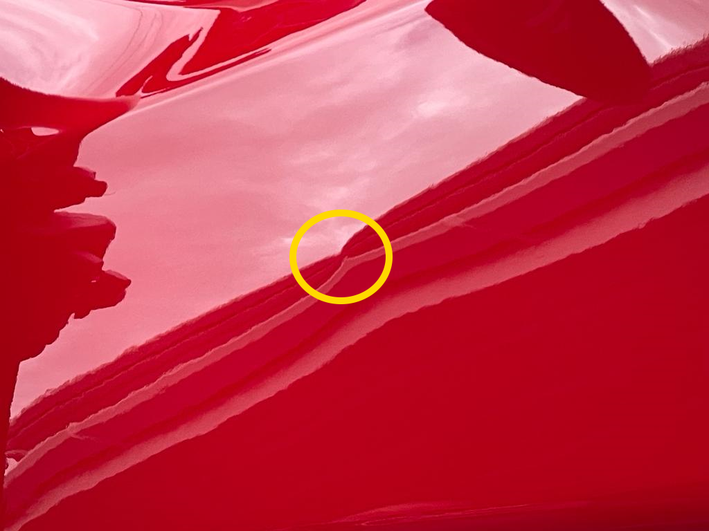

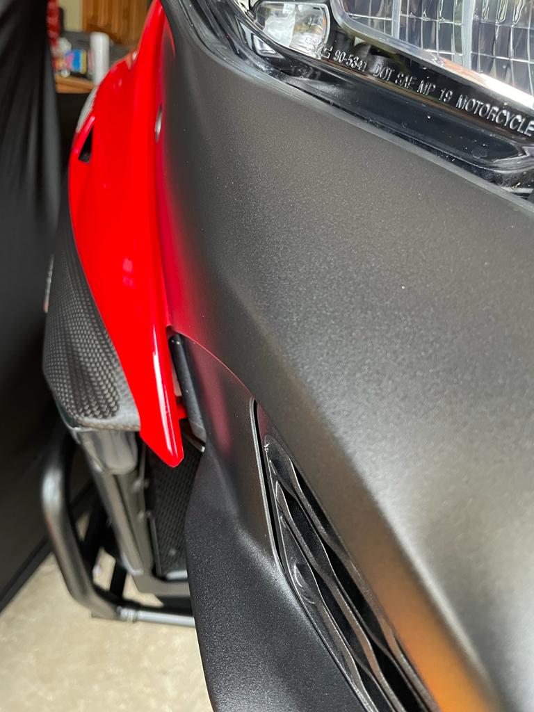

  20. Well got bike back. Shorter side stand isn't an issue, lean on stand looks similar to original. Took her for a bit of ride, have to say, very, very pleased with the handling and turning. Feel's better now if I'm being honest.
    What I'm not pleased about is I don't think Laguna re-assembled the front end panels very well. Not sure its just me but things don't look like they line up correctly anymore. Even top left of the tank there looks like a small bump has appeared.
    I took off my left side carbon panel to see if any screws where missing I noticed the panel underneath hadn't been be clipped back in correctly. Looks a bit of a hash to me, but I'm going to take a run up to Ducati Cambridge tomorrow to compare and get another opinion before I kick off at Laguna.
    Here's a video. WhatsApp Video 2023-07-11 at 19.33.55.mp4
    Anyone close to a Multi V4 to compare please?
