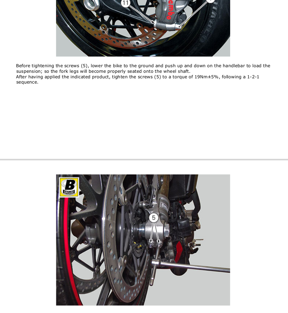

    FYI, All 55mm have the same torque settings, forged or cast.
    To service your bike, even if it's just wheels you need both a small and a large torque wench.
    230 nm for the rear axle nut ,
    63 nm for the front axle nut,
    45nm for the brake calliper bolts,
    10 Nm for the Sach front pinch bolts (19Nm±5% Ohlins),
    All these torque settings are in the sticky. (slight deviations for Ohlins)
