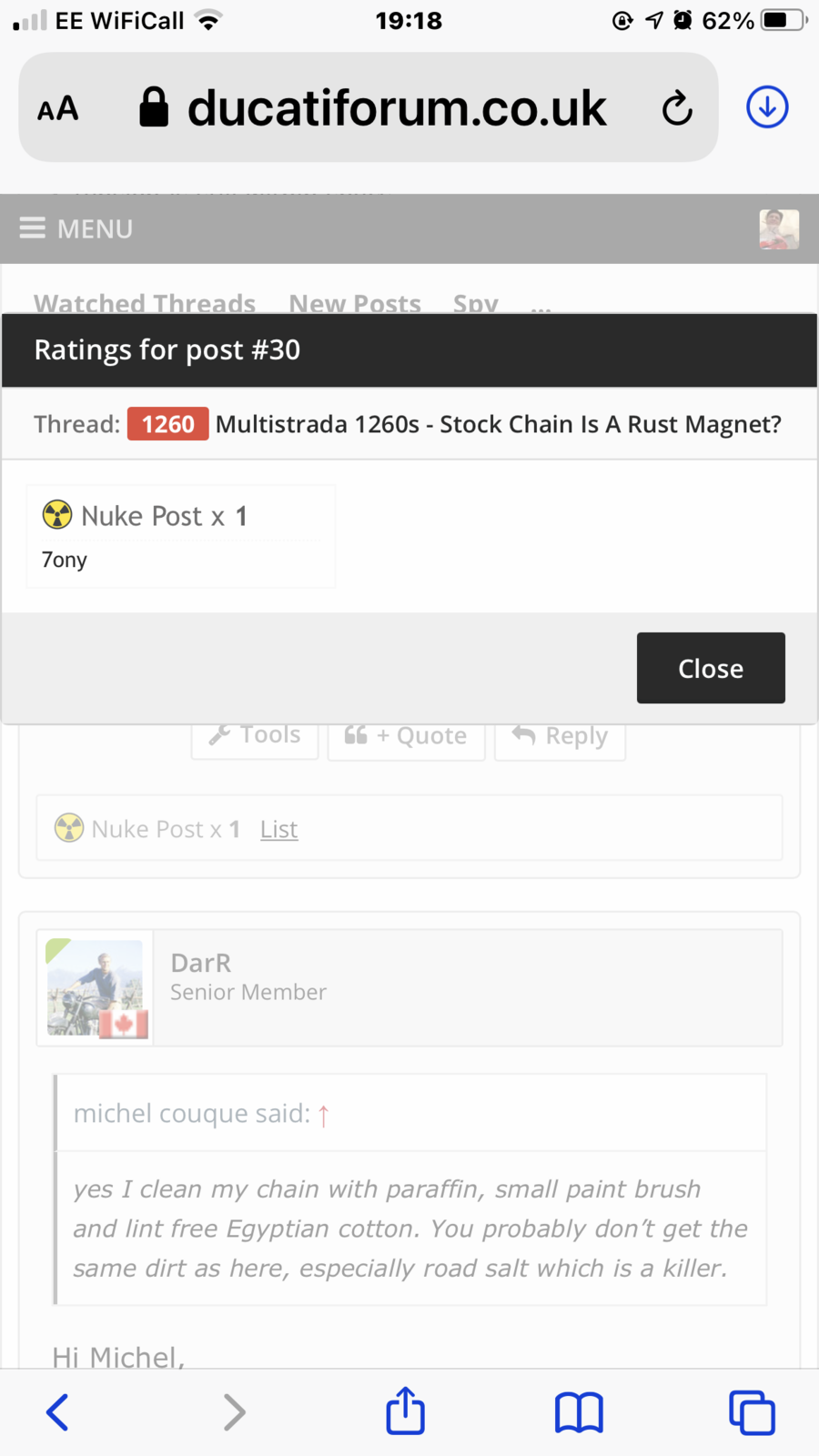

  8. I ignore those as if you’re scrolling through posts on here on aniPad the nuke feature is easily accidentally pressed michel.
  9. Us and our middle aged fat fingers!
  10. Don’t forget to allow for customs charges if you use Carpimoto now
  11. Did I!. Lol.. no idea, pressed in error..... I use paraffin too... just not Egyptian cotton, more like my old pants... lol
  12. I also have a range of well used underwear hanging in the garage waiting to be used.

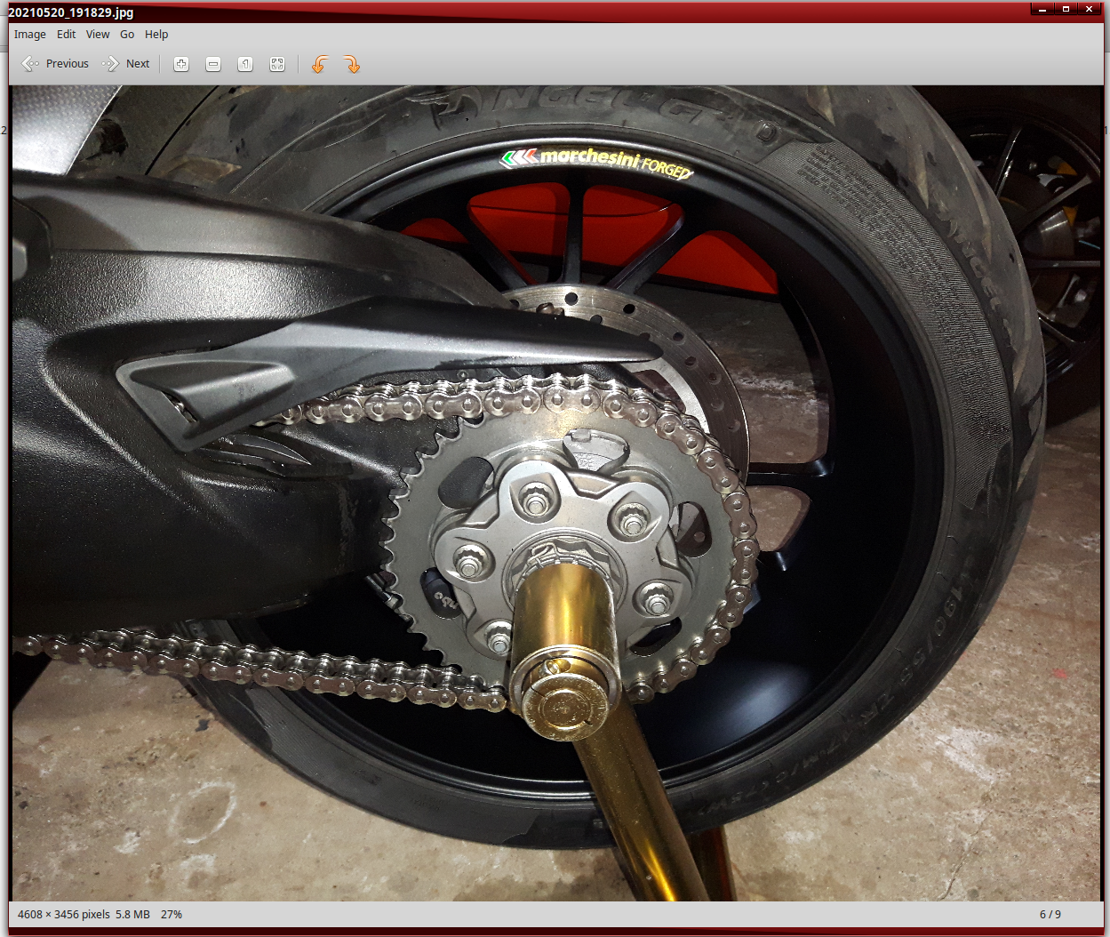

  13. Hi @Michel,
    Good photos BTW.
    Your rear sprocket looks ok. Your counter-sprocket shows a bit of wear but has some life left. The chain looks really gritty however and needs cleaning.

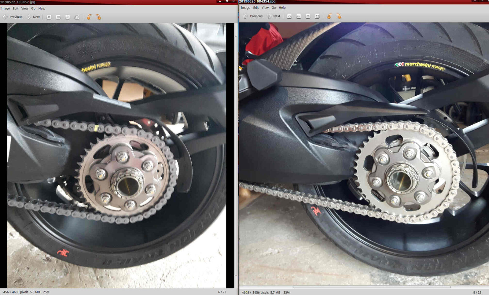

    Here's a photo of my chain and sprocket when replaced at the first 1000km service.
    Notice the two 2019 time stamps on the top left hand corner.

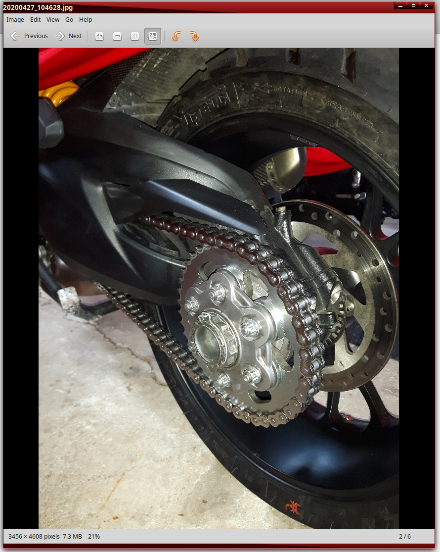

    A year later in 2020.
    Screenshot from 2021-05-24 10:16:18.png
    A few days ago at 13,000kms.
    Screenshot from 2021-05-24 10:10:37.png
