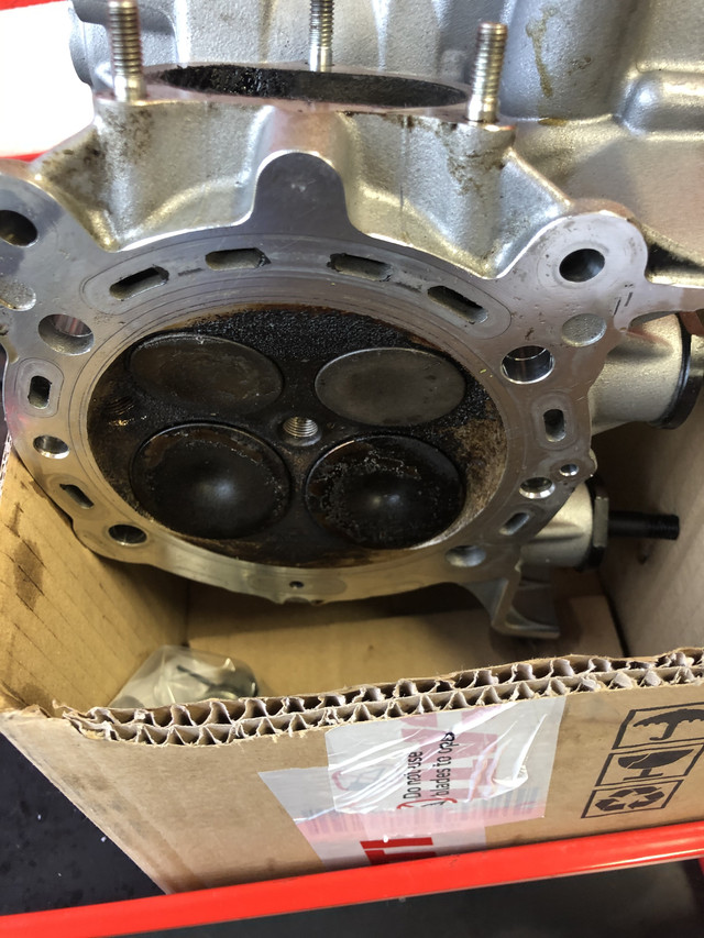

  12. Just an update...
    Repair done...
    Here how my old head looked like...
    Oil was coming from above, inside the head, leaking down through left part of exhaust manifold...
    Also, oil was entering through exhaust valves into the head, that's where this oily burned material on the valves is coming from...
