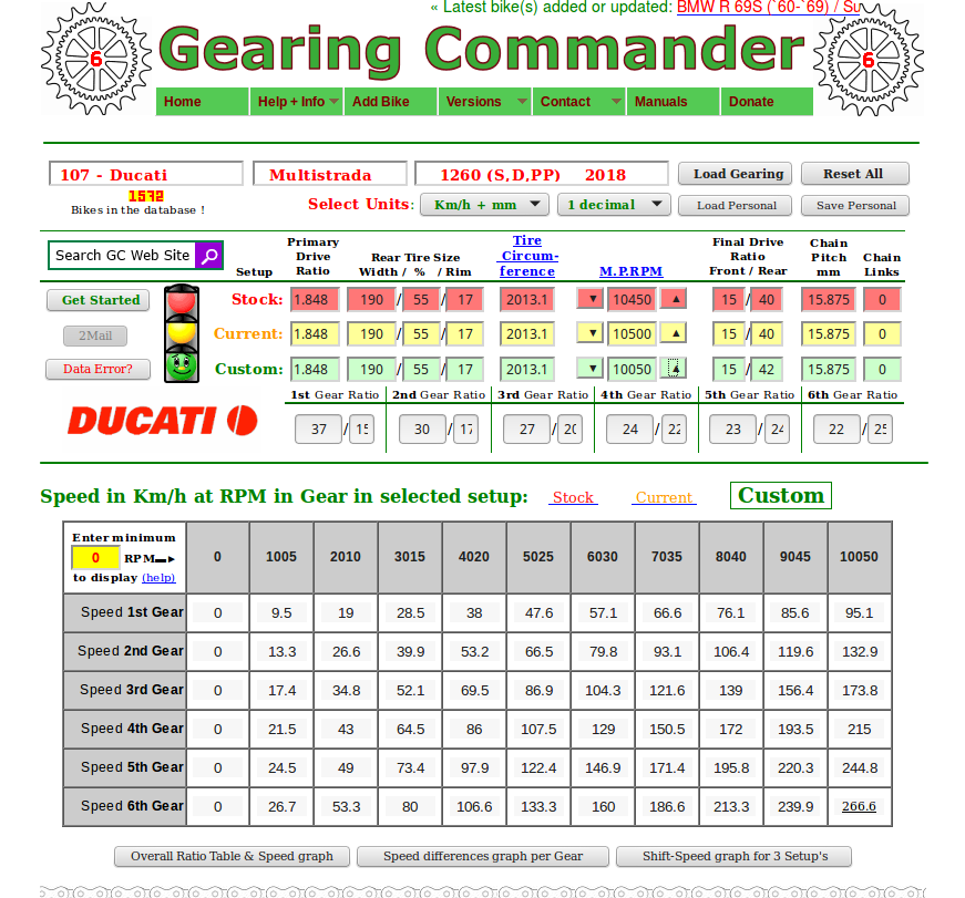

  4. I'm questioning my own observations as they don't coincide with Gearing Commander even when using 15/42 and adjusting for the speedo error. Would be a lot simpler if the Ducati speedometer was accurate.
    Maybe it's off by more than 5%
    Screenshot from 2019-07-09 18:06:00.png

  5. I'm questioning my own observations as they don't coincide with Gearing Commander even when using 15/42 and adjusting for the speedo error. Would be a lot simpler if the Ducati speedometer was accurate.
    View attachment 162393 [/QUOTE]
    The bike will never do 165 (or whatever it is standard) as aerodynamics come in to play and GC doesn't account for that AFAIK. but its a great guide for how much it changes in gears at revs, so you can see what is lost potentially top end but (probably more importably) what revs at 60/70/80 etc. Especially if you change gearing and it throws your touring speed in to a flapper flat spot!!
    Also note it calls out primary gearing, so you can check across models
    I used to be on this all the time when I raced and did trackdays :upyeah:

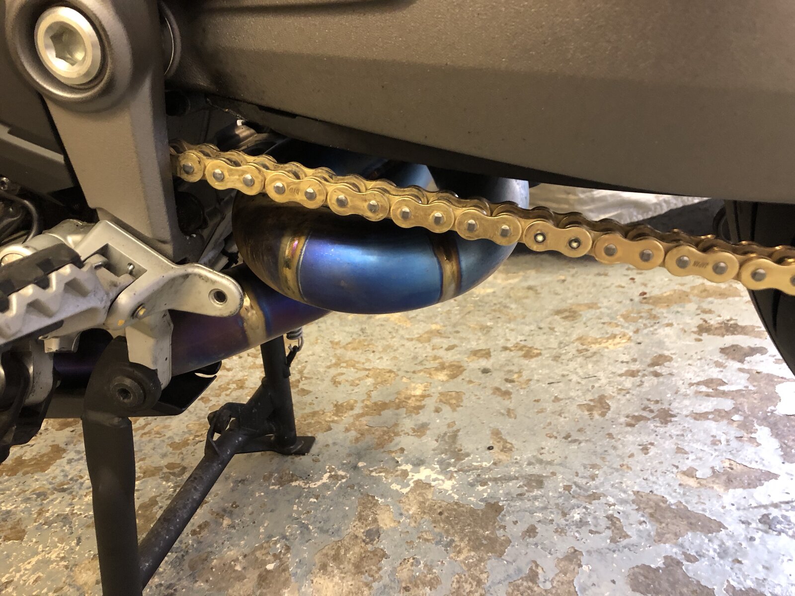

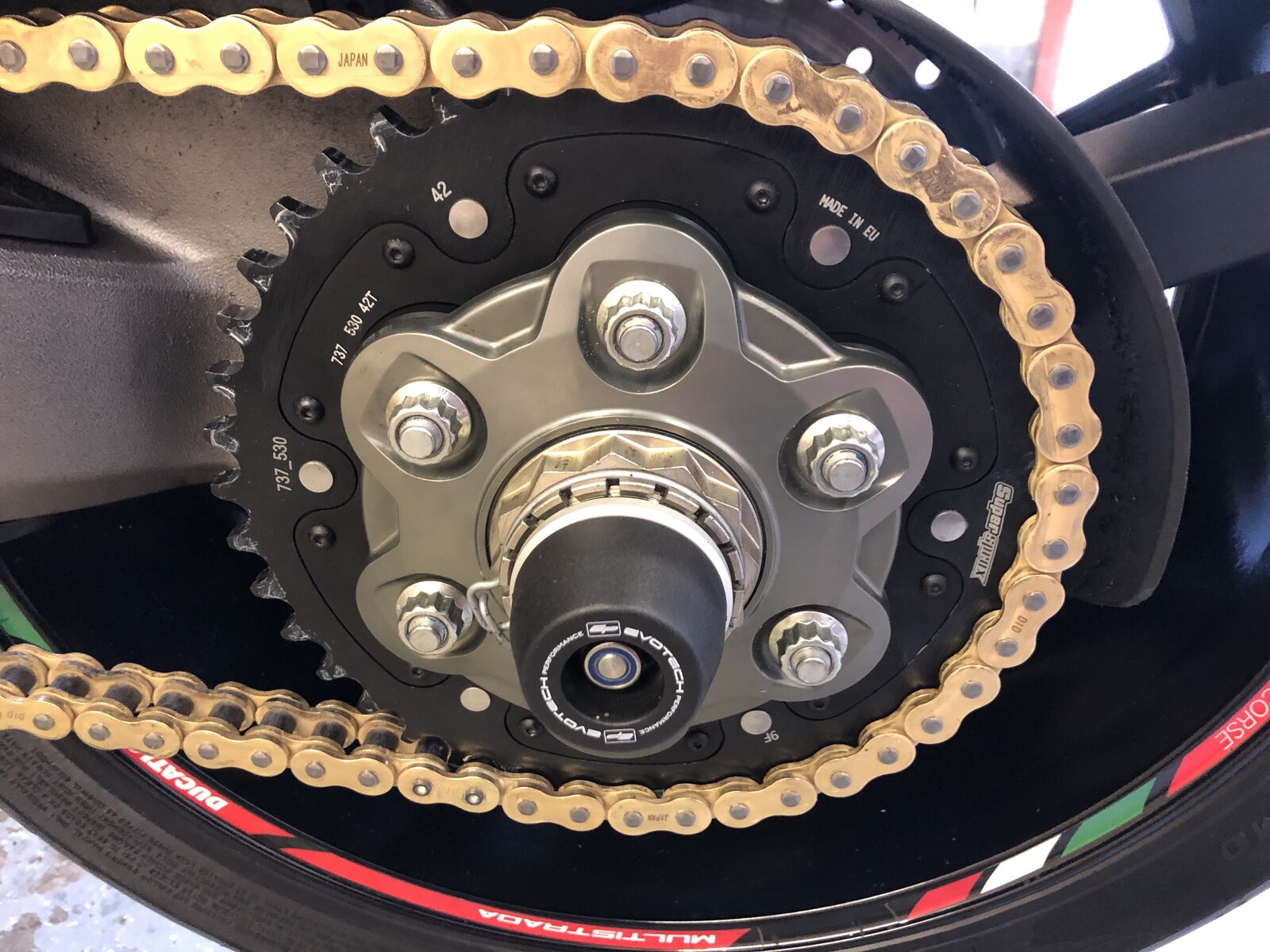

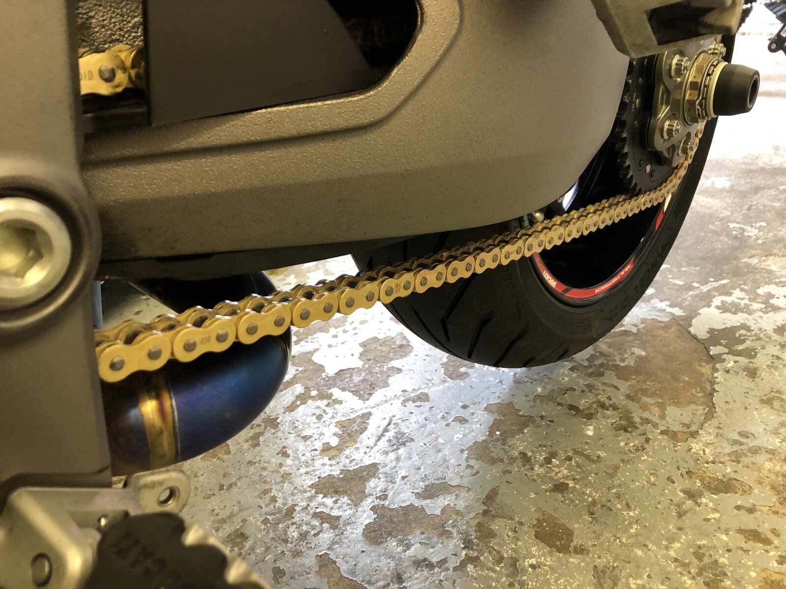

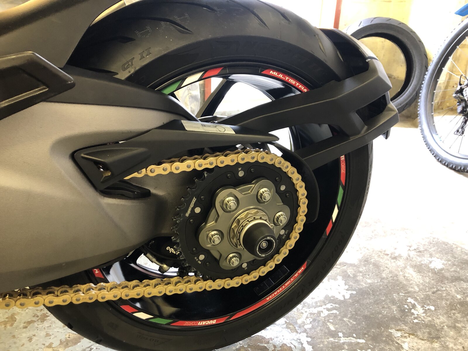

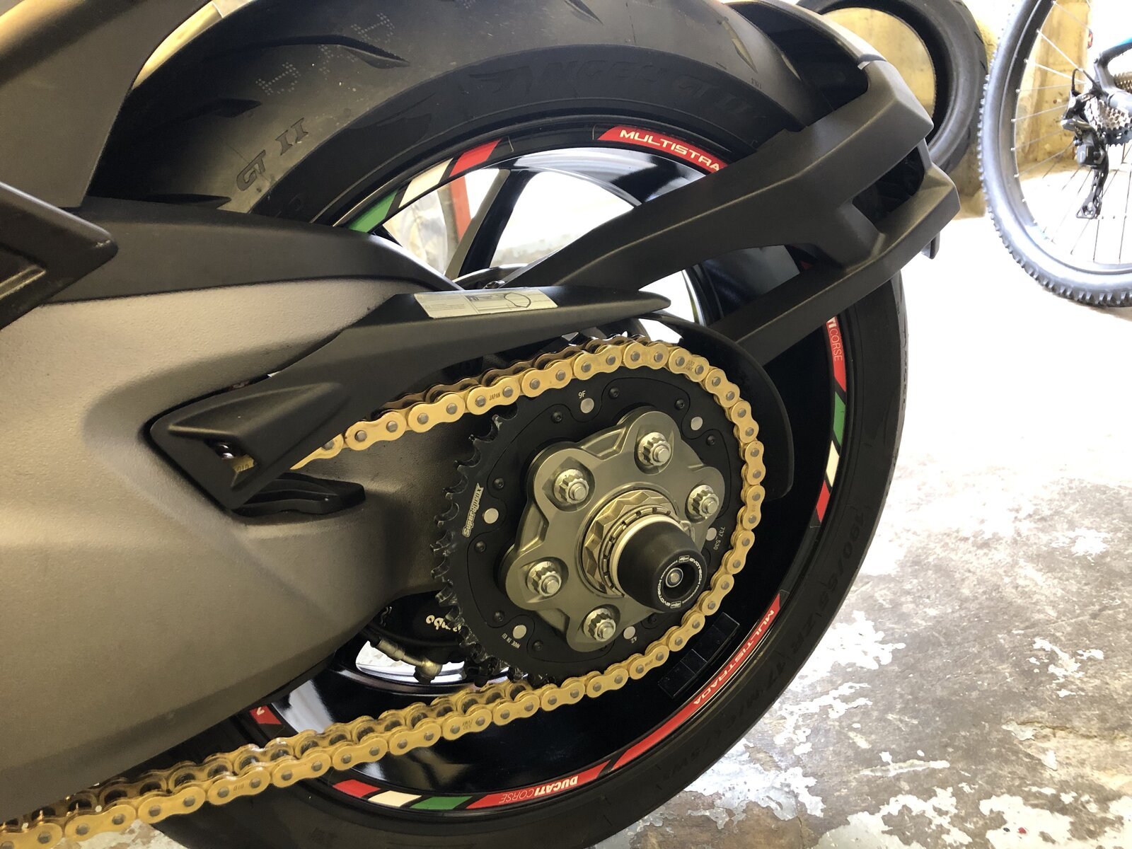

    Looking forward to the first run out.
  19. Looks well
