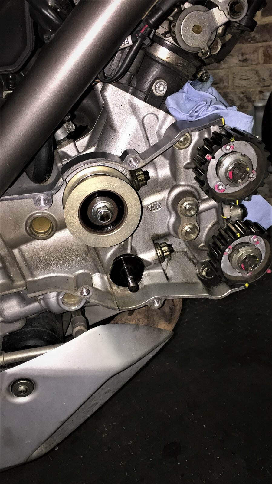

  11. No it can’t be one tooth out as I checked the cams using the cam centre method using a degree wheel and it correlated with the vertical cyl. Didn’t fix the problem though. So I swapped engines and exactly the same problem ... so highly unlikely that both engines had bad valve timing by one tooth.
    When the TDC mark is lined up with the mark on the crankcase, both cams form upside down T’s. Then I can fit my Ducati cam holding tool on both cylinder inverted cam T’s... and I wouldn’t be able to do that if a cam is one tooth out.

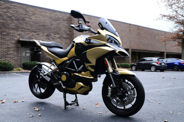

  12. I don't use sophisticated locking tools when bits of wood suffice nicely.:upyeah: Those are pictures of my Strada 1200S
  13. Yes that is exactly how mine looks. If you look at the center of the cam the notches form 2 inverted T shapes.
