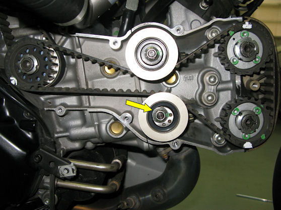

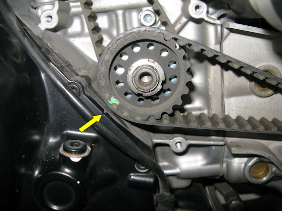

    Ignore the yellow arrow in this first photo. 39CADF00-893D-46CF-B2C1-72F2EC10983B.jpeg
    This is the mark I am talking about.
    See how there is an inverted T shape in the cam centres.
    I don’t understand how the engine could be out 1 cycle with the pulley lined up with the pulley mark (indicated by the second yellow arrow) and the inverted Ts on the cams.
    Thanks so much. If this is right I will be a very happy camper indeed.
    Ignore this photo... I can’t seem to delete it.

  8. I didn’t know that you had changed the belts - did it start to play up immediately afterwards? take the belt covers off, rotate engine to TDC firing on horizontal cylinder and take pictures of belt run on all sprockets for us.
  9. Ok. Done in my edited post above.
  10. if you marked the pulley or used the marks on them no matter how many times you may have inadvertently turned any pulley with the belts off, if use the marks you cant be one turn out on any pulley
  11. Isn’t it always TDC firing on horizon cyl where I have indicated with the yellow arrow ... where the mark on the pulley and crankcase line up? Oui? Non?

  12. Good to hear. I thought so but nice to have a more educated second opinion. Will do fresh photos when I get back to the bike but they will look the same. I’m in Rio for a wedding at the moment so it will take me a while to post them.
  13. Roger that. Will do.
  14. Alexaussi Looking at your 3rd photo ( which I assume is related to the engine you are having problems with)
    This looks absolutely correct.
    For clarification : ( it took me ages to fully understand this as I'm slow on the uptake, so thought I would try to help you )
    When the crankshaft pulley mark is aligned with the mark on the crankcase and the cam pulleys are aligned as yours are showing in the photo. The piston is at T.D.C on the Firing stroke.
    I found the Ducatitech videos very helpful, the link is for a 749 but same principle
  15. For further clarification:
    The lower pulley runs at 1/2 engine speed, so 2 turns of the crank to 1 turn of the timing pulley.
    When the timing pulley mark is lined up with the line on the clutch cover the engine is at the timing position.
    i.e. The horizontal piston is at top dead centre at the start of the firing strowith both valves fully closed and the vertical piston is half way down the inlet stroke with the inlet valve fully open. At this point all camshafts on the MTS engine will have the leg of the T facing away from the cylinder (this is not the case on 749/999 and 1098 engines).
    The 3rd picture shows the cams correctly timed.
