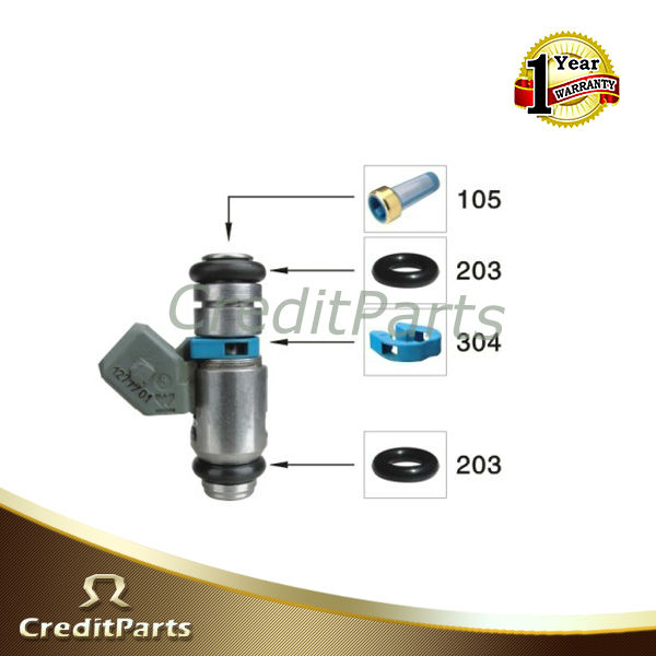

  7. Most injectors, including those fitted to Ducatis have a tiny filter in the inlet. They are not mentioned in any service manual nor parts list. The Multi injectors probably have them too.

  8. Yes but buggered if I can get them out.
  9. You could try using a self tapping screw to extract them.

  14. this thread got me out the poop the other day, chasing an intermittent random multiple misfire error. that had been getting progressively worse over a period of wonths on a Renault of all things. there is indeed a filter inside the injectors. I have renewed many injectors over the years because of electrical faults, generally v,easy to diagnose, simple ohms test. but I have never seen a clogged one. let alone 3 out of the 4. I had pumped a few hours over a period of days into this job and I don't charge for failure. then this thread popped into my head on Thursday night. with a few bits and bobs out the way I could pull them out and check the spray pattern. near bugger all out of one. yip, full of grit, one almost completely blocked I. blew them out, cleaned out the rail. put an extra filter in the line as there is supposed to be a lifetime filter in the tank. boom, sweet as a nut and fin takes all the credit. :upyeah:.
    cheers alex. a wee lesson learned. its so easy to forget the basics once you get a train of thought in your head.
