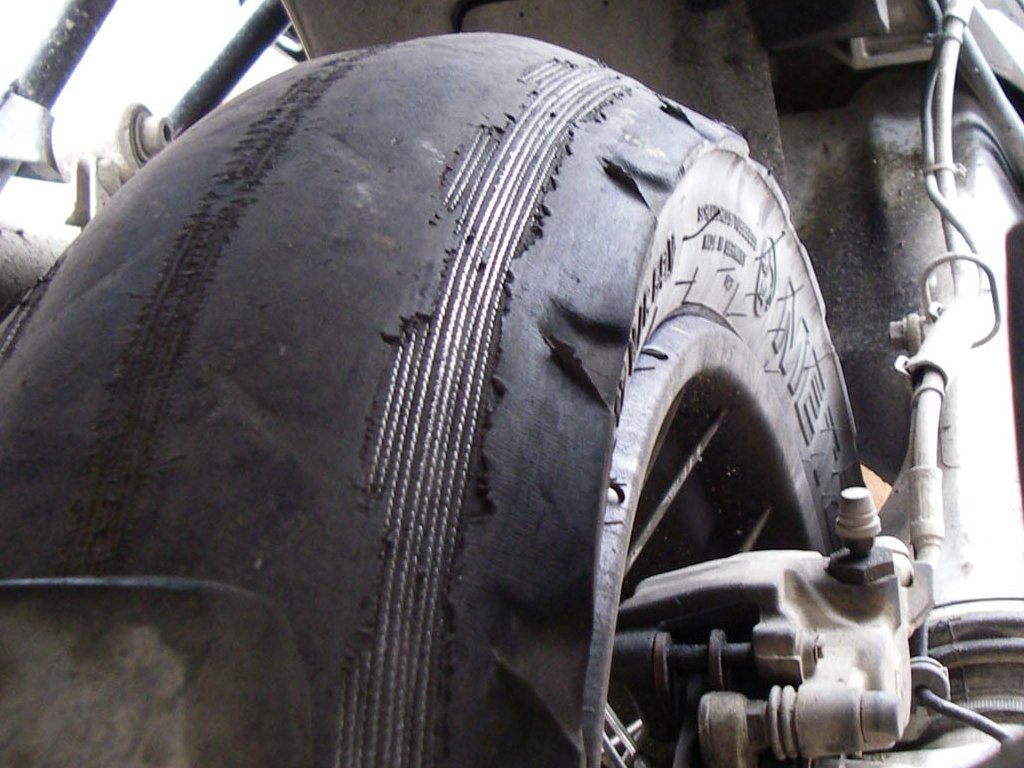

  6. Jeez, that’s about ready to be replaced :laughing:
  7. Another session in that ;)

  19. DarR, that is a good effort !! :upyeah::cool:
    I've skinned a few tyres in my time, and usually have at least one down to cord each year, but not quite as severe as that :laughing:
