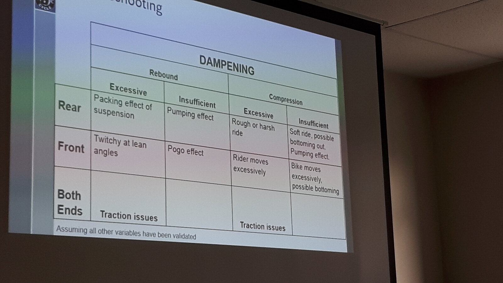

    About the fork dive: I don't have that issue. Try dialing-up the compression dampening (not the pre-load).
    Here's one of many troubleshooting charts that was presented at a track course I attended which may help.
