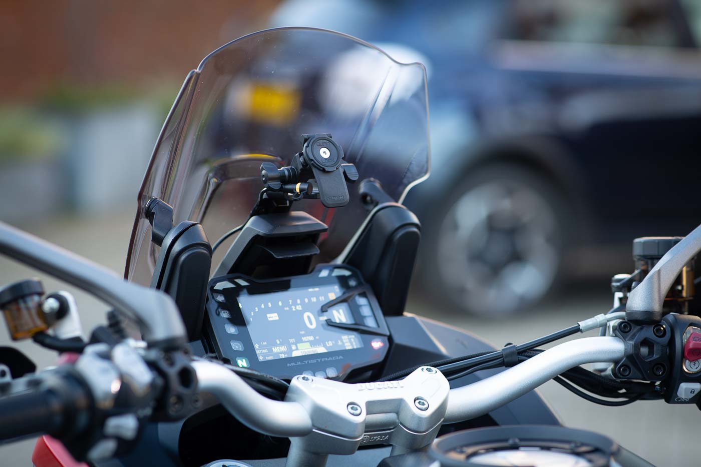

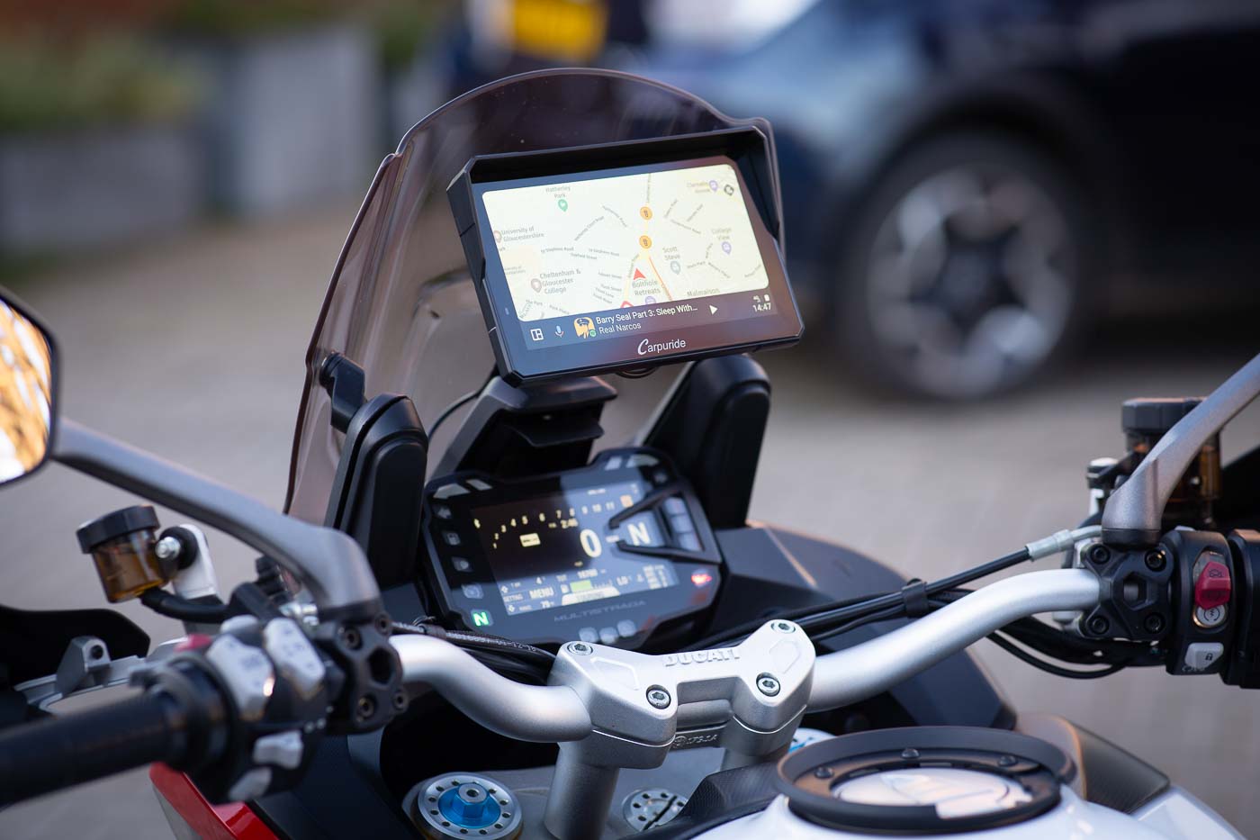

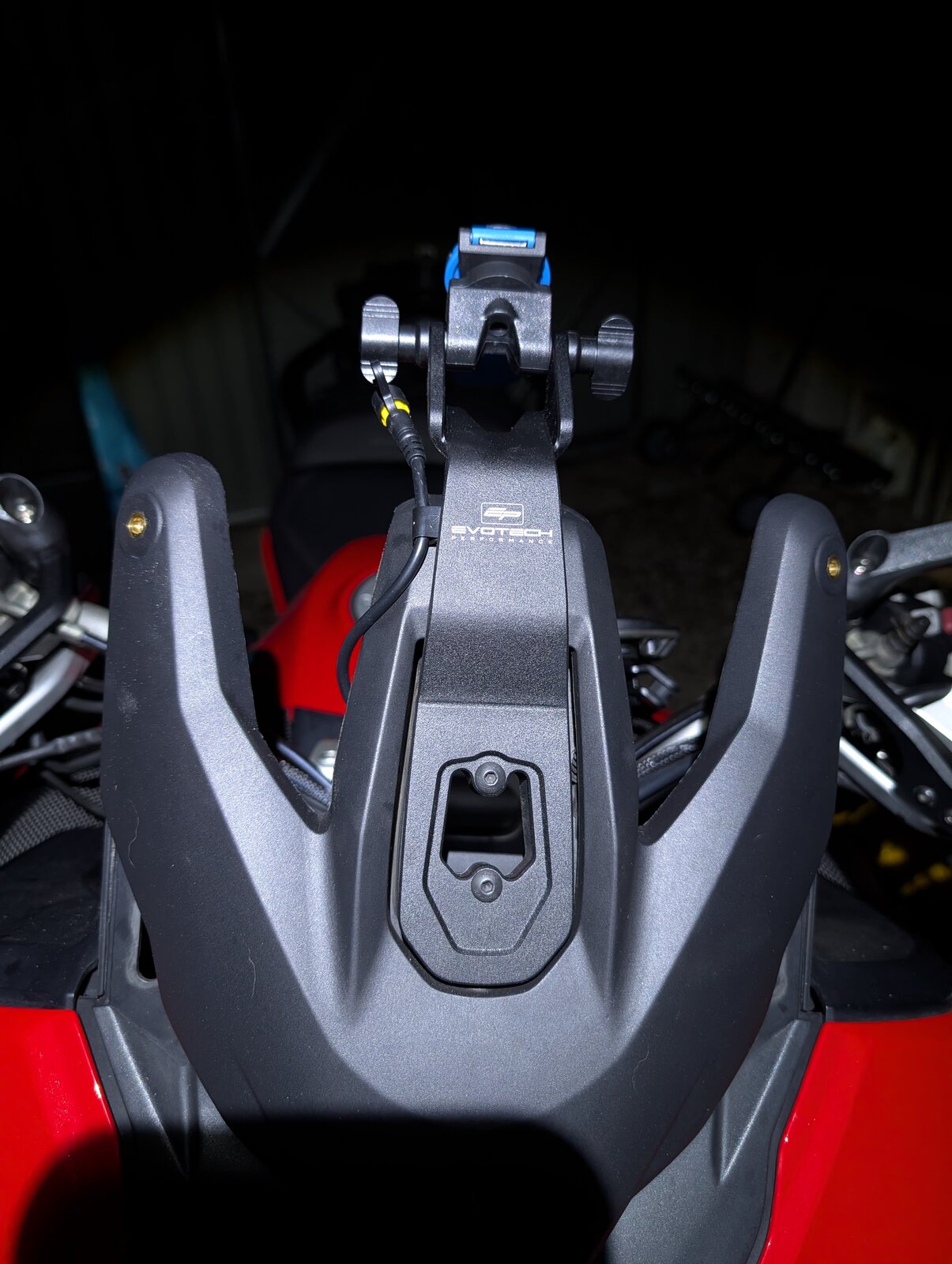

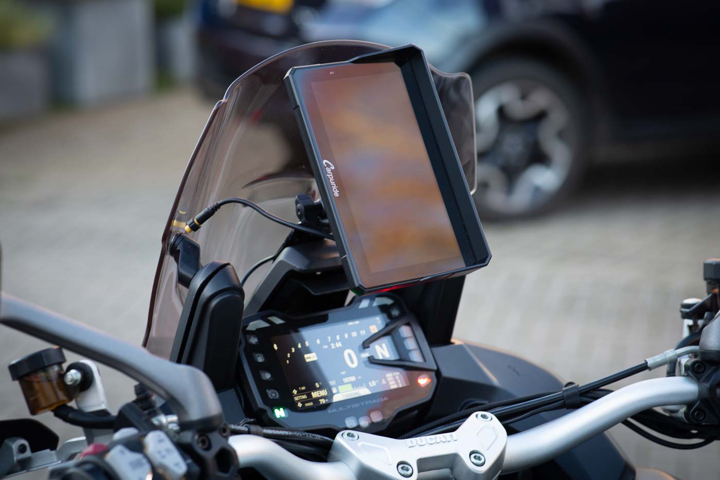

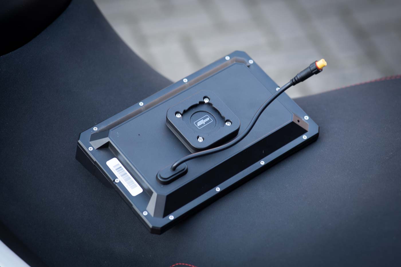

  16. I have the same set-up as @PineWhisper, mounting a Carpuride W702 Pro. The Evotech kit is the usual great quality. Expanding on my post further up this page now I have photos.
    You can see in the first image I've swapped the Quadlock lever from the bright blue one to black, less obvious to thieves and also less distracting when riding without the panel.
    As the Quadlock mates at 45º but locks out either vertically or horizontally I first twist my Carpuride clockwise so that it's in portrait mode (90º from what it should be), as in pic three, so that I can get easy access to both of the cable ends (you can see these in pics one and two) to join them together. Once connected I release the Quadlock lever again and turn the unit 90º anticlockwise to orientate the Carpuride as shown in pic four, this hides the cable behind the unit. Mounting and dismounting it this way prevents awkwardly propping up the panel and risking dropping it or scratching the screen as it dangles, you do need both hands to join the connector.
    The base of the original Carpuride ball mount, that the Evotech Quadlock compatible plate (in pic two) replaces, made contact via a thermal pad with a chip inside the unit, this is obviously so that this part of the mount acts as a heatsink. The Evotech part does the same and being a decent block of aluminium performs the same function. Just don't misplace the thermal pad when installing the Evotech part.
    It's a well thought out solution and very usable day to day as a easily detachable mount. I started with an SP connect mount for my phone on the Evotech GPS mount. Thankfully they sell, if you require it as I did, the head part of the mount to match a variety of GPS models and mount systems. I have quite a few Evotech products on my bike, very happy with the quality and function of them all. Top company with well designed products in my humble opinion, no affiliation other than a satisfied customer.
