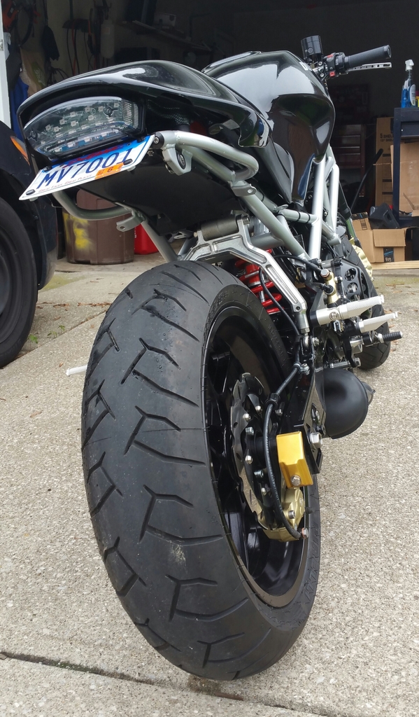

  1. Glad to see you got the tank on ok. The only thing that strikes me as looking a bit off is the gap between the seat and subframe where it bridges across the new angle that has been created. I know you're still tweaking the seat and we've covered the angle thing but I think I'm looking at a different bit to your mentioned solution.

    @Joe748 @higgy748 - Yes, I agree. There are a couple of things I'm not 100% happy with about the seat unit and subframe. That gap between the subframe and halfway along the seat base being one of them. It sort of couldn't be helped because to make the top subframe spar follow the seat unit perfectly would have meant cutting it off and rewelding it much further forward, at around the point of the shock mount, which would have caused almost as much grief as fitting the Pani subframe. As is often the case, it was a trade off between ideals, risk, hassle and budget. I may still get the Pani seat unit and subframe grafted on in the future, but that will have to be once I've topped up the piggy bank again.

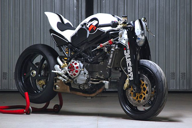

    I trawled the interwebs for seat ideas but most of the interesting ones, like the one on the white bike you posted (which looks great btw and I look forward to seeing your project), are single seater and I need pillion capability. I also wanted the seat unit to be short and end at around a line drawn vertically through the rear wheel hub, and this further reduced the options. I already have built a radically bobbed/brat 900ss (which I'm selling if anyone is interested) which is single seater only and hence is sort of a bit of a third wheel. Although I do a fair amount of riding on my own, I also do a lot with my girlfriend on the back, so the bike needed to fit that requirement too, which severely complicated matters. While if it's just for single seat use only, it's quite easy to just make up a little seat mounting base and subframe under the rider's bum and leave the rest of the seat unsupported, but if you're going to retain the ability to carry a passenger, you need a lot of load bearing capacity carried high up and at the end of what is a long and potentially un or insufficiently braced tube. My girfriend is only tiny, but I sometimes take my teenage sons out for a blast, one of whom is built like an ox and still growing.
    Ultimately I hope I can fit the Pani 899 seat and subframe I have in my shed, but it isn't going to be a simple job. The seat and subframe are quite a complex combined unit where the subframe sort of twists through and up into the pillion area in what I can only describe as an "organic" fashion (no straight lines). The seat unit itself is also not a single piece of plastic, but is instead a collection of small bits of plastic which mount to the subframe to form what looks like a cohesive whole, but is in fact basically a 3D jigsaw puzzle. Hence, that means retaining at least the back end of the 899 subframe so the seat unit can be built around it. Unfortunately the 899 subframe mounts to the Pani in a completely different way to any other previous Ducati in that it bolts to the engine casing. Hence, it's very narrow and there was no natural point at which it could be mated to the much wider frame spars of the Monster. Me, Ray and Max spent literally hours thinking about and discussing ideas, including Max proposing some way of semi-copying the way the Pani uses the engine as a load bearing member. The idea being to mount the top spar of the subframe to the engine and the bottom spar to the frame. Unfortunately, while on the left side there were a couple of handy looking empty threaded holes in the engine casing which could have been used, on the right hand side there were none (because that's where the belts are).
    The only feasible way to do it would be to use the complex, bendy rear part of the 899 subframe only, and chop it somewhere under the rider's seat pad area. The Monster frame would need to be chopped as far forward as possible, but no further forward than the shock mount (for obvious reasons) and some new bracing spars welded on to meet the stub of the 899 subframe.
    It could have been done, but it was a much bigger and complicated and potentially risky job. Risky not only in terms of how it would look once done, but also whether it would be safe. Plus it would have been a lot more expensive, not just in terms of workshop time, but also because the seat would need spraying and I would need new rearsets, pillion pegs, a pillion pad, a new rider's seat pad (which I pinched for my 900 project), a new lock for the seat cowl/pillion pad (it didn't come with a key) etc etc.
    All a bit of a ballache basically, so this was the (much simpler, safer and less expensive) route we decided to go down. For now at least.....

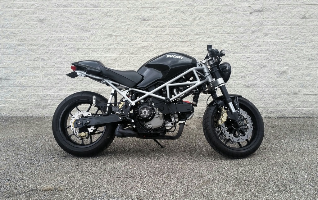

  15. The low rear end of the OG Monsta is an easy fix, you could go with a trick piece of kit like this from S&P:
    Or source an eccentric shock link from an 851/888, or simply use longer rod ends and/or threaded standoffs. I personally love the huge headlight but I wanted something more modern that also worked better while still matching the rest of the bike so I went with this setup from Motodemic:
    The classic Monster is a very blank slate, easy to modify to suit your tastes. Best "standard" ever produced and the gobs of torque from the venerable 900 motors is more than satisfying for the street.
    I do, however, like how you've exposed the vertical cylinder with that 748 tank. Overall not for me, but a clean proper build nonetheless.
