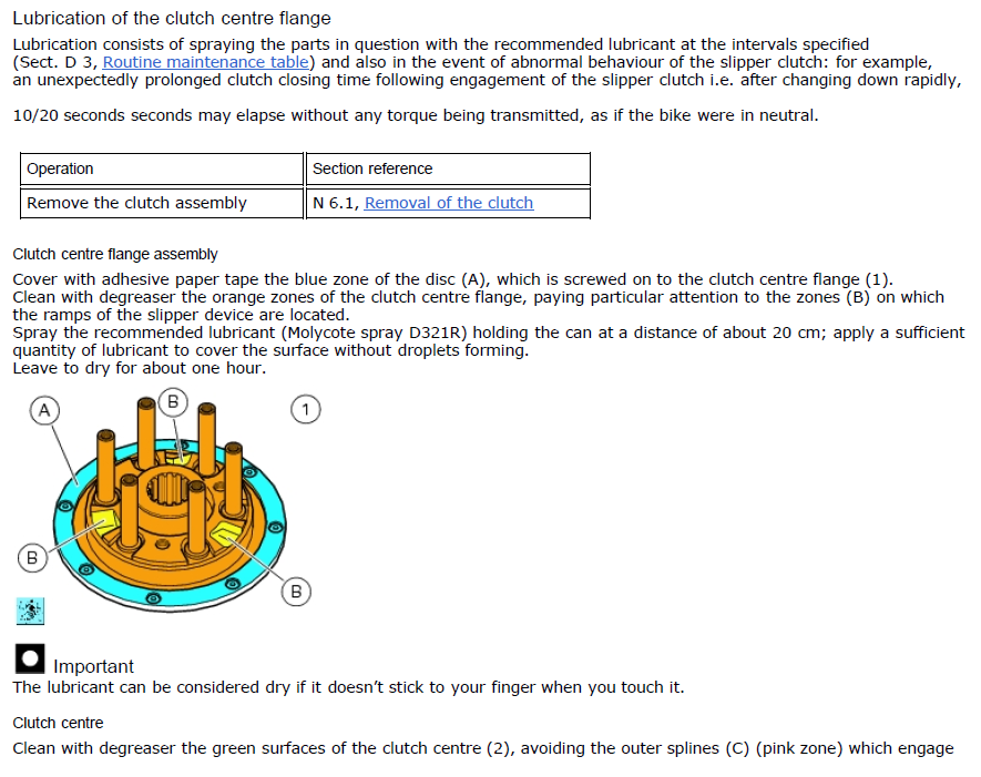

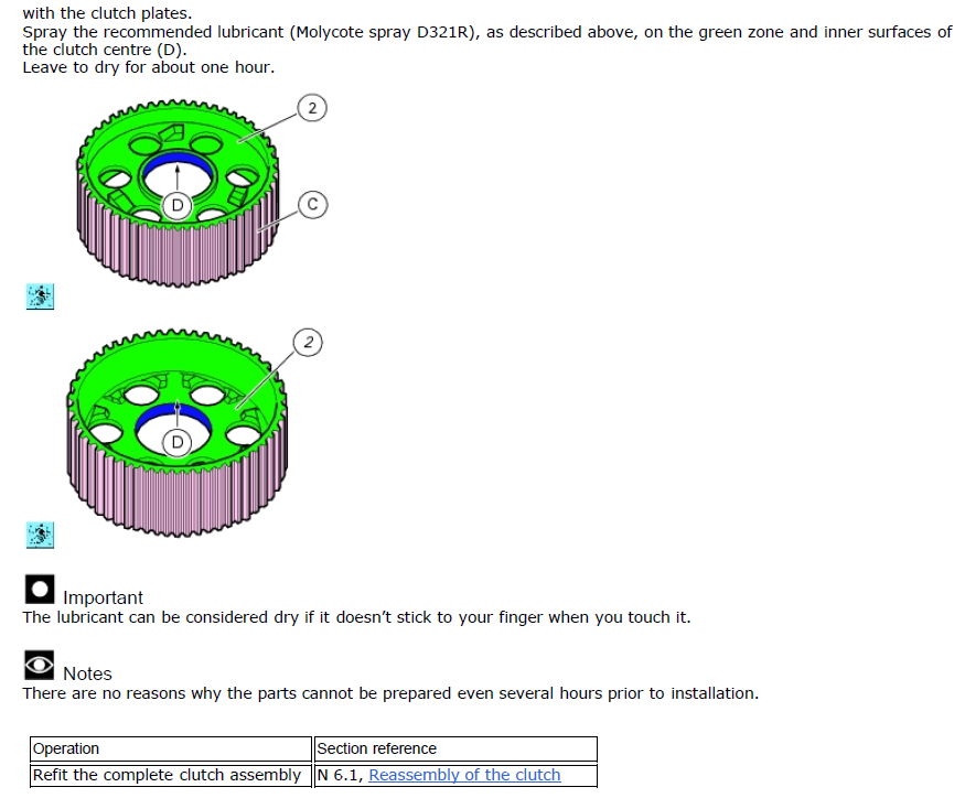

  11. @AmalfiCoast_1198s Upload that video of your clutch noises when you get a chance. We'll see if its the same thing.
    The bits I greased were the bits mentioned in the service manual (extract below). I'm sure that greasing bit though is more for the smooth running of the slipper mechanism.
    The bit I think helped most with the launches, was the general strip and clean of the basket and plates. Due to still having a closed cover, there was a lot of dust build up in mine. I stripped all the plates out and cleaned them all. The basket was slightly worn by the plates, and where there was wear, there were small tangs of metal on the inner face of the basket which I removed to try smooth the movements of the plates up.
    Re-fitted it all and it was much better. No more groaning sounds as I set off, no more lunging, predictable, and very easy to modulate.
    I suspect though, as it gets dirtier again, those previous symptoms will return.

  12. The grease is just for the slipper function and has no effect on graunchy pulling away.
    My clutch is fine from the perspective of slipping as I recently regreased it.
