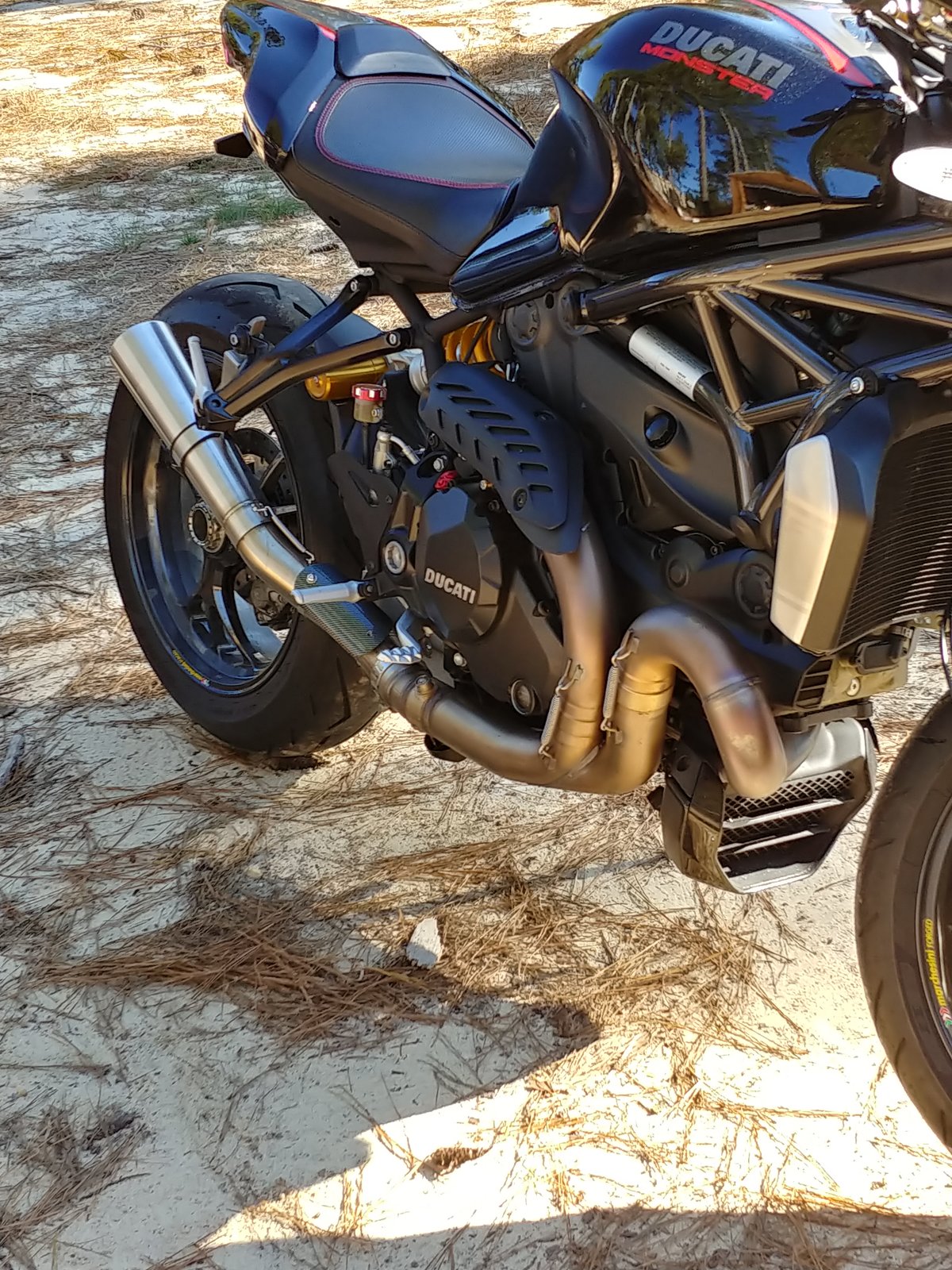

  1. 1128181332_HDR.jpg Installed a Danmoto conical exhaust $260.00 US

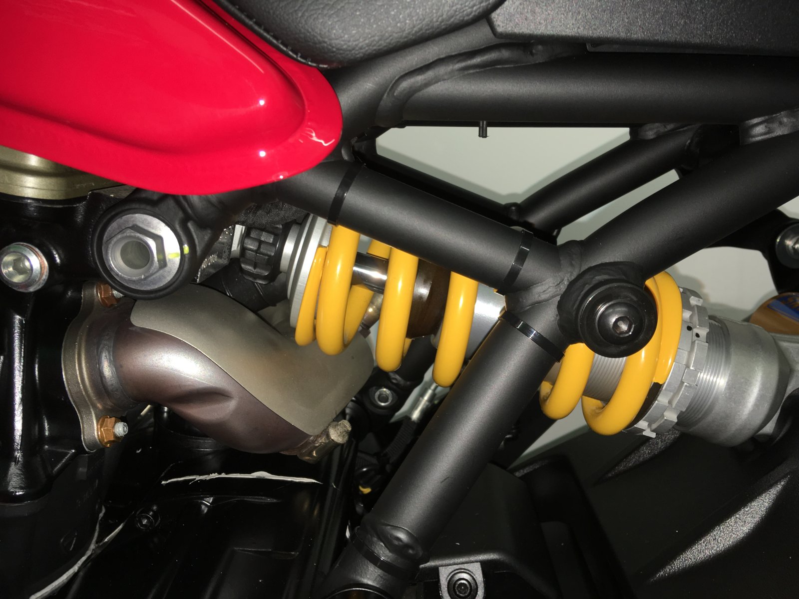

  2. Quickshifter wasn’t difficult but this bit of carbon took the piss!

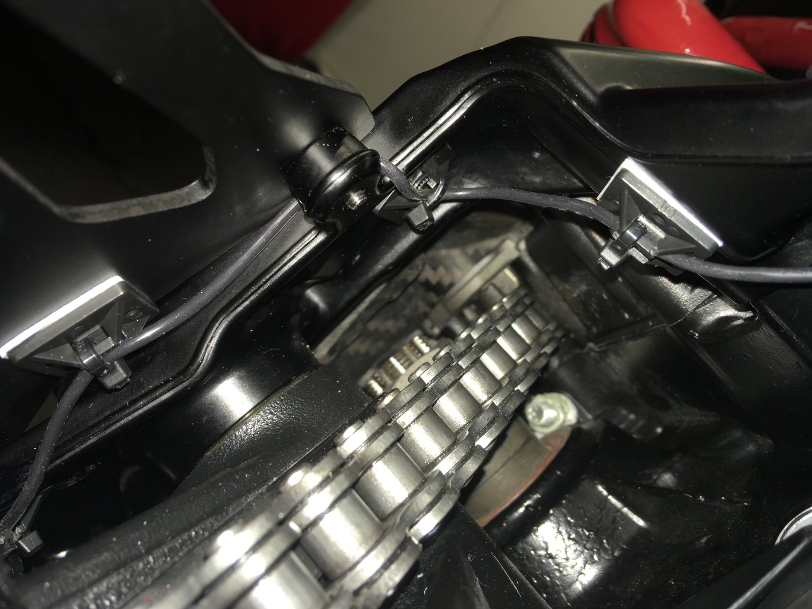

  3. How easy is it to fit the chain guard, looking at the pictures of the part it screws in from the back of the swing arm, remove rear wheel ?
  4. Yeah remove the exhaust and rear wheel
    There’s 2 screws you can get to (one easy and one with a bit of a faff) but the screw at the front is behind the tyre so the wheel has to come off
    Careful not to drop the screw into the hole the swingarm!

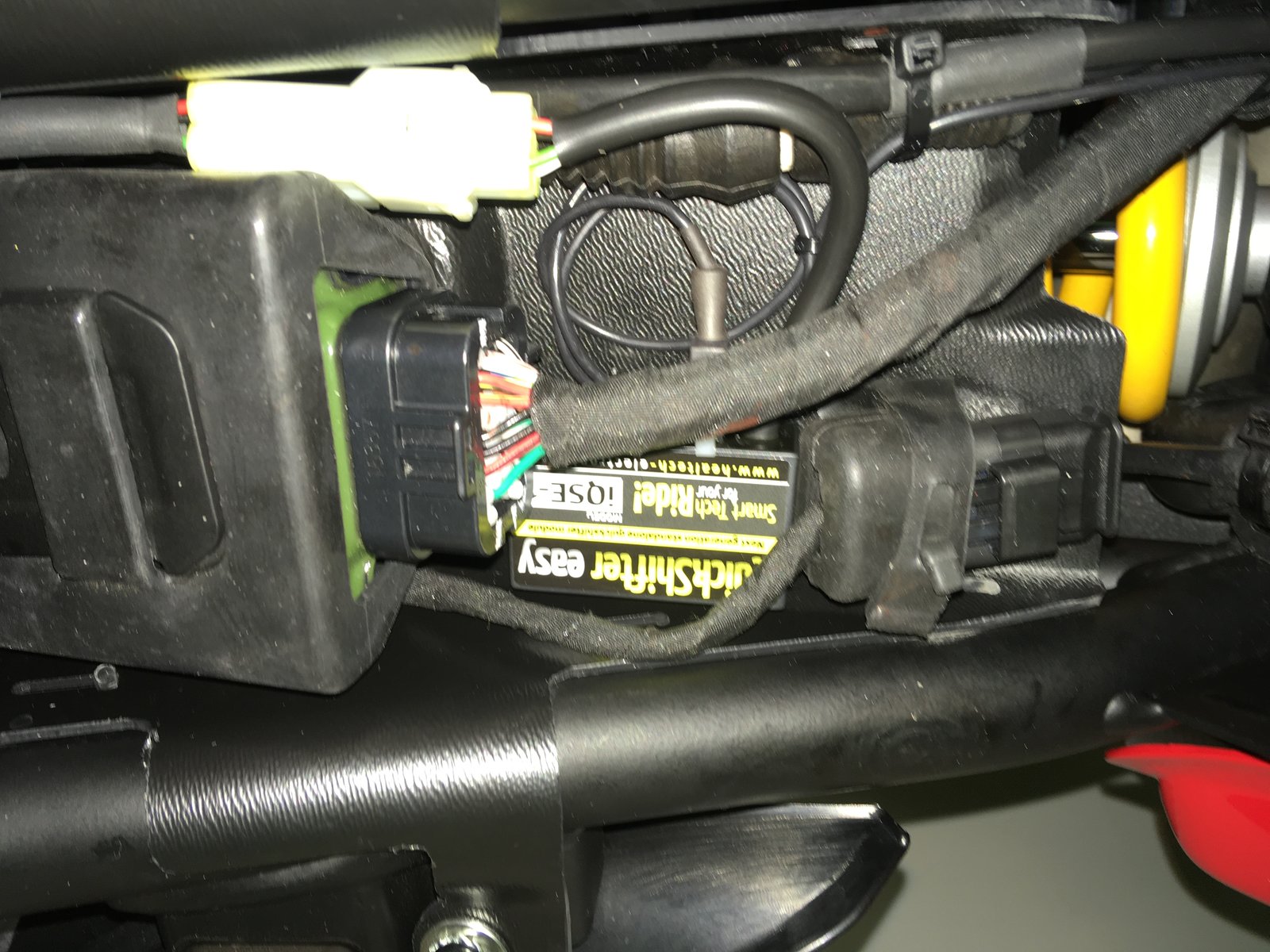

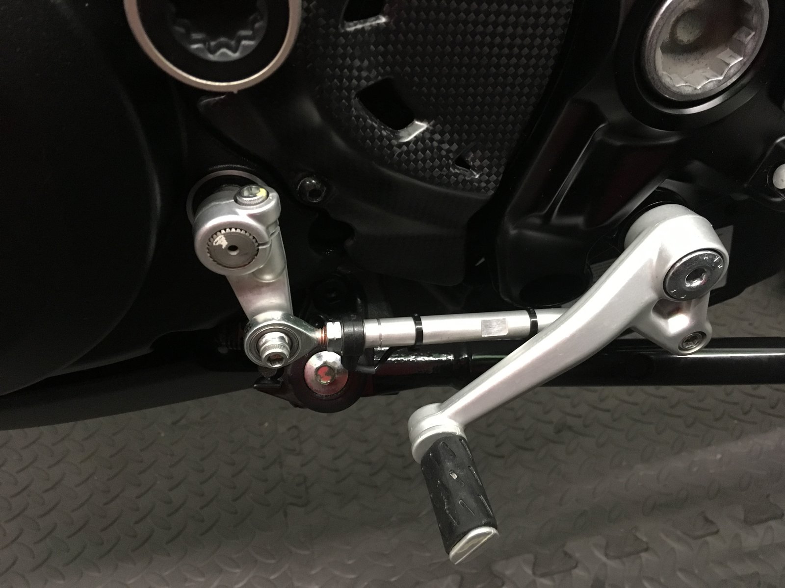

  5. Installed the quickshifter - not sure if it works yet and don’t fancy trying it on a paddock stand!
    Here’s how I routed the wiring
    A1F0CE27-0B12-4CA8-8270-F1FC860ED28D.jpeg 14E0E6E6-C0CE-4E91-A099-FC14D745BCE4.jpeg 37FB5F46-C541-448B-909D-63078E0F3F74.jpeg 3D27B8F2-4765-47A2-90A4-B853C7B67DC9.jpeg
