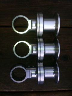

  5. here is the std length and two of the shorter ones that are part of the kit that kyle fits
  6. I see...well this is some very helpful information!
    Thanks!
