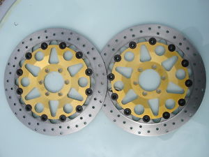

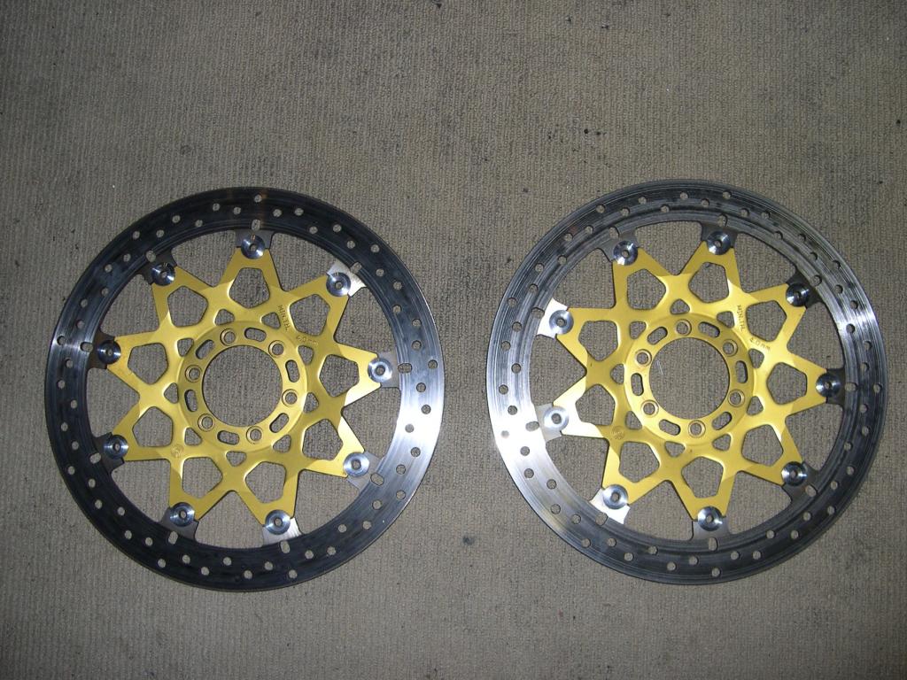

  4. Not sure what those discs are but they are similar to the keyhole discs, which do not float. These are 998 discs, no holes only cross lattice. 998 Discs are not full floaters.
    They look like 748SPS discs which are floating and they are cast iron not steel.
    These are keyhole discs, again non floater.
    And finally cast iron 748SPS discs

  5. Lol..... now im even more confused... mine don't look like any of those. they are floating (to some degree, as there is movement in the bobbins ( or are they just f@#ked!?) I always thought they were standard brembo.. don't know if I seen it stamped or just assumed.... Still need black ones though!!! :)
