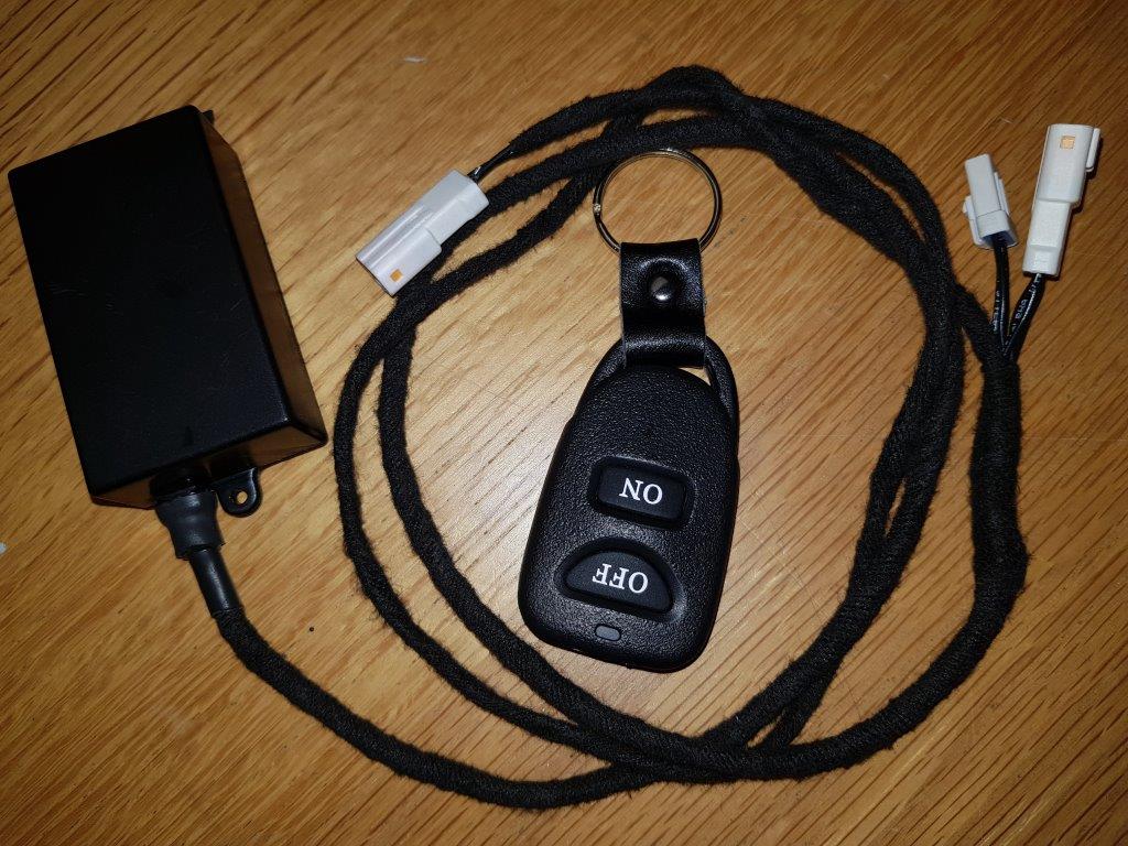

  2. I'm not sure I understand the logic of this modification. The bandit/scumbag/score is big enough to relieve you of your bike, then you stop it within 75m. He then comes back gives you a good hiding, takes your fob as well. Then rides off into the sunset.

  4. Hi the plug is a JST part going under the number 04T-JWPF-VSLE-S, however an unpopulated one of these is fitted into the corresponding socket in GPS accessory loom as means of sealing it off. All you need to do is take the crimped heat shrink off it and use it, you'll just need the crimp pins and the correct crimper, I've loads of pins so if you want some just PM me your details and I'll drop some in the post for you, otherwise you'll have to buy 100!
  5. I see you point, but my reckoning is there's going to be more than one scrote initially but there can only be one riding it away. Hopefully I'll never need it but if that day ever comes at least it's something other than just hoping the tracker doesn't end up in a bush.

  7. I like the idea, and you've done a good job at making something that is easily "un-done" should you want the bike back as stock. Good work!
    Any possibility that the "RF killswitch" could be triggered by an external source (gwad knows how many frequencies are being zapped all over the show), or you bump the fob in your jacket or whatever and the bike dies on you when your riding?
  8. Hi, thank you for your kind words, the receiver uses rolling code encryption so hopefully it won't be triggered by errant signals from elsewhere, I haven't suffered from the fob bring accidentally pressed but never say never! All in for less than a tenner so I'm not complaining!
