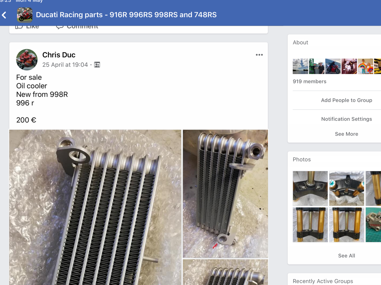

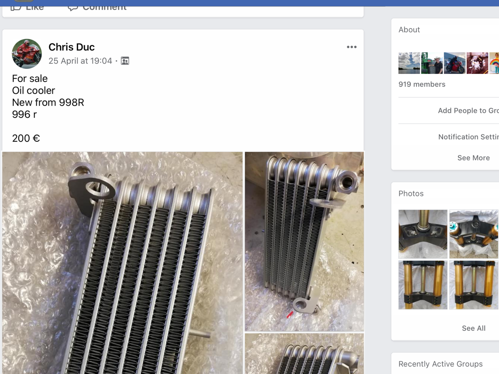

  3. Hi Ben. Don’t know if you’re on Facebook or not. Just seen this.
  4. I avoid facebook but my son is on it.... Do you have some sort of link/address?
  5. It’s looking great mate your doing a superb job... The DF are so proud of you... X
  6. Sorry mate. No idea how to do that but here’s a better photo. Tell him to go to that page. Hope this helps...
  7. Thanks. I will set him on it.
  8. If you struggle, I’ll contact him for you?
