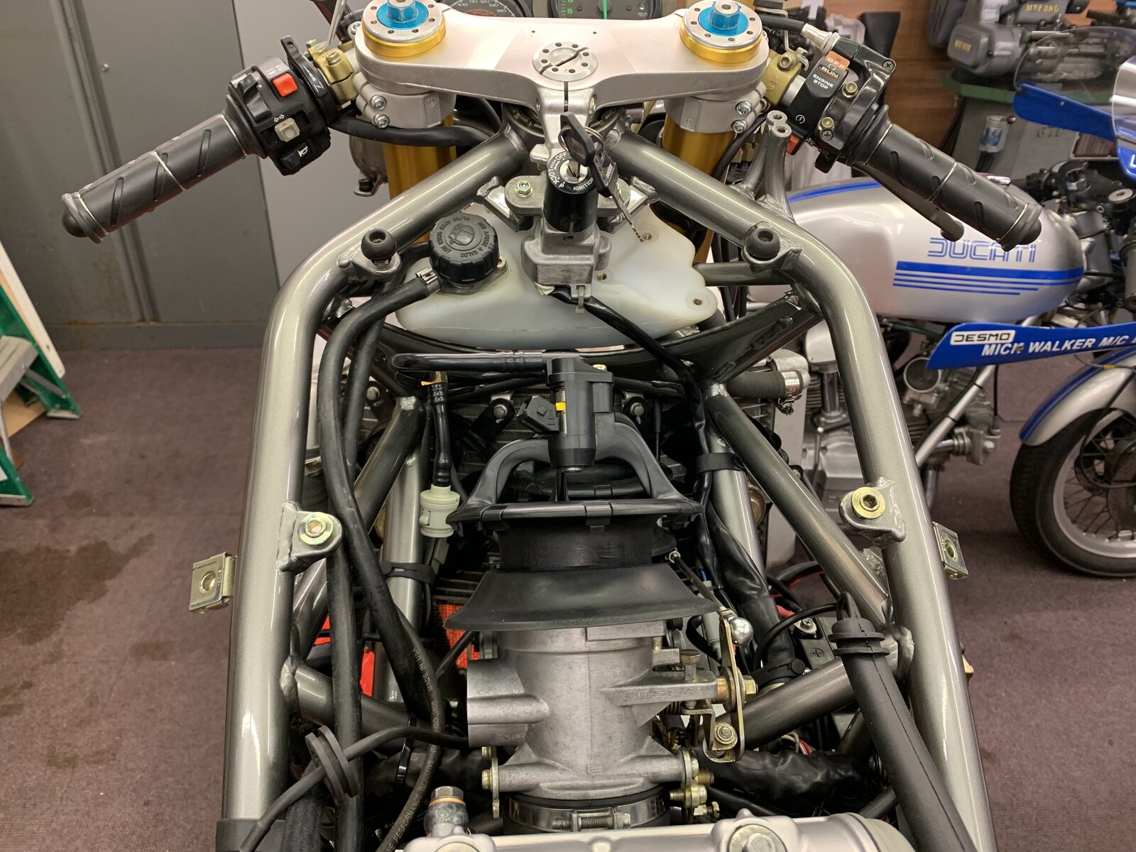

  3. Tried for a first start up yesterday - bit hopeful but although we have spark we do not have fuel. Planning on checking some injector signals and 12 V today with a scope. There are bits of my wiring loom that I have some doubts about too! Also probable that the injectors are jammed up with old fuel and lack of use so plenty to try. Got the tank on facing backwards so all looks un-aerodynamic but allows me to see whats going on!

  8. Well I managed to get the injectors working quite easily without upsetting the household arrangements! But one of the injectors now wants to free flow. Unless there is something stuck on the seat, I think two new injectors are in order. The consequences of hydraulic lock do not bear thinking about.
  9. She runs! All OK.
  10. Right. No oil leaks, no fuel leaks. Noise pad inside airbox disintegrating and there appears to be some wear in the throttle body linkage or the rear spindle bearing.Usual tuning required but in general I am pleasantly surprised. Confident enough to phone the paintshop in the morning to book some work in. This thing made a good noise and no complaints from the neighbours. (Less straightforward when we fired up a GP6 a few years ago after fitting a Motec system). Rest easy guys. I am having some red tonight.

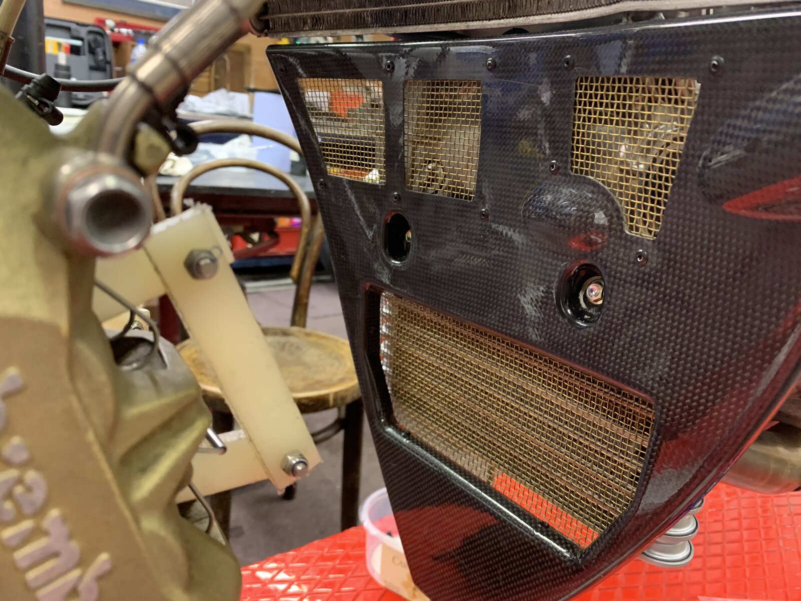

  14. I fitted 998 style fairings to my 916SPS bitsa which had a separate belly pan - I made two sheet ally brackets (one each side) to support the belly pan when the side fairings were removed.
  15. Thanks RickyX. I have opted for a single bolt to hold the belly pan on when side panels are removed. It may not be as standard but it works. The belly pan is so light that a single bolt is fine.

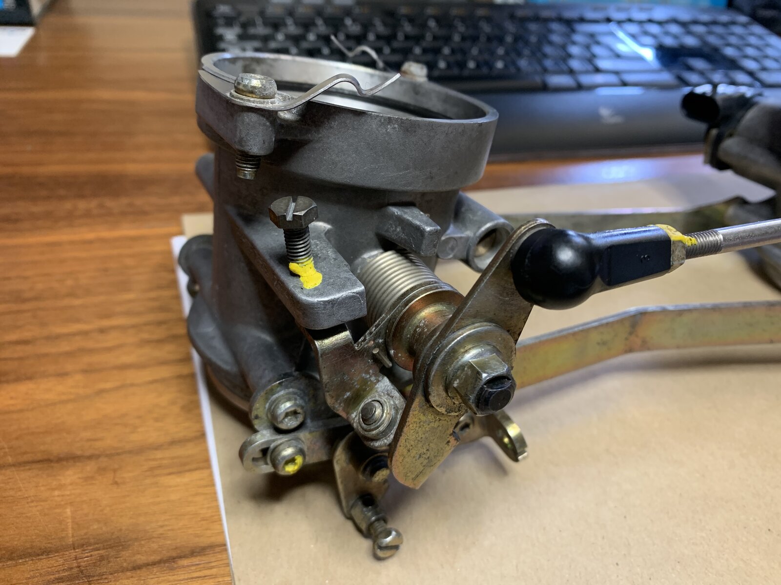

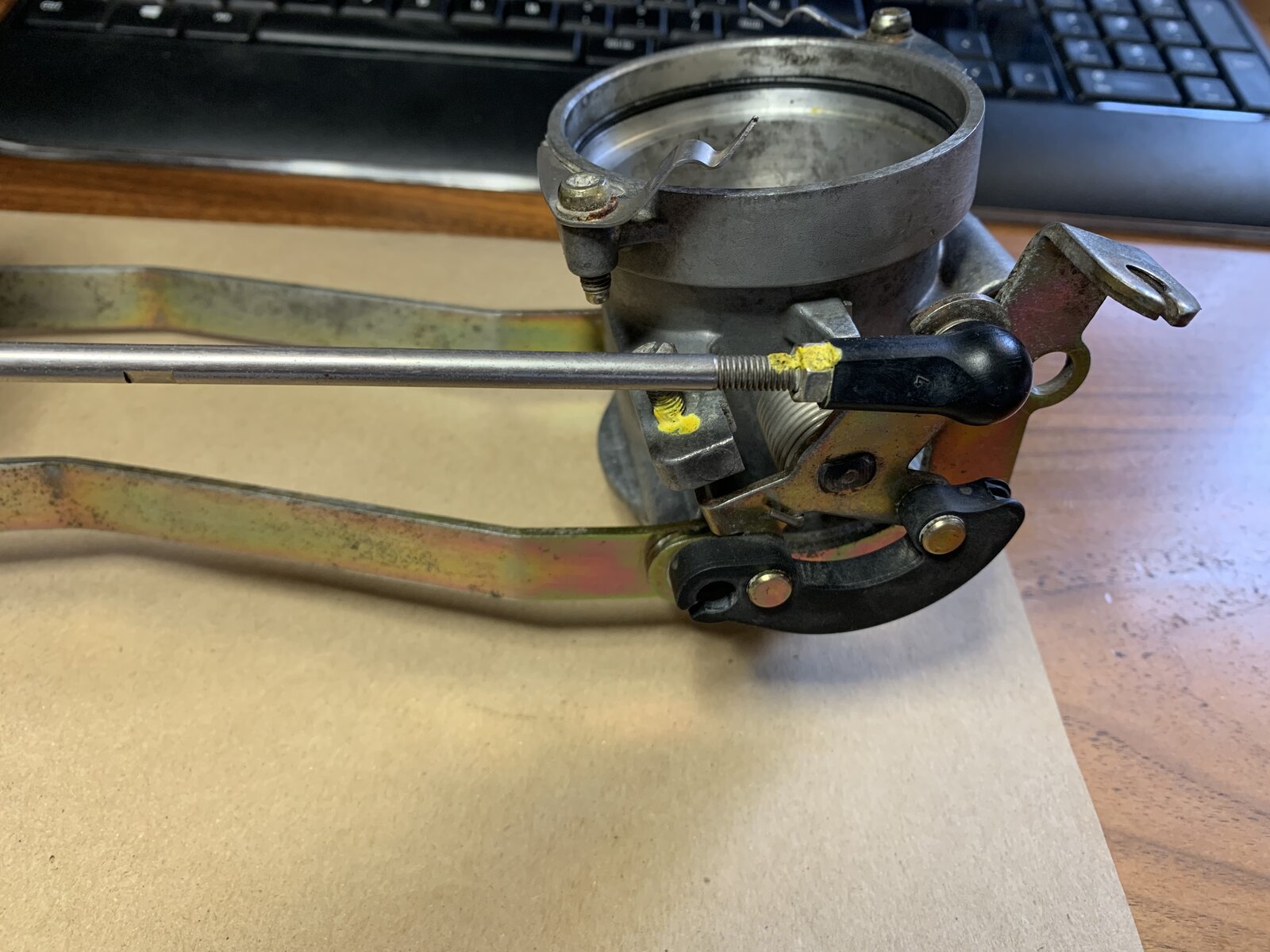

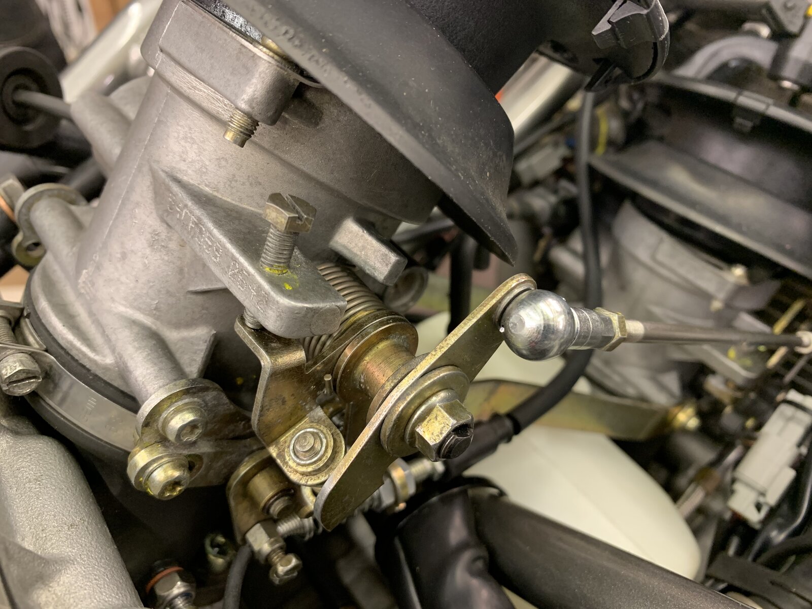

  16. Does anyone know who will have parts for or will overhaul throttle bodied? The plastic socket on the horizontal body linkage is worn and I think the vertical body shaft bearing is worn too. Ducati only have one part number for the whole assembly so I won't be going down that route!
  17. You can replace the ball and plastic socket and go spherical bearing
  18. I am sure the bearings are a standard size and can be replaced.
  19. Spherical bearings would probably be a good idea. Thanks. I have not taken the assembly apart yet so don't know what sort of bearing is on the shaft.
  20. So I have replaced the plastic throttle linkage connectors with steel/nylon ones and that seems much better. There is a bit of wear in the vertical throttle body shaft. There is a sleeve in there which could be machined out and replaced but with some careful adjustment, there is little or no slop. If it proves tricky to set up then that will be the course of action. Everything including the tank is in the paint shop now so won't be able to run again for a couple of weeks. So on with the small bits that need tidying. Airbox noise panels, steering damper, etc etc. As always suggestions are always welcome but bear in mind that this is not a down to the washer rebuild. Its for practicality and usability.
