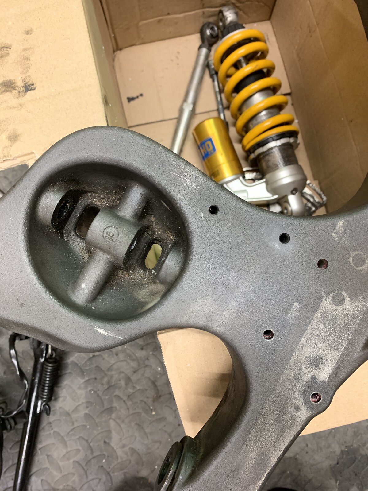

  7. Just an update. For those who are ever in my boat.
    Decided to take some bits off today that I’m going to get powder coated.

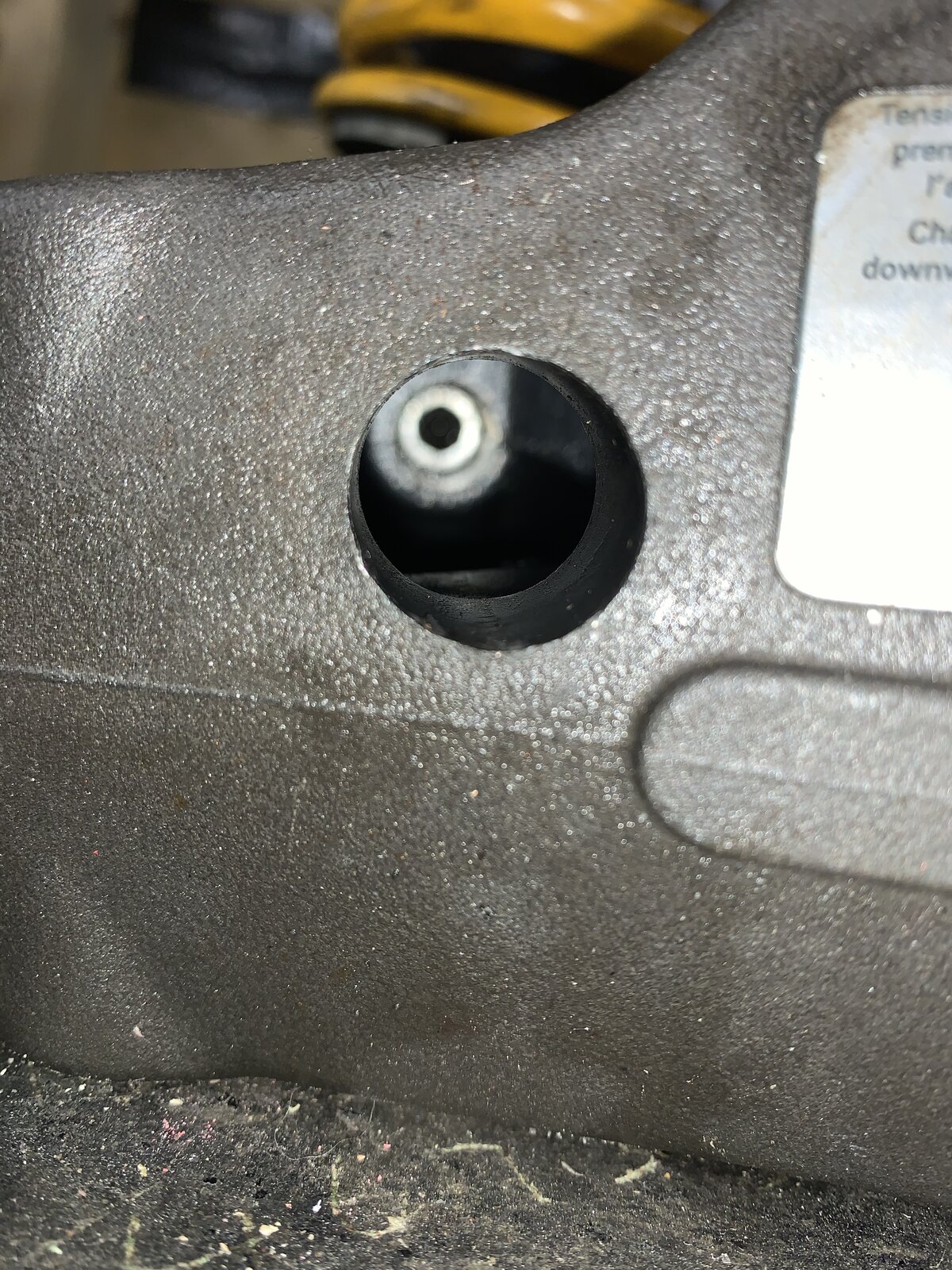

    Started stripping the swinging arm down. Everything has been a breeze to take apart up until now. But the bolt inside the swinging arm that holds the shock and link is never coming out. The threaded nut on the side that’s not recessed came off with no trouble at all. From what I’ve read and seen ( cheers lamb chop ) the bolt should then tap through. Mine won’t even turn!! So it looks like this is a no go as there is no way of even cutting it to release the shock. I’d be happy to source a new bolt and do this but I can’t see how it could be done. Boooo
  8. This bastard has put a spanner in the works!
  9. Try putting the nut back on half way & whacking it, wd 40 every where, hot air gun the region too.
  10. I’m a bit worried about hammering it to hard in case it fractures the swing arm.
  11. Very unlikely, remember your hitting the bolt along its axis trying to shear the corrosion, it'll go.
  12. IT WORKED!! Your a star mate! I literally broke 2 extension bars trying to turn it to free it up! Now the next hurdle is getting the bearings out the pivot end. :weary_face::weary_face:

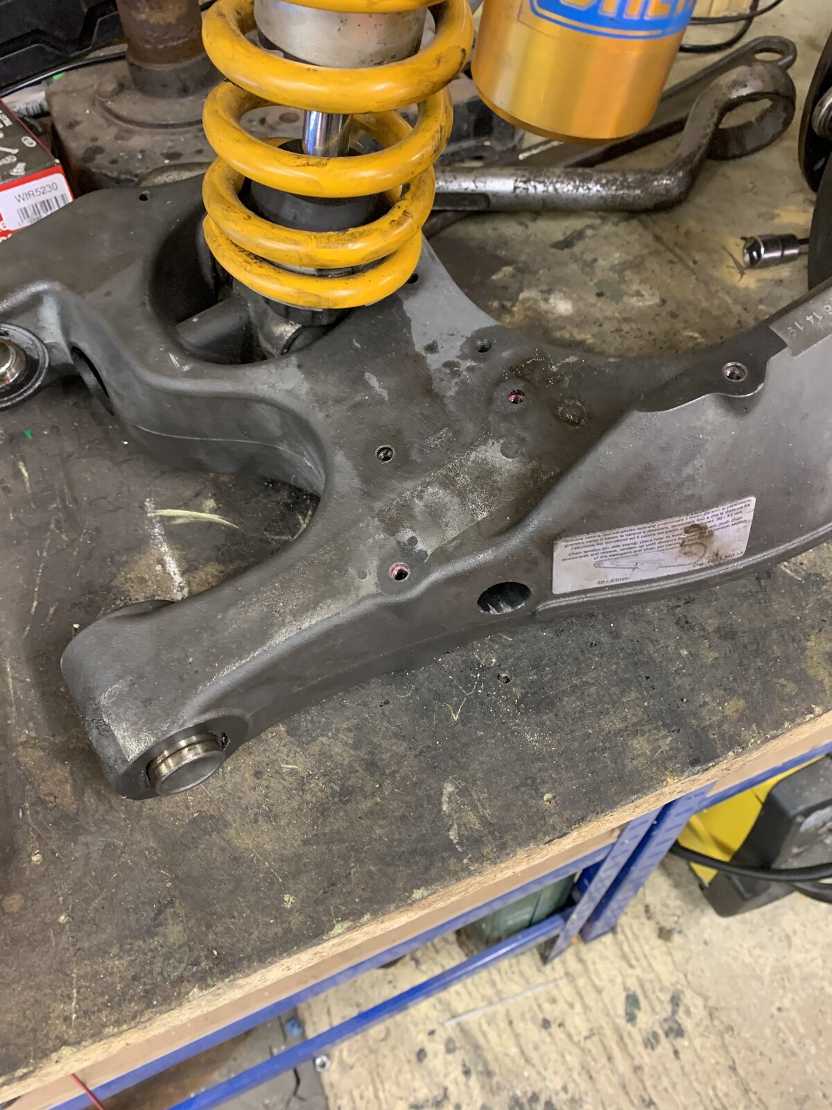

  14. After a lot of thought I’ve decided to swerve the swing arm powder coating idea. All the bearings and bushes in mine are like brand new and think it’s just going to be a waste of time and more so money to go this route.
    I will however have a good clean and re grease everything. Also as I’ve now removed the shock I have removed the spring. I’m looking at either having this powder coated yellow again as the original powder coat has flaked in places. Or maybe a new replacement??
  15. If its apart and the spring isnt right for you then get another one otherwise get it recoated...i would say....
  16. Oh yeah - something to note....when you put the shock back in the swingarm theres a gap inside...be really careful as if you loose the bolt in there - thats it....its gone....ill happily admit....ive done this...
  17. I noted this as I watched one of Chops vids the other day. He mentions you Confy , saying that you gave him this tip. He made a point of being very careful so it stuck in my head. Guess what happened though lol. Lost the extension bar in there. Luckily when I took the hub out I managed to shake it out
