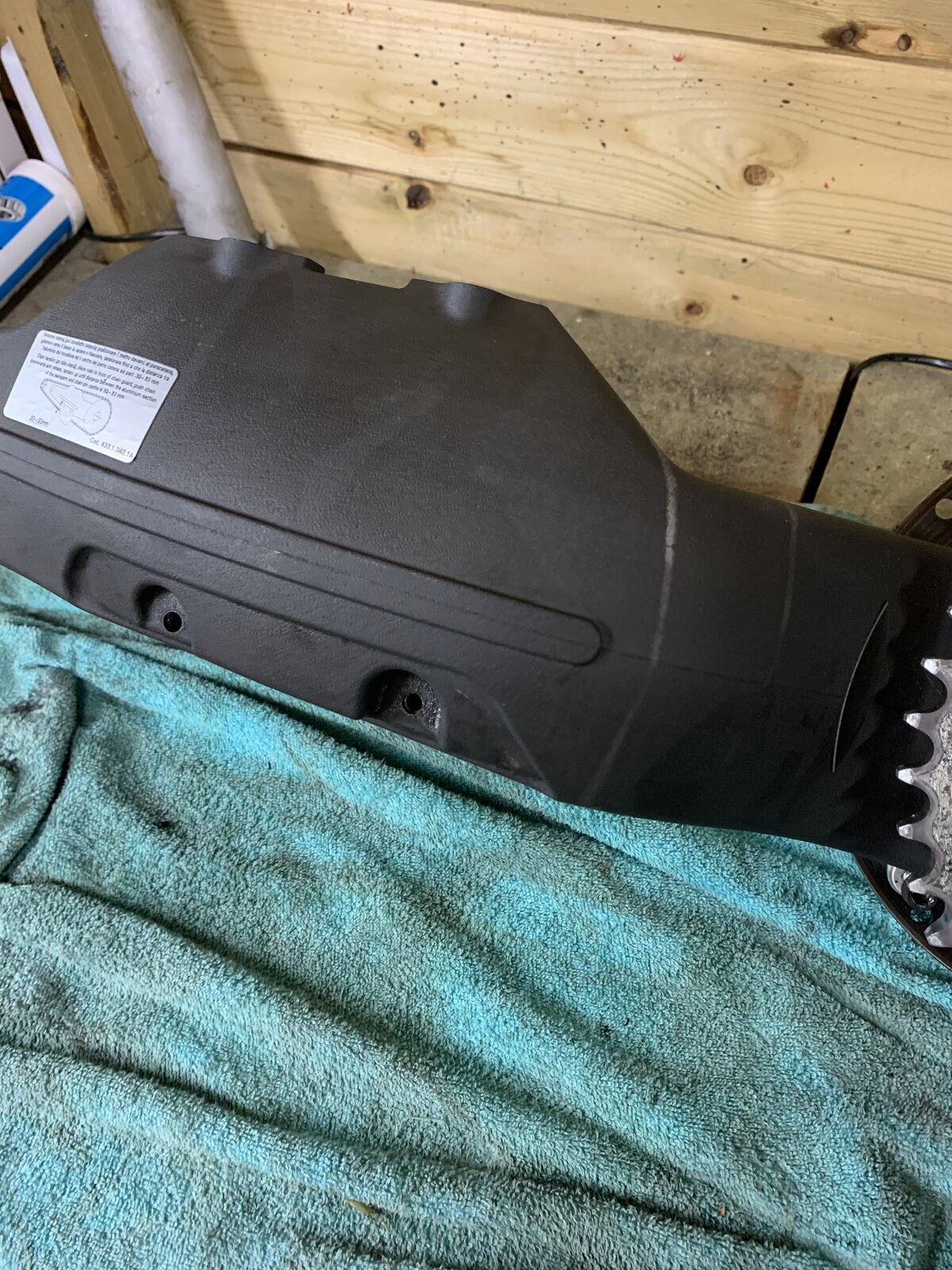

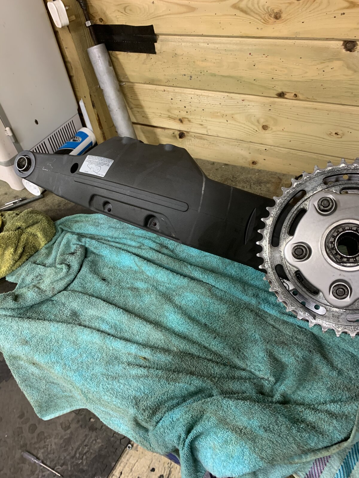

  1. Give your comments please fellas. As bearings are in tip top condition I’m not going to go to the lengths of replacing them but still toying with having the swing arm sprayed. Only prob is it’s textured. It’s got a couple of stain lines but I’m thinking of just putting it all back together and getting a carbon swing arm cover. Let me know what you think
  2. I would leave that well alone and pop it back together, looks ok to me.
  3. Satin carbon cover is best.
  4. Cheers guys. Think I’ll just re greas all the bits up and re fit it and keep my eye out for a carbon cover in the future.

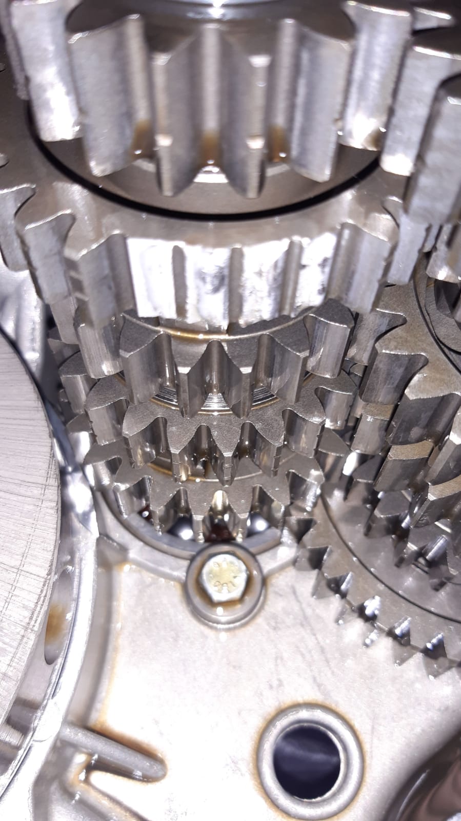

  5. Bit of an update. Spoke to Simon at Race engineering today. He started stripping the engine on the 19th as promise and the culprit is 4 teeth stripped off one of the gears. As well as the rebuild the plans are to have the heads ported while they’re off. I’d really like to put race cams in but I’m not willing to cough up the amount of money they’re going for new. Spoke to loads of people with mixed reviews on going for a lightened flywheel so not sure about this yet. Balanced crank is on the list though. Then to keep cost down but performance up I think I’m going to go for the mwr filter that replaces the top of the air box. Definitely plans for some other little bits while it’s all apart like the ceramic bearing for gear shift etc ( cheers comfy ) but yet to get a final costing for the engine work. Watch this space.
  6. The culprit that’s going to cost me a fortune
