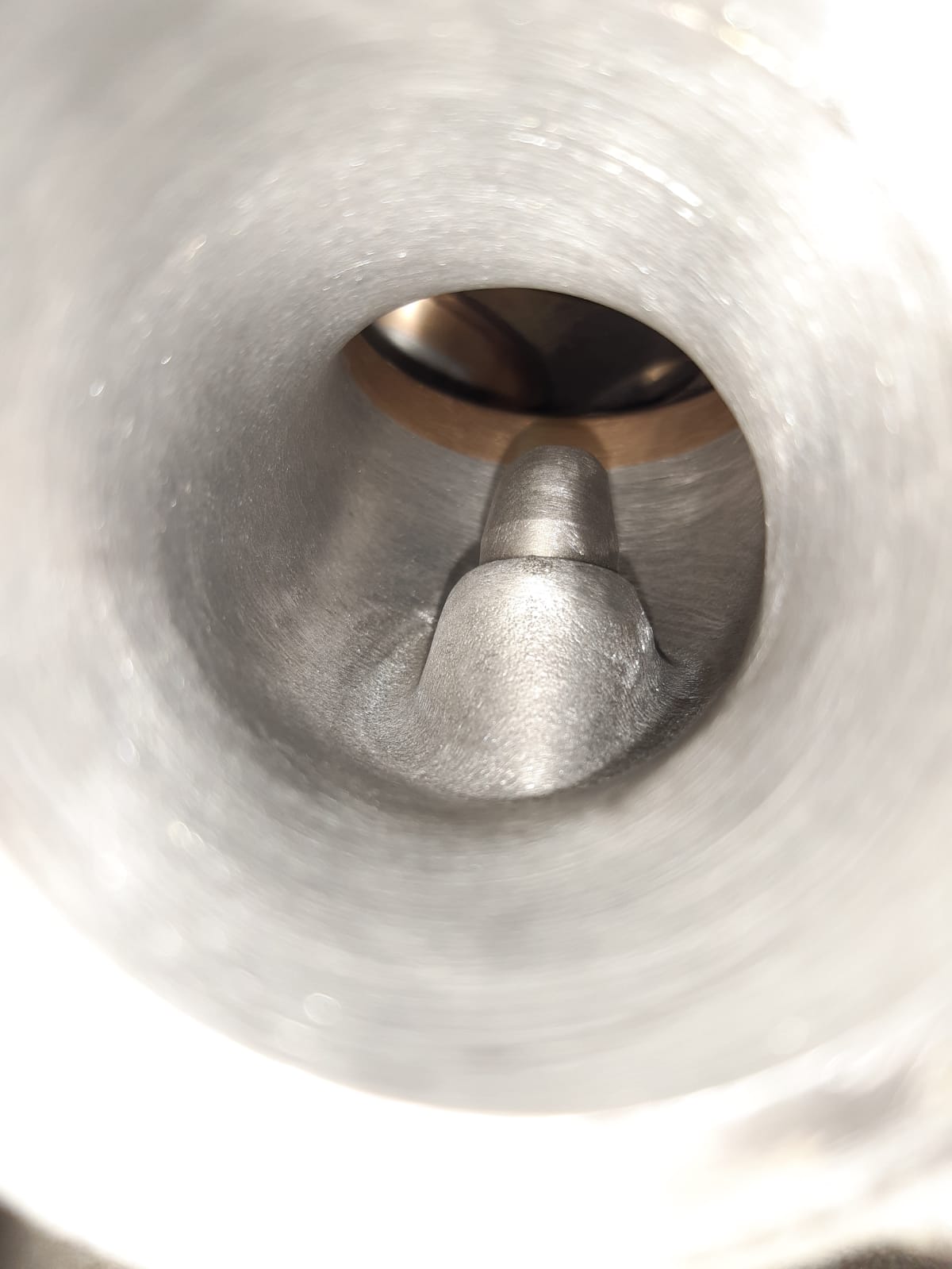

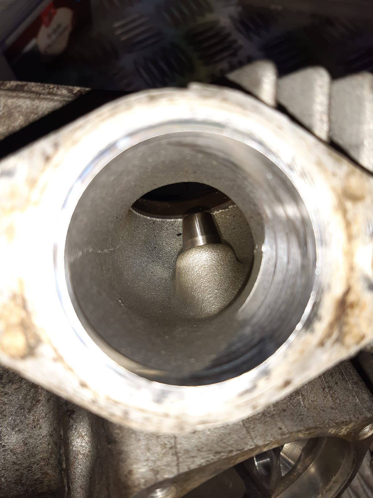

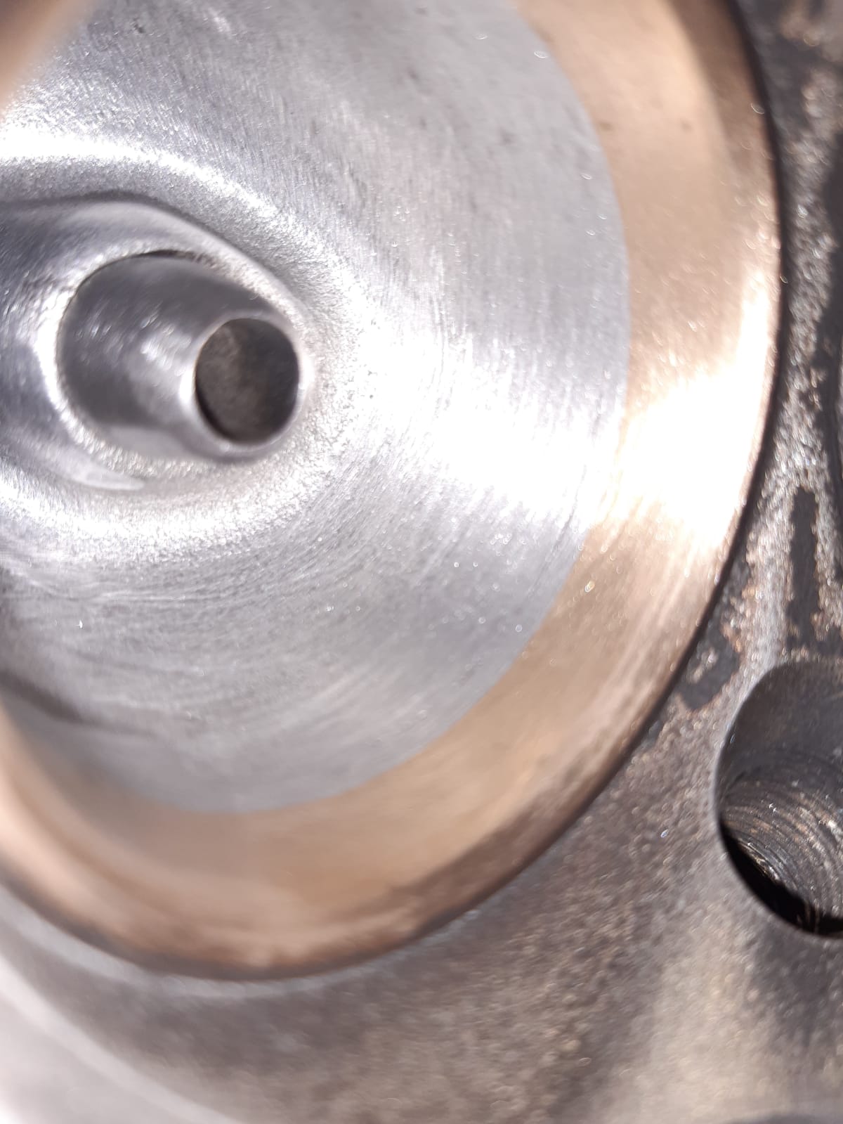

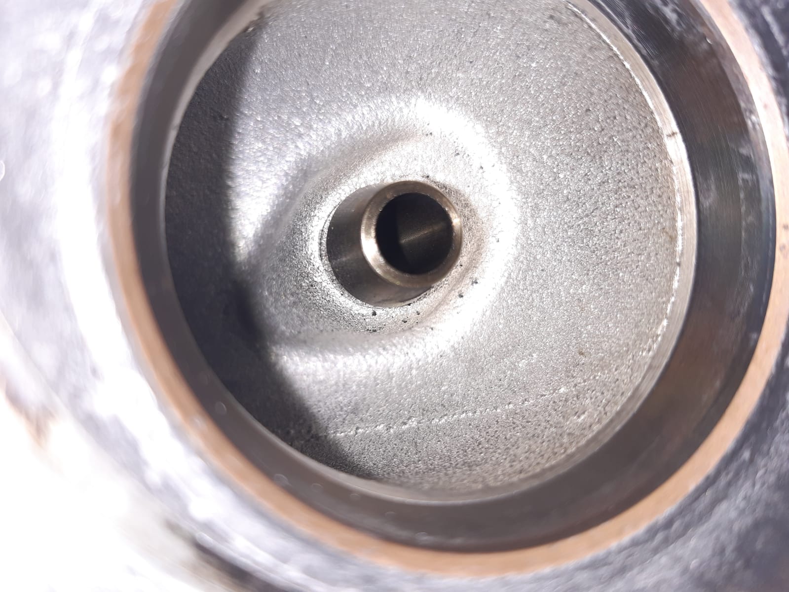

  14. F2460D0E-7D37-459B-93B2-7DD36DE6C7A9.jpeg A65DC9F6-D109-4491-BDA6-4E5857F62028.jpeg 09731F73-0971-4340-A05A-12A6B5D808AD.jpeg ED2F72B1-1447-4DF3-9AF2-E31EA782A2CD.jpeg Some pics of the gas flowing for anyone who cares lol
