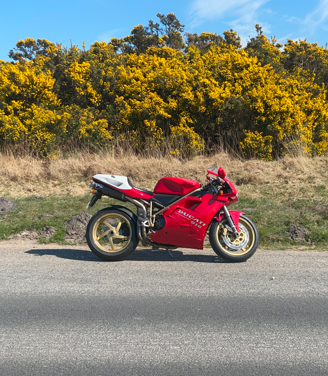

    Finally got it Mot'd and on the road, put a couple hundred miles on it today to get used to the way it rides.
    I think that's more than its done in the last 13 years.
    #24 Ti-Tech, Apr 2, 2025
  5. Well done im very happy its being used and cared for!

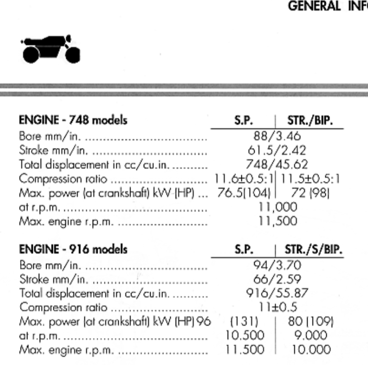

  8. Looking at the workshop manual tells us that the stock 916 Strada/biposto engine redlines at 10.000 rpm (with max hp reached at 9000). Make that 11.500 for the SP (max power at 10.500). 12D87D67-22DB-4BDE-8B19-703B06A67414.jpeg
    I definitely would not want/need to rev a stock 916 engine above that, personally. Firstly because you only lose power past the peak rpm, secondly (and most importantly) because that would drastically reduce engine life…
    PS: You look at %CO when tuning idle mixture on an engine with a gas meter, not CO2. Alternatively, you can mesure the AFR (air fuel ratio) with an O2 sensor.

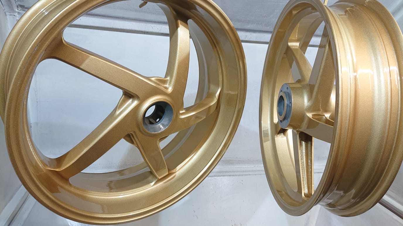

  9. This could very well be the best ever result on a repainted gold Marchesini magnesium wheel I've personally seen. This is truly indistinguishable from the original paint code. Top job
  10. Thanks for this information, I won’t be doing anything to it personally it’ll be going in to a shop and I’m sure they would tell me the same.
    I’m happy with 10,000 rpm either way but it certainly doesn’t feel like a mechanical limit when you’re pushing on.
    Feels like it cuts fuel at 10,000 to me.
    I’m not mechanically minded so the Co to co2 must have been me misunderstanding the tech I spoke to.
    It’s more the pops and bangs on the overrun that I’m not sure is right.

  15. Yeah I’m happy with the wheels; they’re as good as I could hope for.
    It’s going to be the frame/headlamp frame colour to match up next, that bronze is apparently quite a difficult colour to get right.
    #35 Ti-Tech, Apr 3, 2025
