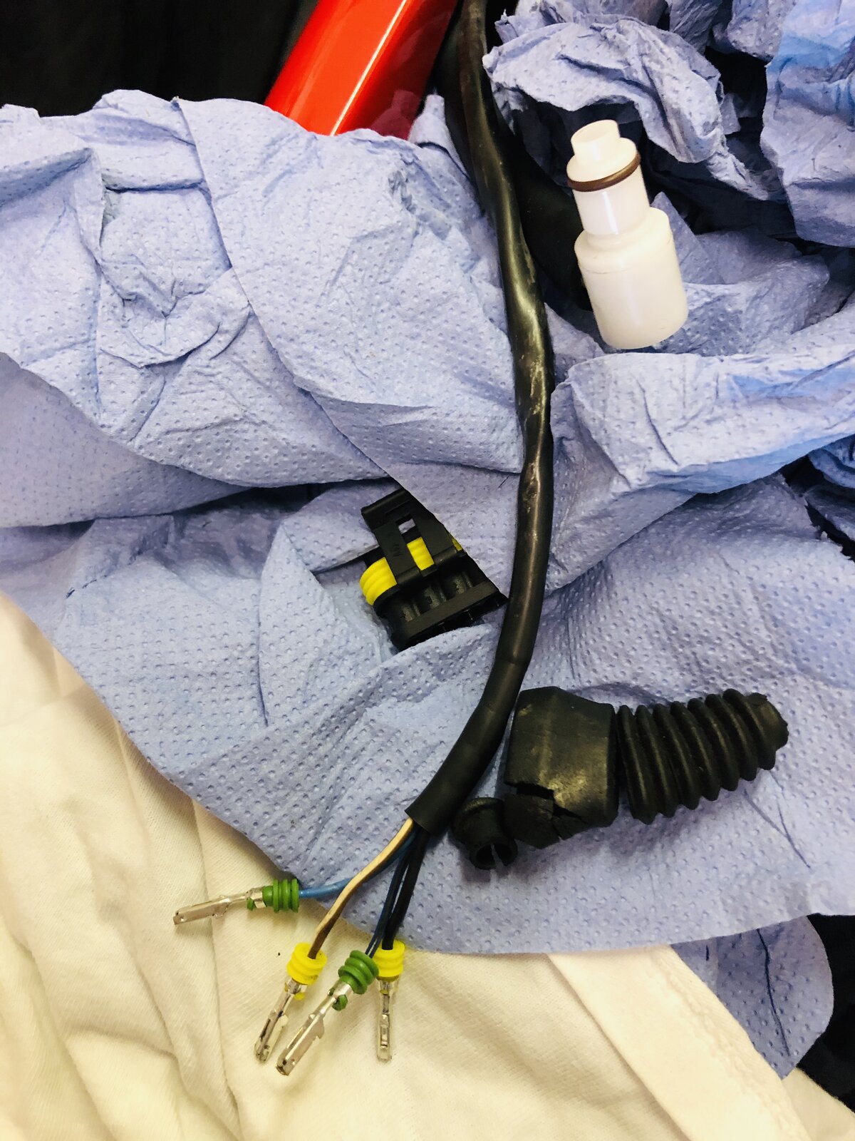

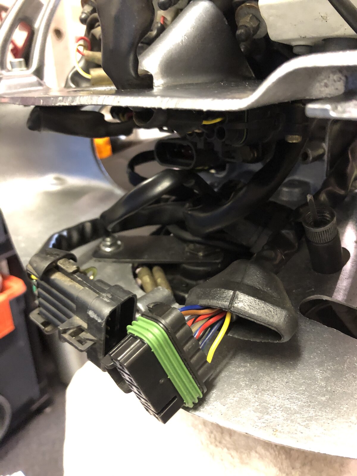

  2. Doing this today.....
    Replacing knackered rubber boots on connectors.
    Patience, patience, patience....
    Nothing much else to do tbh:mask:

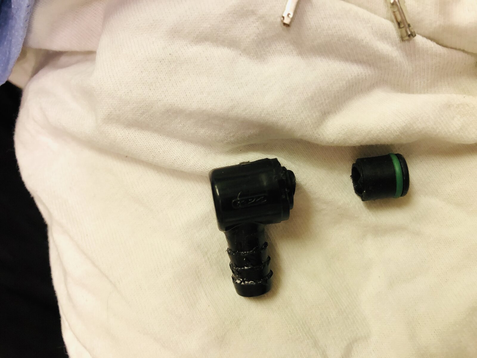

  3. Took tank off today and the male quick Release coupling snapped, brittle as.
    Fortunately I had bought a replacement pack.
    Also replaced another connector boot.
    Perished.

  7. Bob, did you replace the boot on the atmospheric pressure sensor on the rhs of the header tank by the steering damper. That one allows water into the sensor connector when the rubber is perished and the water will sit around the connector pins causing odd running and cutting out issues particularly when it is hot. The reason it is turned back on itself and then tied that way is it is a known issue. Separate the plug and have a look in the socket and you will see where the water sits.
    • Useful Useful x 2
  8. Apparently the 998 doesn’t have one on the coolant reservoir with a bit of researching on the tinterweb.
    I did wonder what the three holes were for though:thinkingface:
  9. Ha Ha, a better solution than bodging the electrical connector wiring I think

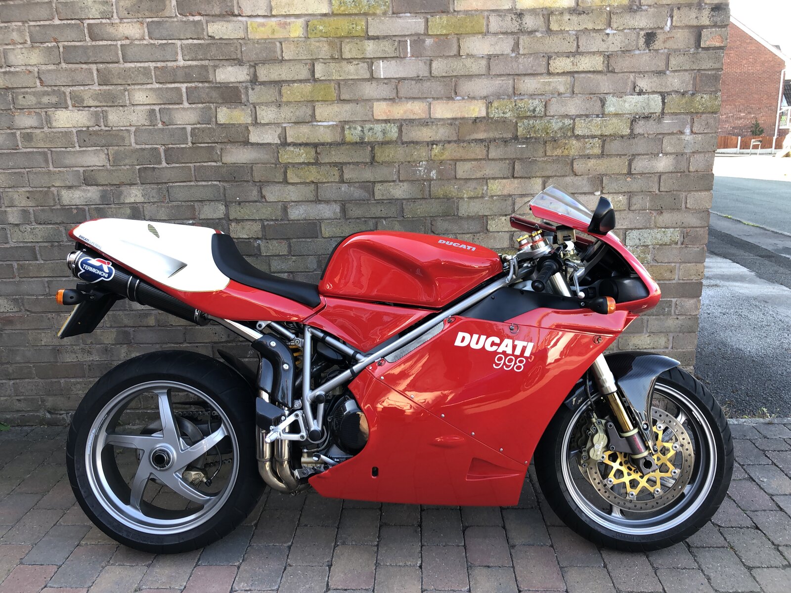

  10. Wow!... she looks amazing mte.. you’ve done such a quality job... WD
    is it not an S then? I know from OP it was a BiPo, not sure perhaps they only made S models in mono postos ??
    X
  11. Thanks
    Its a Biposto but I've managed to get hold of a Monoseat for it whilst on lockdown and then the spending begano_O

  15. Hello were do you get your couplings from thanks Anthony
  16. Try @Exige on here, iirc he supplies them and there’s a Forum discount for subscribers.
  17. I’m out of stock of males, I have plenty of females :bucktooth:
    in fact I have 2 male connectors left too but not listed on EBay :upyeah:
    Metal ones are worth the extra though imho
