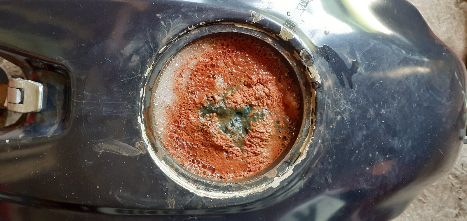

    Anyway the fuel tank is not as good as it looks and I thought. Put the phone just inside and took a photo to look at the side of the tank and it's nasty and crusty:- 20240613_100607.jpg
    And that is not good at all! So have put 2 litre of bleach in then a handful of screw and and a handful of nails the added hot water sealed the top with silver duct tape and given it a shake around not letting it sit a while and see if it helps. Fingers crossed but if this doesn't work then we may have to look into getting something like Por-15 kit and that means it will be July before we can even think of putting this back together. Plus of course now have the hassle of getting those nails ans crews out of the tank.

    Any way I added a litre of bleach some hot water and somenails and screws after sealing the opening with duct tape gave it good shake around then left it to sit for a bit before moving it so it lay on the other side and repeated the shaking. After a while gave it another go and the duct tape let go .......... wasa bit hopeful expectimg t stay sealed I suppose, so emptied it and then with much shaking and finally reaching in to get the last srews and nails out took a look inside and YES they had scoured the scale off the sides so a rinse out then set it up for another round of electrolysis with the scale off the liquid can get to the metal underneath. This time I added about 1 litre of bleach and emptied the rest from the bag of Bicarb powder filled the tank to teh brim with this mixture and connected it all up and have just been out to see how we are doing and there is a lot of horrid rusty scum floating in the filler hole so it's working.
    Now we just wait.

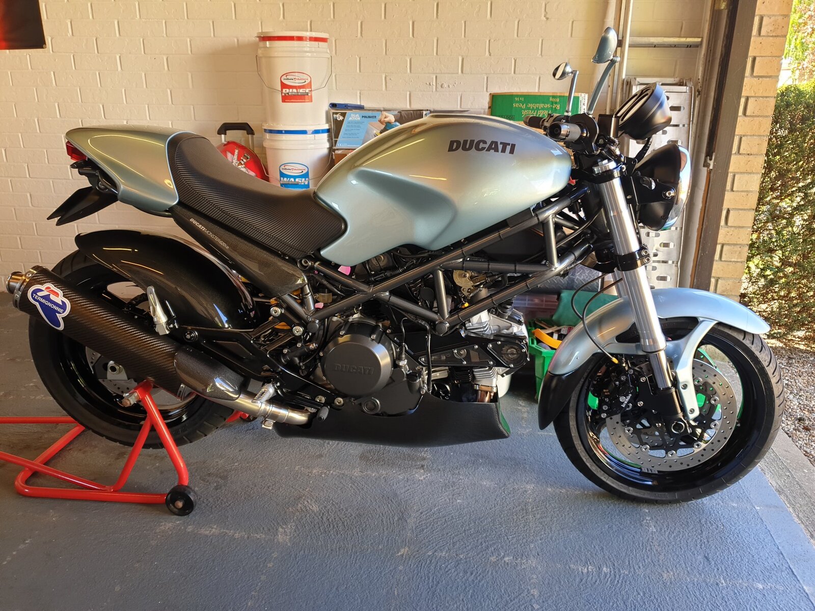

  4. My wife has a 2003 Monster 620ie, but that came with a plastic tank (thankfully hers has not suffered from any swelling as some tanks occasionally do). Would that not be an option if you can't get rid of the rust in your tank? Here's her bike which I restored a few years ago.
    Very nice normally am not a fan of silver on cars and bikes but that does look very nice indeed and looking at the gloss on the rear tyre/mud guard think mine may have to go gloss too I have to take it off anyway as there is a crack in it that requires fixing and tempting as it is to go with a nice Bright colour like Yellow (I love yellow on bikes) guess it might be better to just keep it boring black and that little belly fairing looks good. Surprised at no instrument binicle fairing though. . The tank on mine was made 29/08/01 accordng the stamp underneath it :-

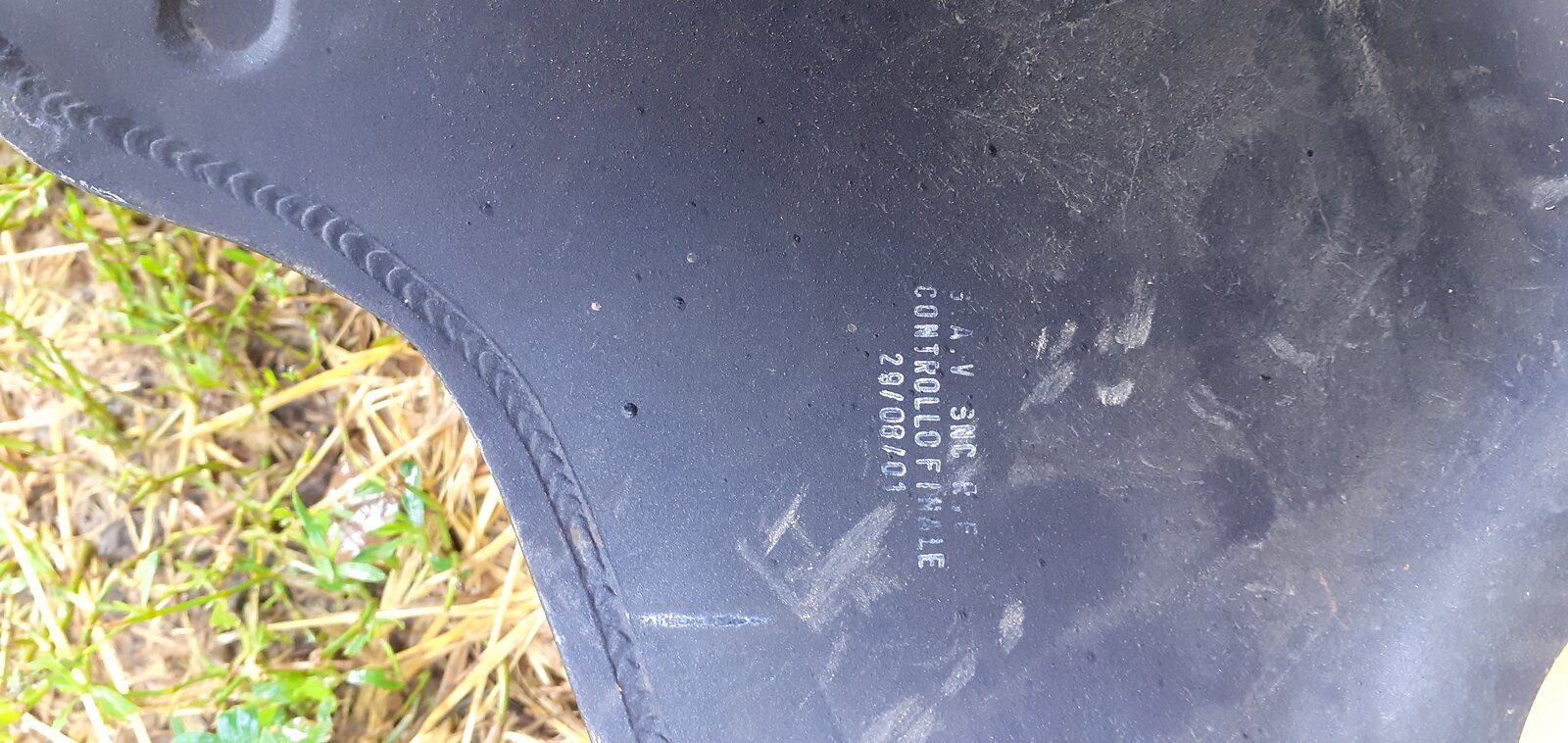

    Now the issue we are are having with getting another tank is threefold:-
    1) Plastic tanks mount differently the pivot at the rear is in a different place.
    2) The fuel pump is totally different as is the level sensor I beleive.
    3) the filler cap is different I think you will find
    None of those are unsolvable this biggest thing is that vendors never seem to offer a complete tank all that I have seen are missing pump, level sensor and filler so not only are the tank shells expensive they become almos ruinous once you buy the missing parts just the plastic tanks fuel pump if you can find a good used one that is are expensive new well the ones have seen advertised are damn near 45% of what I paid for teh whole bike a totally new tank is more than 1 1/2 times what the bike cost.
    In the meantime my tank was drained of the fluid and then had heat applise with an electric heat gun to fry it out inside fully then the insides were liberally sprayed with WD40 and it swished around to make sure all surfaces were coated this will hopefully hinder or stop new rust forming while we sort out hoses and a possible sealer treatment.
    I currently have enquiries out with a couple of Itailian spares places about a replacement tank there is anice looking tank for sale here but of course it's an earlier one for a carburated bike not a FI one so won't fit the several FI ones ahve seen on ebay are all damamged in some way and would need repair and repainting to make they usable.
  8. Oh well it appears that fuel tanks for this year 620ie do not exist in the wild might as well go searching for Rocking Horse Poo! So the Po5-15 route seems to be what we will have to do and thinking on this it means that the steel lines inside the tank will have to capped off to stop the sealer from ..... well sealing them up.
    Have found a supplier for submersible hose in the UK on ebay and one that WILL ship a Por-15 motorcycle tank kit out of the UK also on ebay............ many it seems will not. So have made up an ebay order that include a new tank seal to replace the perished on on mine and a new door mirror adjusting module to replaced the seized and broken on on the sportscar. Despite this being a part used on multiple makes and models it seem the motor factors cannot order one here :astonished: but they sure know how to load prices though.
    Fitting a plastic tank although it sounds like a good solution is a nightmare as none of the tanks that I have found for sale are complete plus the mounting is different and as yet have not found the plastic tank mount for sale used neither have I found the plastic tank fuel pump and level sensor for sale used the only one have found was at a new spare place in Holland or Germany and they wanted just shy of 900 euro for the pump. So somehow have to make this steel rusty tank work.

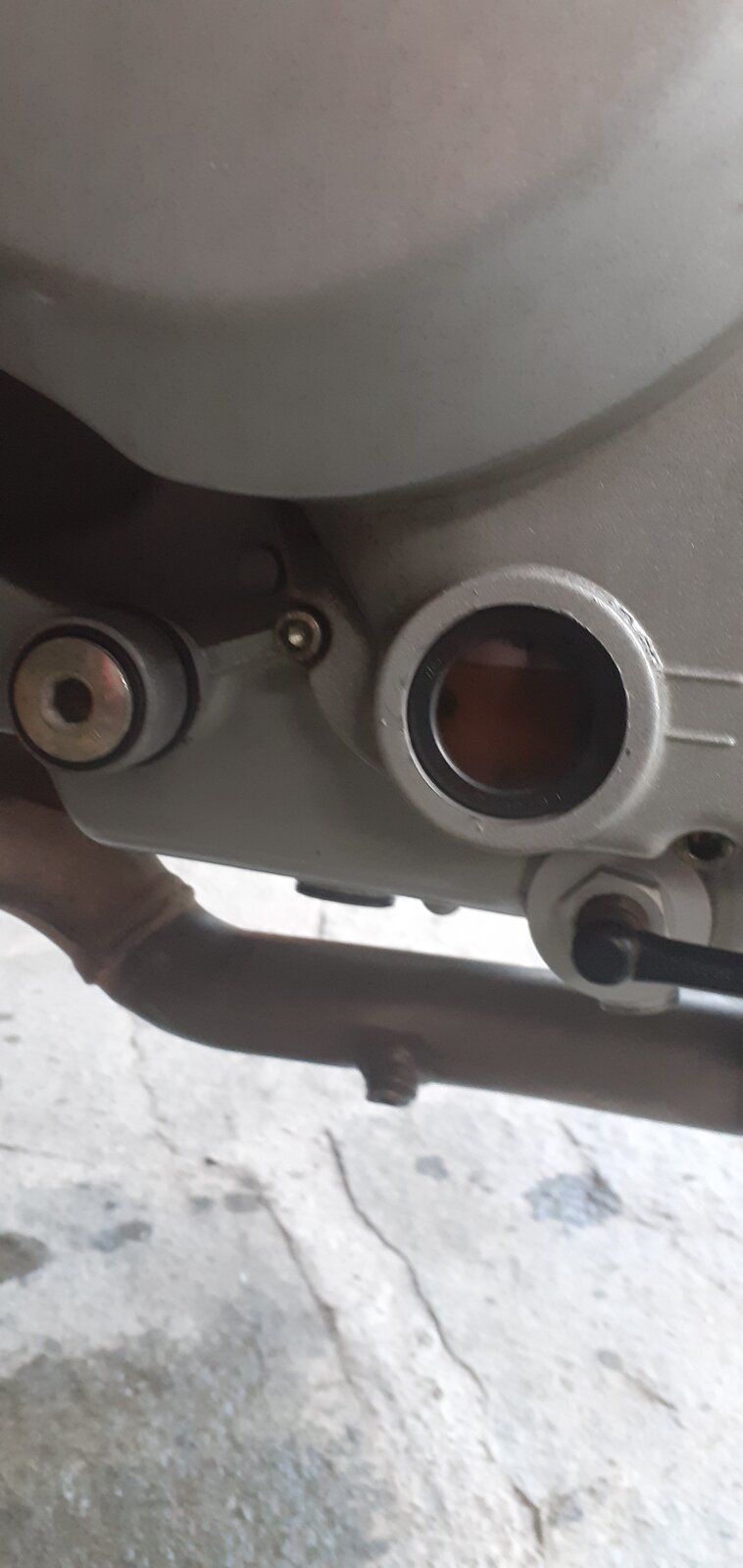

  11. So this afternoon did the oil change on the Monster and did my usual of priming the oil filter before putting it on. Looking online found various amounts of oil required so using an old but clean coolant bottle of 1.5 litre capacity put 2.5 litres (1.25L twice bottle had a clear strip with capacity markings) into the engine then once it settled started engine to circulate it then shut her down and checked level it was low not surprisingly so added another 0.5 litre and repeated the fire up shut down and check proceedure. Resulting in level too high as silly me forgot to allow for the primed filter :( : unamused:.
    So had to drain a bit out .....ho-hum what fun:-
    Level is now near the top mark mind you this with bike vertical not on the side stand but the rear is raised up as it's on a paddock stand. Also re-bled the rear brake and adjusted the brake pedal to suit my sitting position and the rear brake feels much more solid now. Had flushed through old fluid with new the other day but it still felt a little spongy hence the redo today.

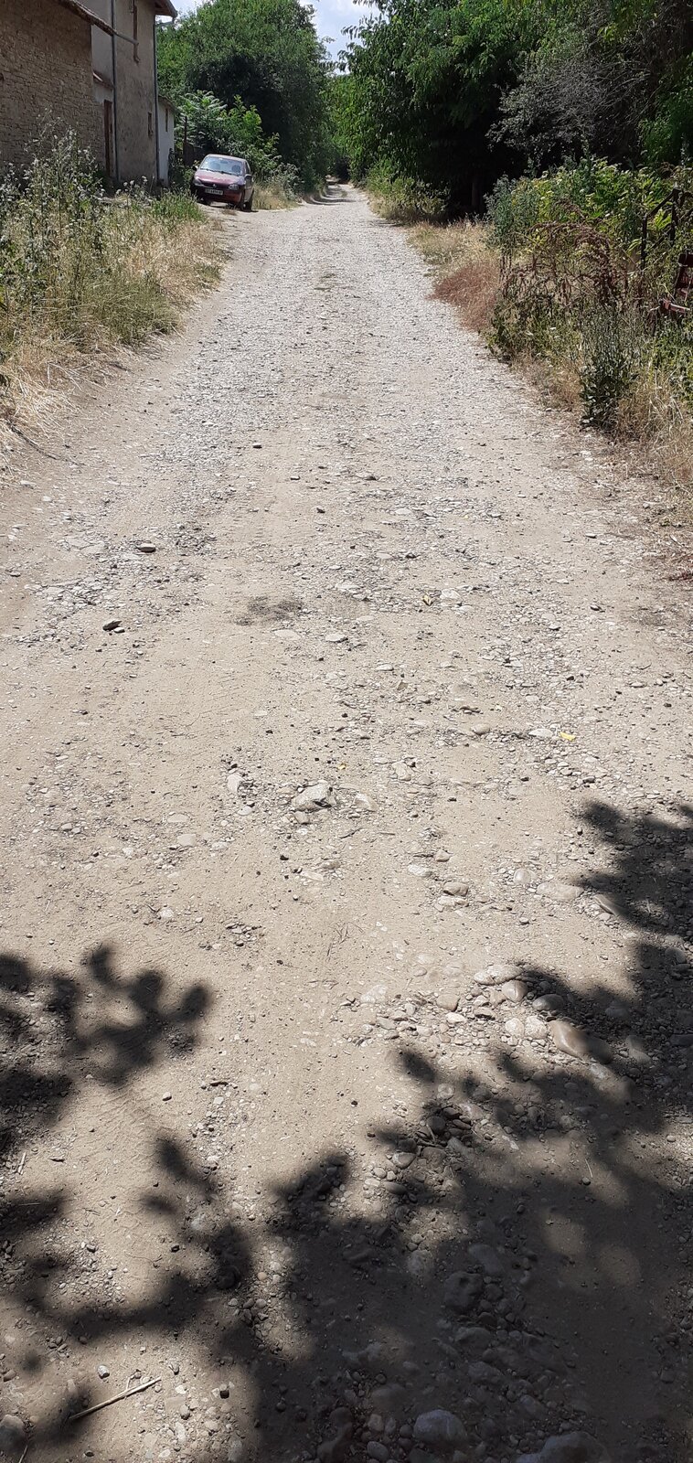

    The line of painted tyres marks the start of the loose stone track that leads up the hill to the proper metalled road there is another stone road to the right out of shot this is like the Roman roads large stones laid down and is a right bonshaker. The blue gates/doors are one of our neighbours.
    We keep this bit of the common mowed and as you can see it's fairly wooded the tree behind the Monster is a Walnut they are very common here along with Mulberry and Harvest Plum. Anyway I was using this mowed area to practice my slow speed riding skills and turns including U-Turns and tight turns and I felt much more comfortable today the rear brake was not much better so I rode back and forth doing turns either end of the run and braking hard with he rear to slow for the turn and after a few the brake started to improve and we even got it to satrt locking up on the grass it needed bedding back in. I had adjusted the brake pedal free play as you really had to push it a long way down to get any effect at all which was not good at all. In all we did around 2 miles in all practicing today in this small area and will do some more tomorrow as need to check how much improvement there is since I altered the steering stops the turn was very limited but the handle bars came nowhere near the tank so decided to open up the lock to allow more movement side to side the handlebars are not the originals and are wider I believe and not comfortable for me cannot wait until the new longer hydraulic lines arrive with the new low touring bars that are about 4" high with a slight pull back.
