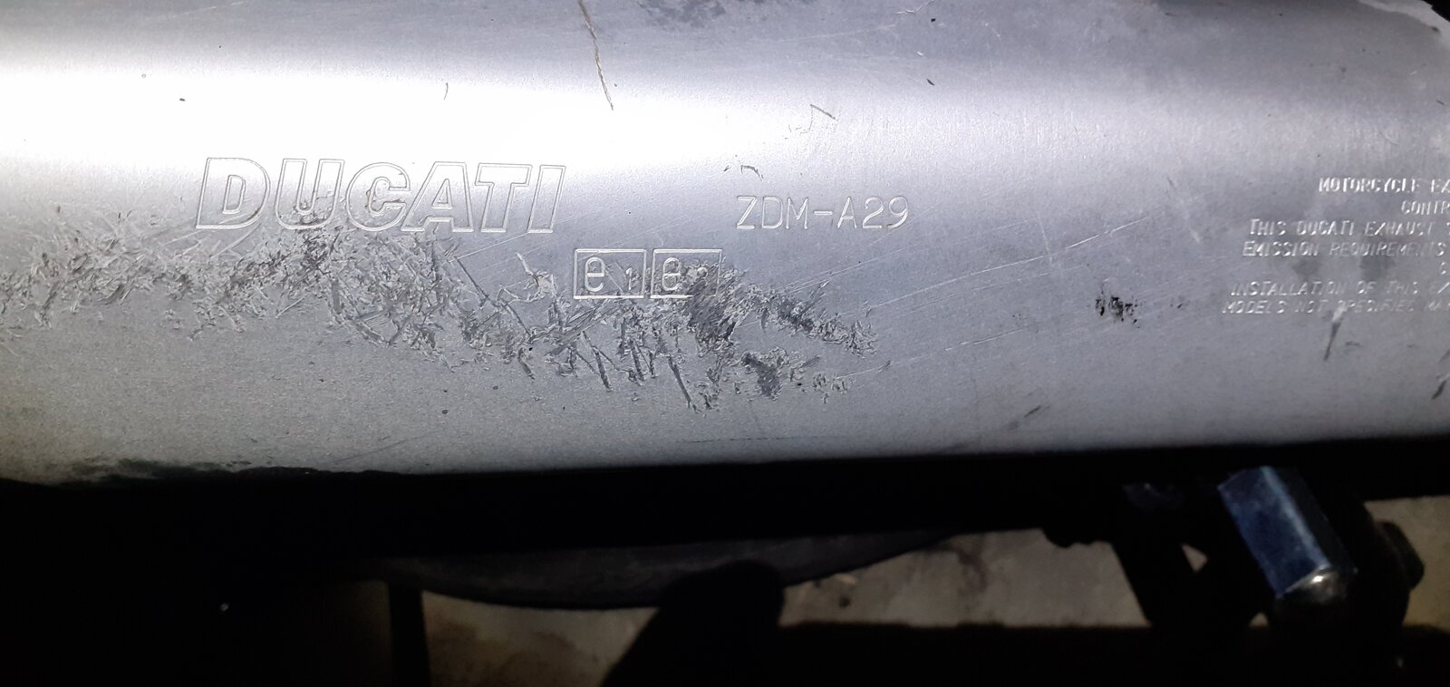

  11. Well I knew this had issues to be fixed mainly the petrol tank and the rust in it which I have resolved. The dent in the tank from the left hand switch gear hitting the tank when it was dropped have filled the scrapeson the front muguard and coloured it with areosol paint that will be re-painted along with the tank and rear fender/mudguard. Fitted new clutch lever and handle bars cannot do much about the scrapes on the silencer.
    Not much I can do about those except change the silencer really
