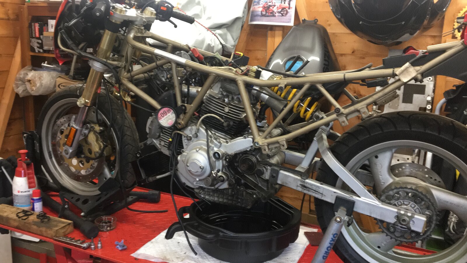

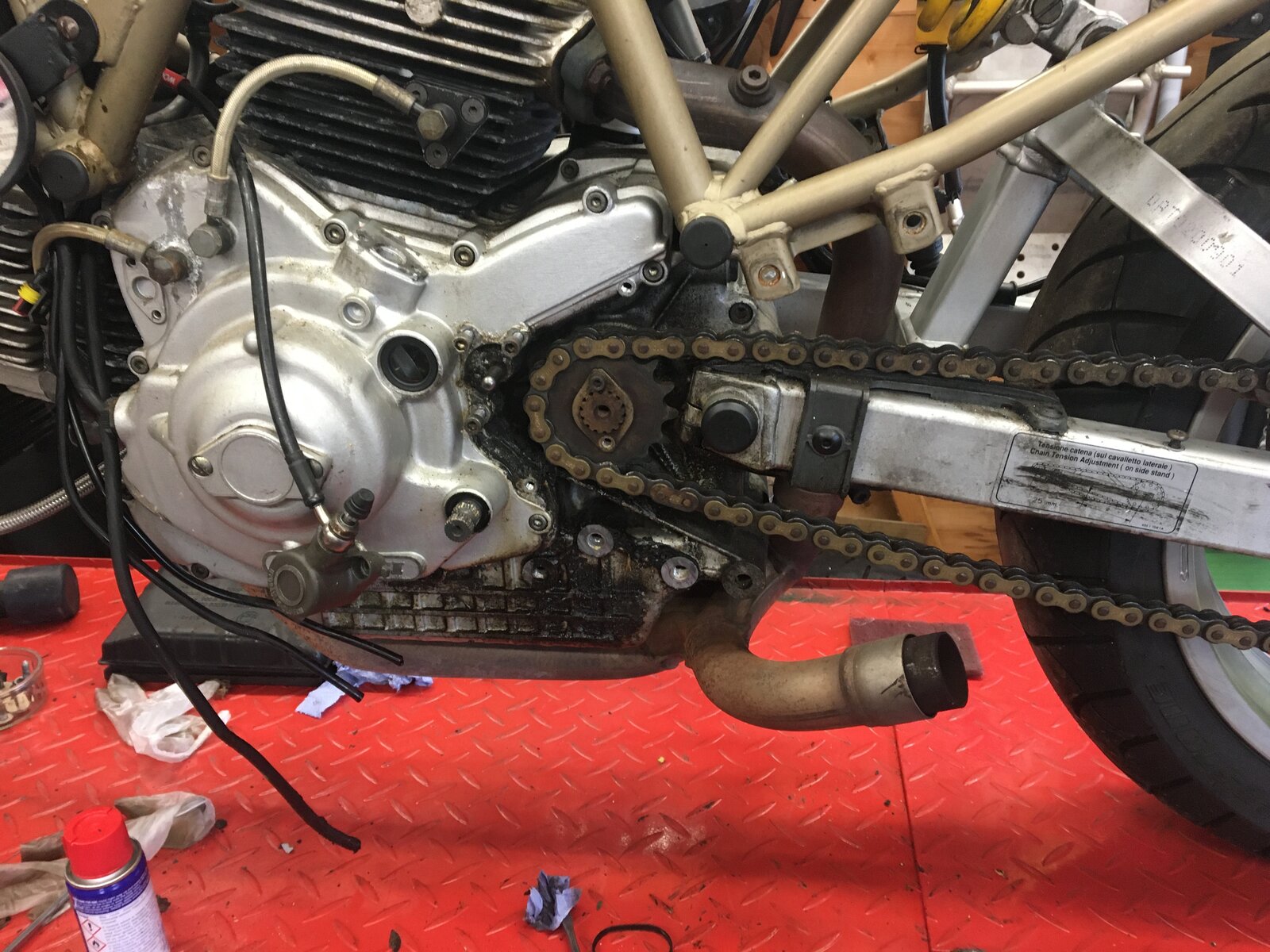

  1. Today's update; I've decided to take the frame off as recommended by you.
    I've drained the oil and it's clearly not been run much since it was put in, so no tell-tale signs of any problems.
    Exhausts system off, Carbs next. It's filthy, but nothing that can't be sorted (yet) :).

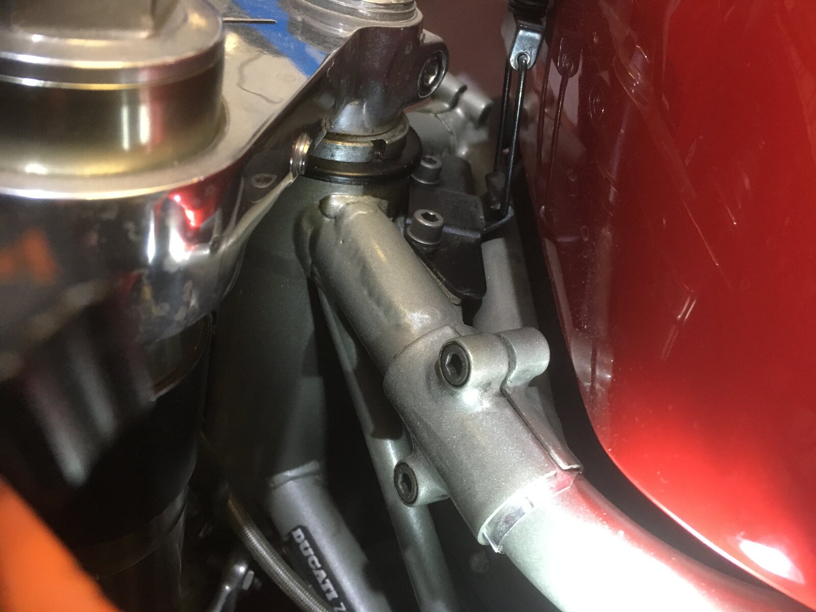

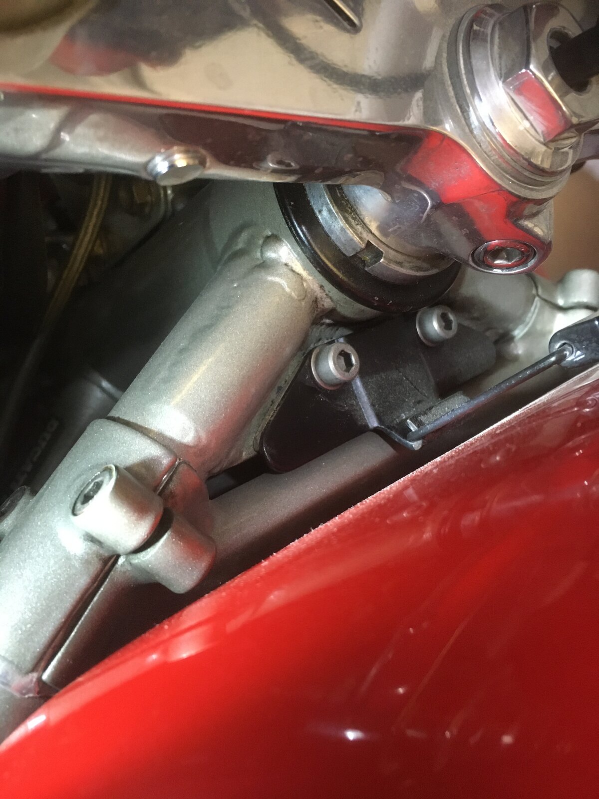

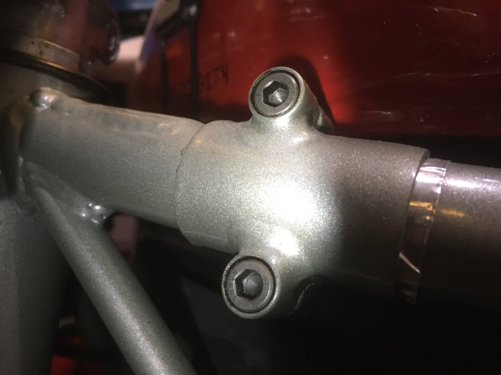

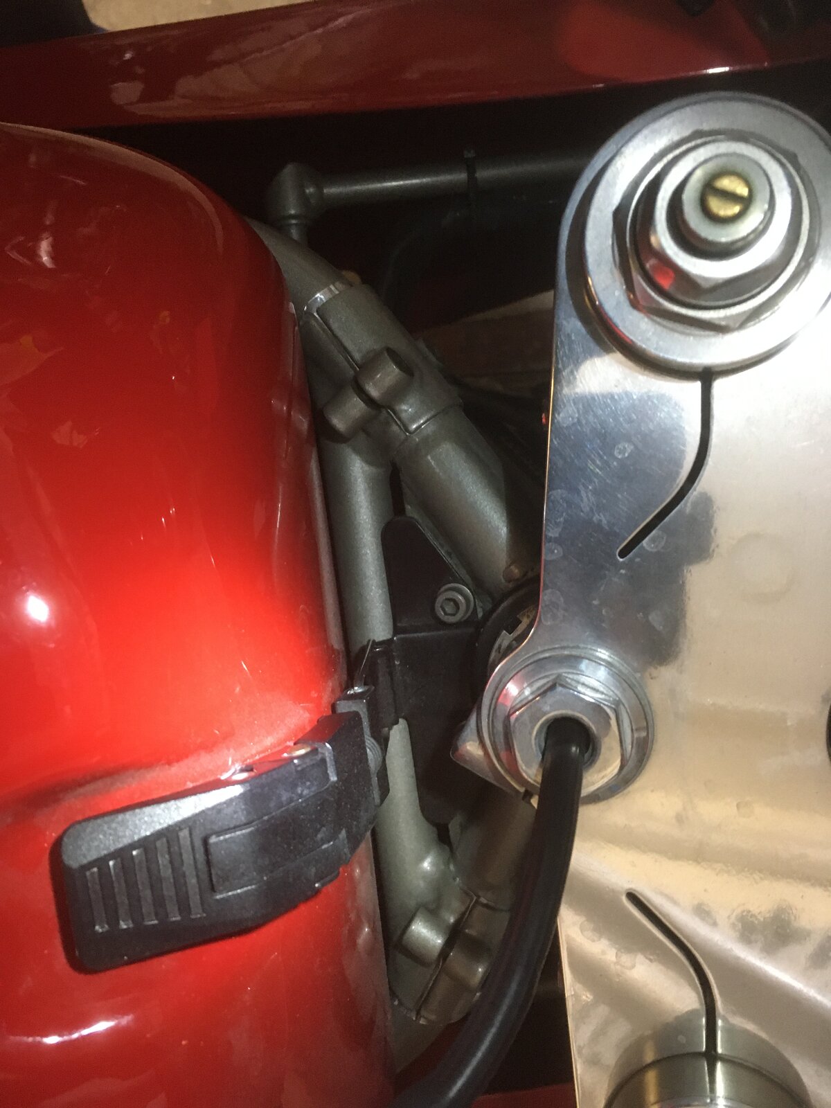

  2. Thanks for this - stop drilling the crack is important and I was thinking about over plating as you have done. I'm assuming that the frame is 4130 Chomoly and I'm looking for a suitable filler rod, I think ER70S-2 or ER80S-D2.
    Tony

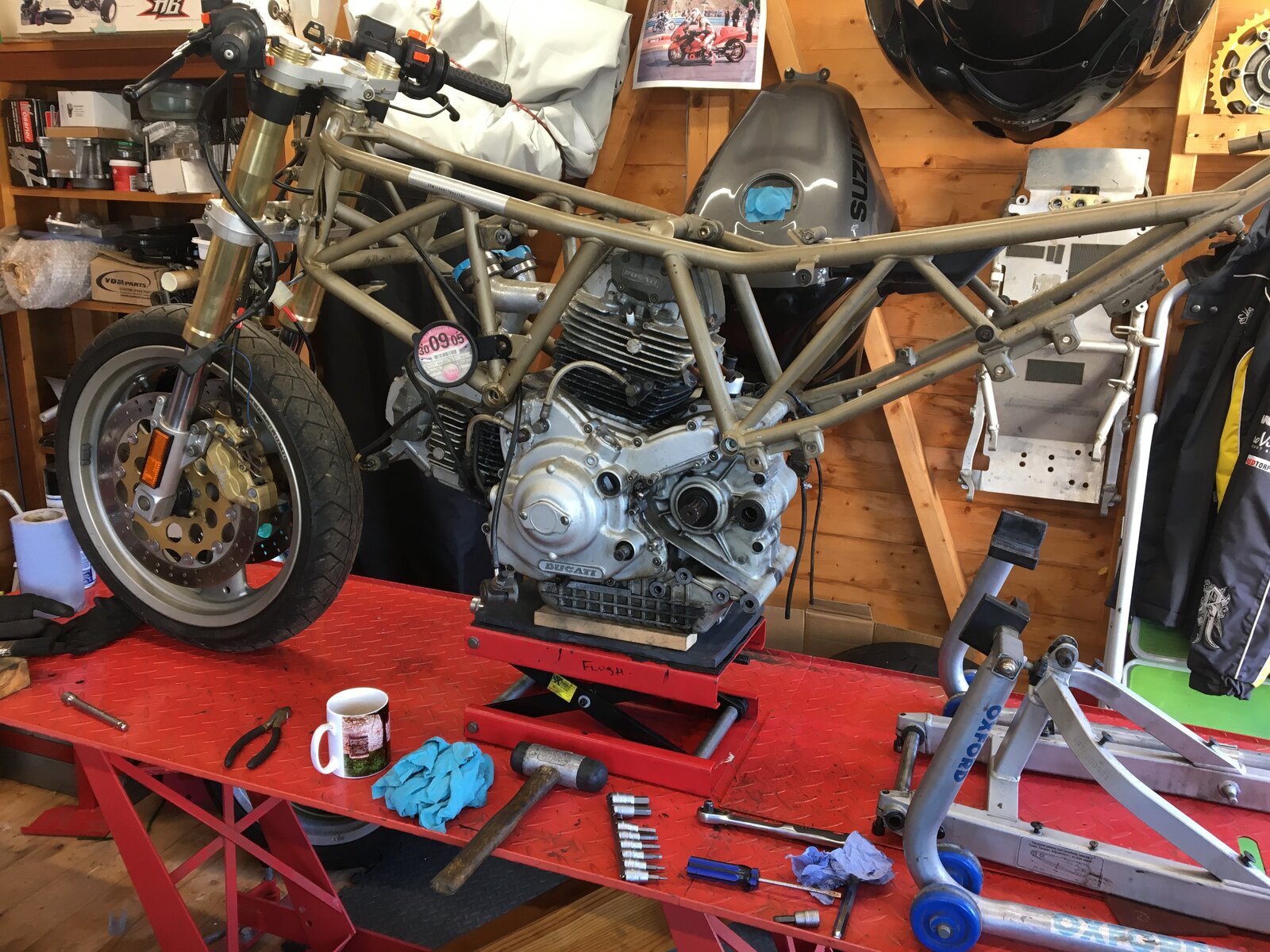

  3. So, I think I'm ready to split the frame and engine - any help on how to do this much appreciated! I'm thinking of supporting the engine, removing the rear wheel and disconnecting the swing arm/shock, then removing the front wheel/forks/levers/switchgear. Finally the nose fairing assembly and then unbolt the frame and lift it off. Is this correct? How heavy is the engine? I'm used to working on the Suzuki Hayabusa and I have to partially dismantle (head/barrels) to lift the motor off the lift on my own. KFMK0107[1].JPG
  4. That is by far the easiest way, :upyeah: you leave the heaviest assembly behind, well-supported, and lift the frame off it, and easier if still attached to forks and front wheel I find.
  5. Hi Tony
    Easiest way to get engine out is to remove full exhaust or just end cans, tank, air box and associated wiring, support the swinging arm then after removing engine wiring ( there is an earth strap at the back of engine to r/h footrest) support the engine securely then remove the two engine mounting bolts (you’ll need deep shallow width sockets)
    This will allow you to lift the rear of the frame up and wheel it forward leaving the engine s/arm with rear wheel still attached. You can also remove the r/wheel and swinging arm prior to this if you want to

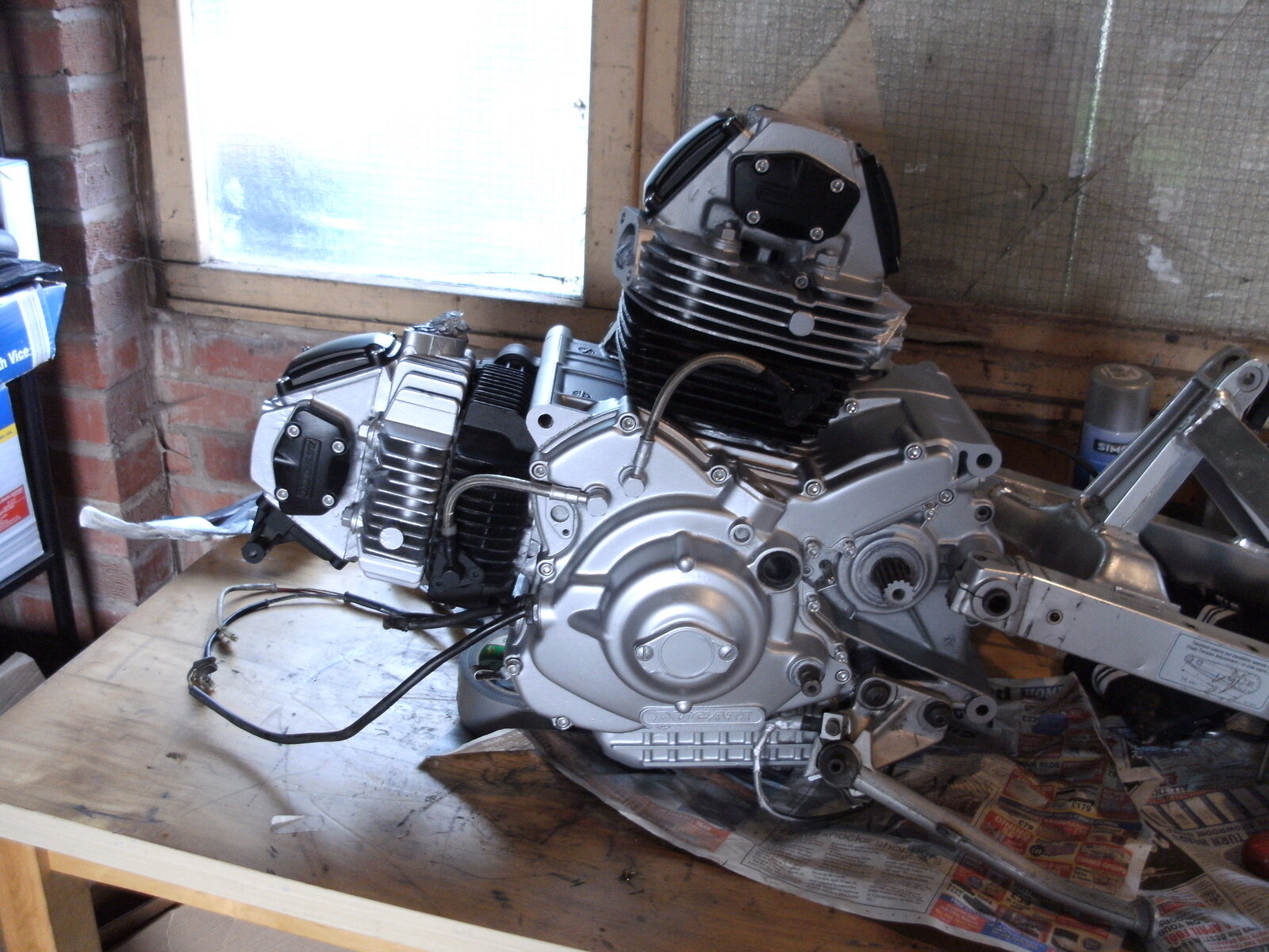

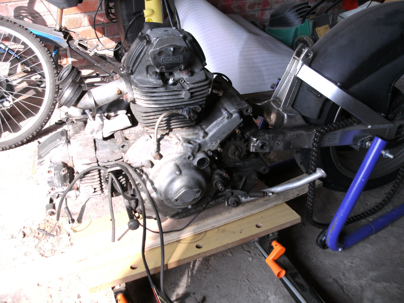

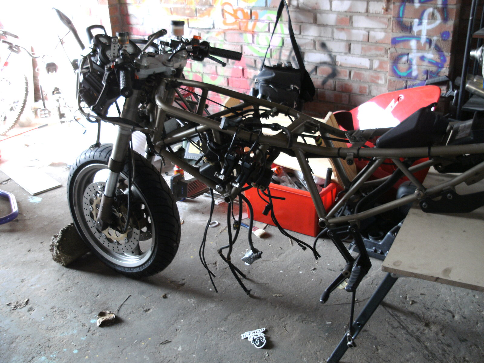

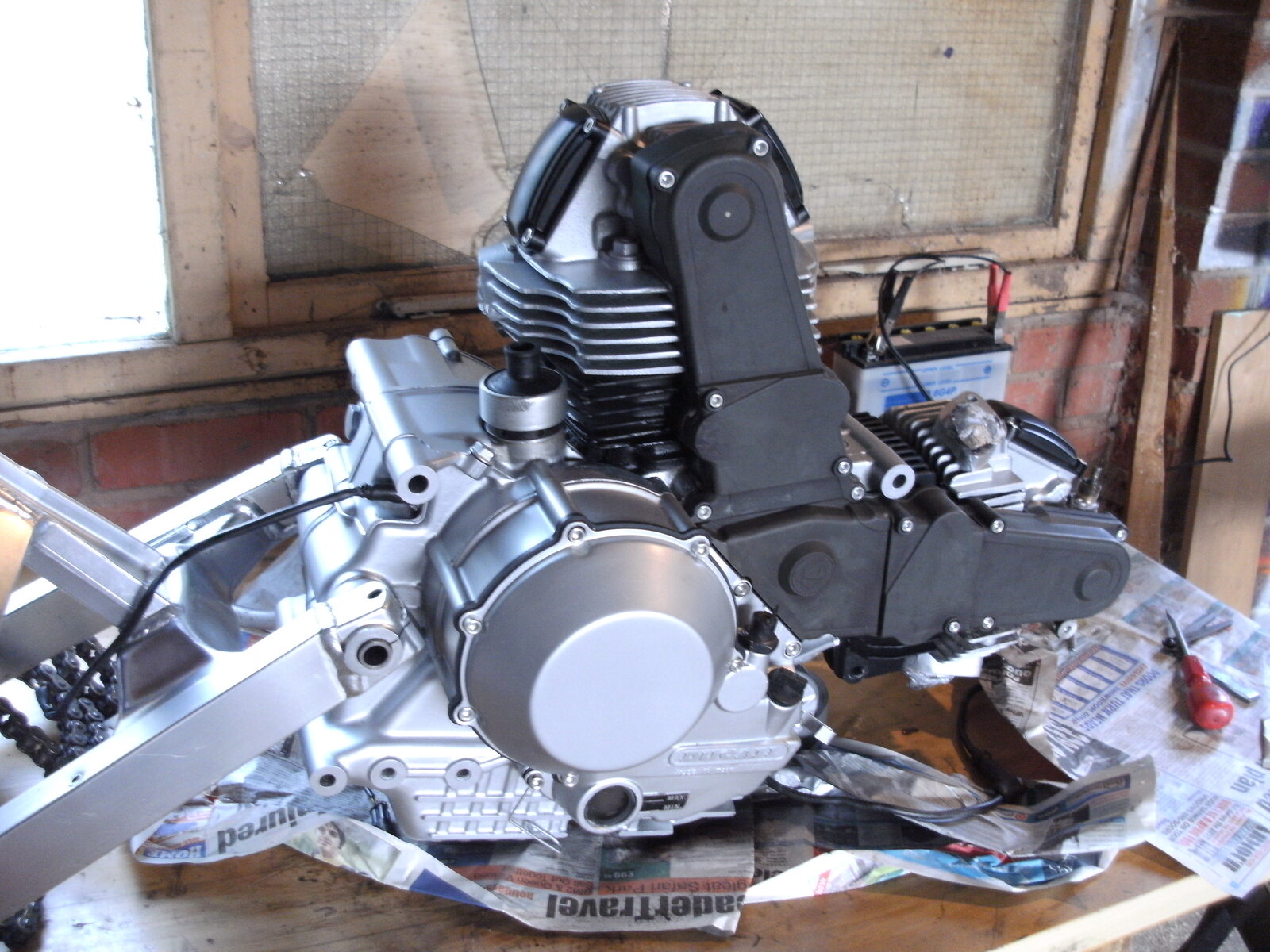

  7. These photos are from when I stripped my 900ss in 2009, I literally lifted the frame off the engine and swingarm, with the wheel still attached. I didn't even remove the swingarm from the engine as it helped moving the engine round on the bench when I was repainting it. Have you got a Haynes Manual as that is what I followed to strip the bike. Bike Strip 010.jpg Bike Strip 012.jpg

  11. Hi Tony and welcome. If you search the web ( if not already done that) about US models you find 2 types of 900 ss (CR and SP ) if not remembering wrong. The Cr model also have the 4.5 rear wheel. I suppose your swingarm is made of steel instead of aluminium? I think that the frame brace was manufactured and sold by "BB Fabrications". I am member of 900 ss 2 valve group at Face book. I´l think it was there i saw them sold. Good luck with your rebuild!
  12. Thanks for the info, yes my swingarm is steel and the rear wheel is 4.5". I have a 5.5" to fit. I'll certainly join the facebook group and see if anyone has a brace for sale, I don't think they are available new anymore.

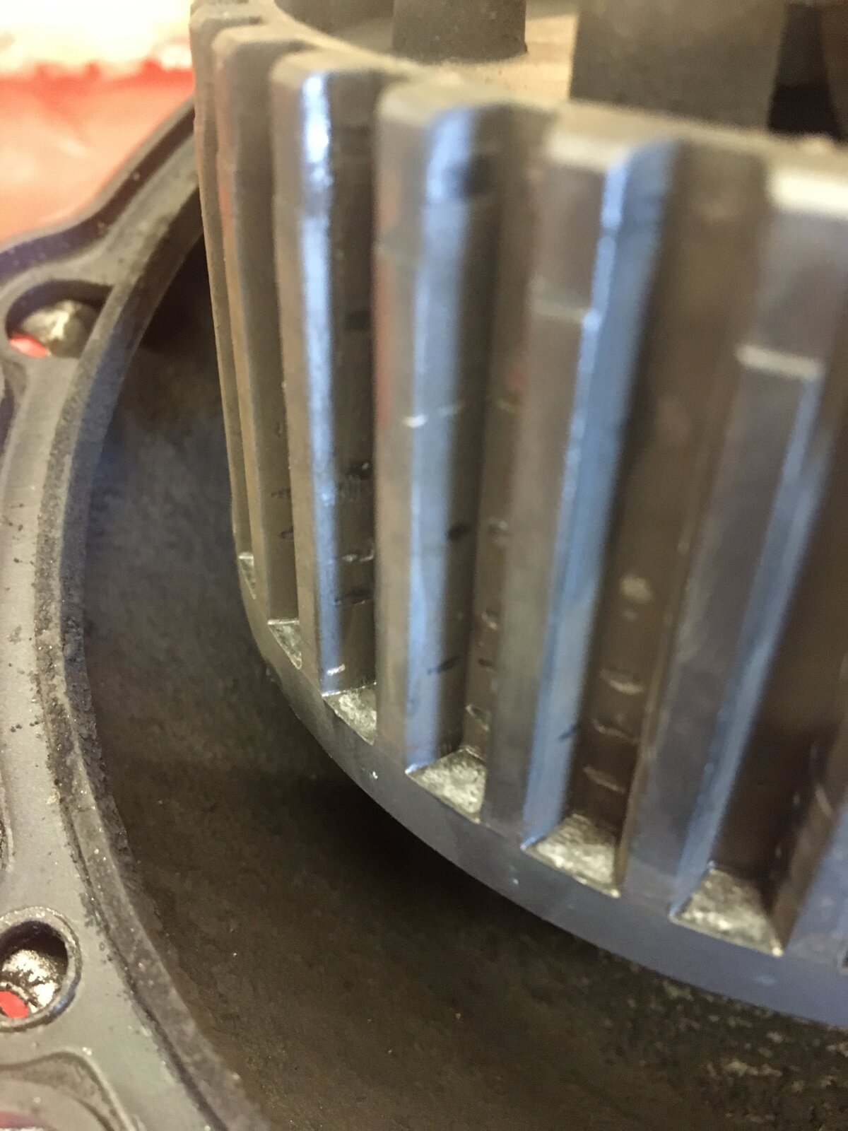

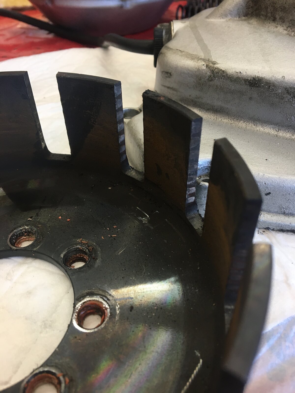

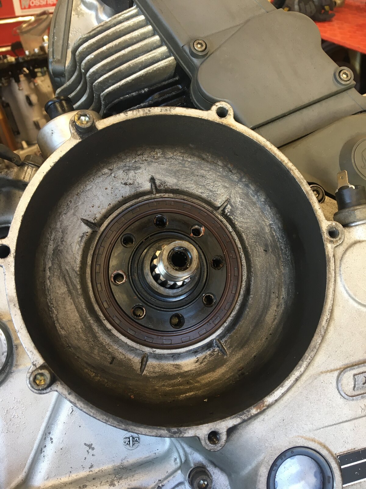

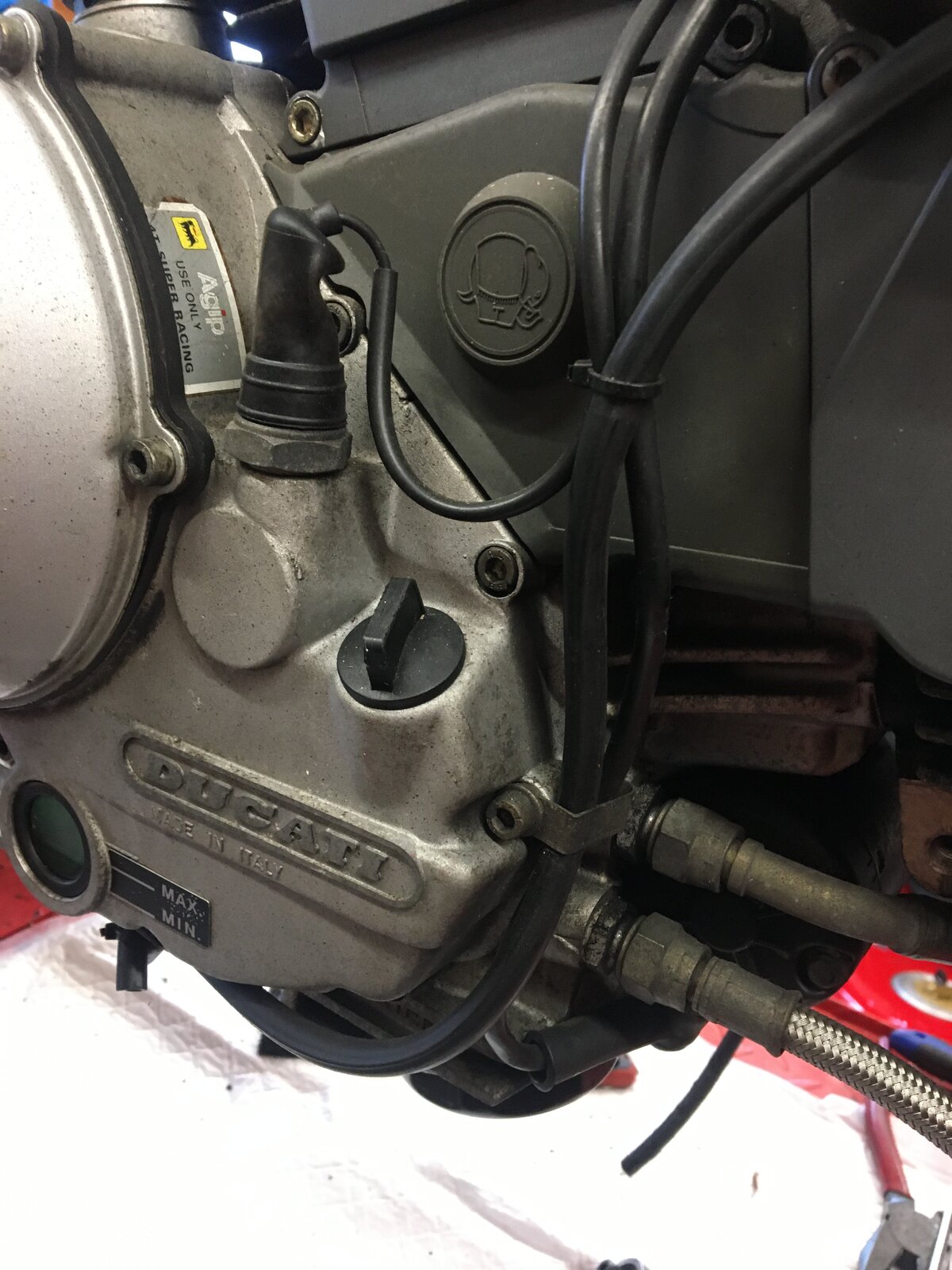

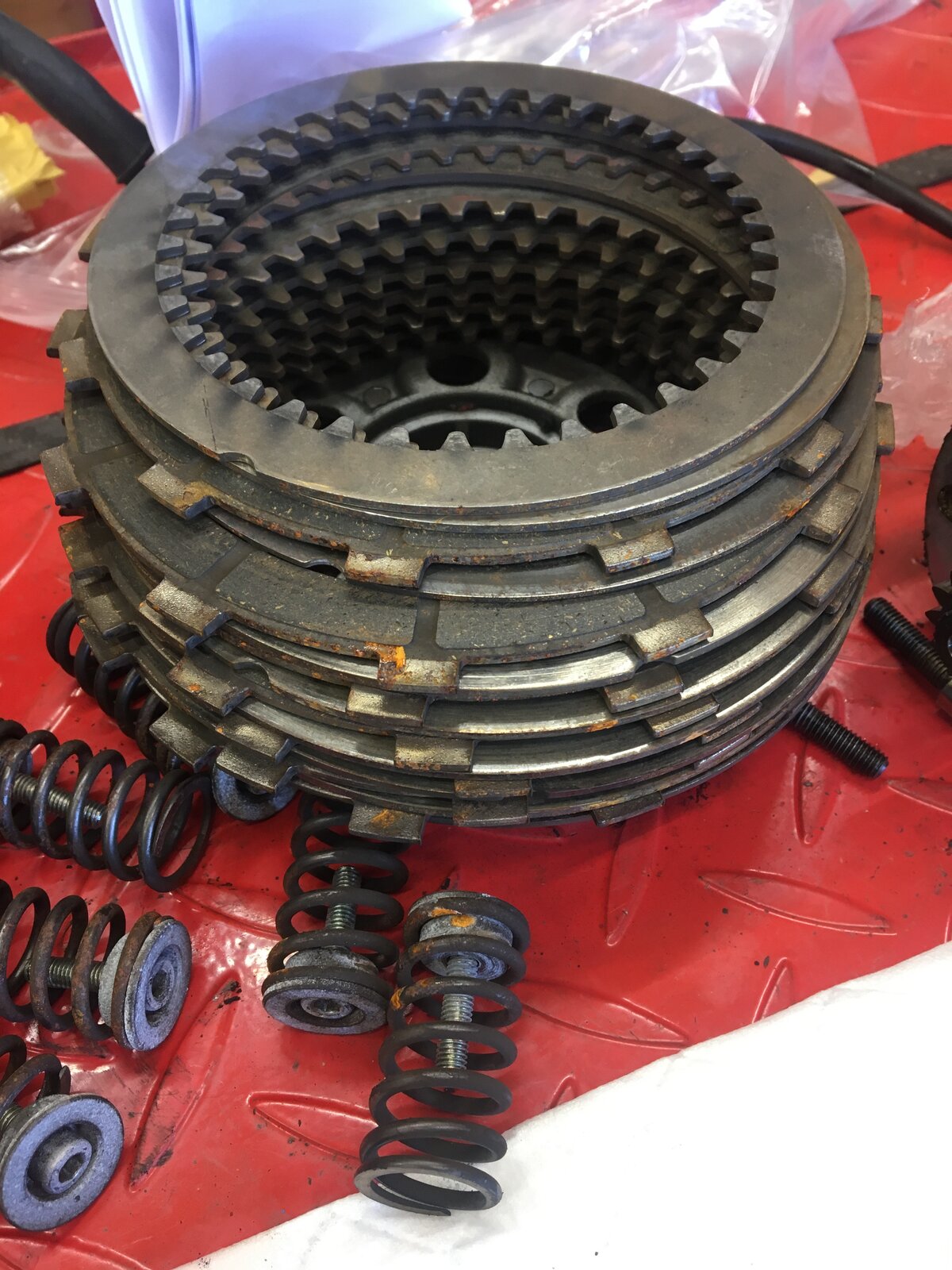

  14. Engine out and I've taken the generator cover off and removed the clutch, which looks in a pretty sorry state. I was toying with the idea of a slipper clutch and having checked prices of the OEM parts it looks like a no brainer.
    A couple of questions if I may; Where is the best place to procure OEM parts and gaskets from? The second question is a simple one (not): How far should I go with the strip down?
    It's only showing 12,000 miles, but the clutch baskets are quite worn, so not sure if this is true. Is it always prudent to change the oil seals on the clutch side and remove the heads/barrels to carry out the cosmetic work - although I had intended not to? It wasn't burning any oil when I started it up at the sellers place - I have read that the piston rings can lose their tension, but is this age or mileage related?
    Obviously I'll change the belts and check valve clearances - anything else in addition I should consider? IMG_4677.JPG IMG_4681.JPG IMG_4682.JPG IMG_4683.JPG IMG_4685.JPG IMG_4686.JPG IMG_4687.JPG IMG_4688.JPG Tony

  16. As mentioned previously, check the coarse oil strainer if not already done. Also check the condition of the sprag clutch. But the clutch basket and plates look ok to me for a road bike.
