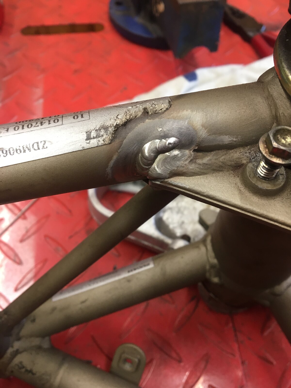

  1. Hi Tony, I noticed in your pic of the cracked head tubes, it looks like the frame may have sustained more significant damage e.g. from a front end shunt, not just frame joint cracks during use, unless it is a mark / shadow. Might be worth checking the frame is straight.
  2. Hi Jon, thanks for your concern. What you can see is some paint or something that must have been spilt on it during storage. Things have moved on a bit now - I welded the cracks today and will be making a strengthening gusset tomorrow to be welded in to reinforce the area.

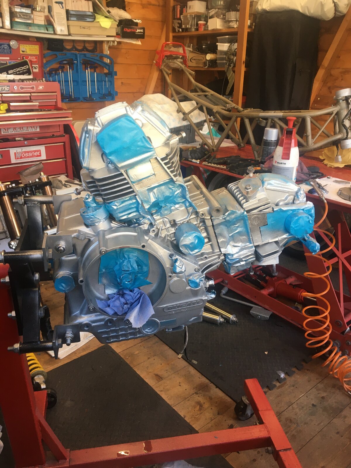

    The engine is in the process of being painted and I'm awaiting new belts and tensioners together with the necessary shims to sort out the valve clearances and new valve seals. The guides seem to be OK with no obvious play, so I'm leaving it together.

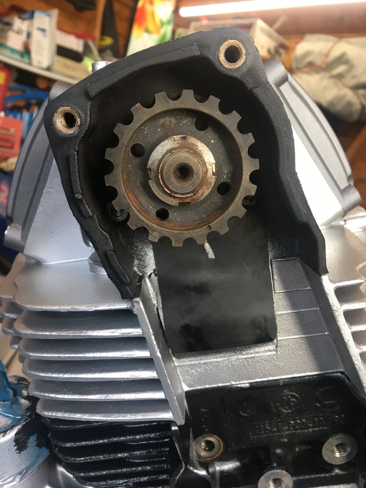

  15. I'm ready to put my new timing belts on but I've noticed that there are marks on the black plastic gear cover (for want of a better description) where the belt has been rubbing. it can be pushed back towards the head, but it just springs out again! I can't find a cover in the Ducati parts catalogue that has the "skirt" on, they are the same depth across the back as the sides and the head has a "vibration damper pad" 70010271A. My head has finning behind that skirt. I did notice that a 2001 model does appear to have the "skirt". Should I just cut it off to prevent it rubbing?
    Tony
