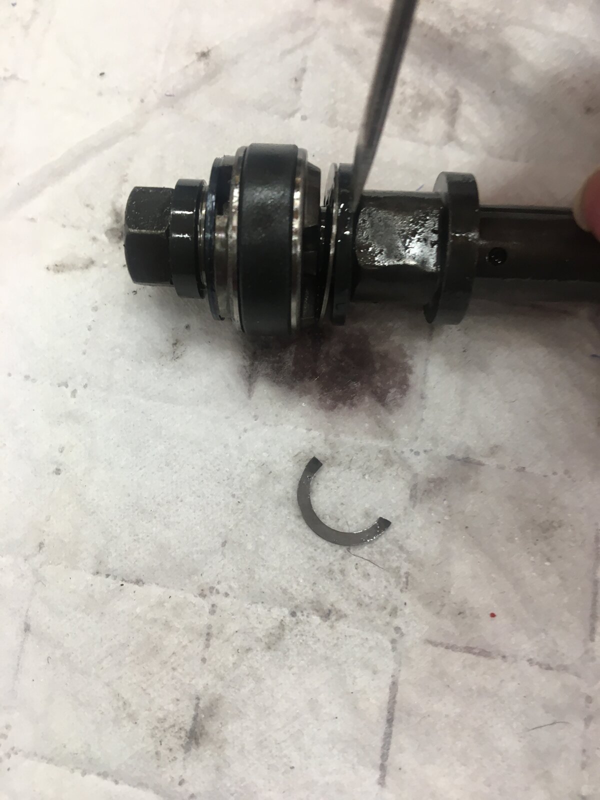

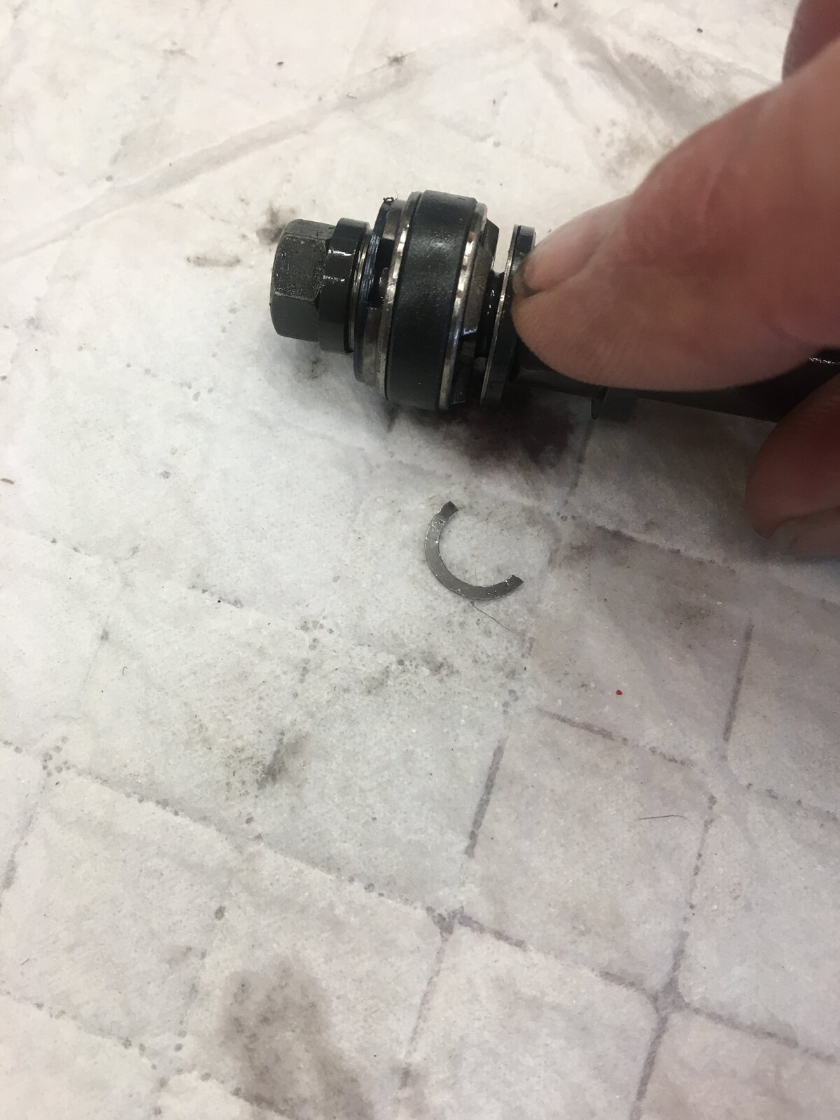

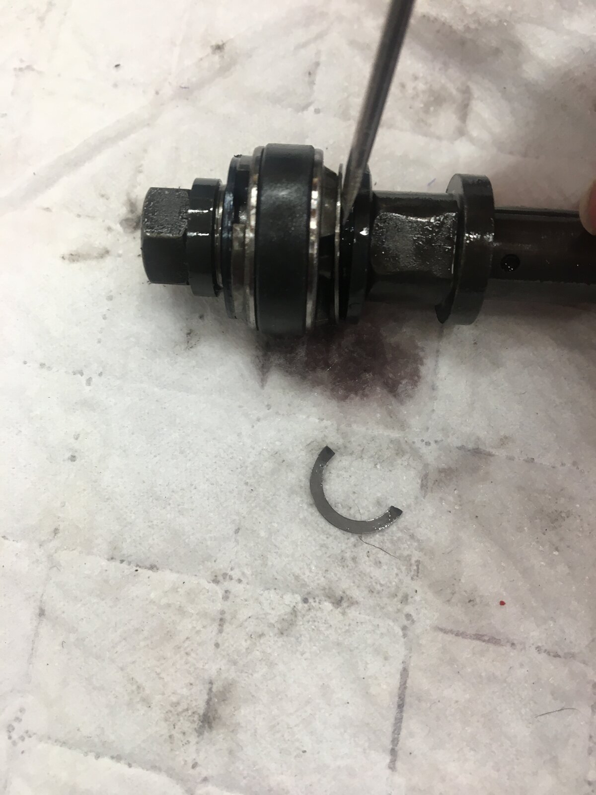

  7. Fork leg stripped again and the compression and rebound stacks removed from the damper rod. I haven't taken the other suspension leg apart to compare, but it seems like there should be a wavy washer supporting the shim in the picture and all that's left is half of it. Could this be the cause of the jump before the rebound damping takes affect? To be honest I was expecting a loose nut or something...
    The broken piece was behind the shim where the screwdriver is in the last pic.

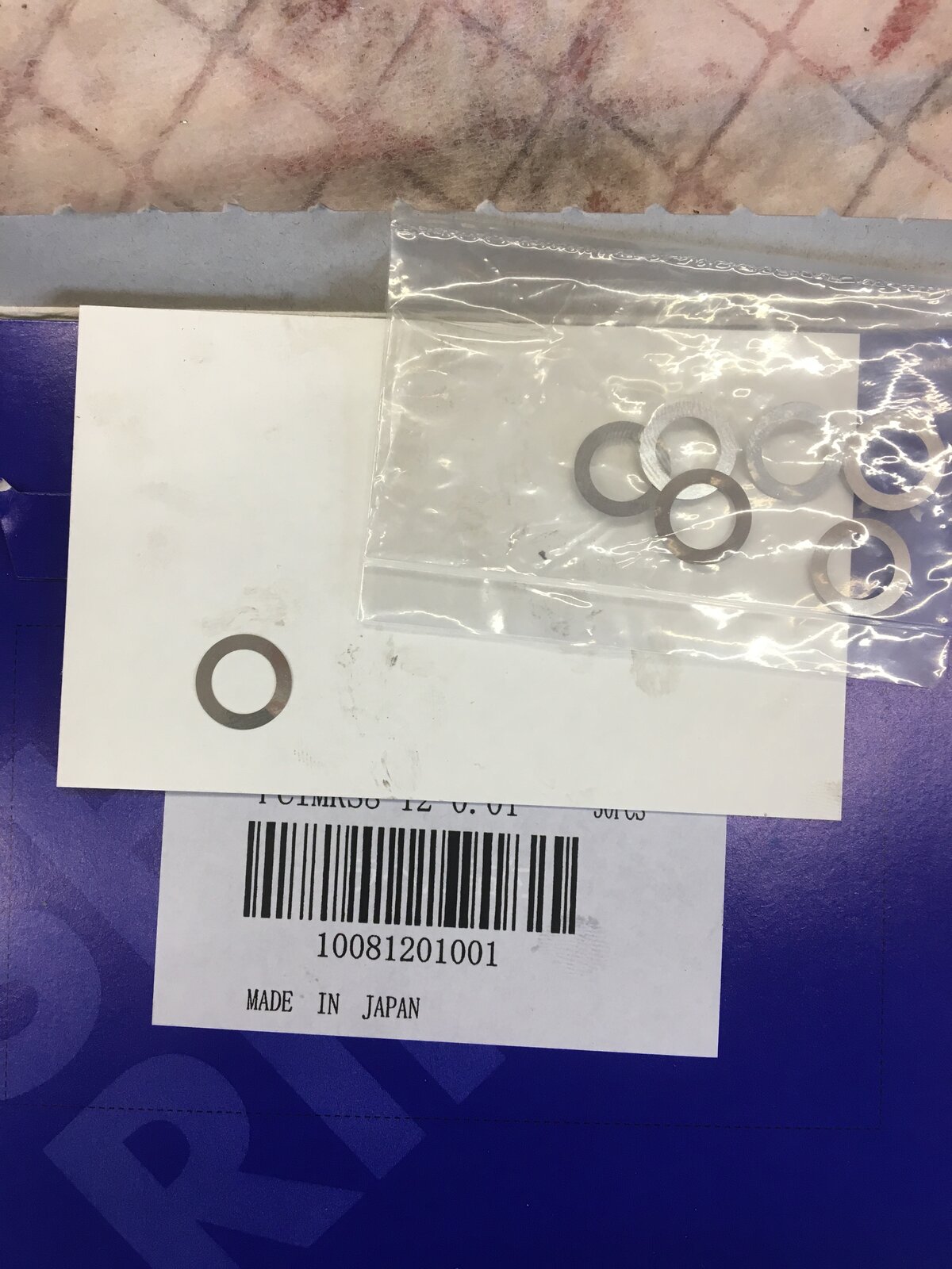

    After extensive searching I could not find any wavy washers of sufficient 'thinness' to give the light load required to just support the shim and allow it to move under oil flow. The broken part of the springy bit that remained measured ~ 0.02mm thick.
    I ended up opening an account with a German engineering company owned by Misumi in Japan. I ordered stainless steel shim washers 8mm id, 12mm o/d and 0.01mm thick - I had to buy thirty!
    They arrived this morning and after some experimentation I formed my own 'wavy' washers by gently folding them in half 90 degrees apart so there are four contact points. I stacked three of these on top of each other and the result is as close to the original arrangement as I think I will ever get :)

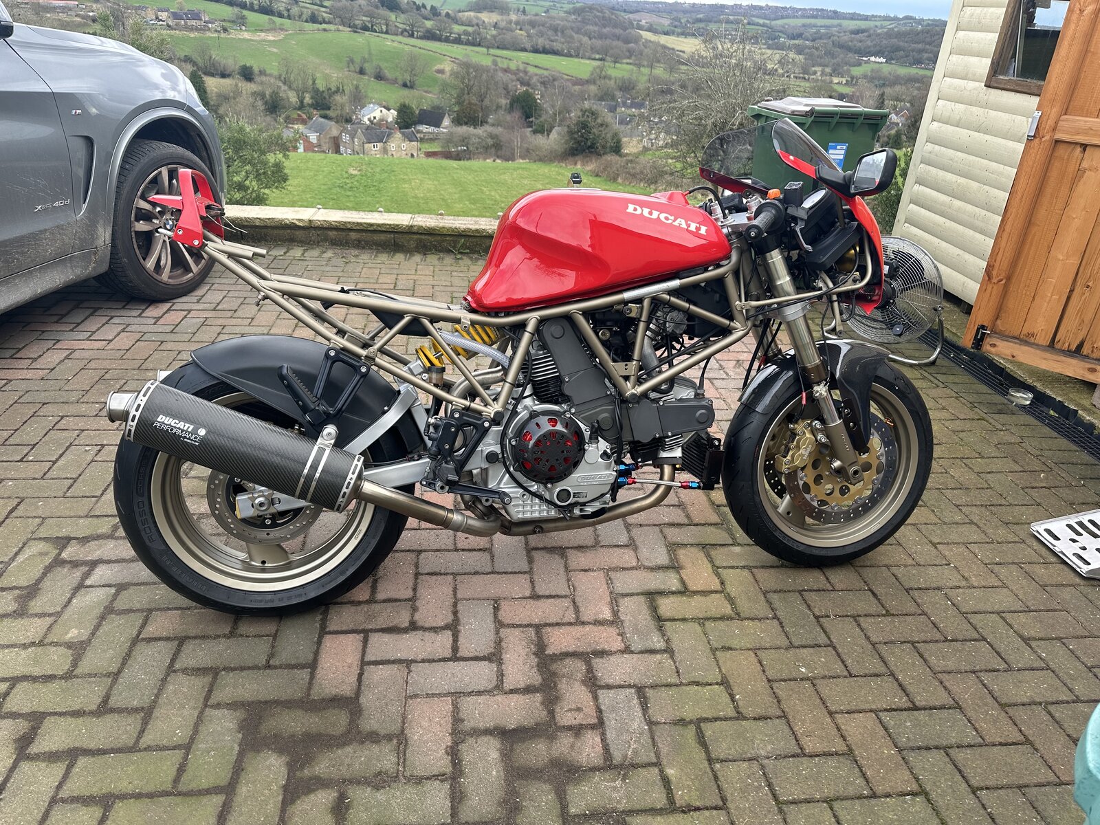

  9. So after twelve months we have a running motorcycle
    a few small things to do and then the fairing parts can go back on.
