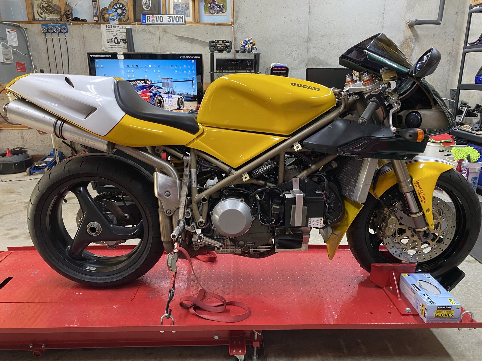

    I am leaning towards a slight pearl yellow with the same pearl white number plates and gold or black pinstripe around them. Also going with a black frame for now, but I am also considering a charcoal grey frame. Of course black wheels. This bike probably would not have been given a second chance if I had't acquired it on trade for some paint work.
  4.

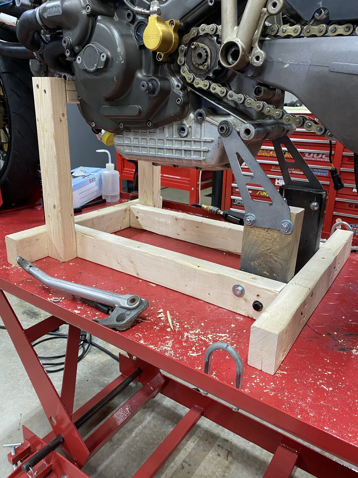

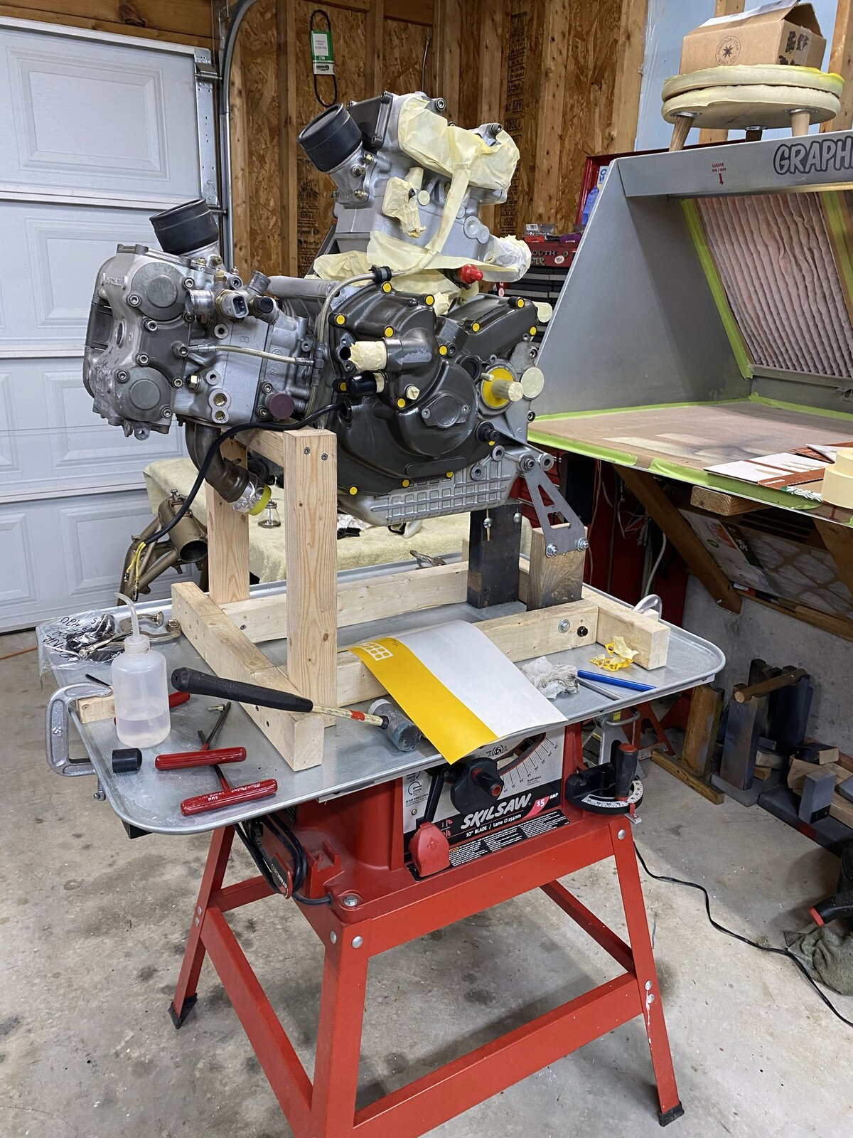

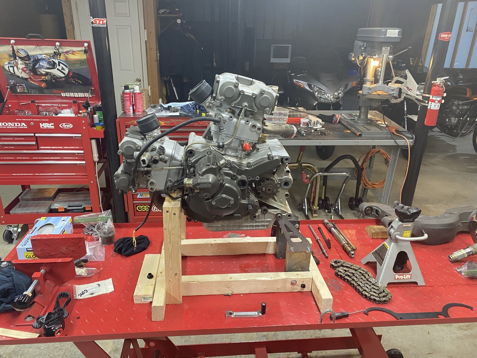

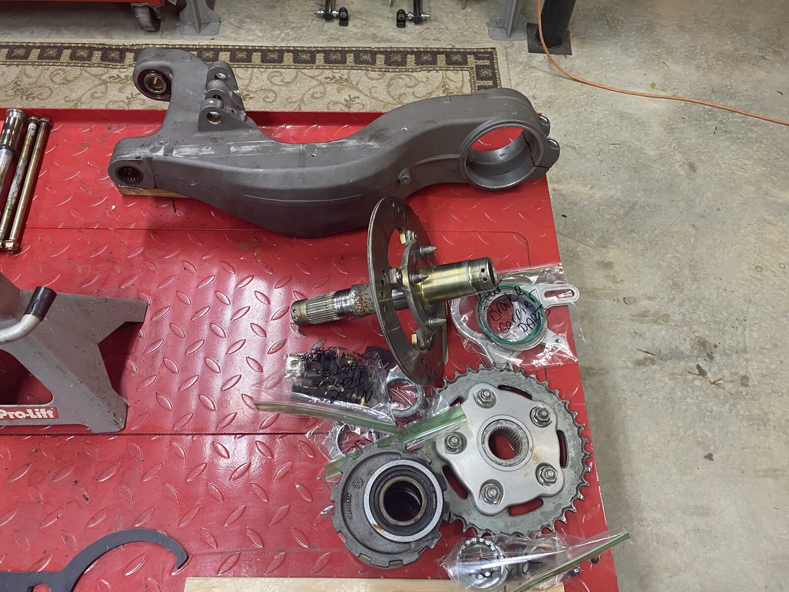

  5. The project is moving along, so here is a pictorial view of the progress.
    Made a stand to support the engine and frame

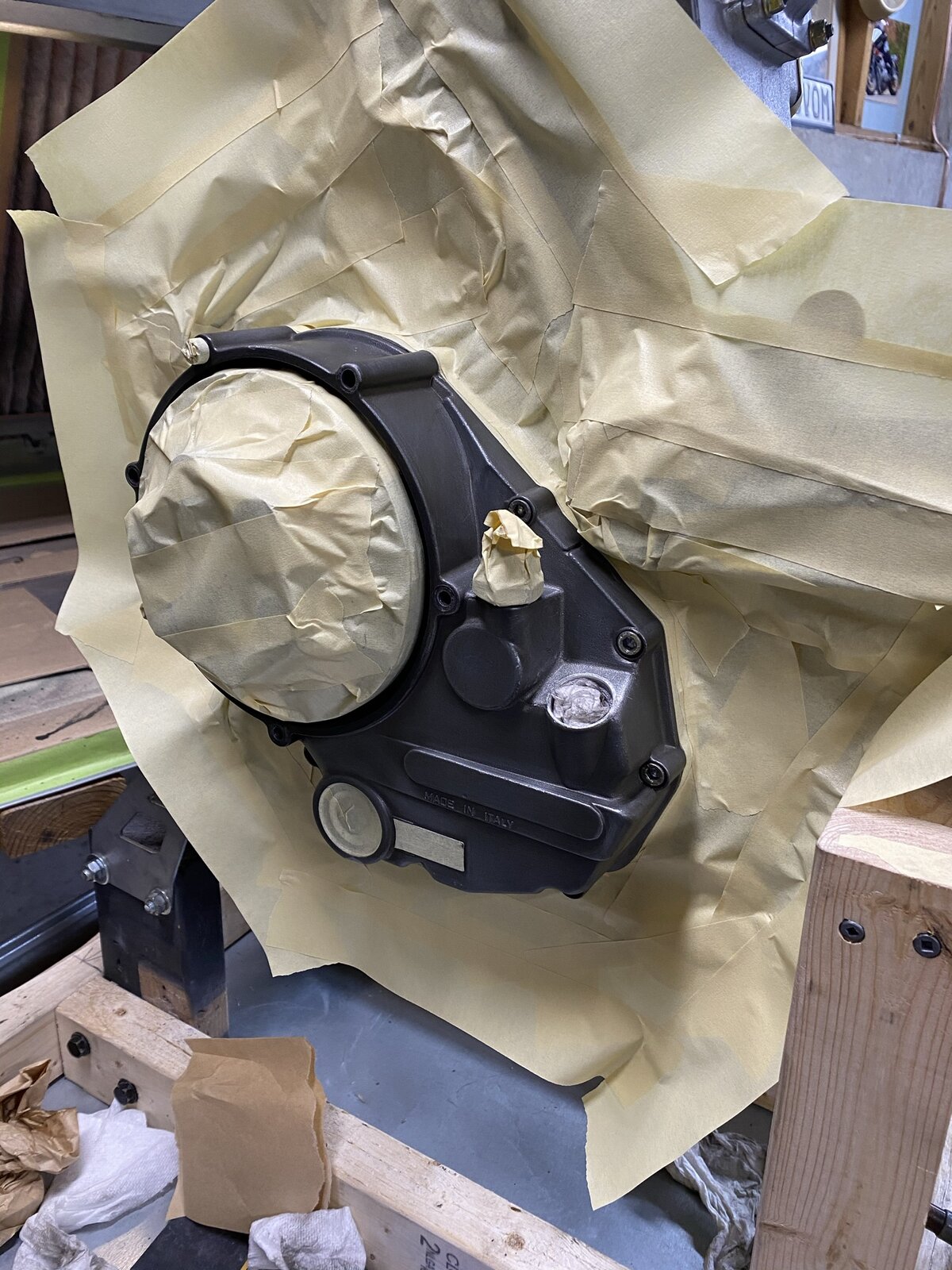

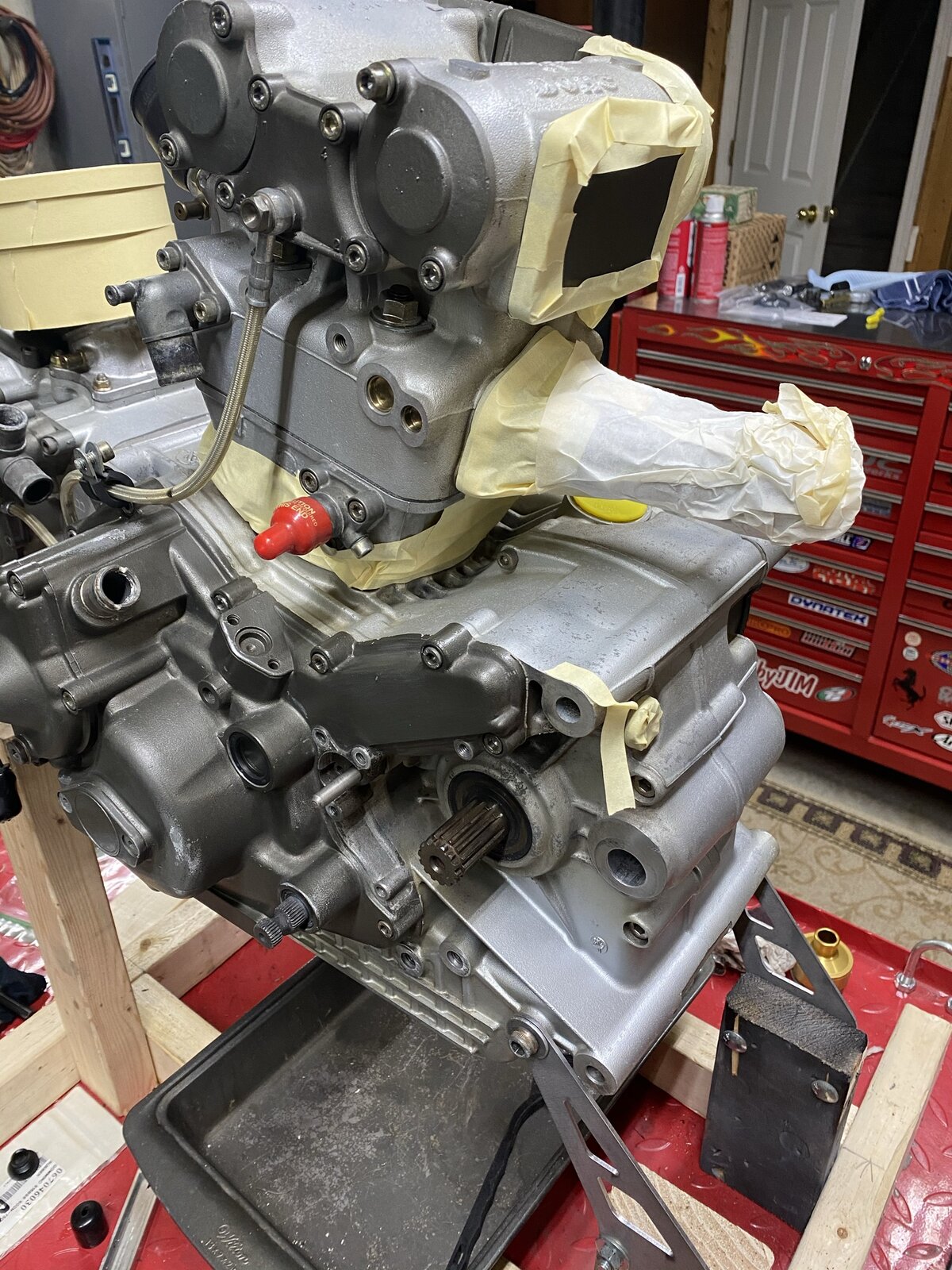

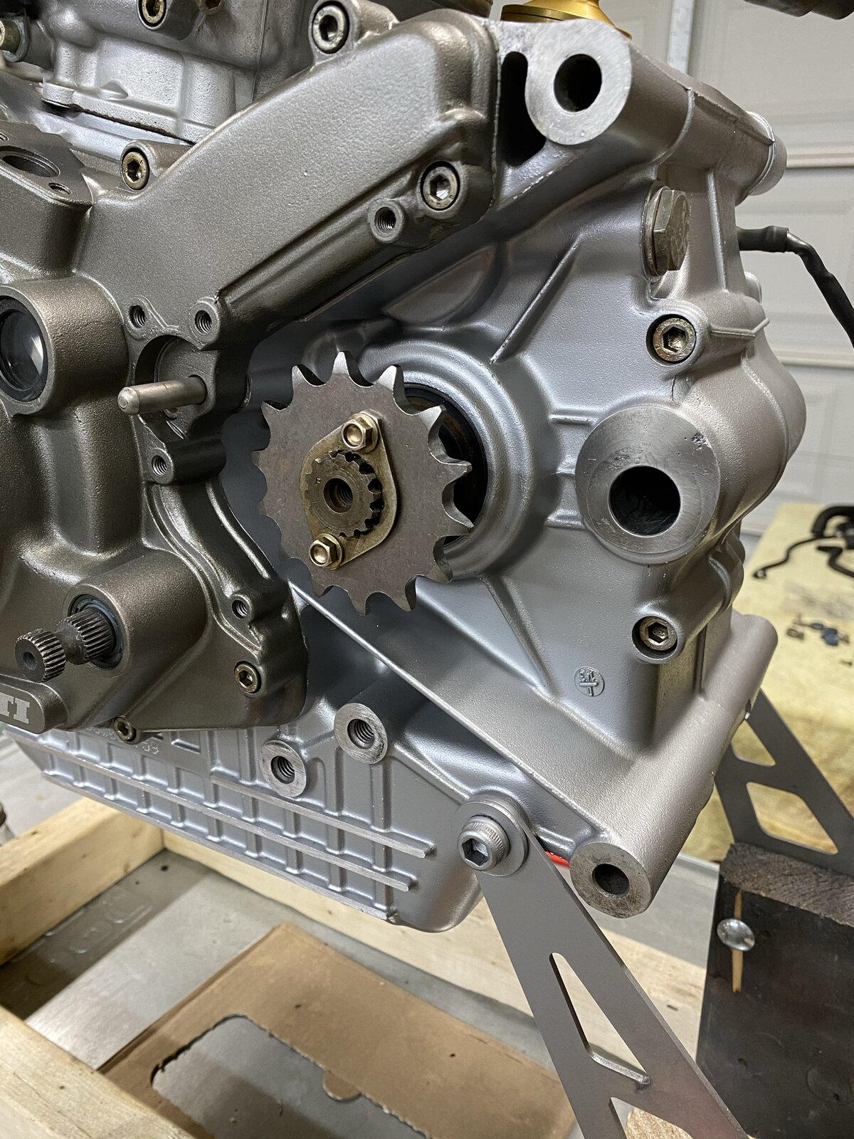

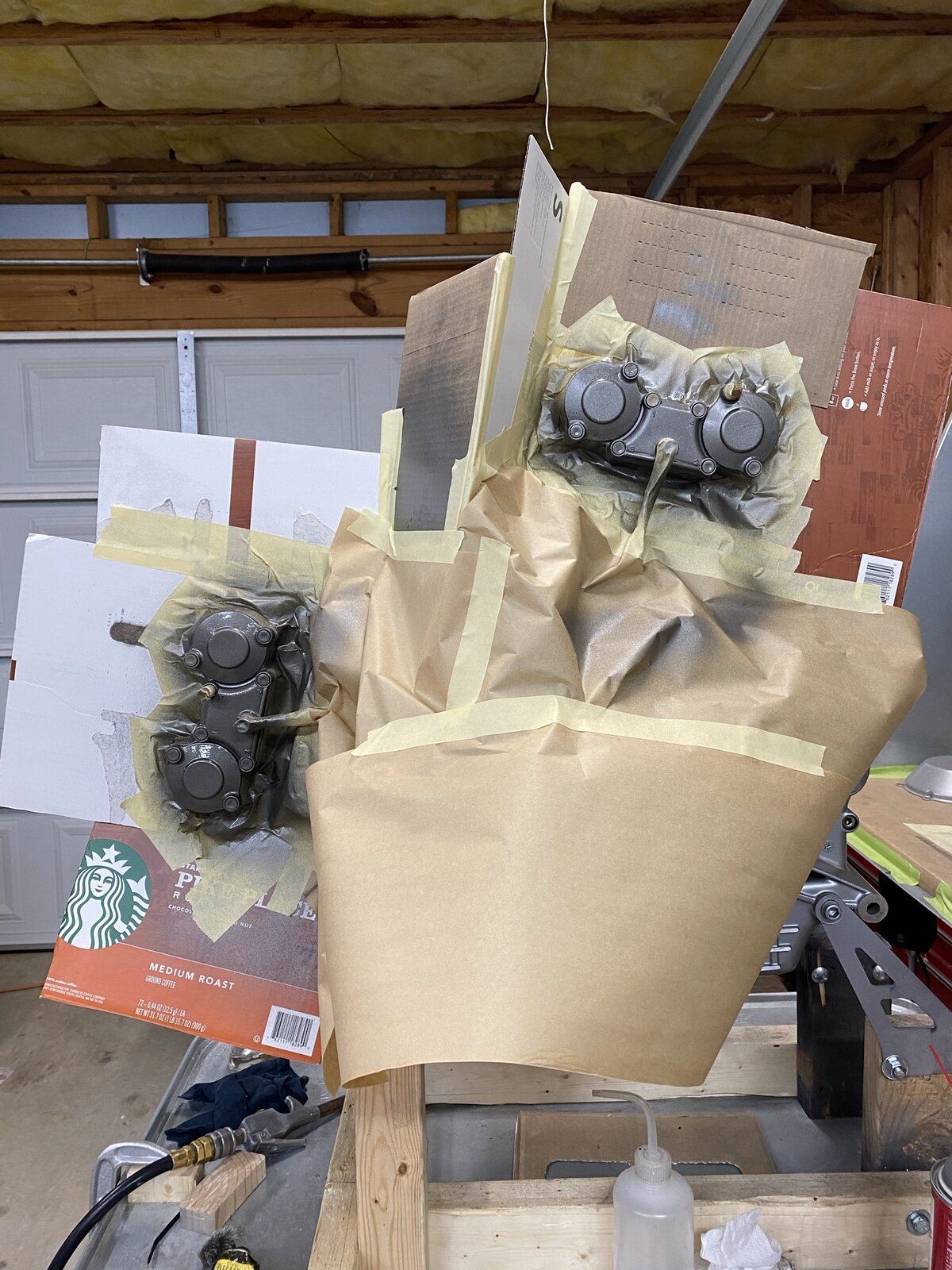

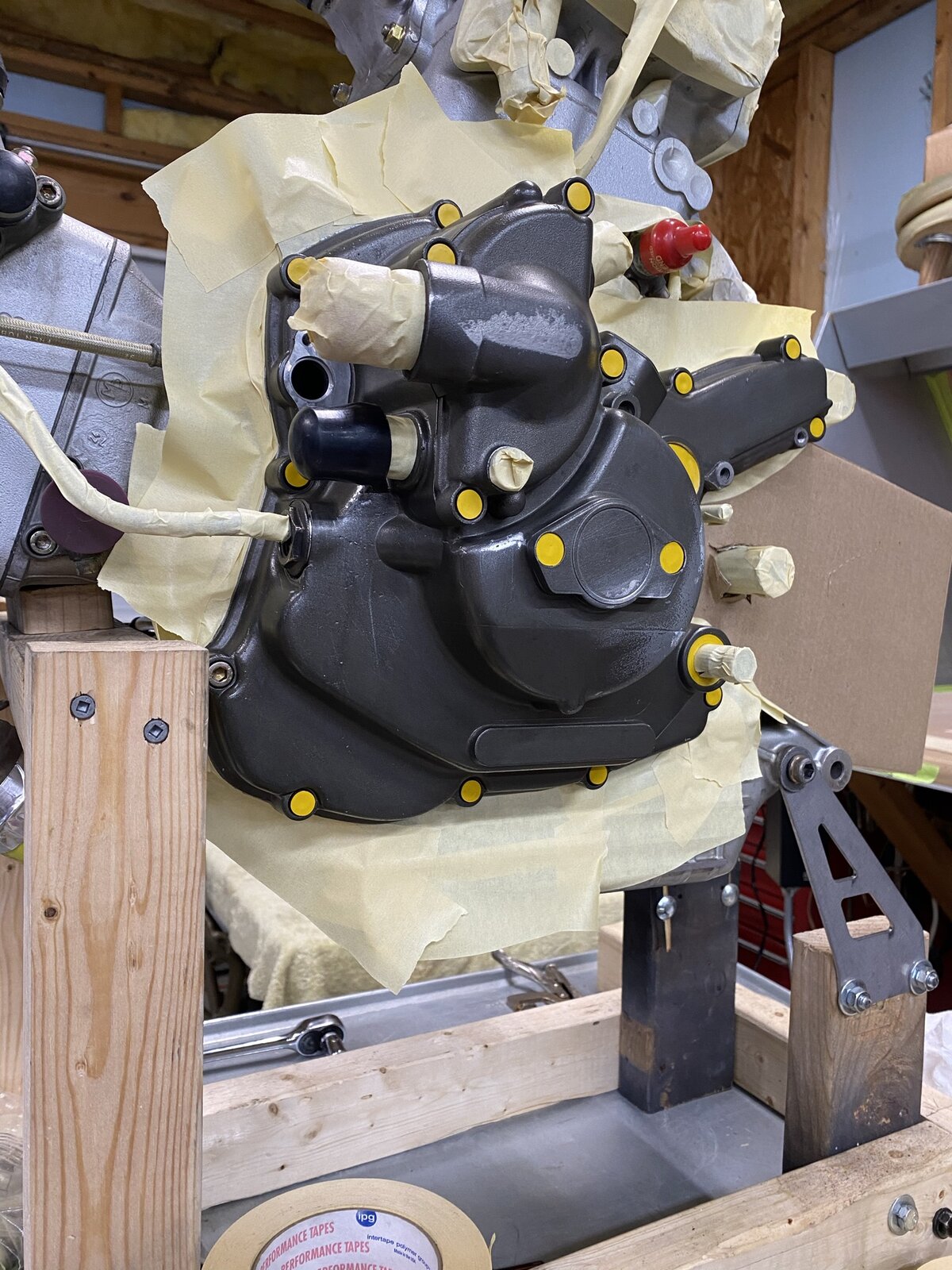

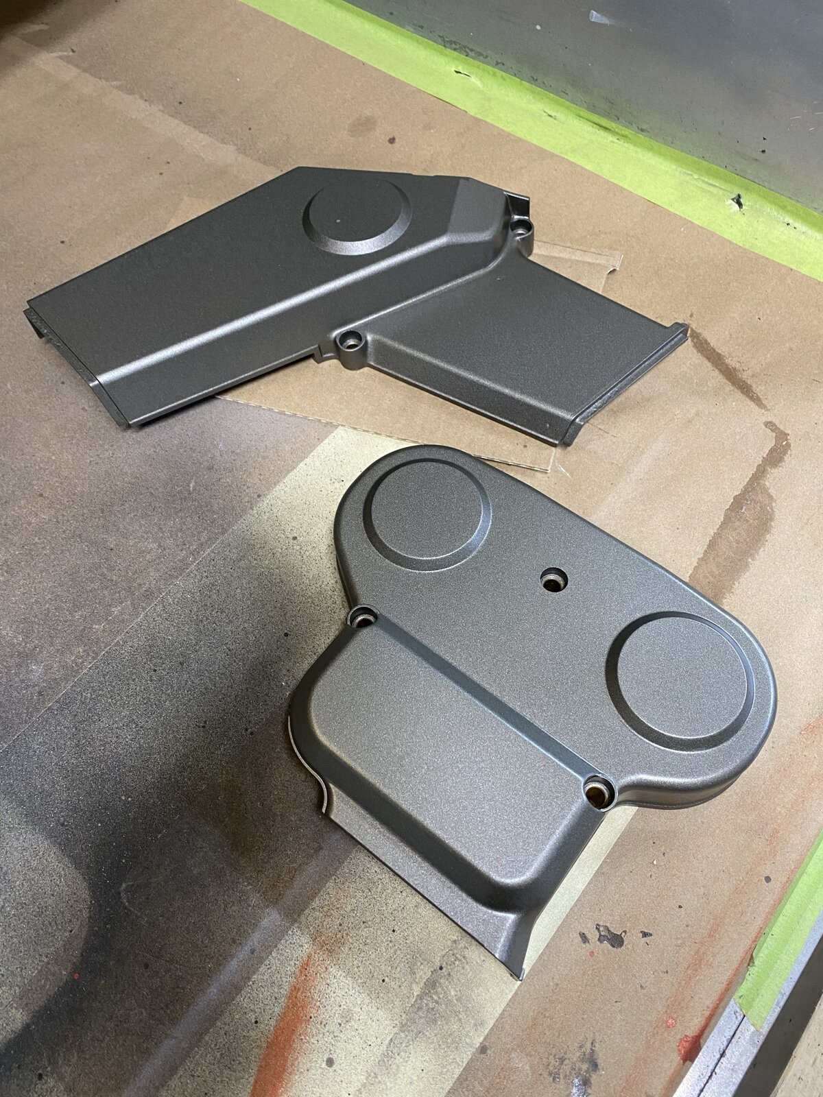

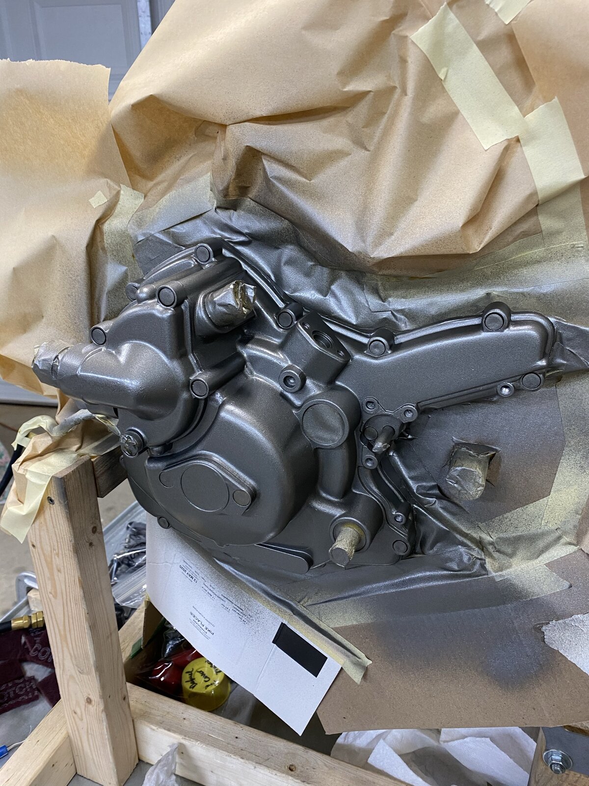

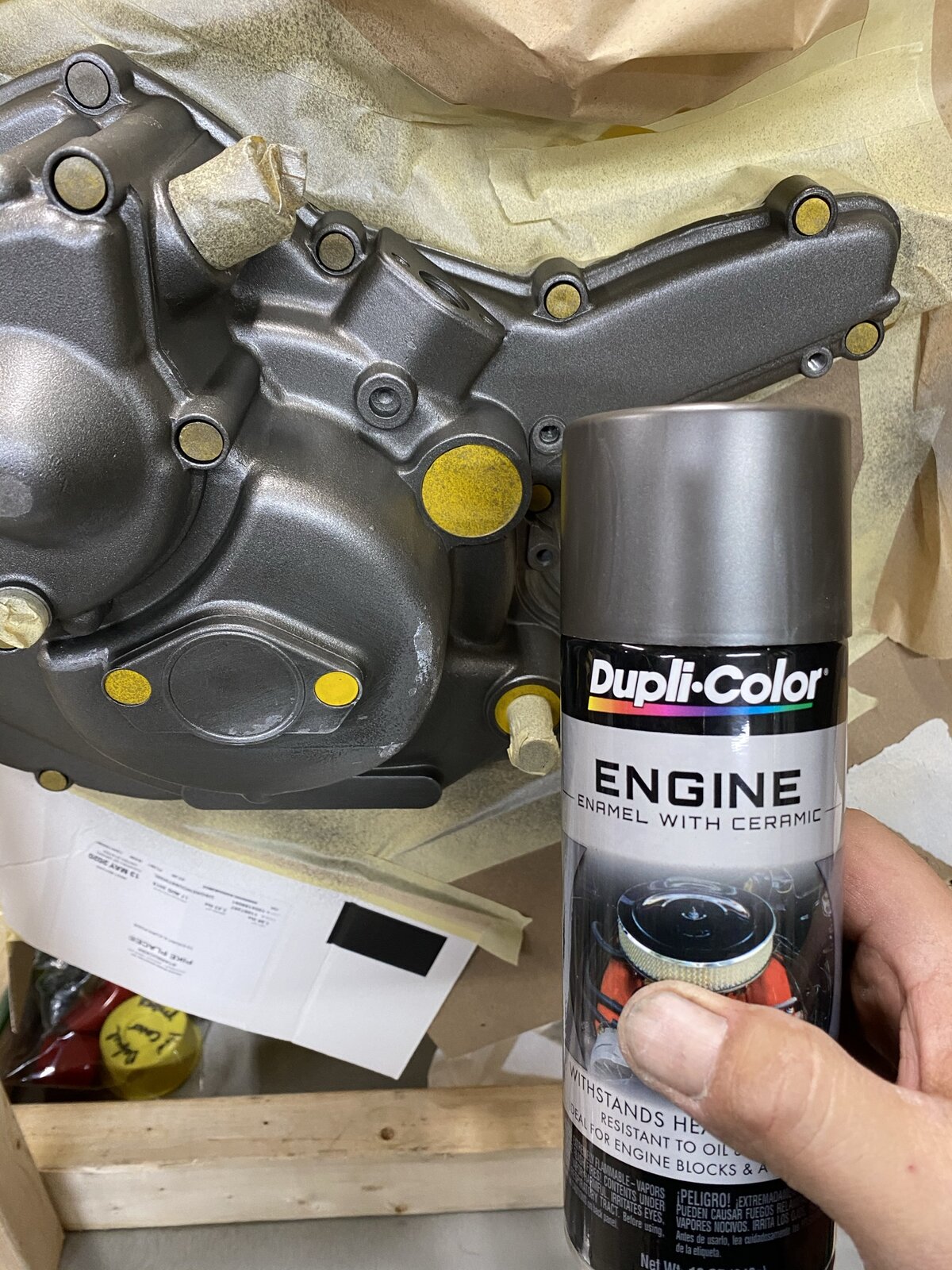

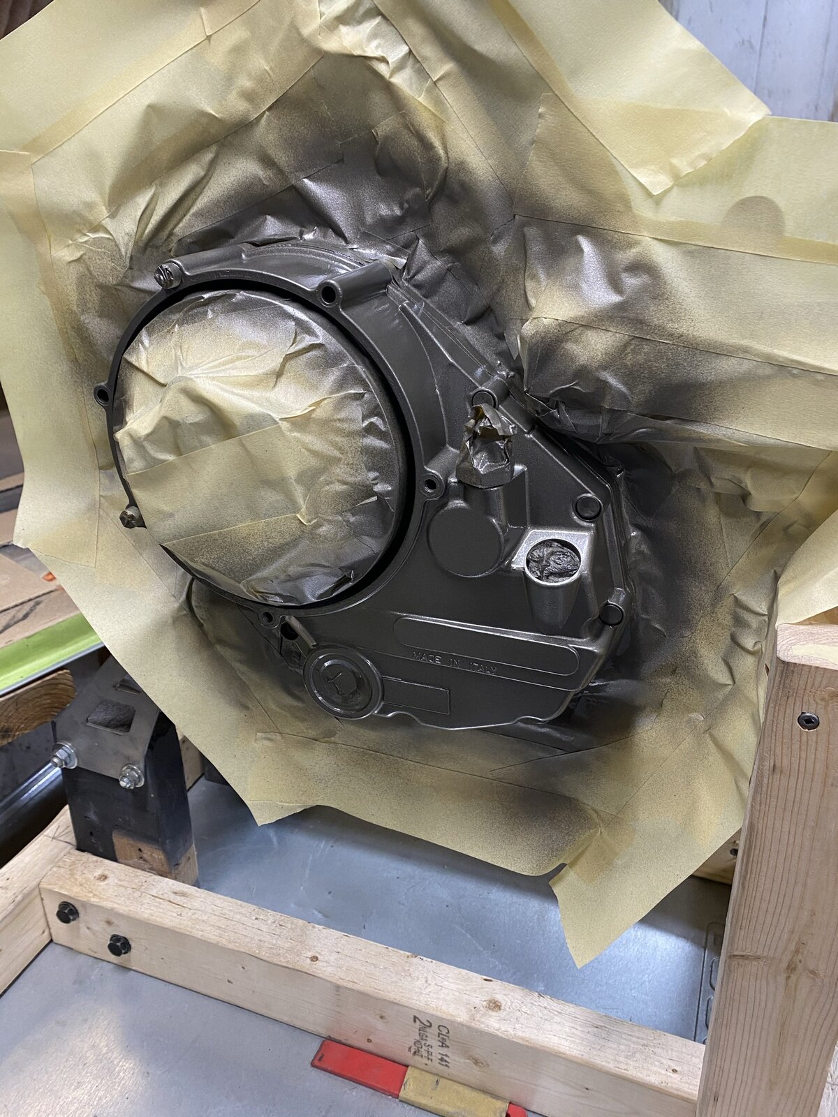

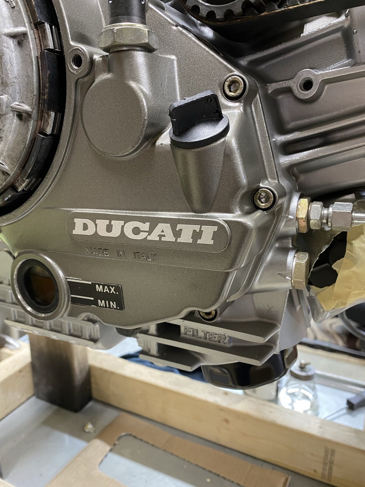

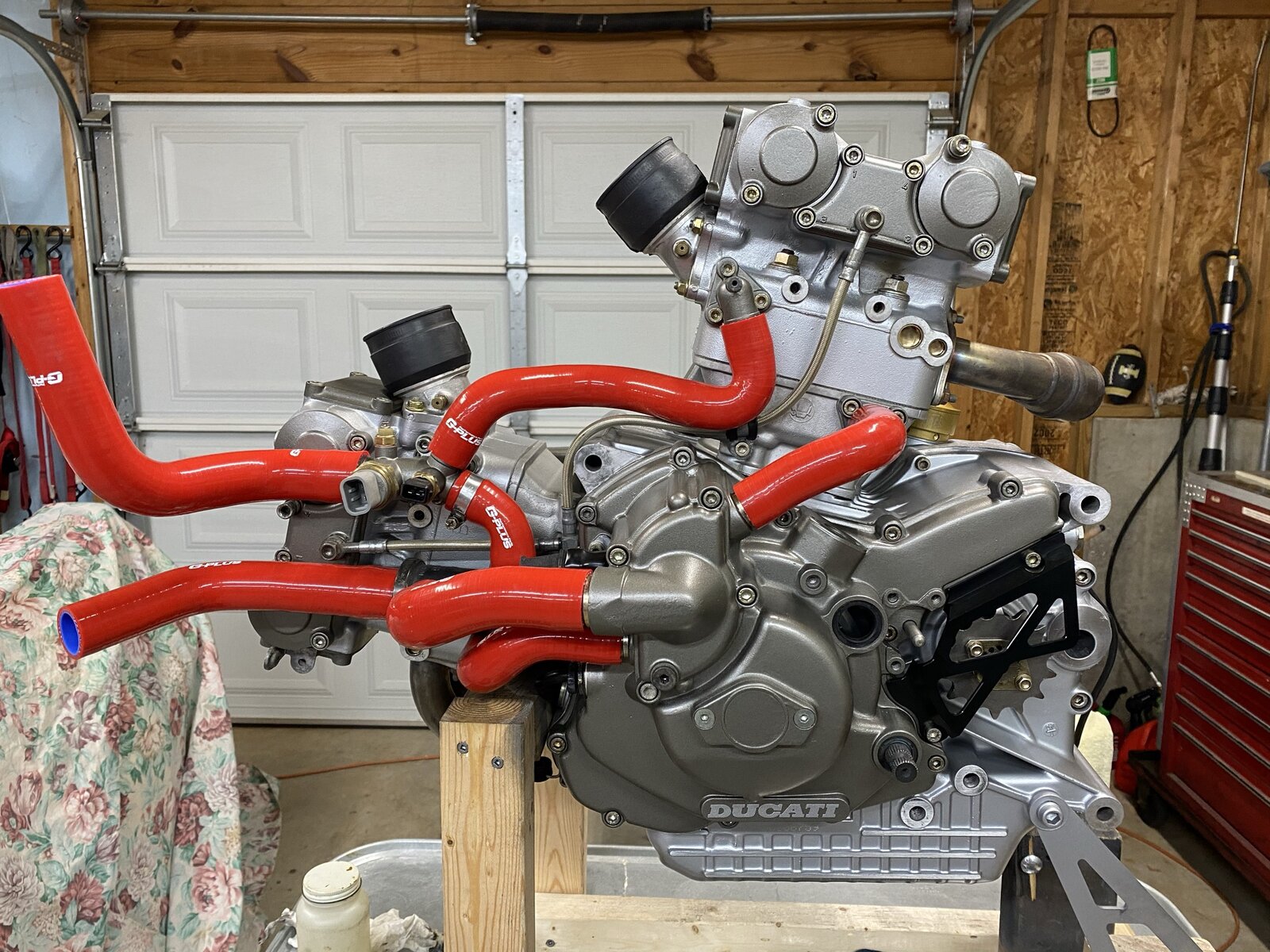

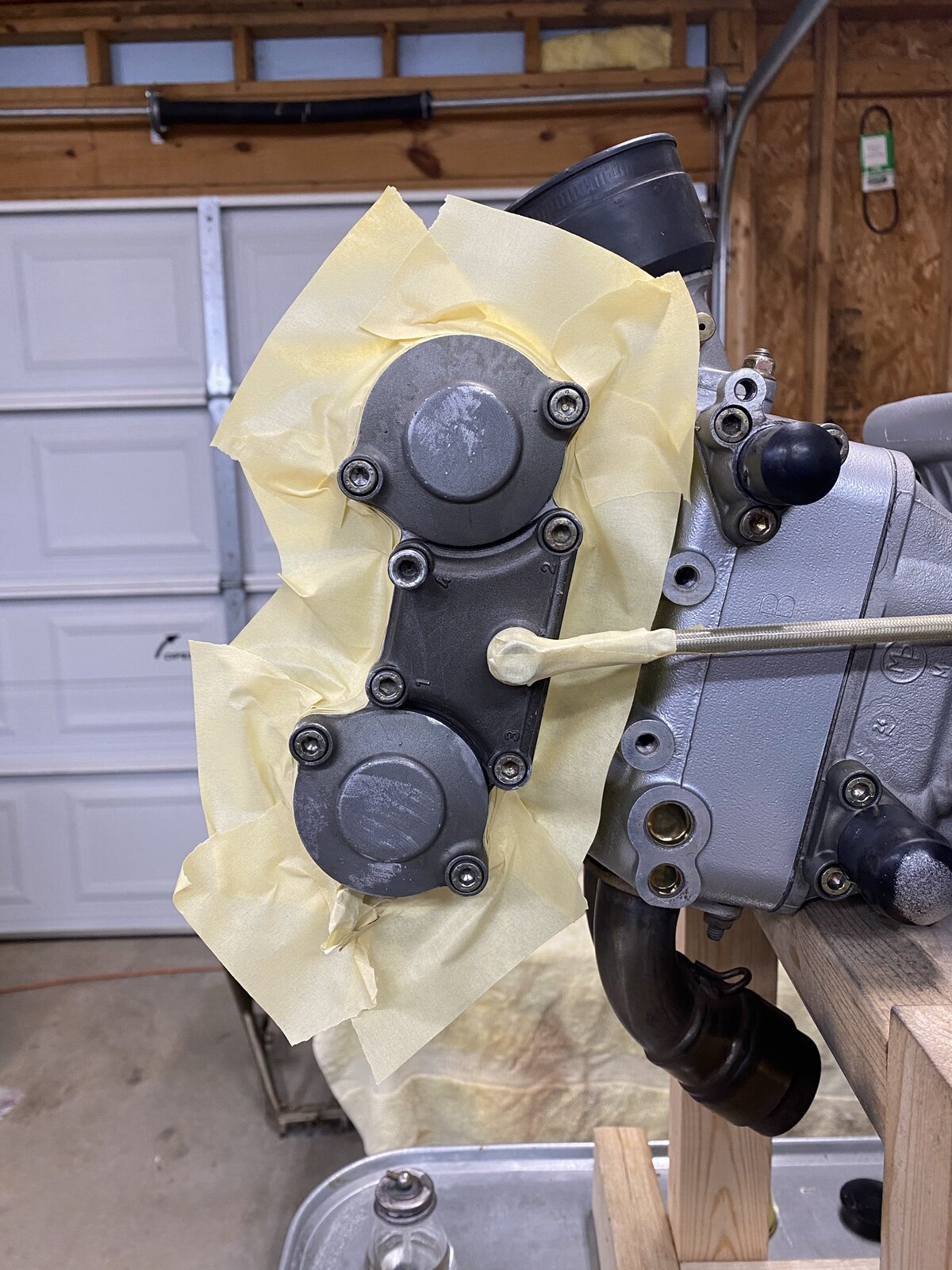

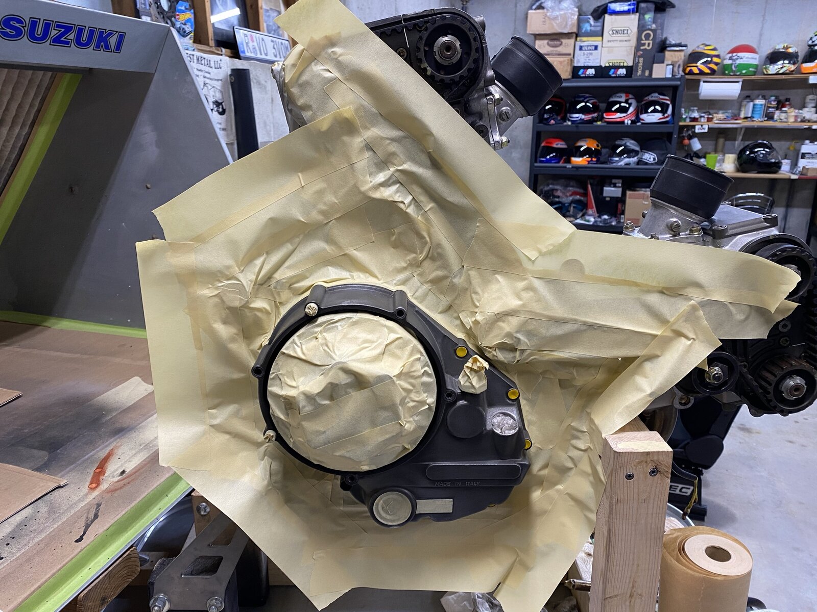

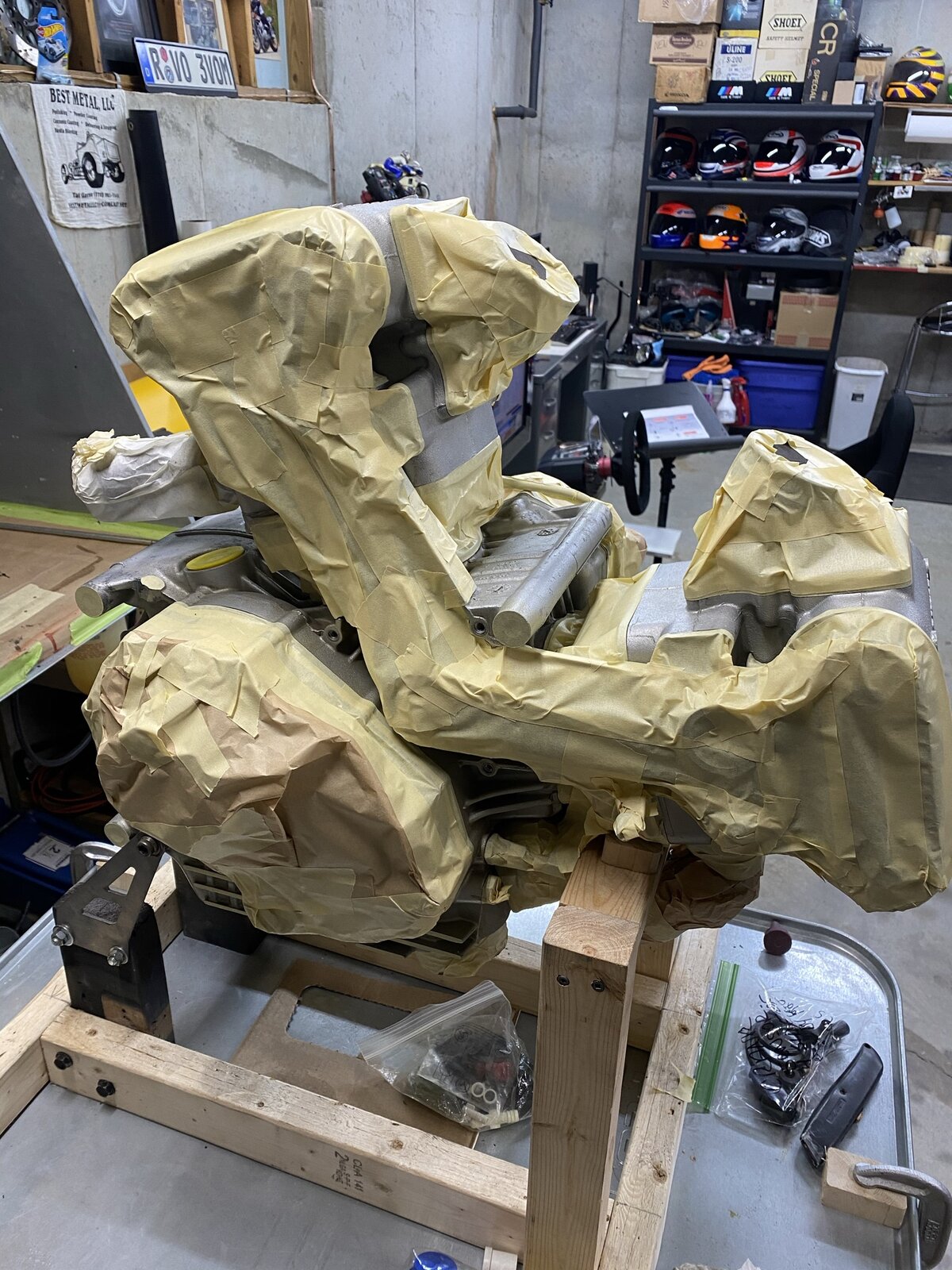

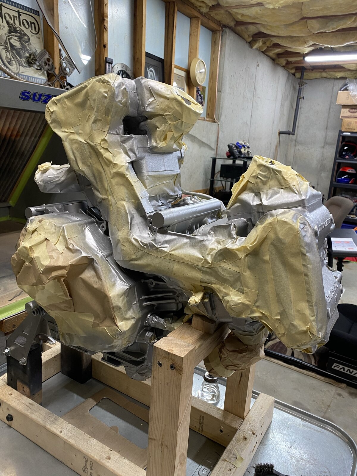

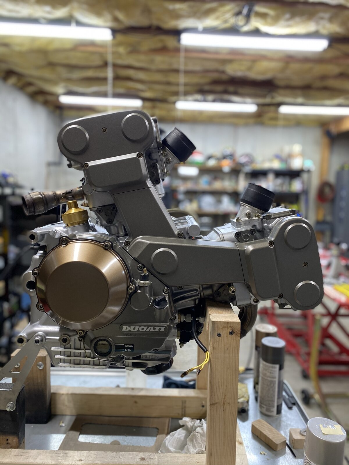

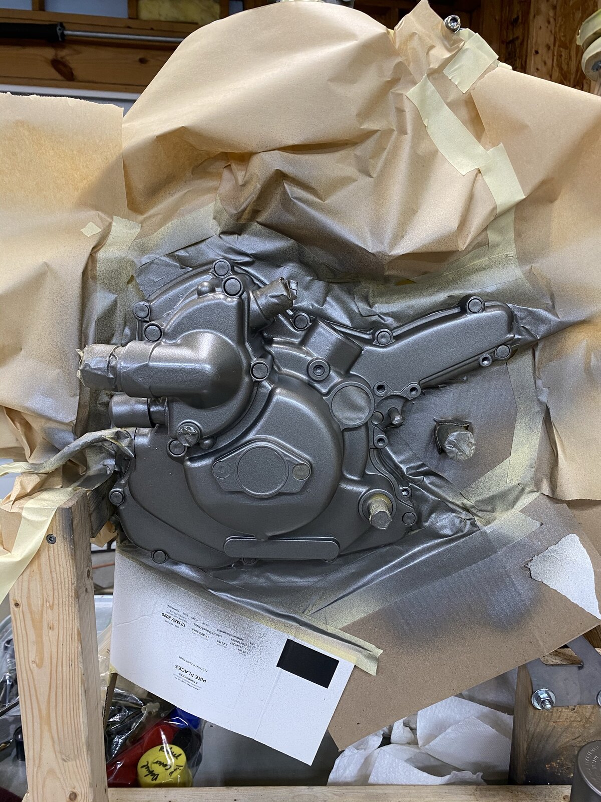

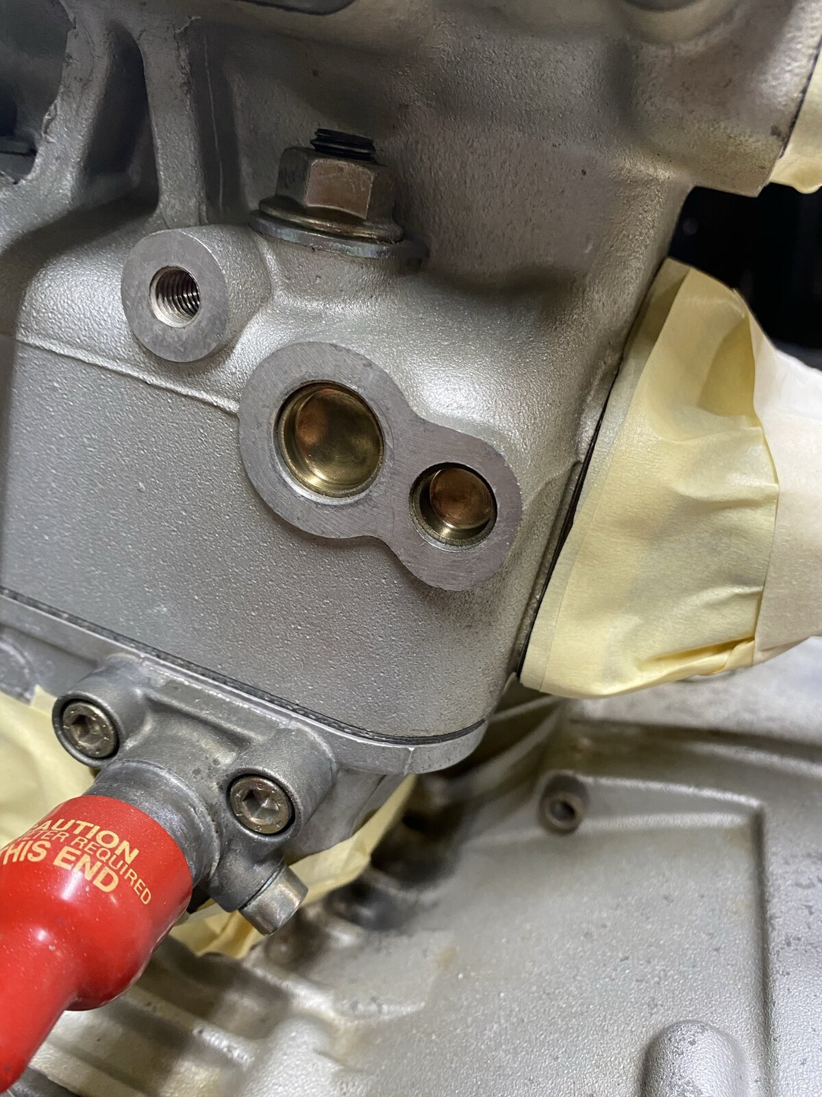

  6. Also worked on cleaning and detailing the engine. Did all of this without a complete disassembly. I'm a custom painter and good with masking off stuff so, This is the results.

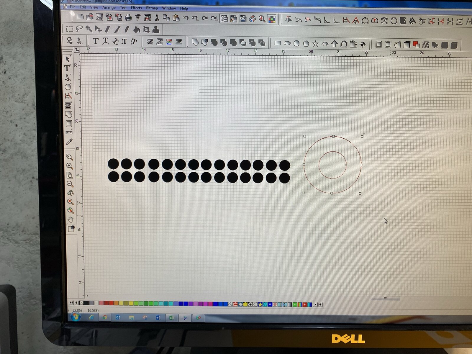

    I have a plotter and cam make masks for various parts of the engine such as seals and stuff. I used Dupli-Color Engine paint on the engine parts and wheel paint on the clutch cover see the pics.

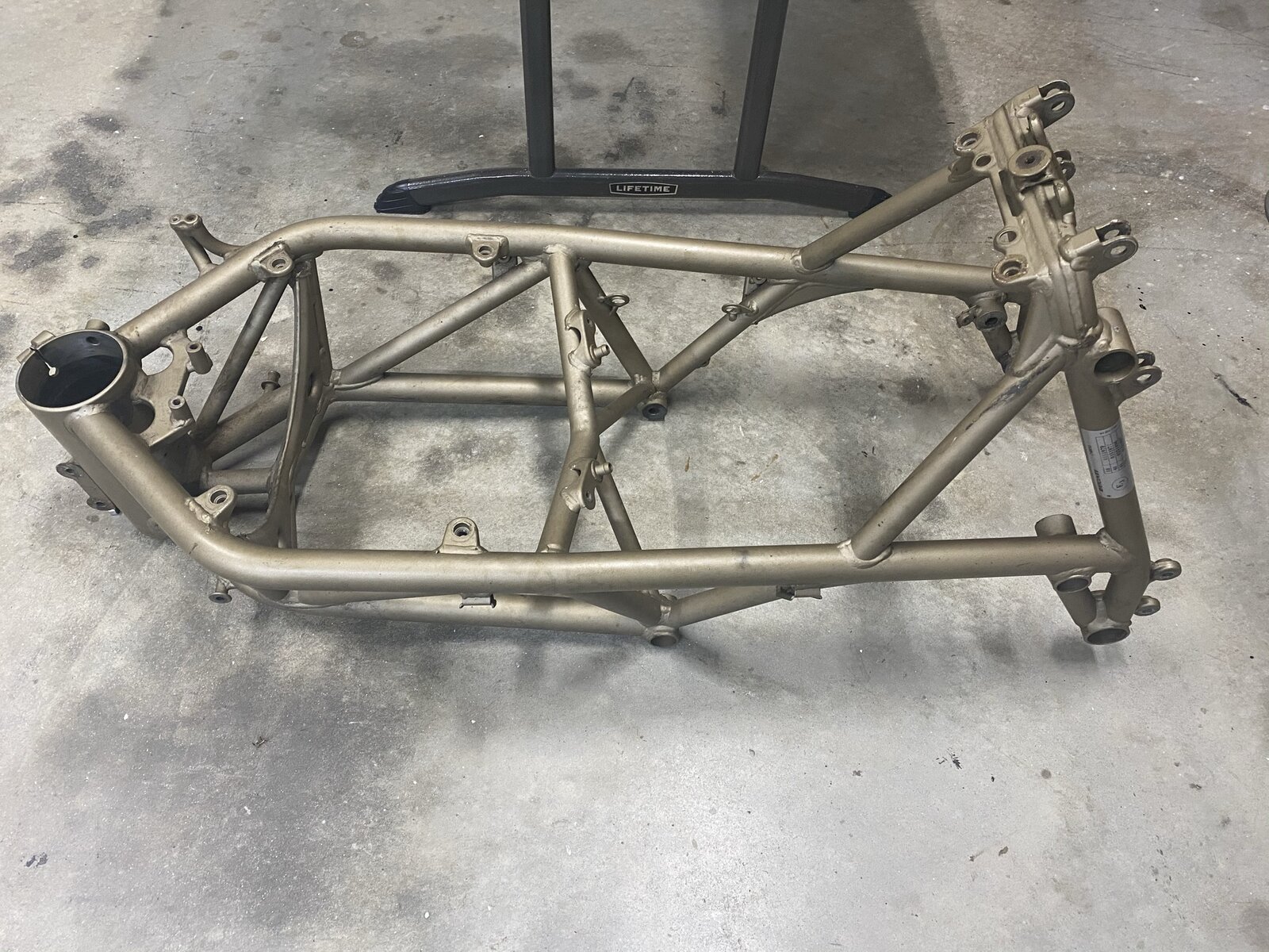

  7. The frame and wheels are off to the powder coater and will be gloss black. Then I can start putting it back together. I have to clean and paint the swing arm. I'm going with the same bronze color as on the clutch cover. Yes I know these are not standard colors, but this bike is only going to be worth something to me. It was not well loved prior to me.

  9. That engine looks fantastic. great attention to detail. (apart from the hoses, but i have a personal dislike to coloured hoses But it's each to their own)

  11. Looking good but did you consider just leaving the cases bare?
  12. Corrosion is the main concern. Not that live somewhere more susceptible, but the corrosion was already established so I cleaned it up primed and painted it. This in an effort for longevity.

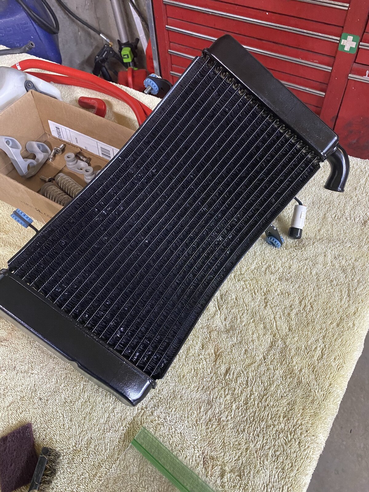

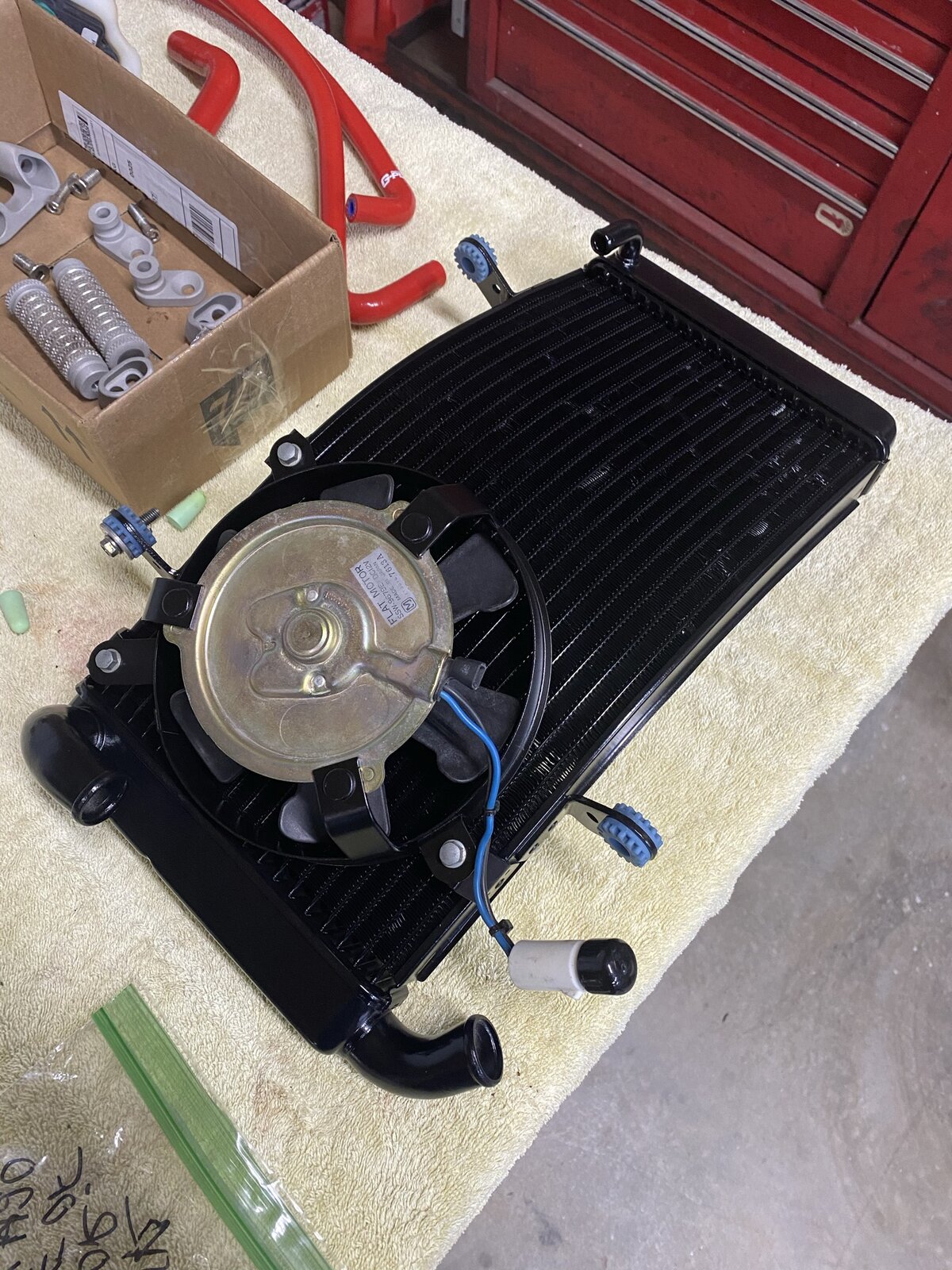

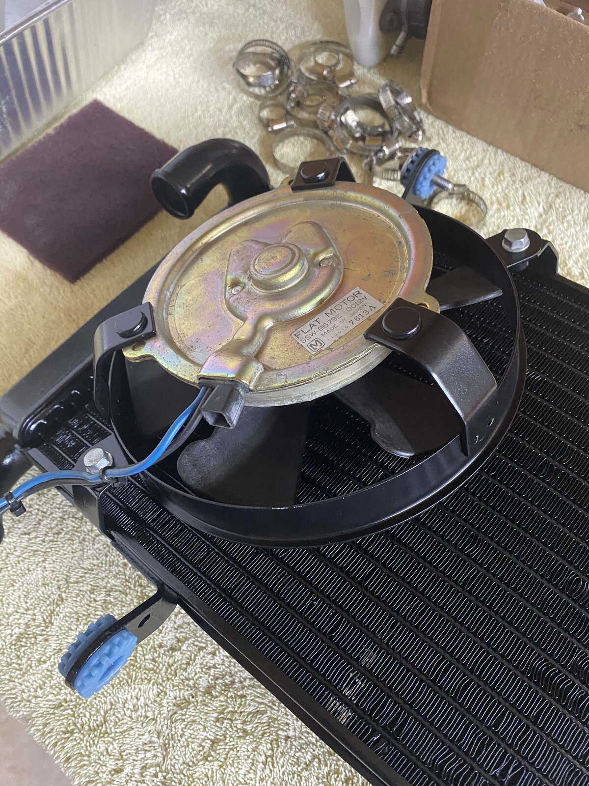

  13. Managed to sandblast and refinish the radiator. Decided on black, the lower cowl closeout will be black as well. I used NAPA Chassis paint. I've used it on other restorations and it holds up really well. I'll Scottish-brite the connection and remove the paint so it doesn't leak coolant and has a good surface for the hose to grasp.
