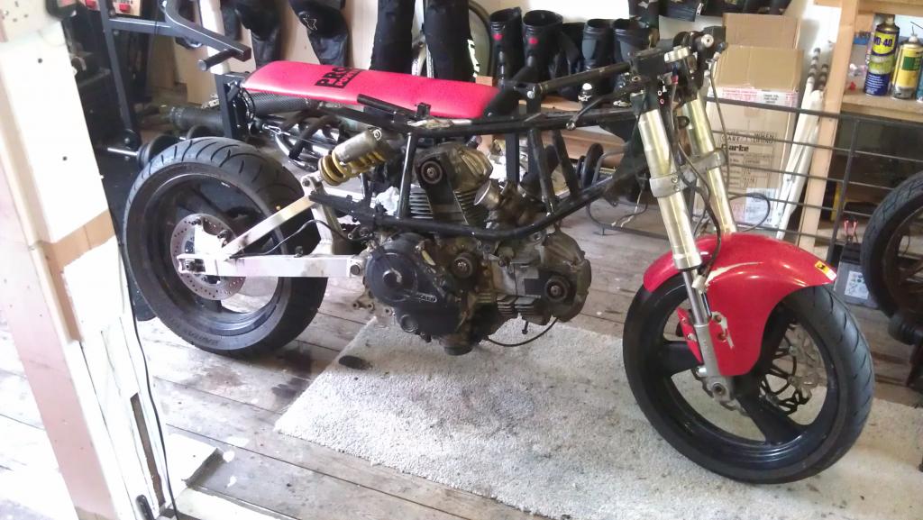

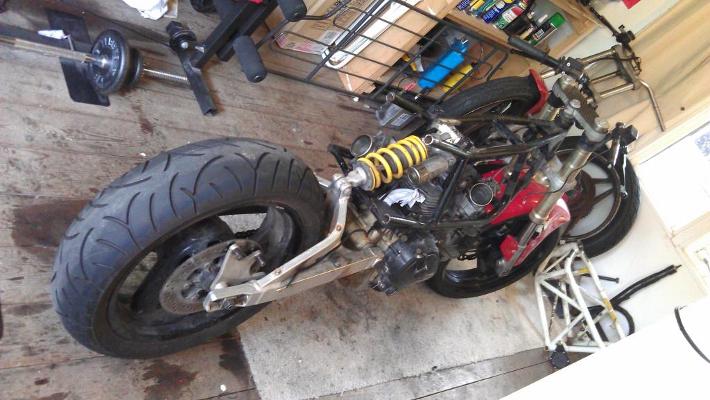

  2. OK, so today went good and bad, I found my 650 heads won't fit my '91 cylinders without mods, so it'll stay a 650 until I can source some late 80's 750 cylinders and pistons. However, I got the front and rear ends fitted, it's looking better already and at least I can move it around the workshop!
  3. Cool! What is going on with the long red seat in the top pic, are you going for the Bobber look??! :biggrin::biggrin:
  4. Why dont the heads fit, i thought the stud patten was the same with the same spigot?
  5. Nice project, I is Jealous, but please make a nicer job of the frame mods, than on the radical bike.
  6. The 650 heads have the same stud pattern but they are only opened out enough to sit on the 650 cylinders, not the 100mm OD of the 750. And yes, I'll be thinking carefully about the frame mods ;-)

  10. So why not get the cylinder head machined out to accept the larger barrel spigot, easy job for a competent machine shop. they could also reprofile the squish band to suit your new piston whilst they are on it.
