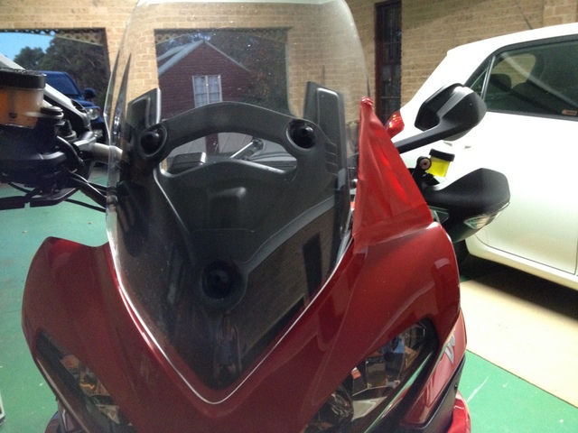

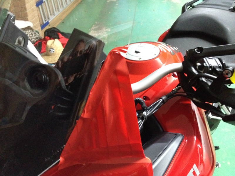

  8. Has anyone tried this approach to stopping the wind blast from under the screen. You could fill the space with a flexible material that would deflect the wind like a sail and allow the handle bars to move to the full lock position.
    As soon as I have time I intend to use heavy duty masking tape to see what happens and if effective shape a piece of red material (perhaps leather) to attach to the screen and fairing. The two fasteners on the fairing could be used to attach the bottom of the "sail".
  9. Front on it would look something like this
  10.
