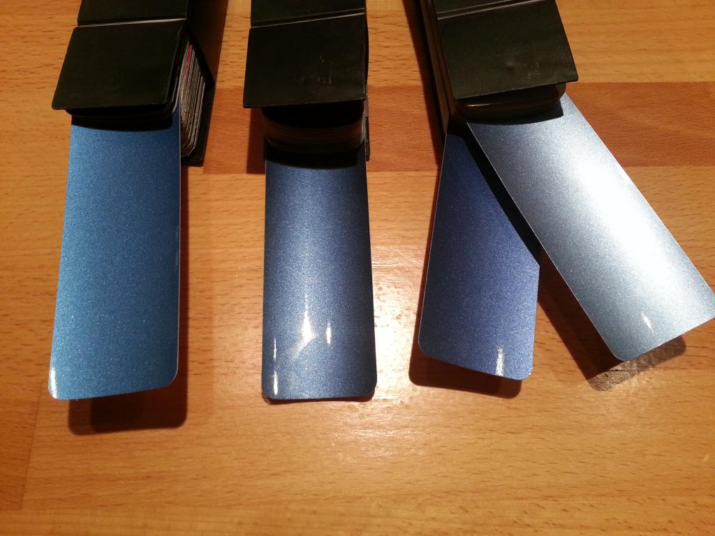

  13. Ok, it's getting there! The motor is primed and ready for some paint. Once I find the piston circlips it can even go back together! My painter has primed all the bodywork, I just need to settle on a colour. I want it close to the original Pantah blue, but it doesnt need to be spot on. The far left swatch is the closest to my eye? What do you guys think, it's a long time since I've looked at a blue Pantah!

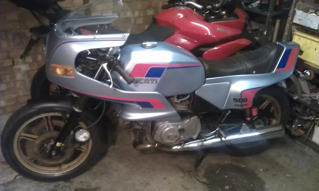

  14. Try this colour (but looks slightly bluer in reality than in the photo):
  15. Thanks Pete, it's lighter than I remember. I've had another look at the chips and the Mrs agrees. I've settled on a nice light metallic blue as used on some Peugeot and Citroën models. I'll post the pictures when the bodywork is back. My only worry now is that the OE decals I sourced from Holland are still usable.
  16. By the time you've photographed it and put it on a computer, and I am looking at it on another computer, I doubt my opinion of your swatch is very useful, but all things being equal, it looks more like the one on the left. Can you not get the original spec from Ducati? Or you could send a swatch book to someone like Pete to check against a real Pantah.
  17. I understand what you're saying. The colours are spot on for how they look on my notepad, and it's only a rough idea. The colour doesn't need to be an exact match, close enough is good enough :upyeah:
  18. In which case any of them is going to look good, although the one on the right is a bit more run-of-the-mill and silvery - almost 600 Pantah rather than 500.
