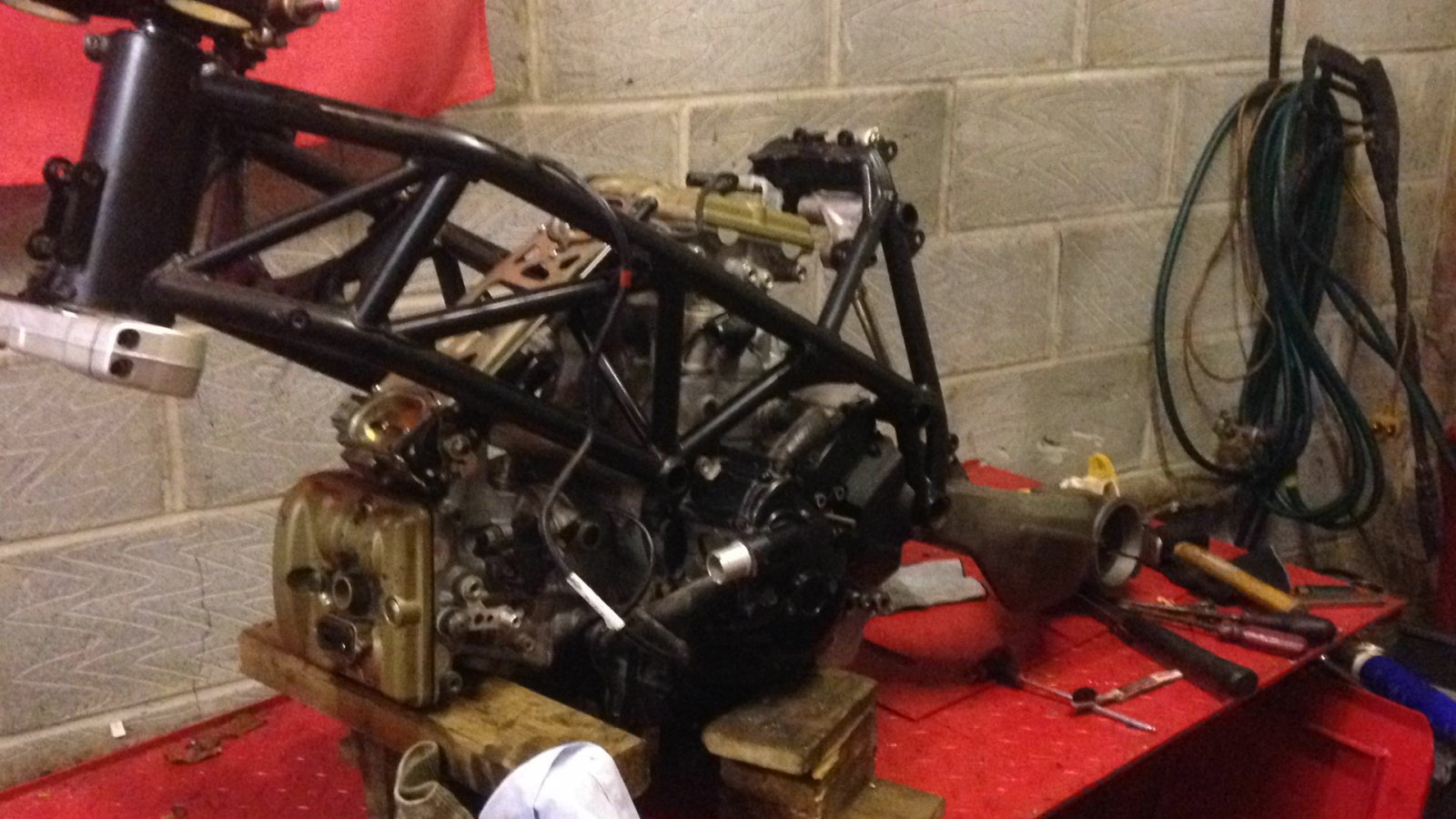

  6. you building another?
  7. he's always building another
  8. Having a dabble :)
  9. post pics dawg!
  10. Don't want to hijack, so I'll start a separate thead at some point.
  11. Feel free to hijack
  12. (his engine needs a clean)
  13. Humph!
  14. I'm hoping thats on its way apart, not together ;)
  15. The project will always suck up more money than you had planned.
    Start with the airbox conversion and work out from there. If this is done right, the rest will slot into place.

    airbox is coming together, main new base is in gf then being skinned in cf. fits nice, just final skinning to finish on the inside, tb linkage nice and clear of airbox.
    Mount injectors next,
    Nelson, what do you do with coils, i have stick coils but going to use 996 ones initially as i know it works?
  17. Stick with the 996 ones with the 996 loom. Although you may have to consider plug cap length.
    There was huge debate on MS as to wether the sticks would work with the 996 loom/ecu. It was never concluded IIRC.
    I go with 1098 loom and ecu now.
  18. Yeah, I saw all the stuff about sticks working or not, which is why i'm going 996 coils. Cap length i have just trimmed the shroud cap so the plug leads snap on as the should but the top sits slightly lower down the plug hole. Coils still fit to original crossmember mounts and no problem with length.
