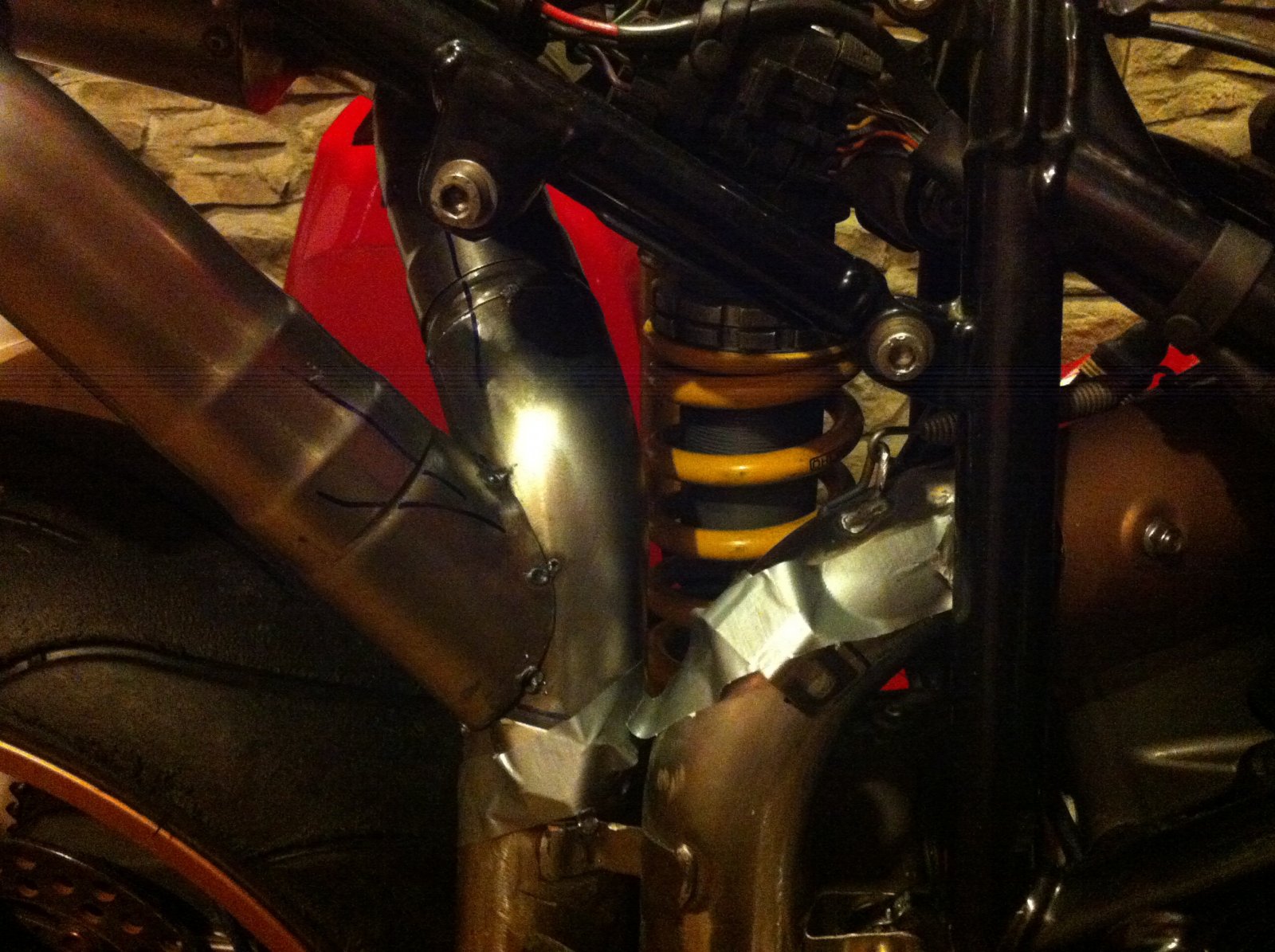

  5. I am building it with just a stock system but will measure it in the morning.
    Hoping to get my cuts welded up over the weekend. Only the rear section i have cut as everything else fits other than one of the lamda plugs which is right under the swingarm. That will be moved incase it is needed at a later date, as the 996 ecu didn't need it.

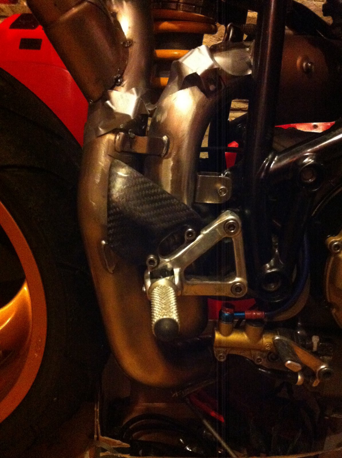

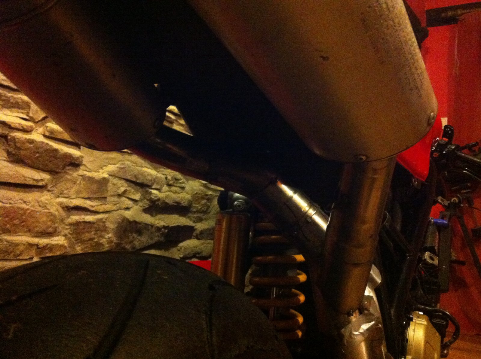

  6. The headers on my system are 52mm going up to 56mm where the pipes are linked then my silencers are 52mm as i am using my old cored tails of my 996. The only cuts are from where the 1 branches back out to 2. image.jpg image.jpg image.jpg

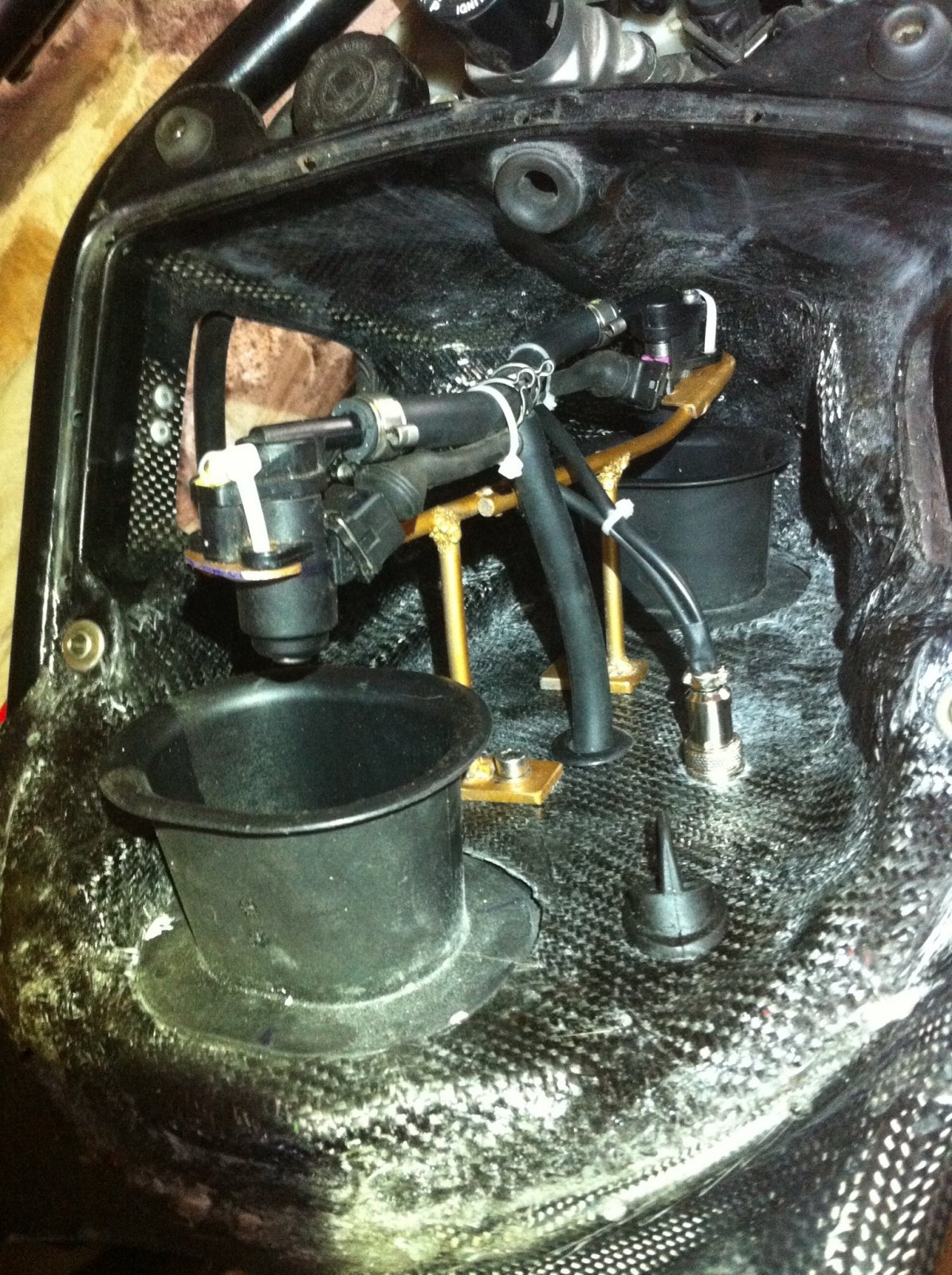

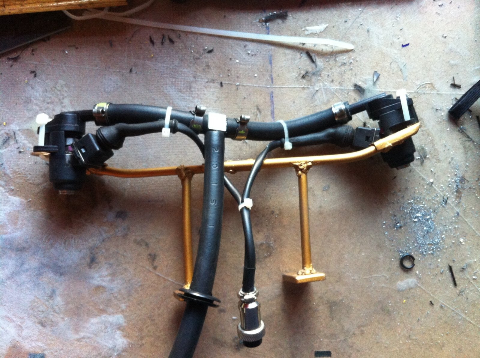

  7. Airbox and injectors all sorted except a few nuts, bolts and connectors. image.jpg image.jpg

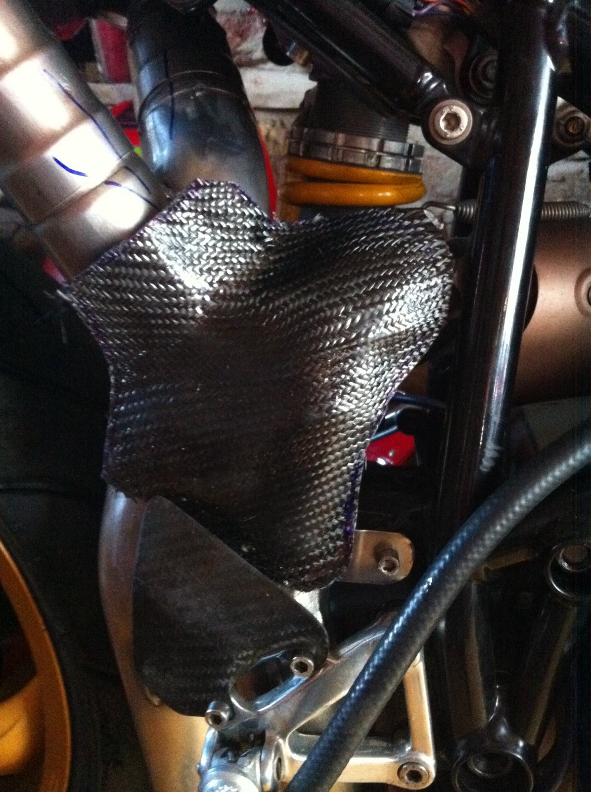

  10. Will that system be big enough for the larger motor? I think the 1098 runs a 60mm as std (not certain tho)
  11. I've read so many different things Paul, so I am going with it and see how it all pans out once up n running and eventually dyno setup, will need to gain a power commander for that though.
    Not overly worried about flat out free flow of exhaust as a big chunk of my riding is road based so smaller pipework for greater low/midrange.
    Time will tell.
