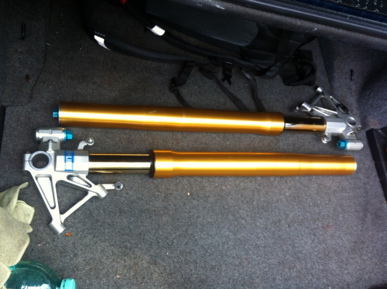

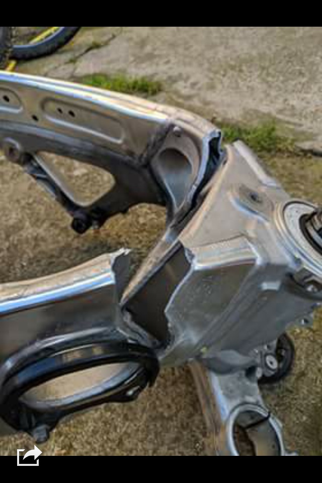

  3. They were effectively beyond ecconomic repair compared to the costbof buying a 2nd hand good set. The lad has put showa's on but is going to get some öhlins cartridges, so I may be sble to swing a deal on that thru my öhlins mate.
    To be honest I was expecting them to have been folded in half after seeingvthe frame.

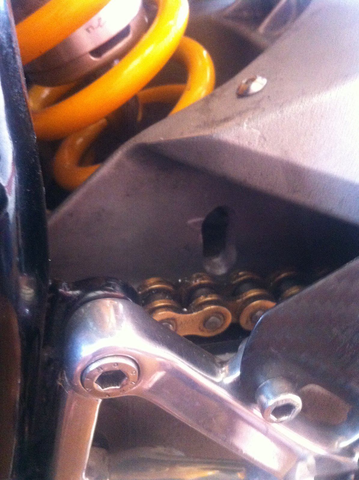

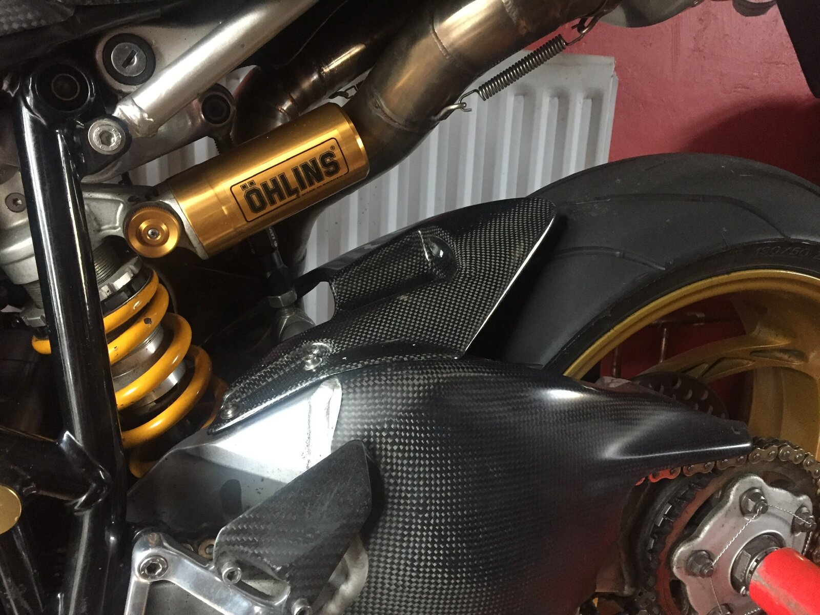

  4. Ot a lot to report of late. One small thing that needed doing was modding the swinarm to be able to adjust the rebound properly. So drilled hole and slotted the casting to enable access to the adjuster.

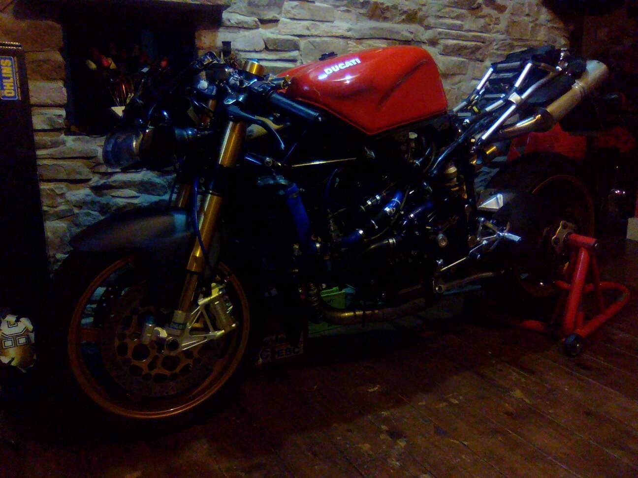

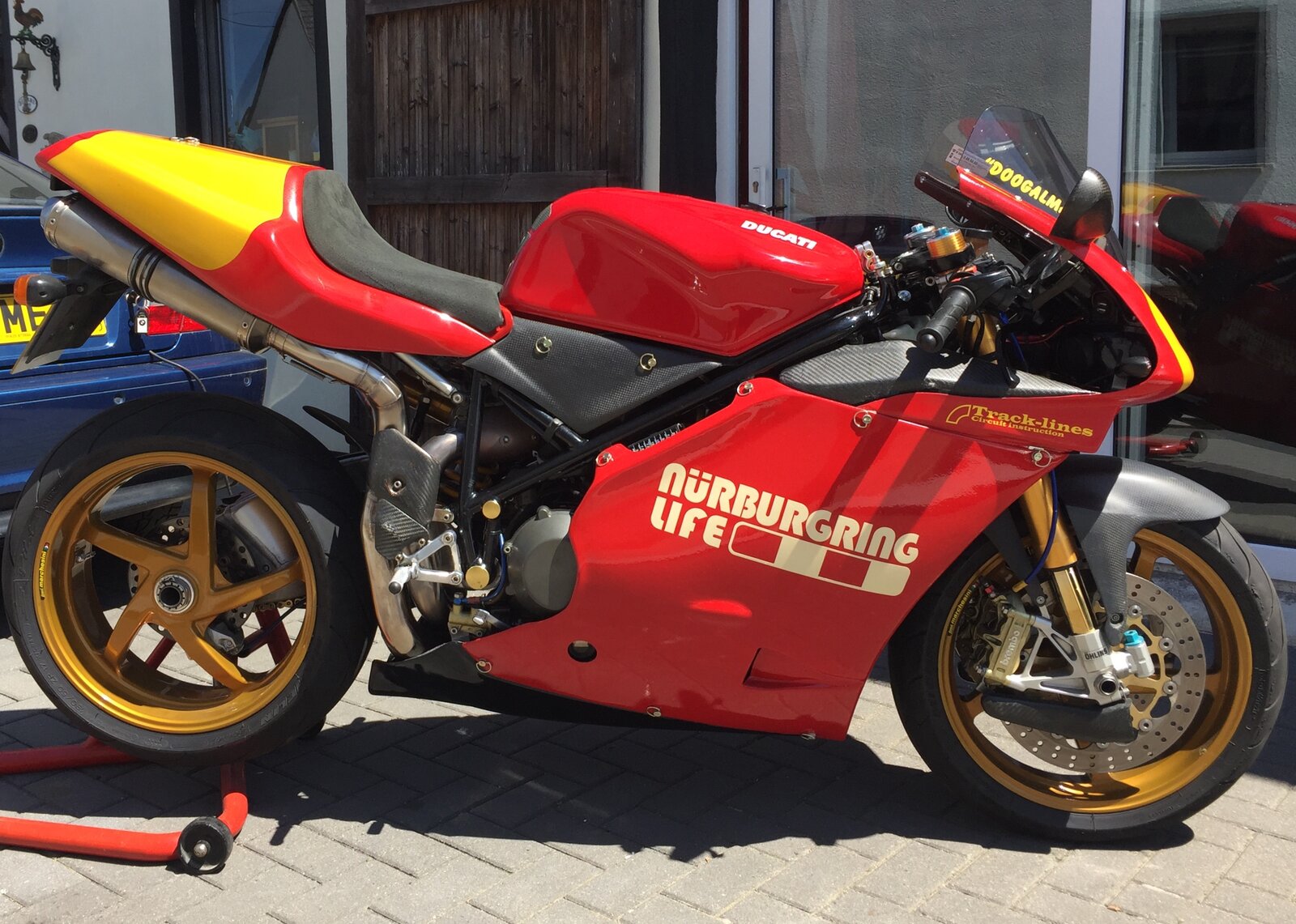

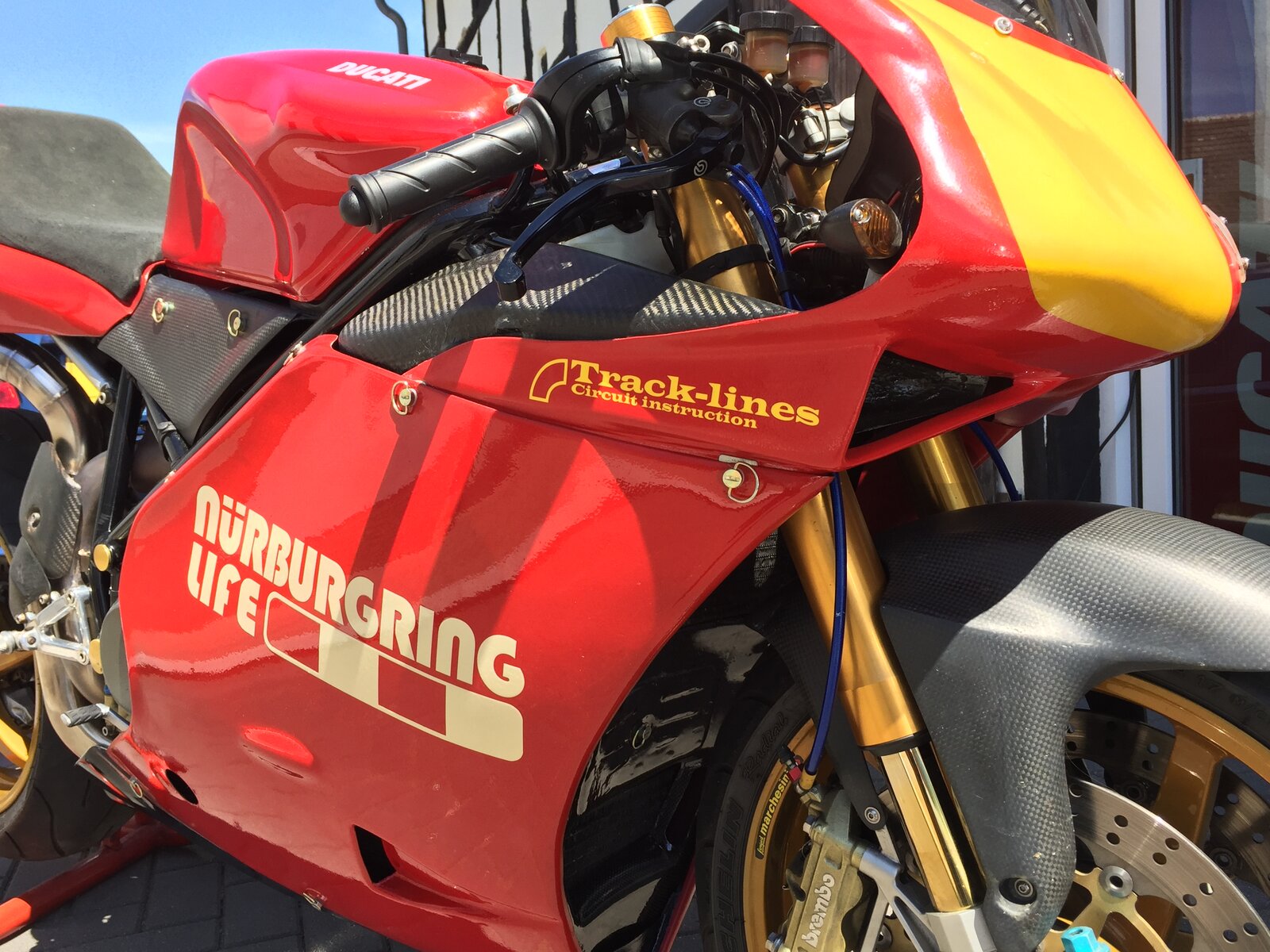

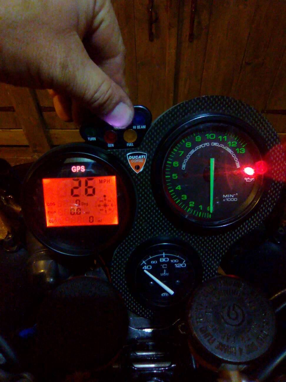

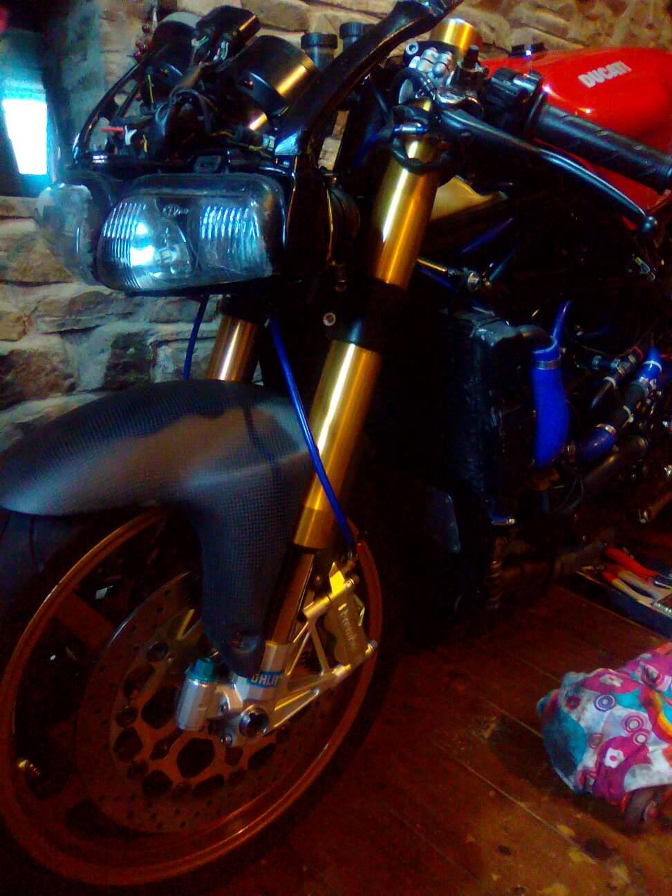

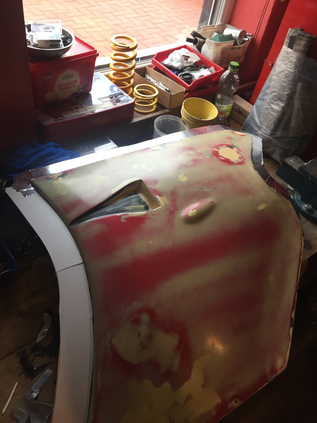

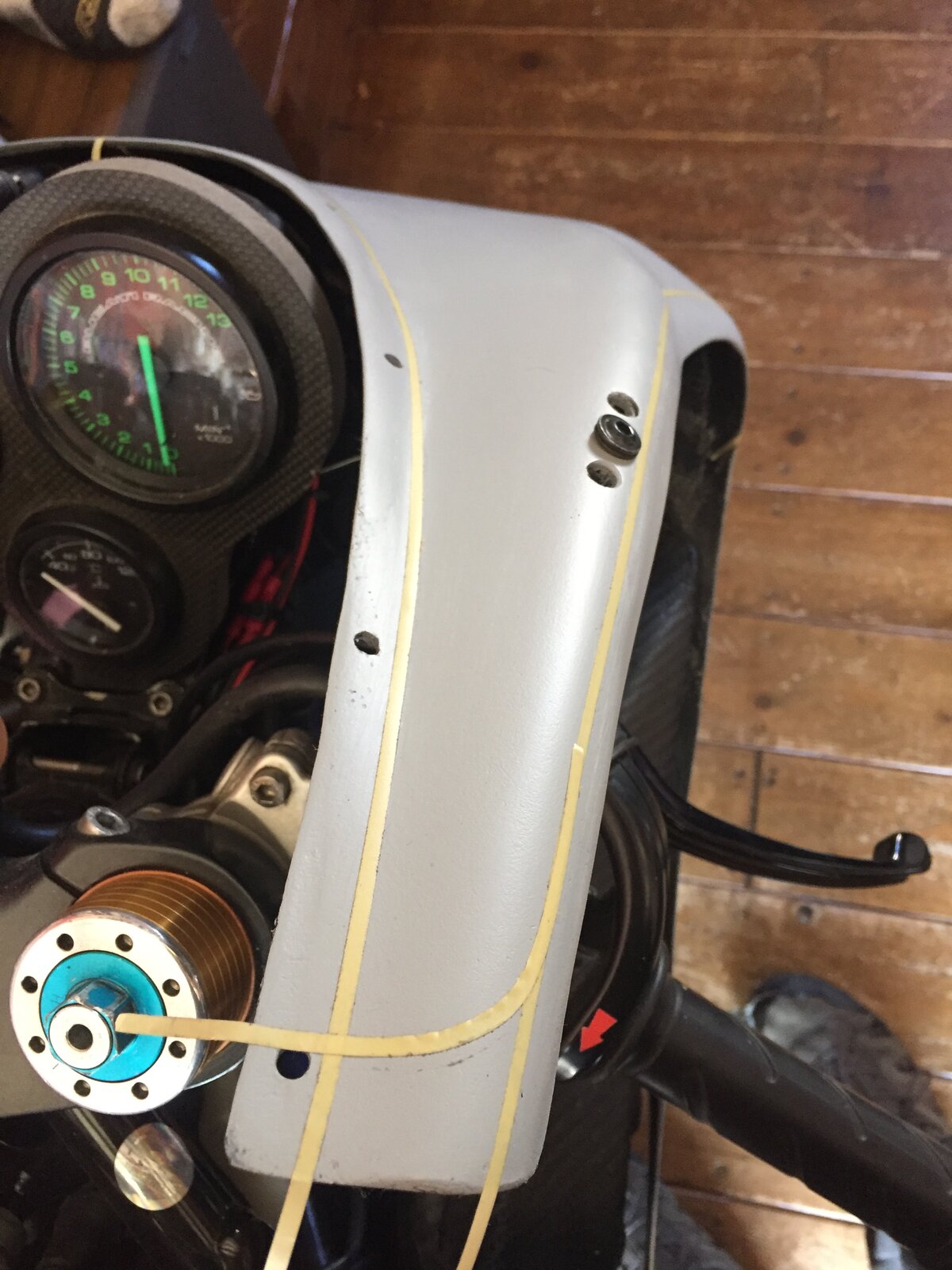

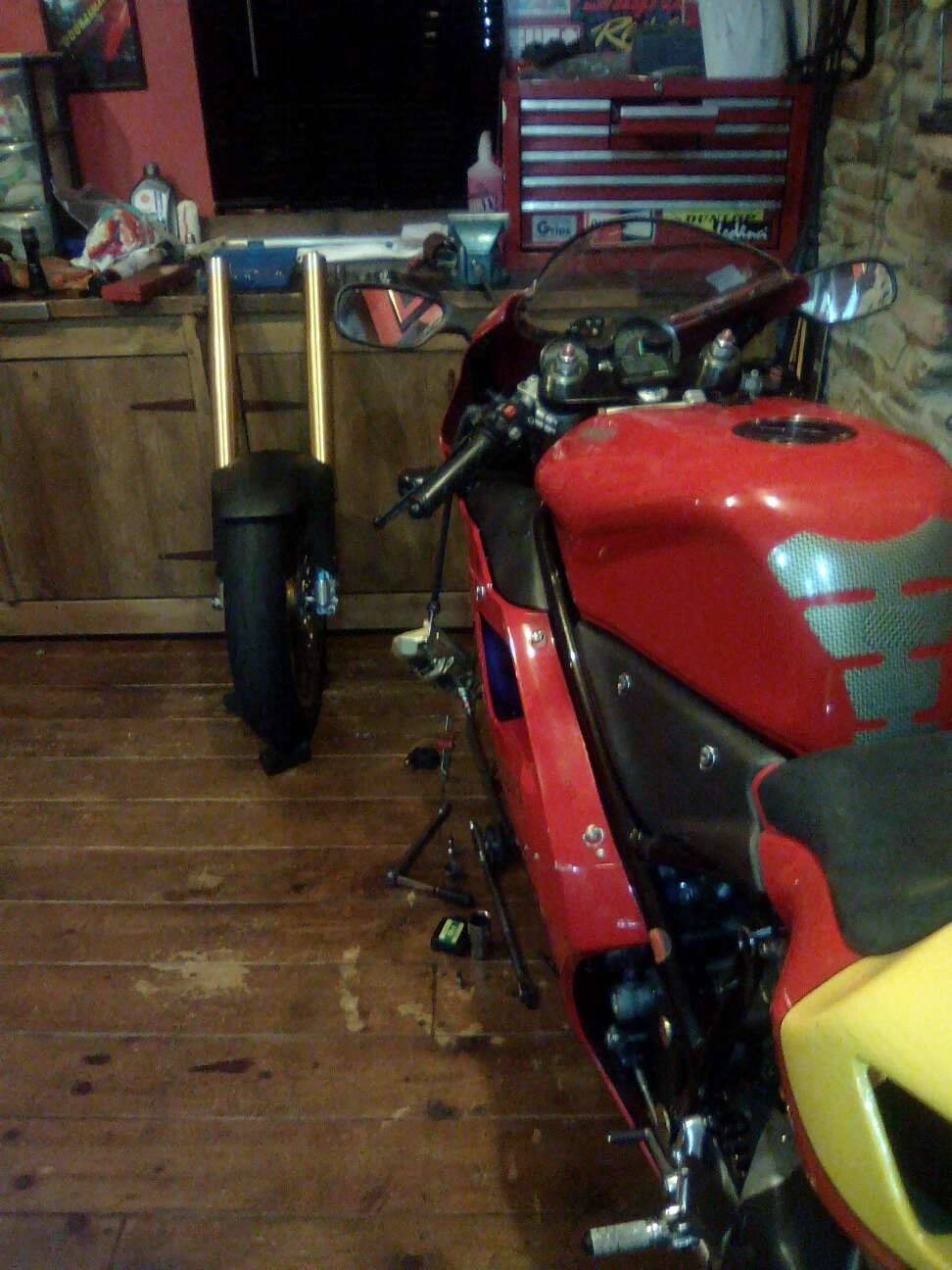

    Anyway, spent some time in the uk for nov/dec so gathered a few bits n bobs. Main thing was some machining from FE. Winter plan is/was to fit the FG016 forks and do some other tidying up of stuff. Picked up a ratty old front mudguard from a gen 1 rsv100 that I stripped the paint from and made good. RSV gen 2 looked wrong to me as too angular so went straight for the gen 1
    well the forks are in. Main issue involded was to hope my measurments all added up correctly and that the pieces would fall into place. Had FE machine an axle and some spacers up. Got a mate of a mate over in Belgium to machine the bottom yoke to 56mm from the 53mm that was standard for the showas. The FG016 is 51mm top so that was just a case of sleeving it down from the 53mm. ONly snag that I had forseen was that there may or may not be space for the speedo drive. Looked at various options and decided to put a gps speedo on the bike in place of the original (Glass was starting to crack anyway).

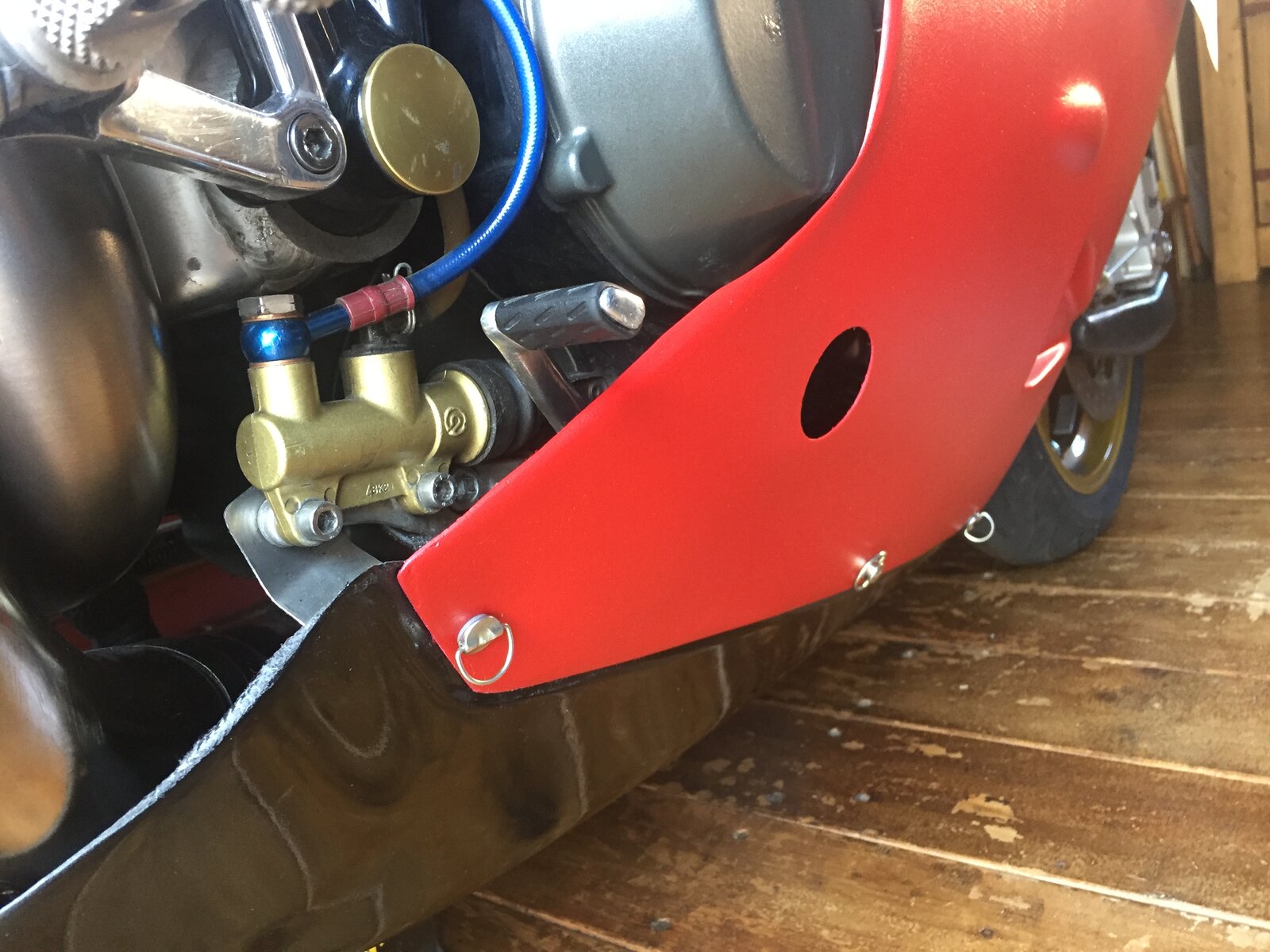

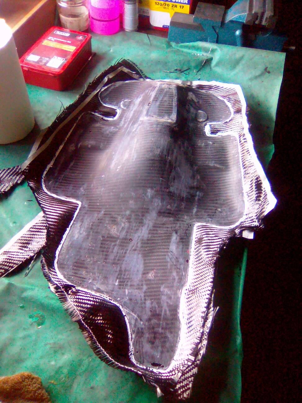

    Also finally got around to finishing the undertray. The pics are of it in an unfinished state but overall I am pleased with the result. Not perfect but I can see where to inprove next time. May look into the idea of making some mouds next winter to maybe have a goat at making a fairing in carbon.

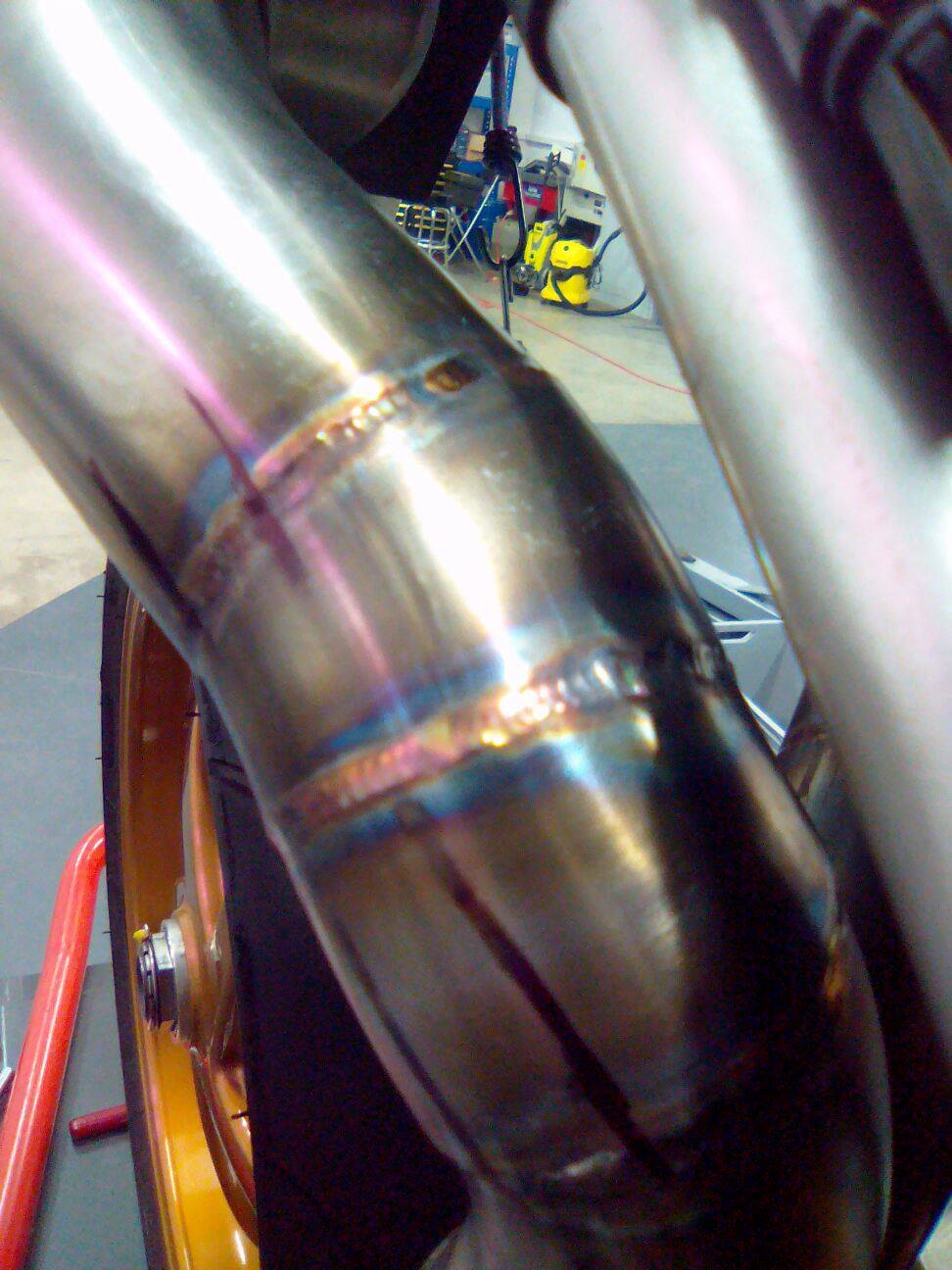

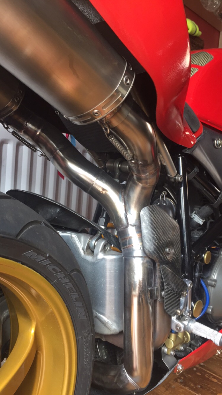

  10. Small update. A good friend has started a workshop buisness of his own. Primarilly car related stuff but he is a keen biker and owns a couple of Ducati's. So yesterday he and I made a start on the rear half of the exhaust system.
    He admits his welding is not quite up to as he is way out of practice and familiarising with a new setup minus pedal. Looks ok compared to my pigeon shit style of welding. Gonna finish the job maybe tueday so will post pics when done.
    52075915_380387289424862_5302201972328235008_n.jpg 51726546_732663483794013_7800975393514586112_n.jpg 51480983_1139782772846830_2302504651393597440_n.jpg
    • Like Like x 8
  11. Nowt wrong with that welding. Looks a decent job.

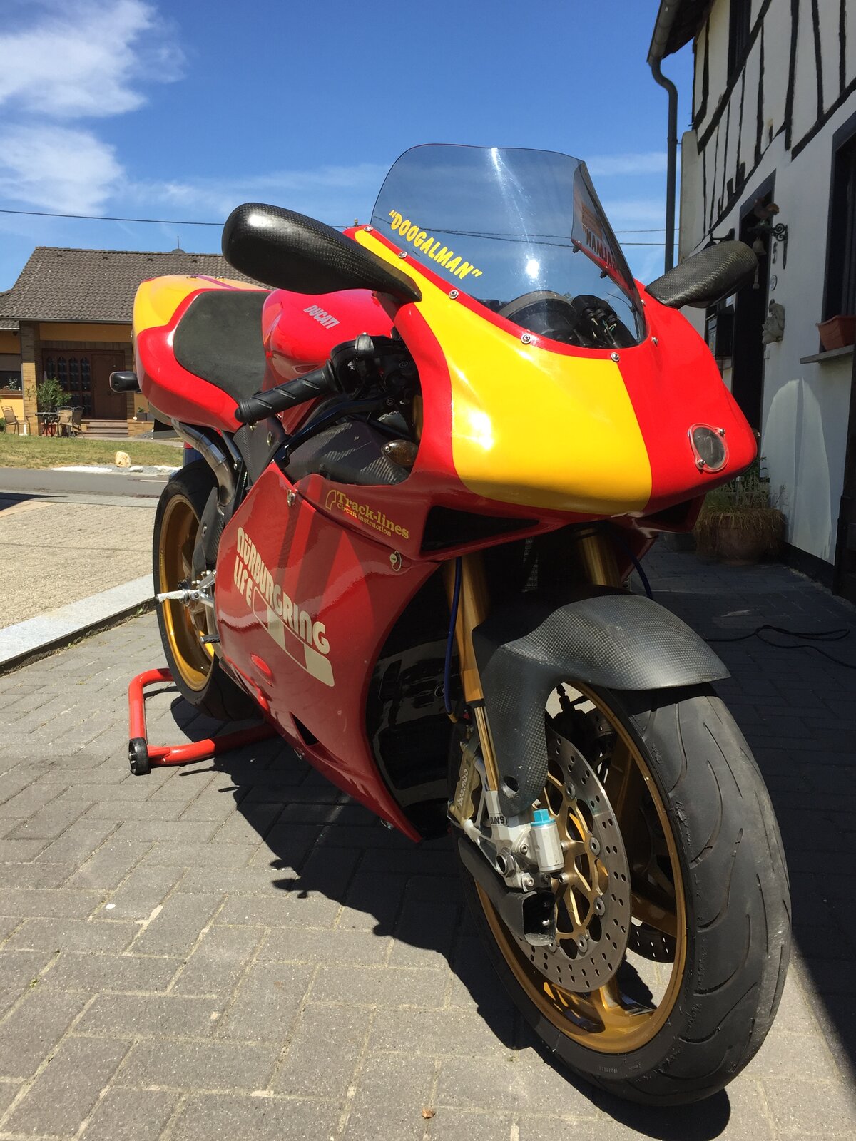

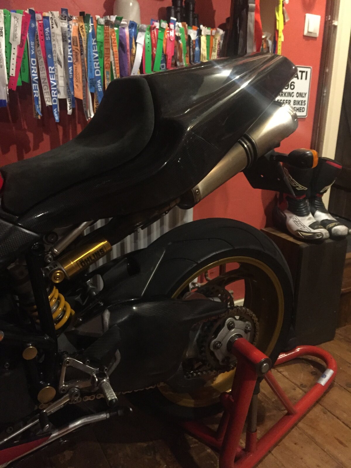

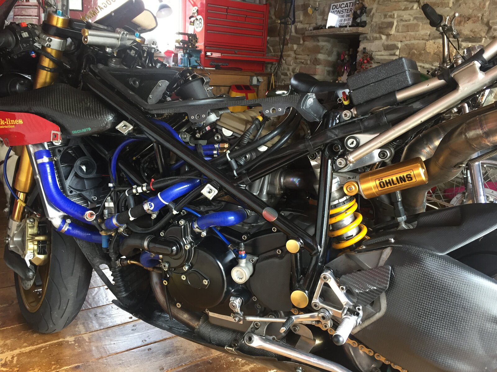

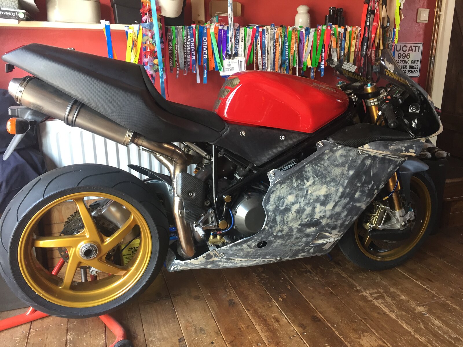

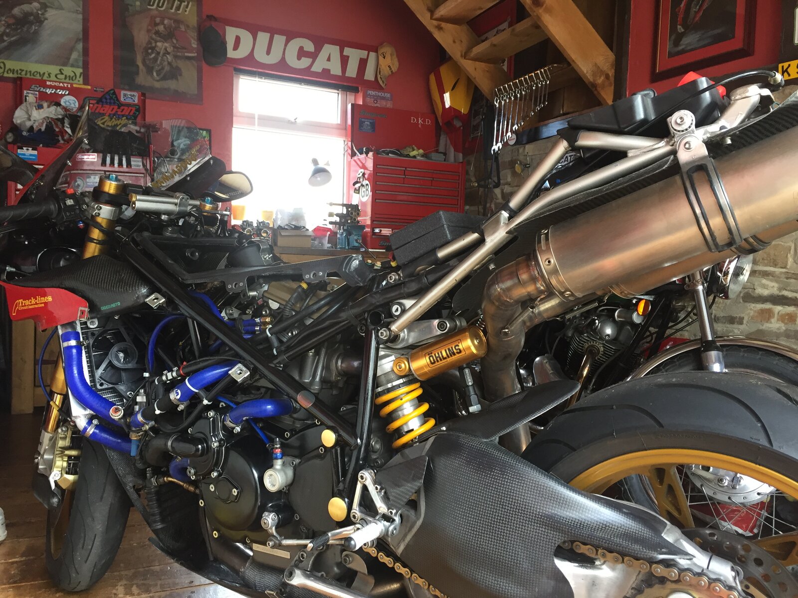

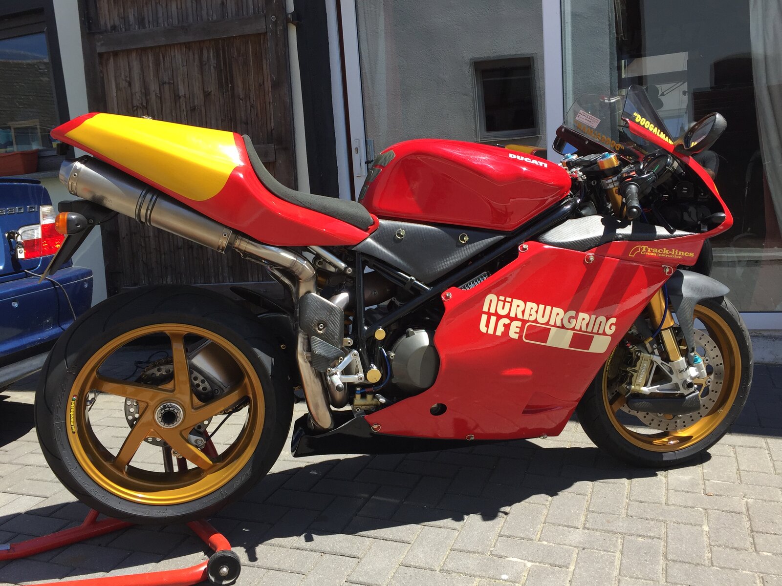

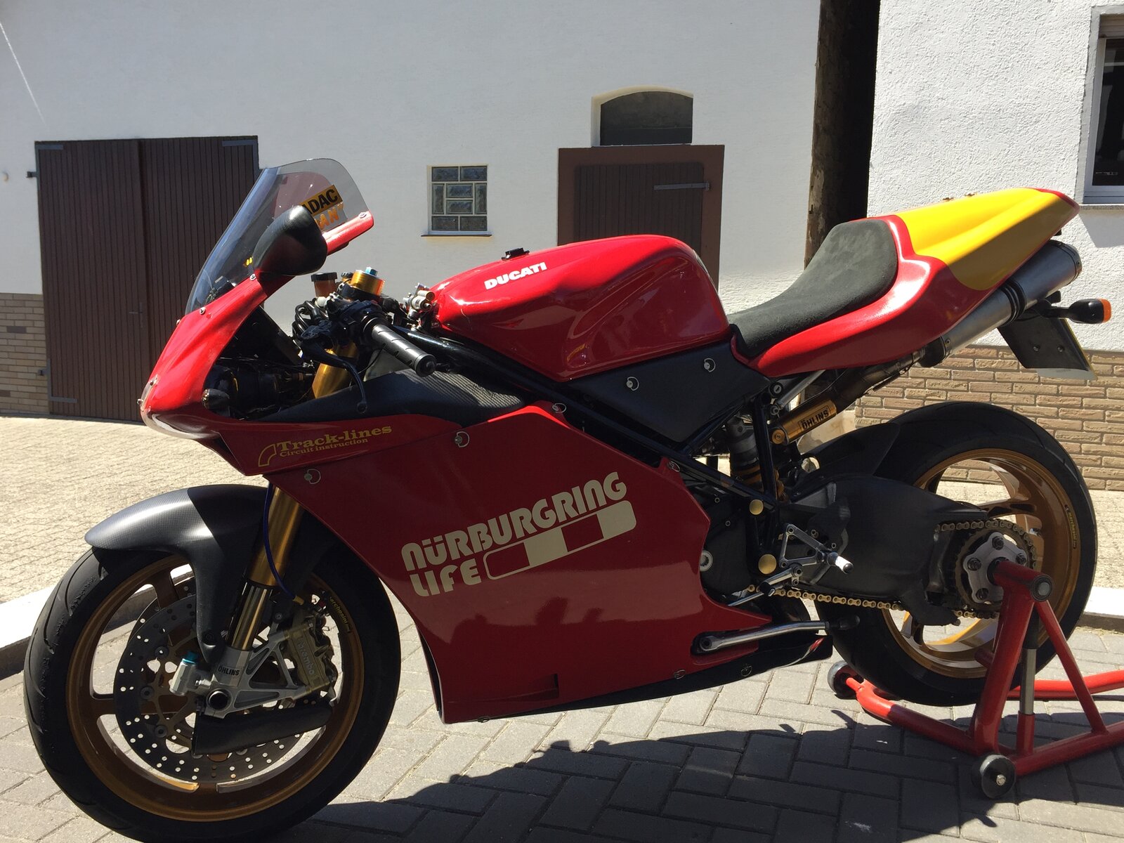

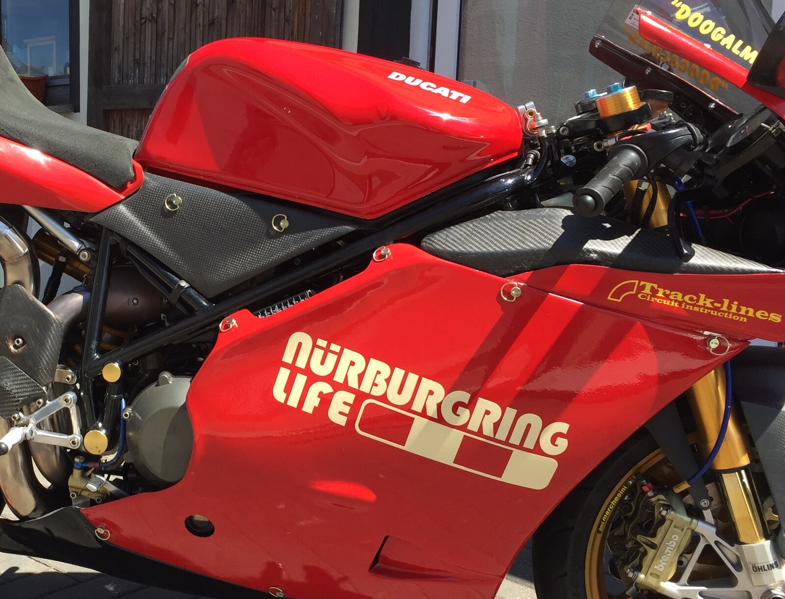

  12. Right, a long time since I did an update so it may be a bit hotch pitch and out of order.
    I’ll skip the fine details and try and keep it simple.

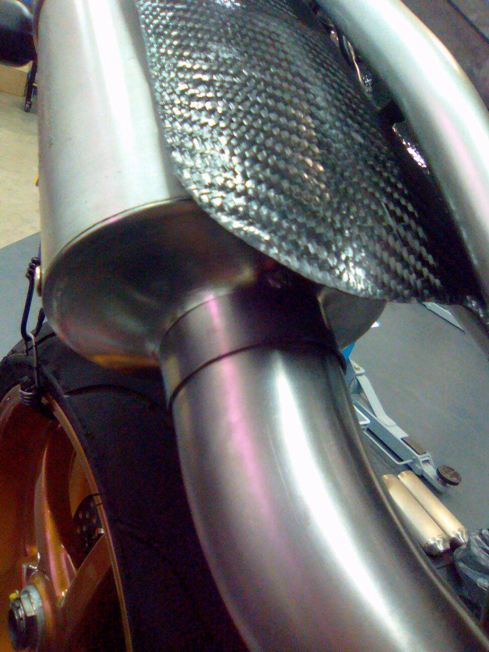

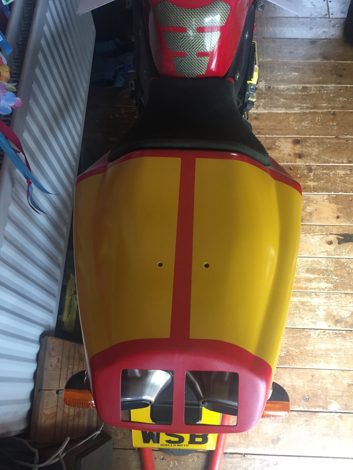

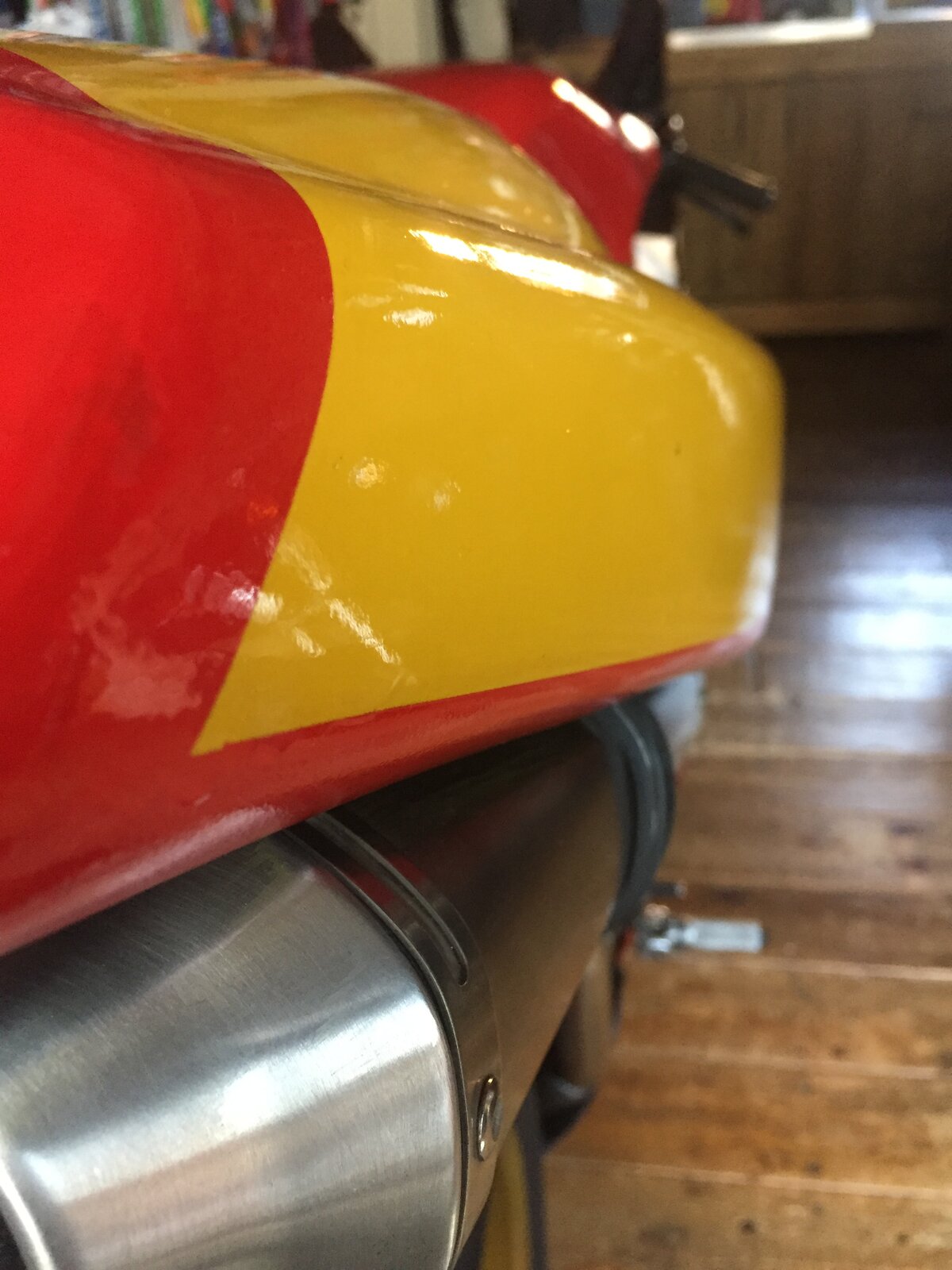

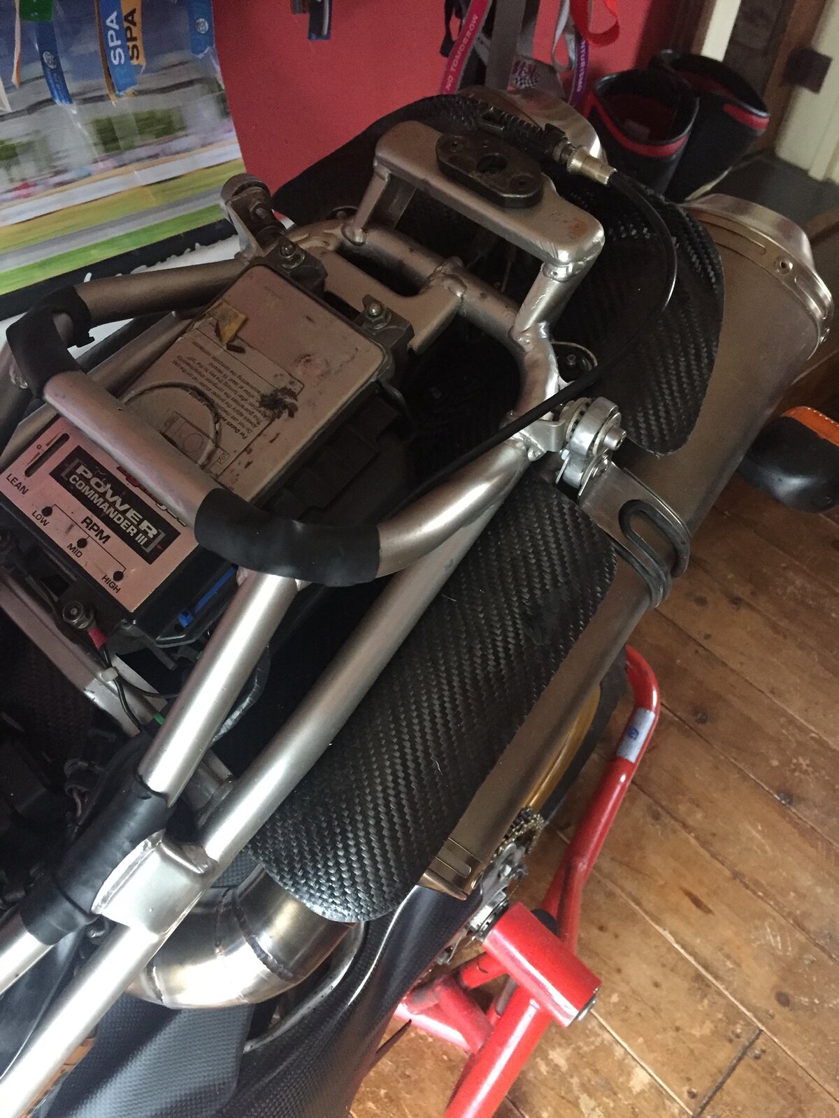

    So last posts were st about the time we sorted out the exhaust. Of which I have a choice of sort of cored out stock cans, for when I want to make a noise. I also have a set of stock 848 cans which have been adapted slings with the noisy pipes to be a simple slip on arrangement secured to the pipework via springs.

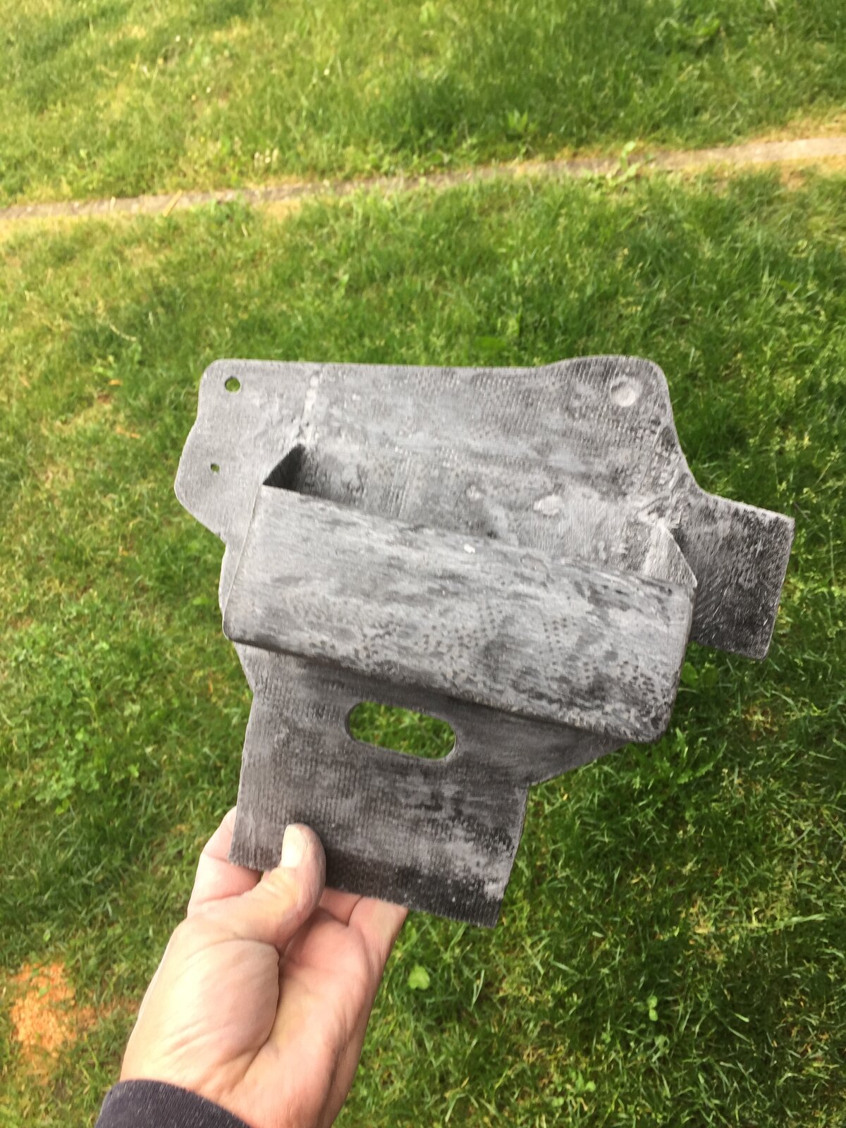

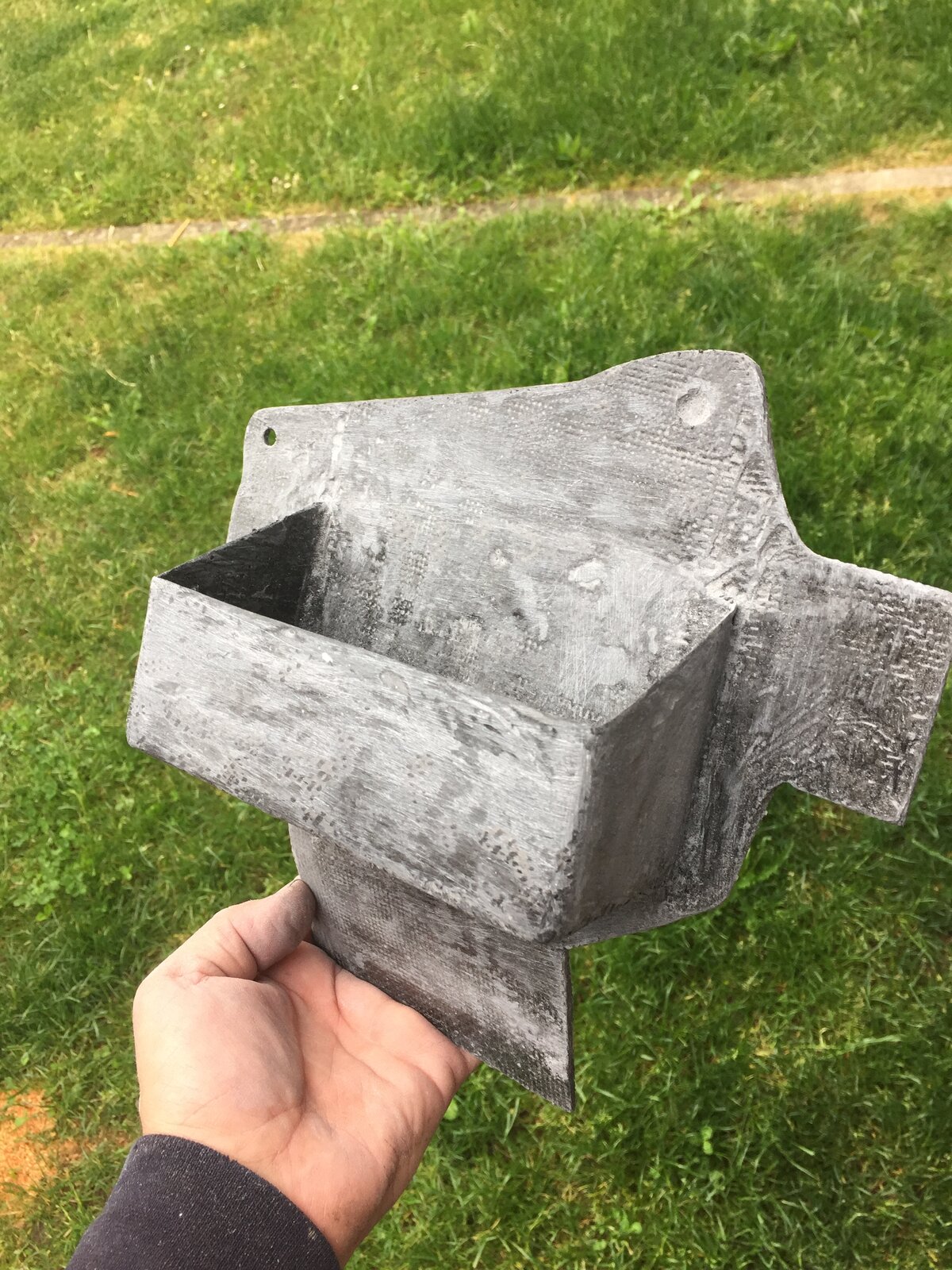

    Of the two sets of pipes I generally run the 848 cans as the bike is used in Germany mainly and they are not too keen on the loud bit. Only downside is that the area above the cans where the cat lives gets hot enough to damage the carbon undertray that’s made. So a simple application or two small sections of motorsport heat shielding to the underface of the tray sorts that.

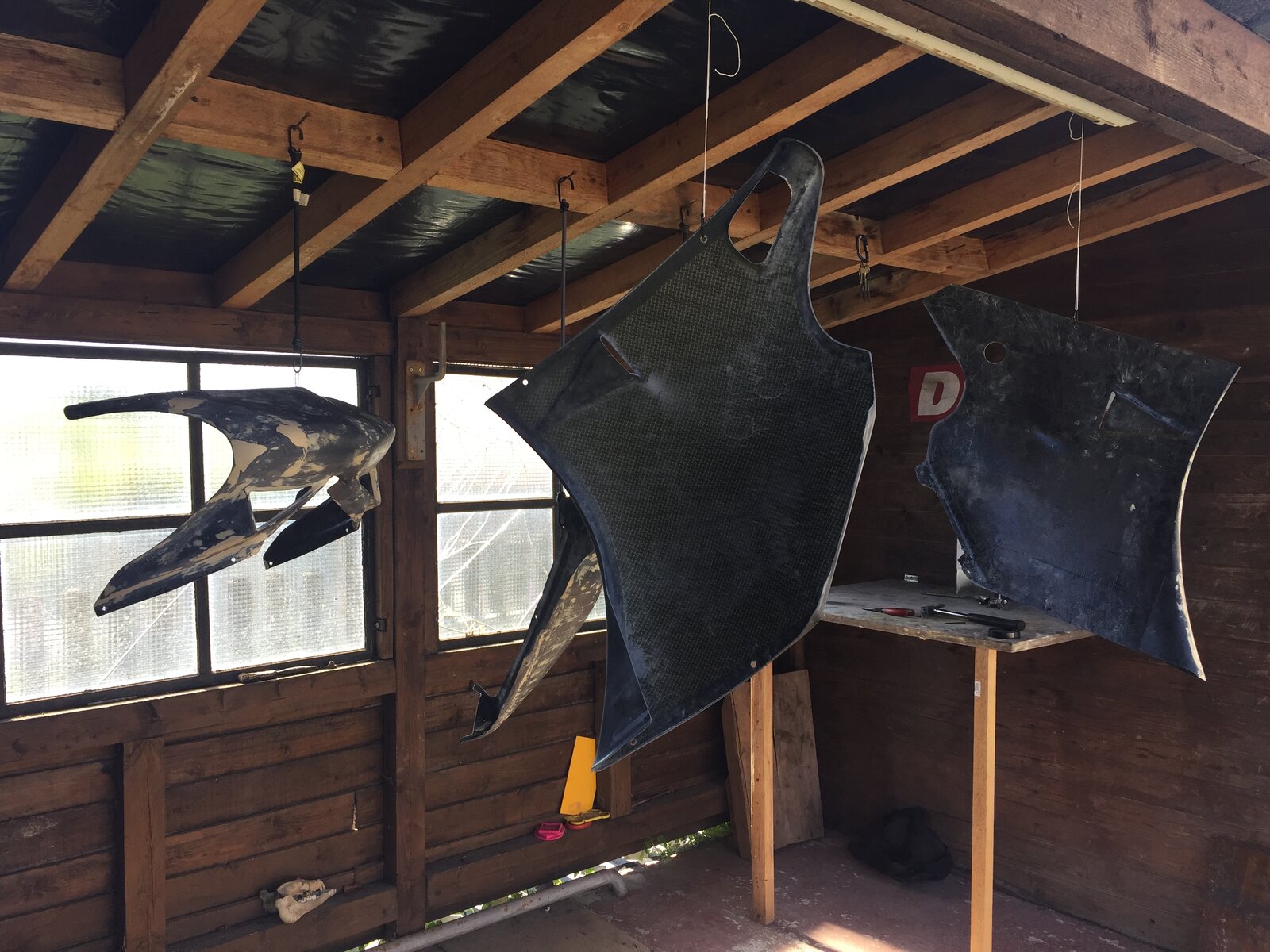

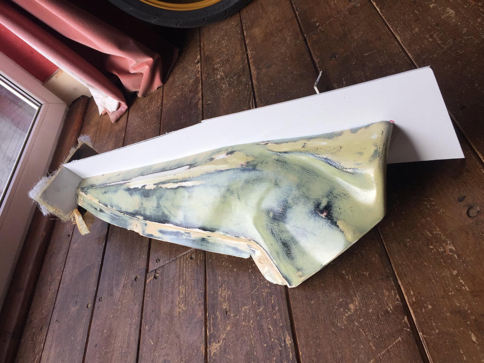

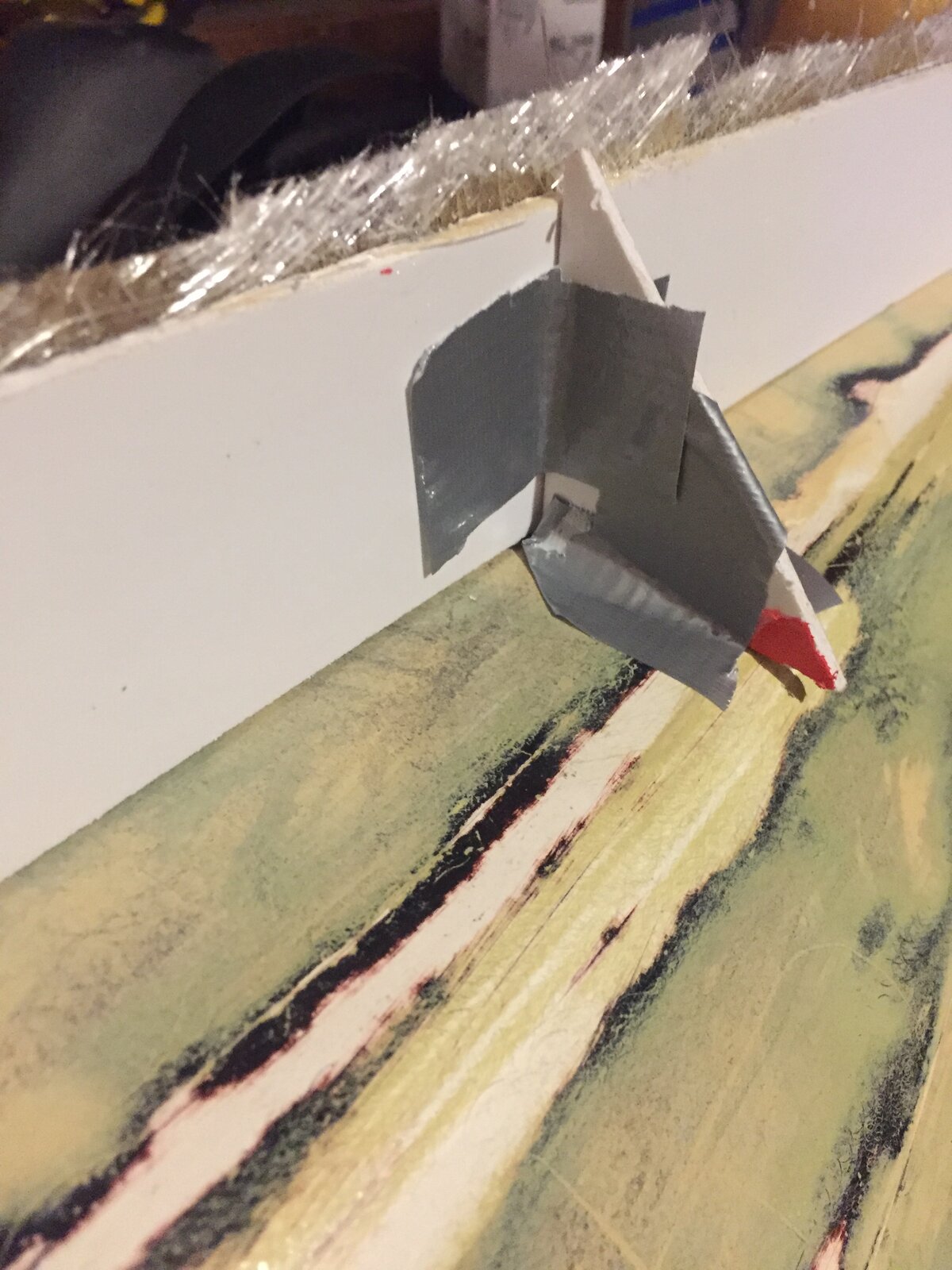

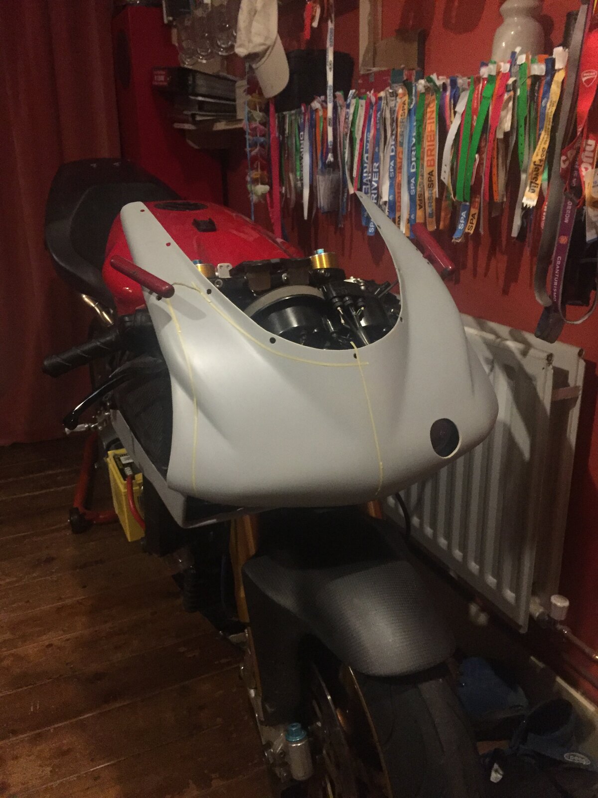

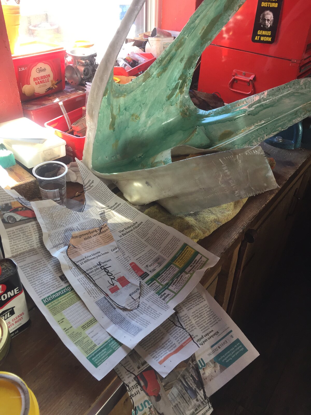

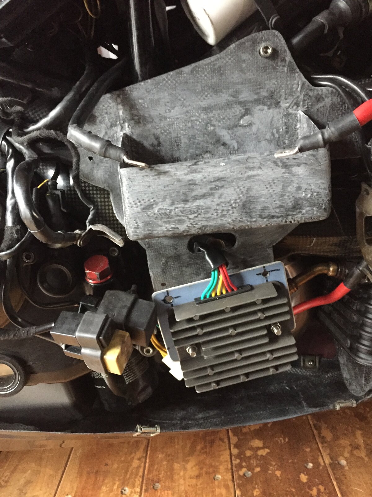

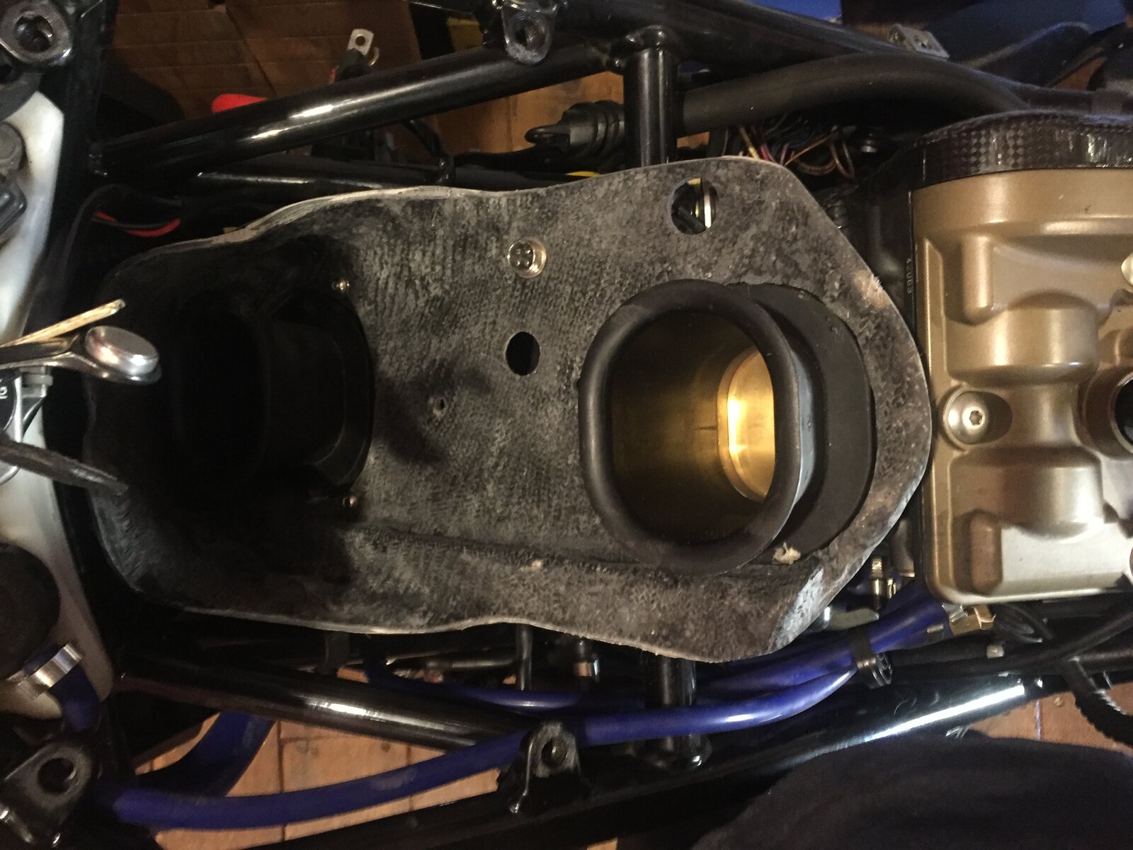

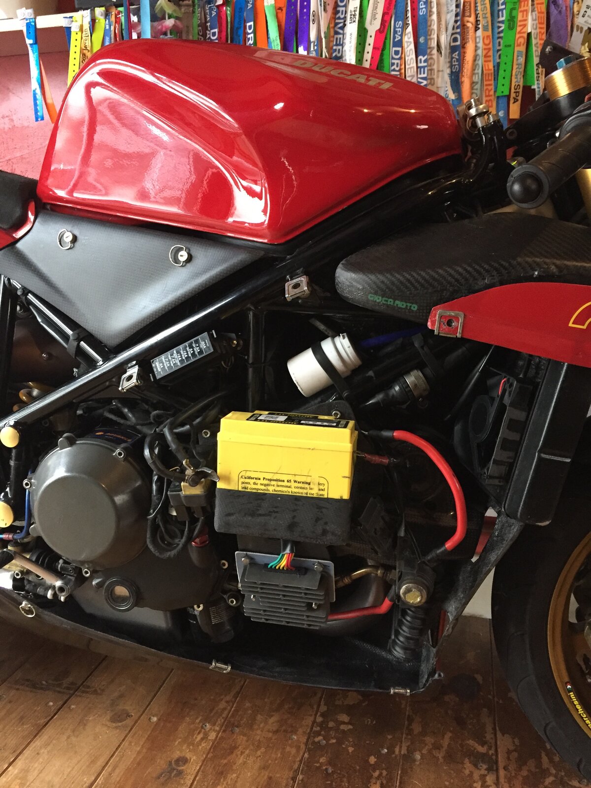

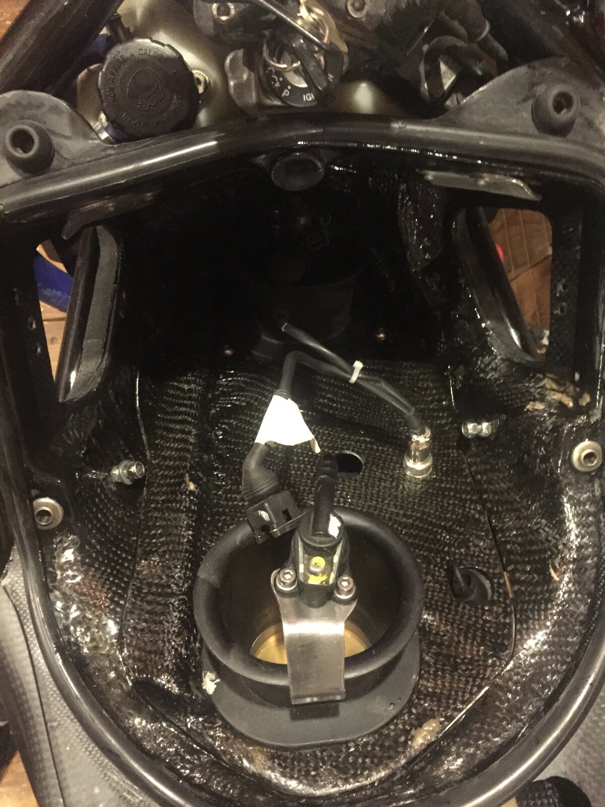

    Other jobs I wanted to revisit was the airbox as being single piece it’s a pain to remove and strip down if needed. So I have now made it two piece. I need to do a bit of tidying of it this either and create a flanged seal between the two halves. Also earmarked is a few tweaks to the wiring loom to again facilitate component removal with less complications.

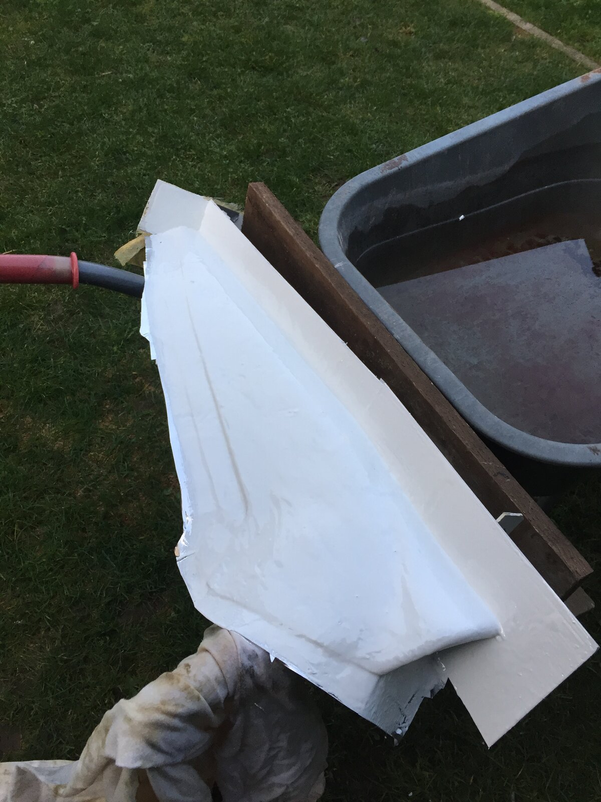

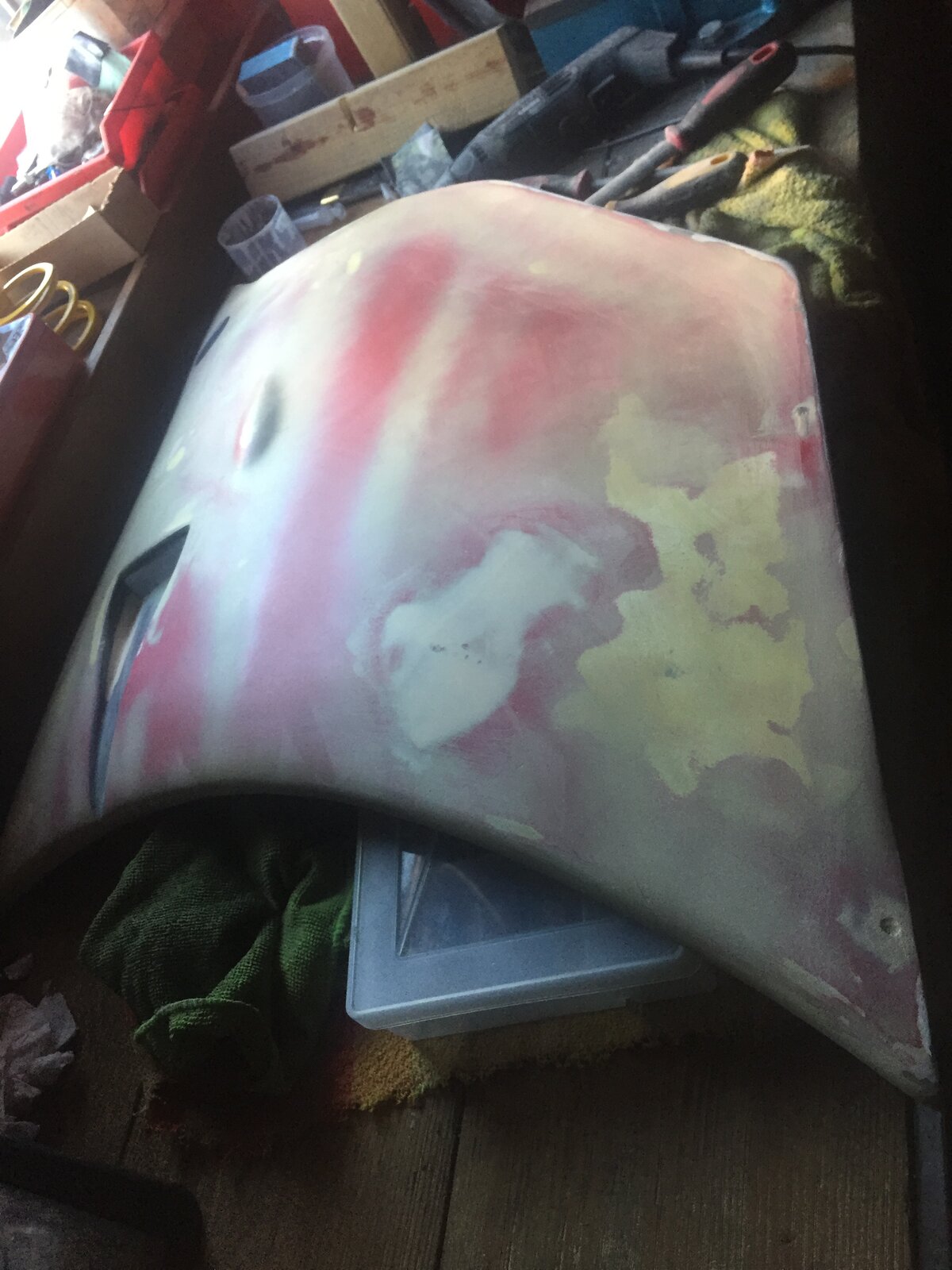

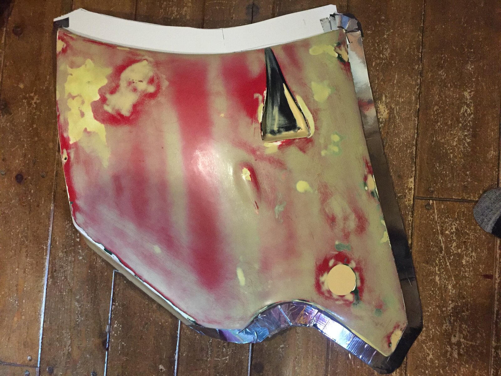

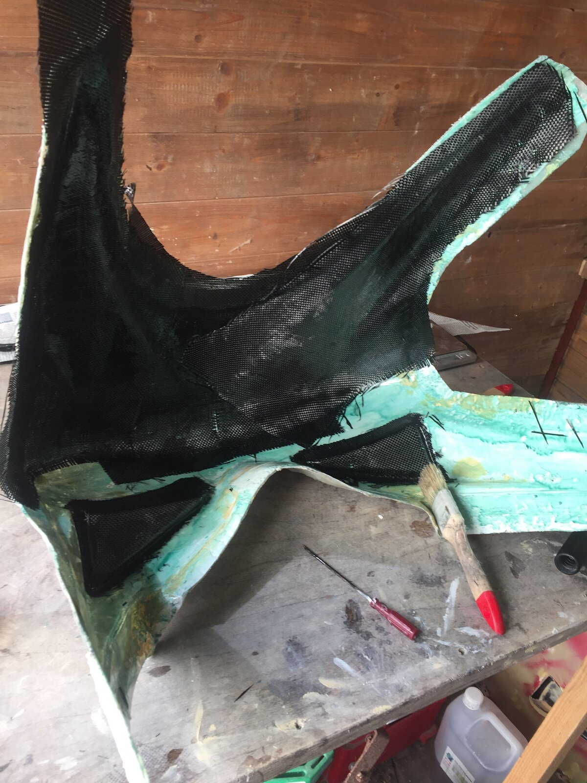

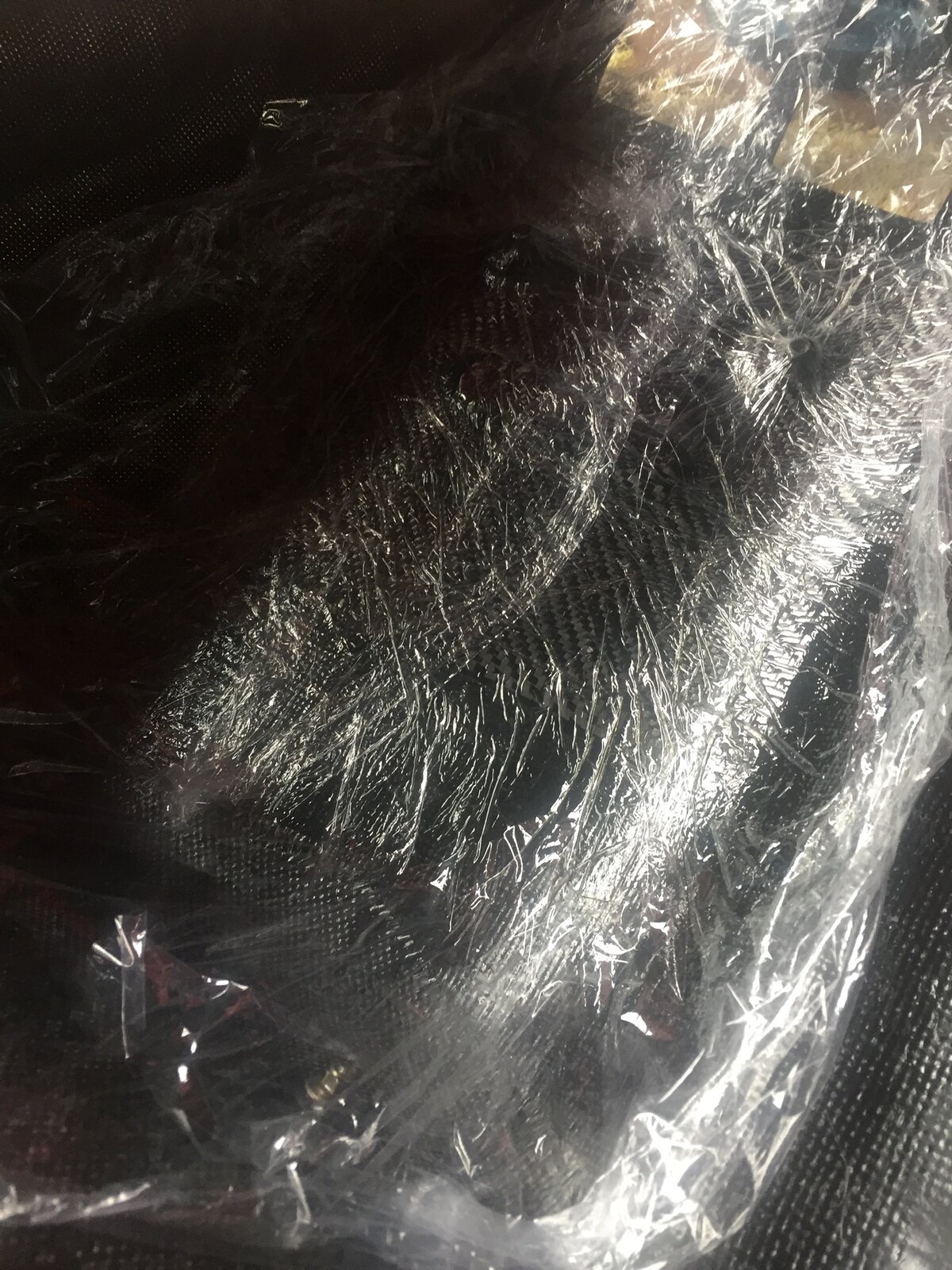

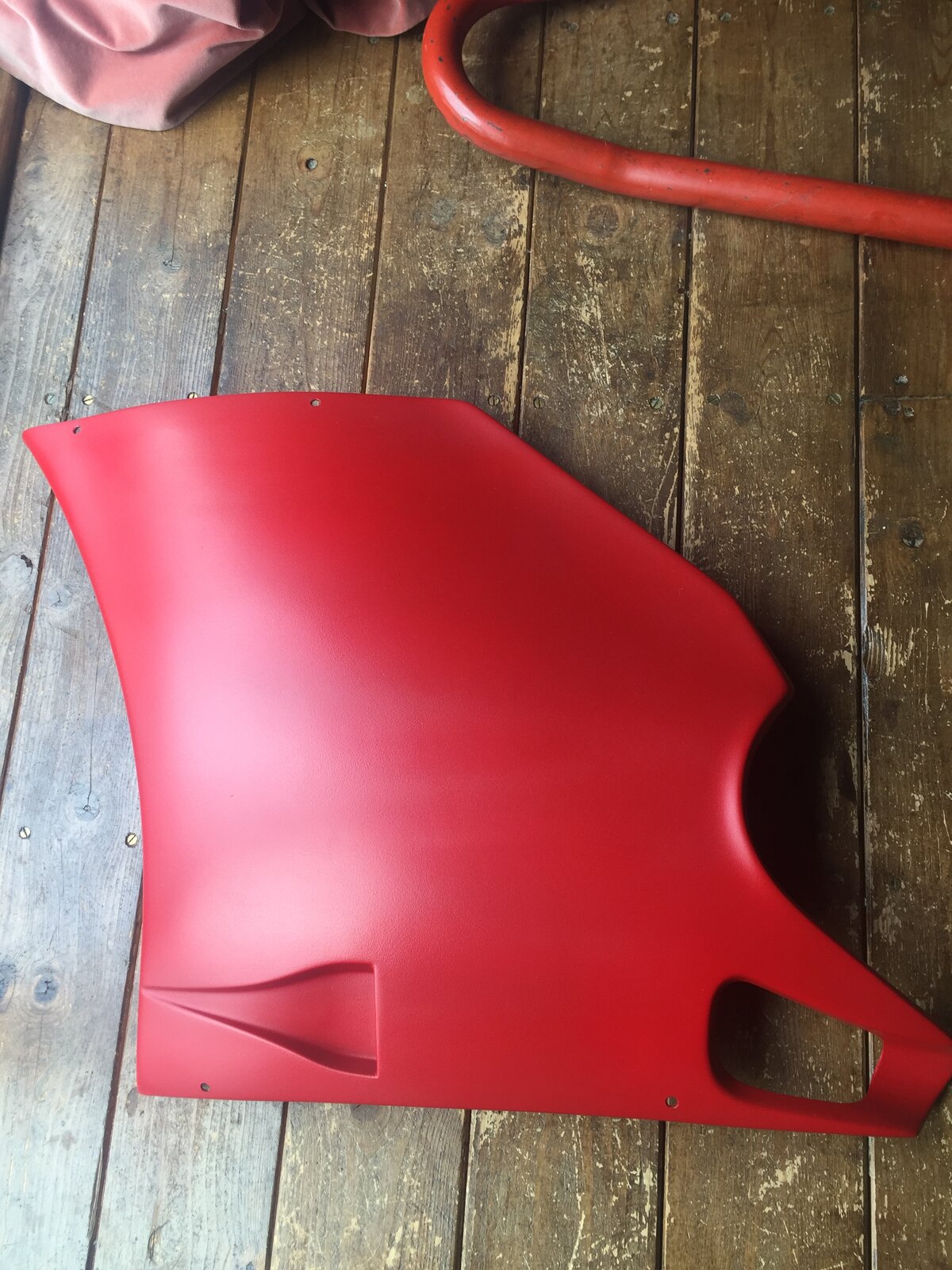

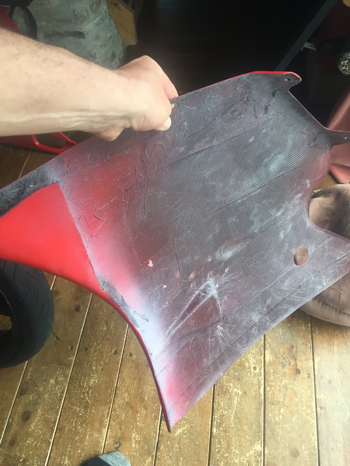

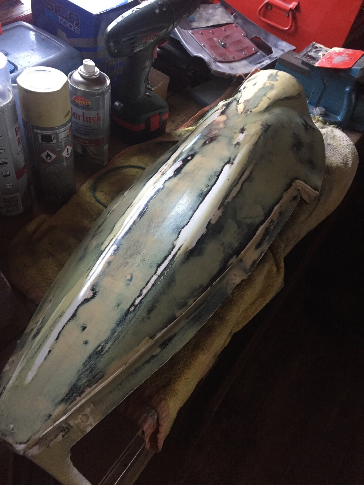

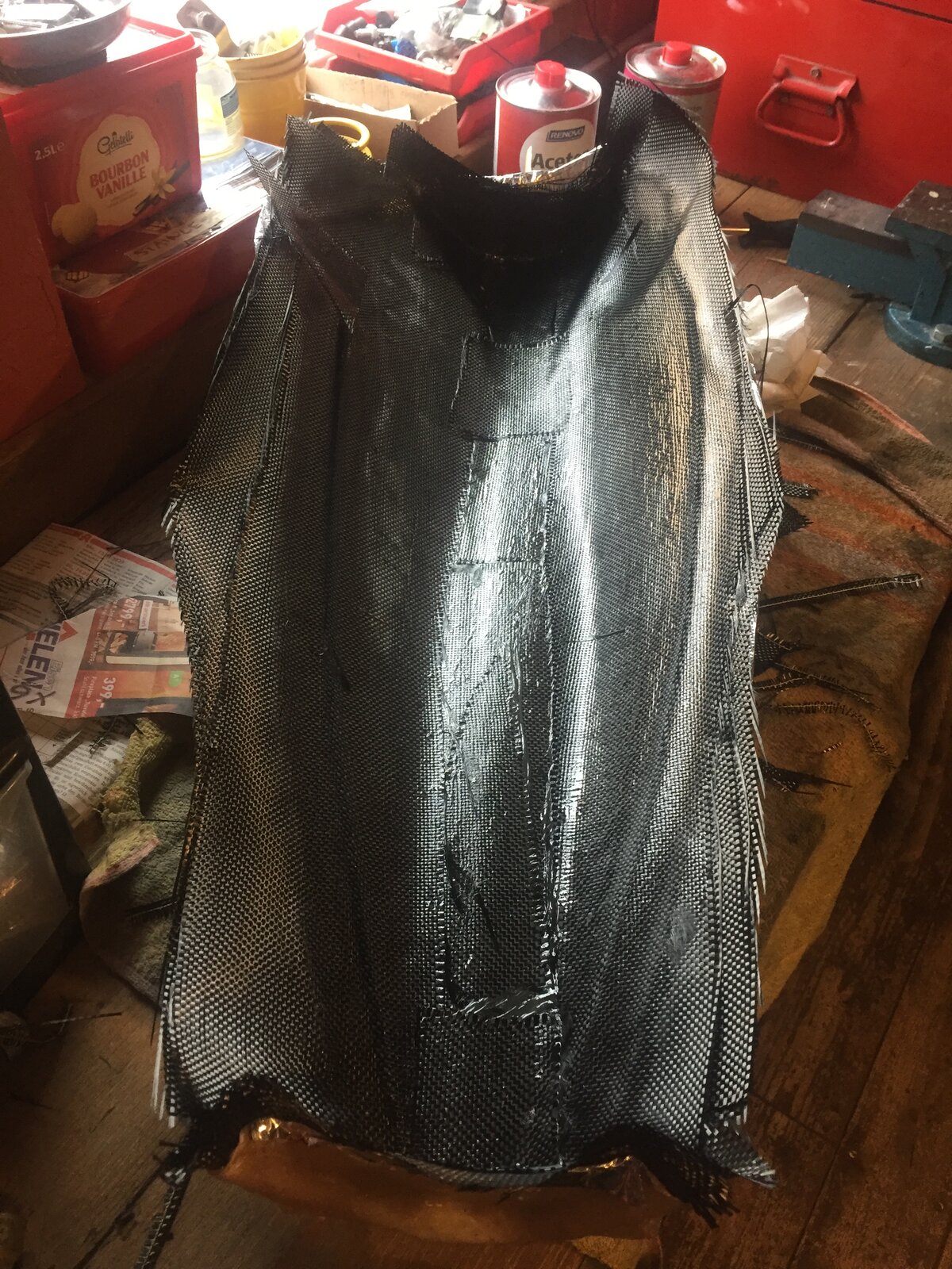

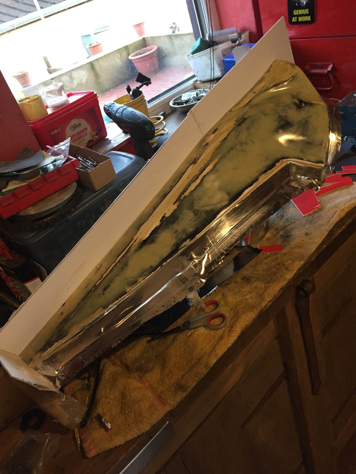

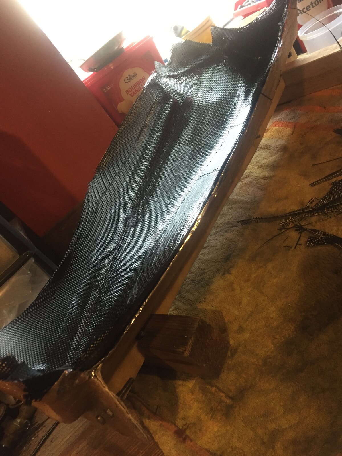

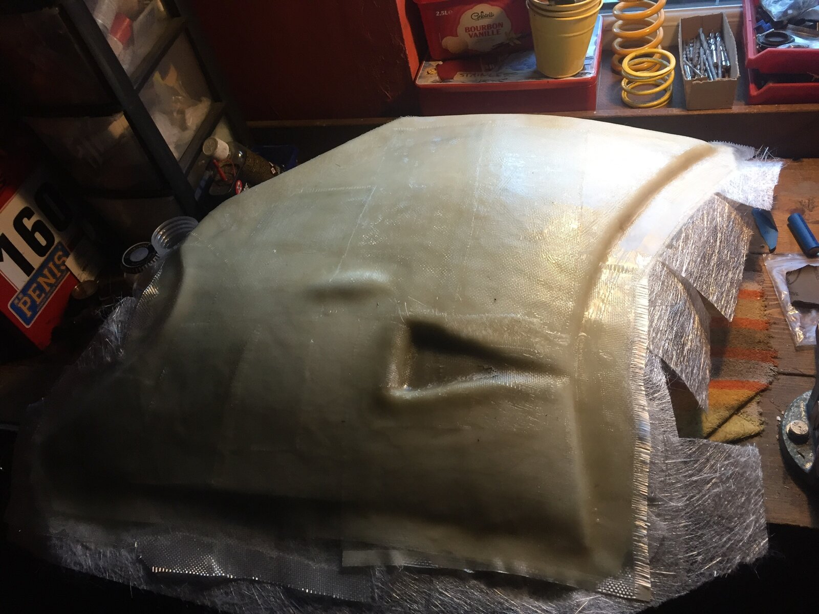

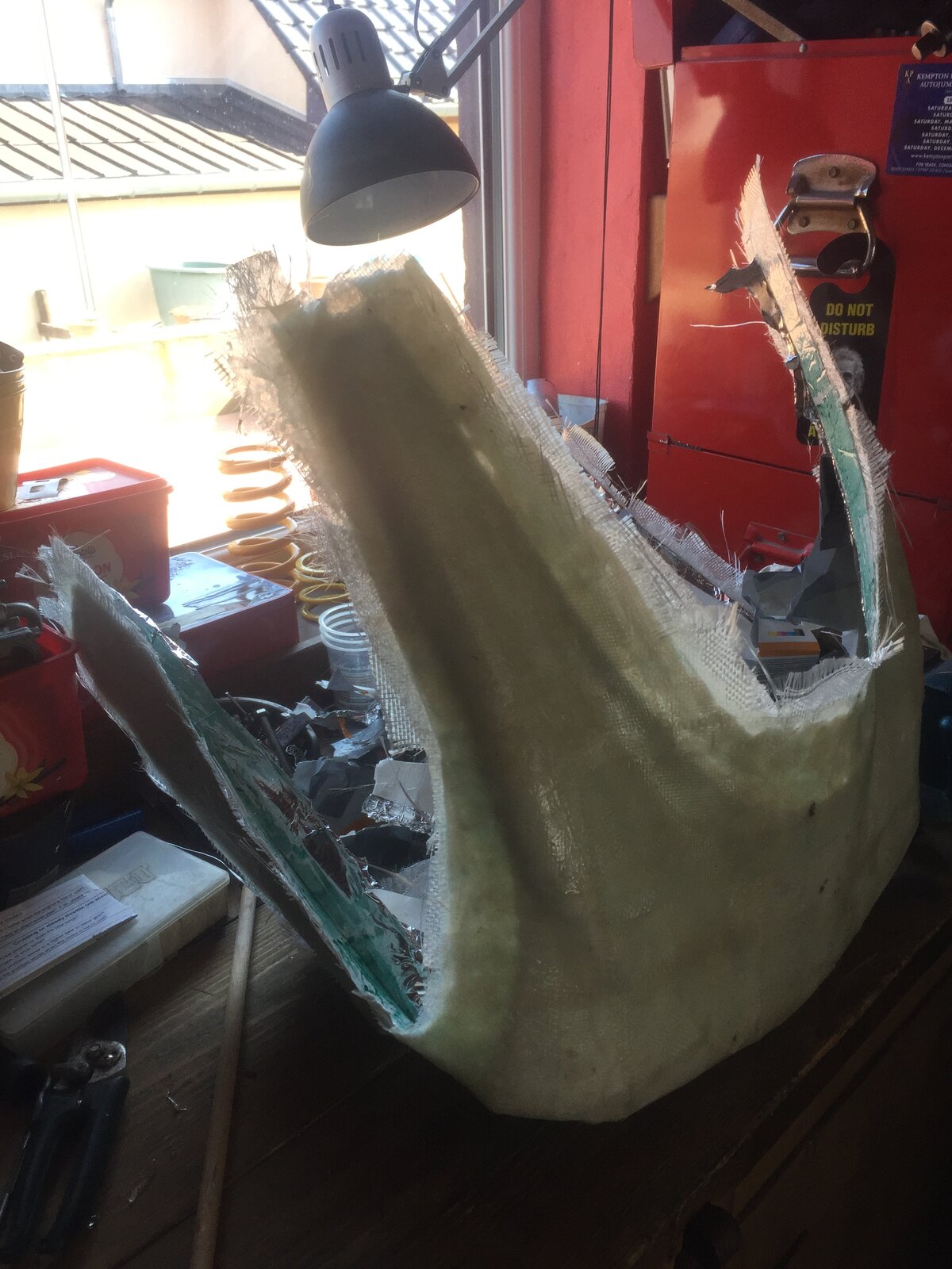

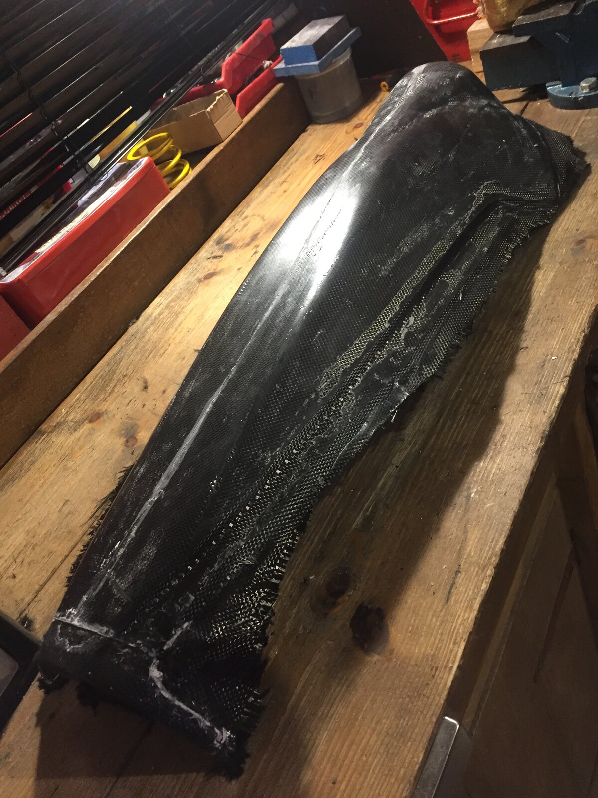

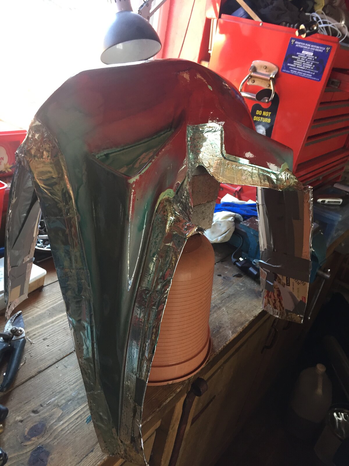

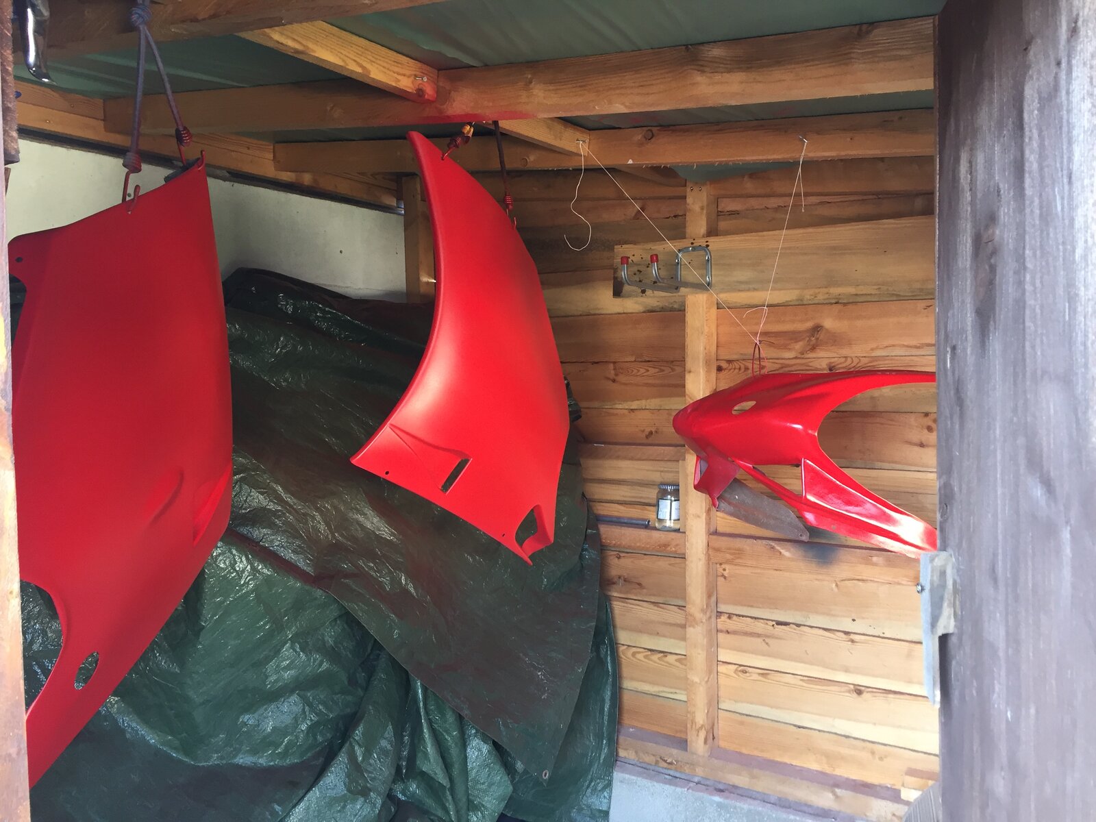

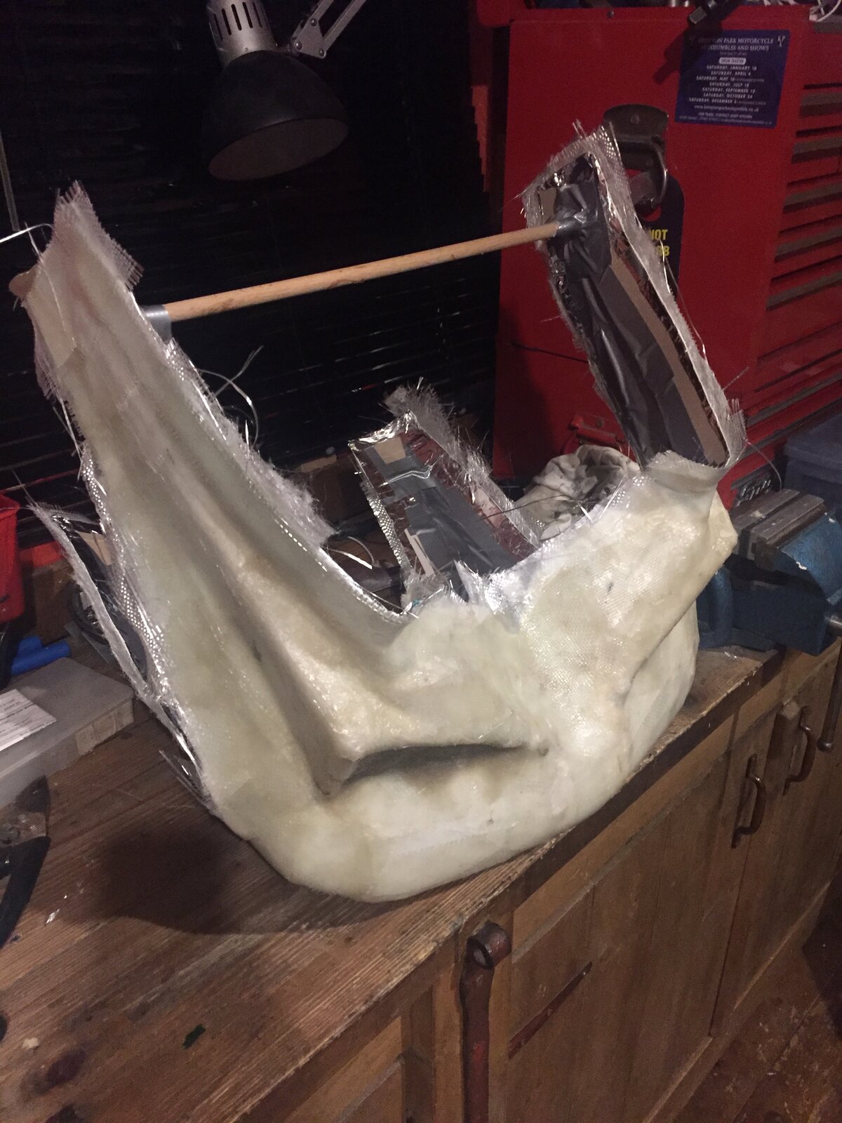

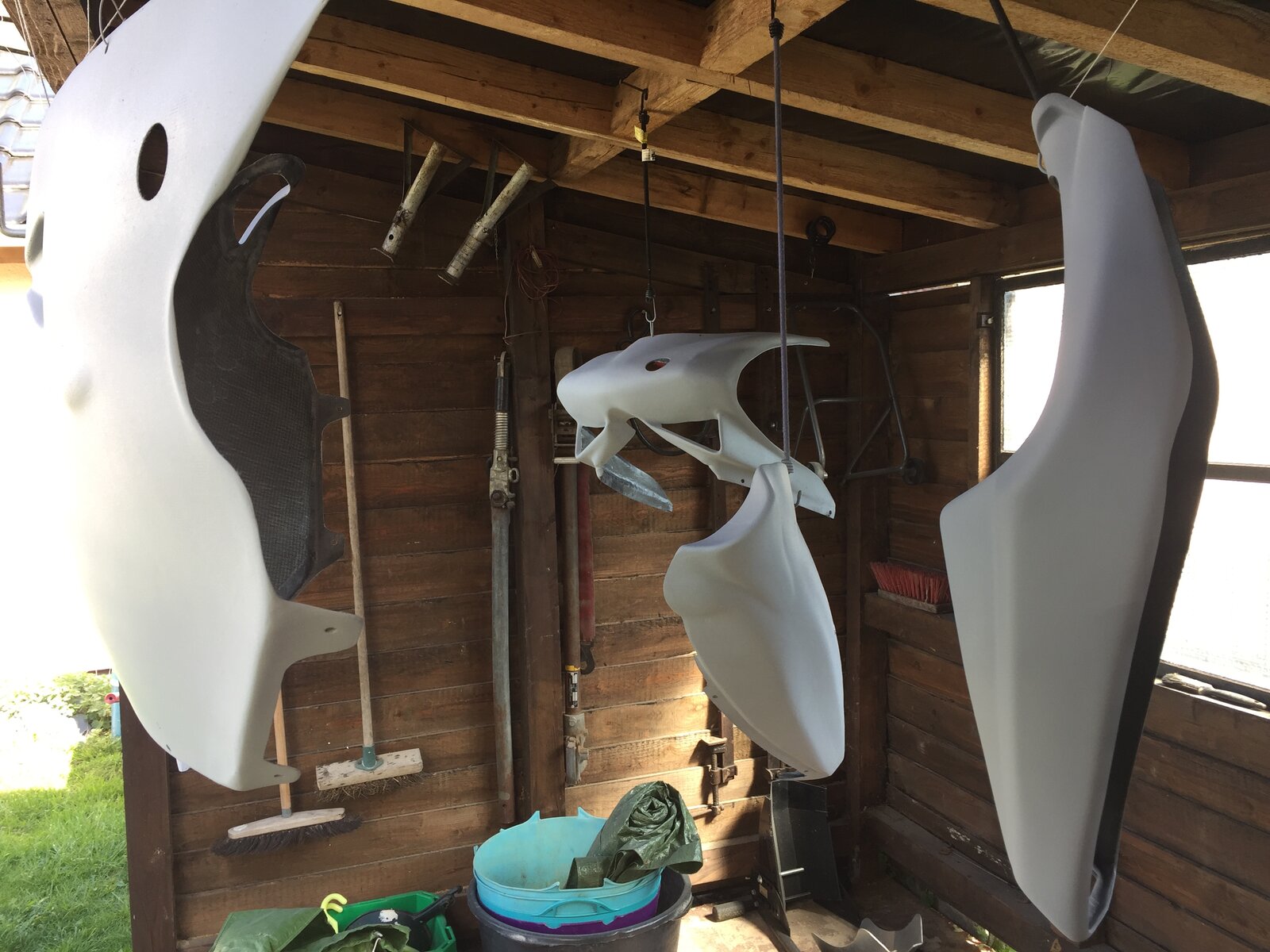

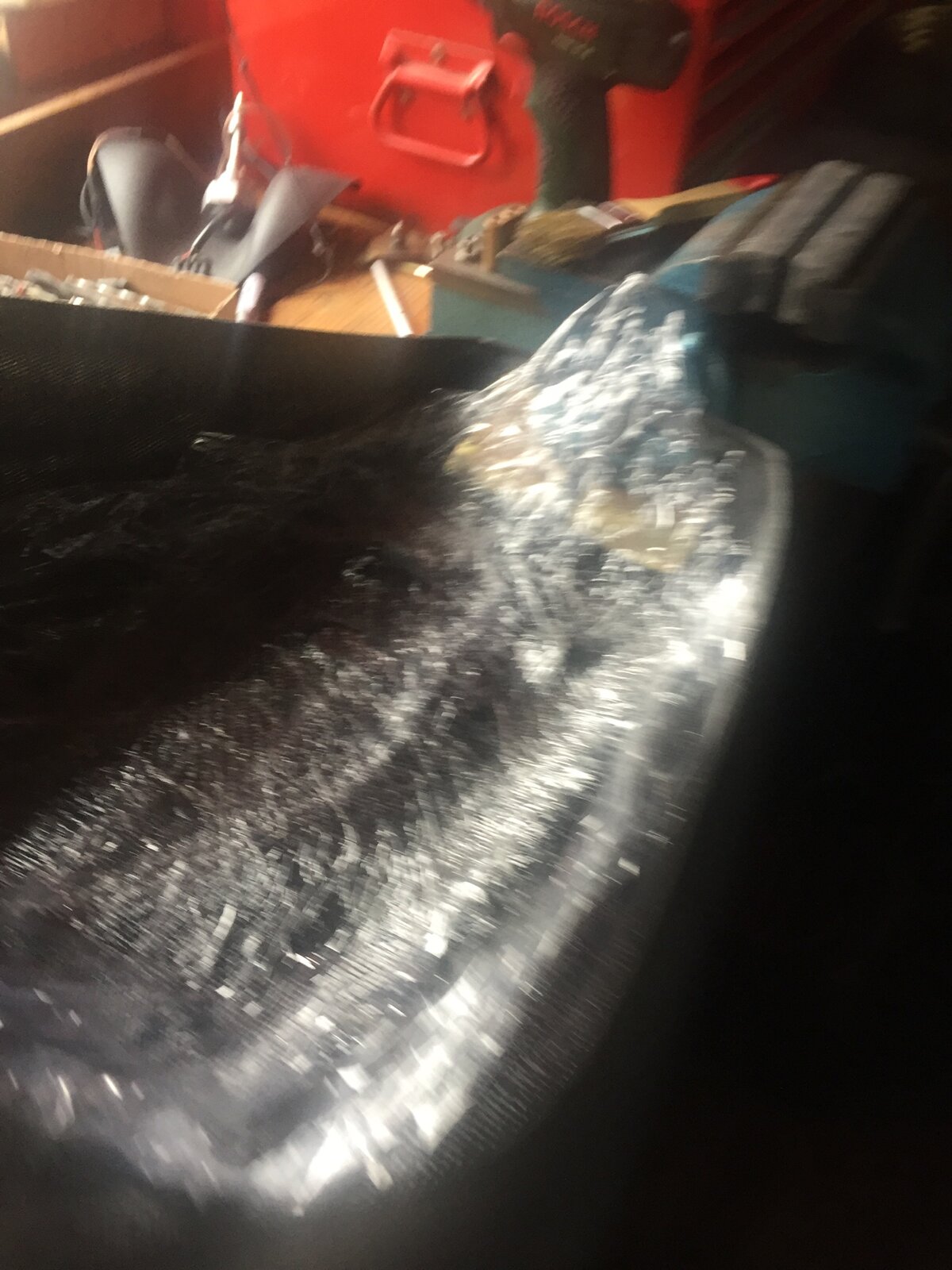

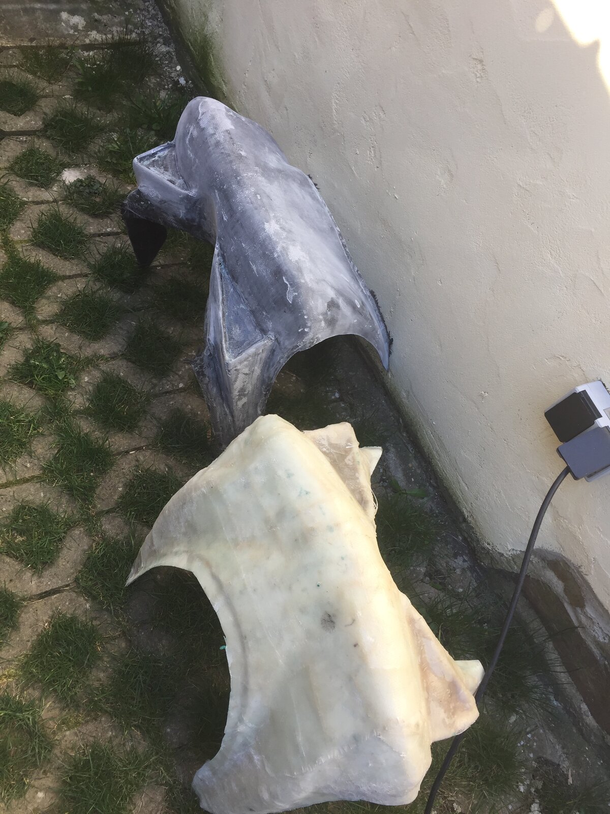

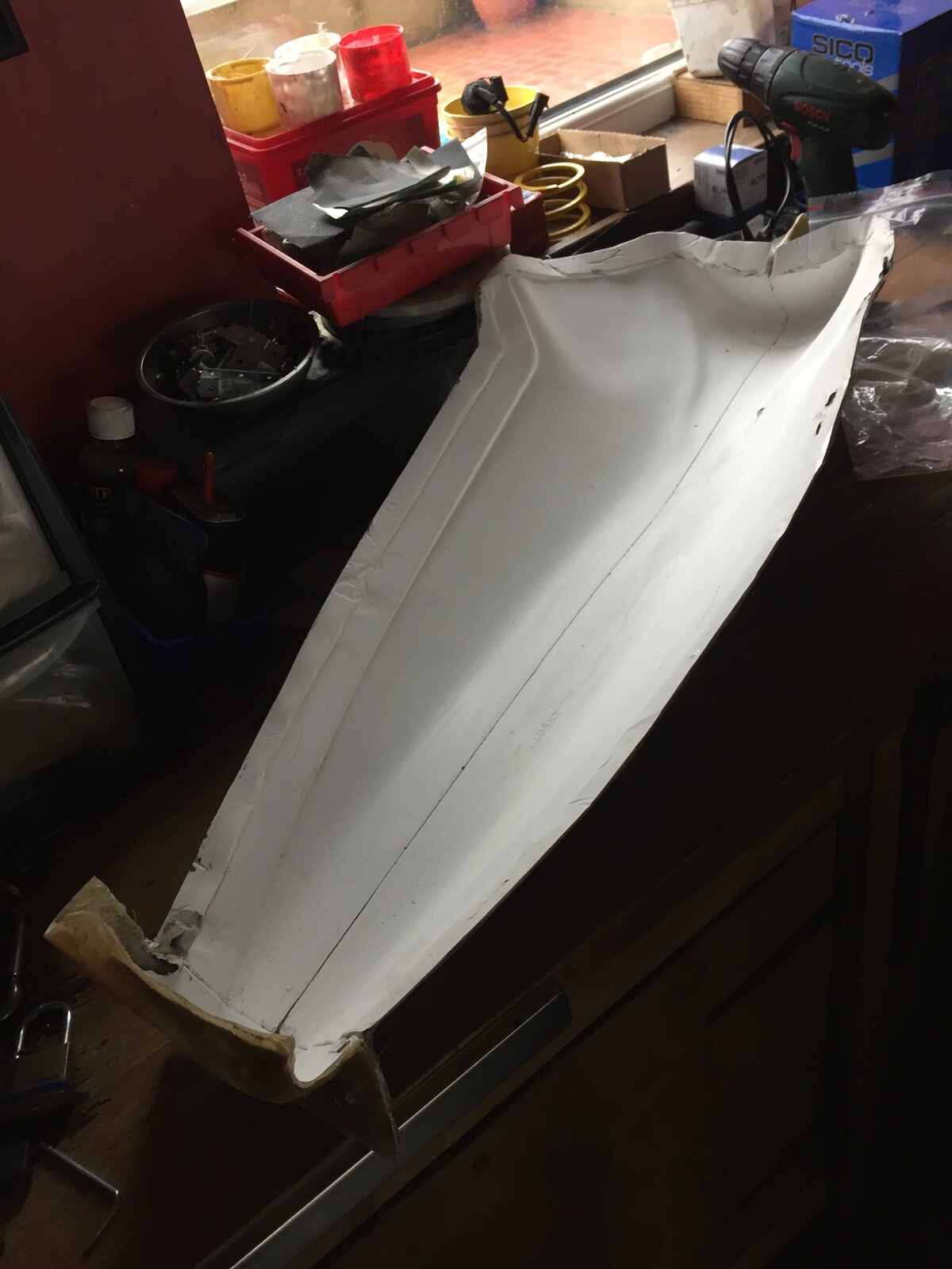

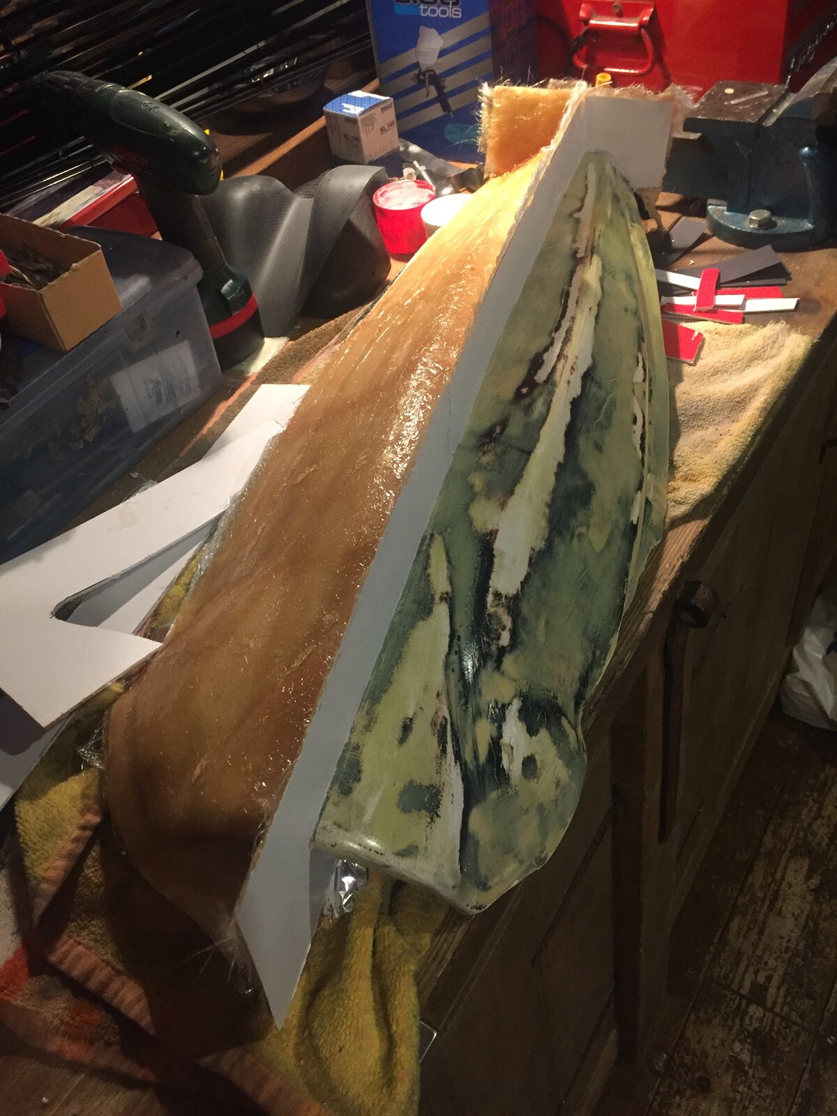

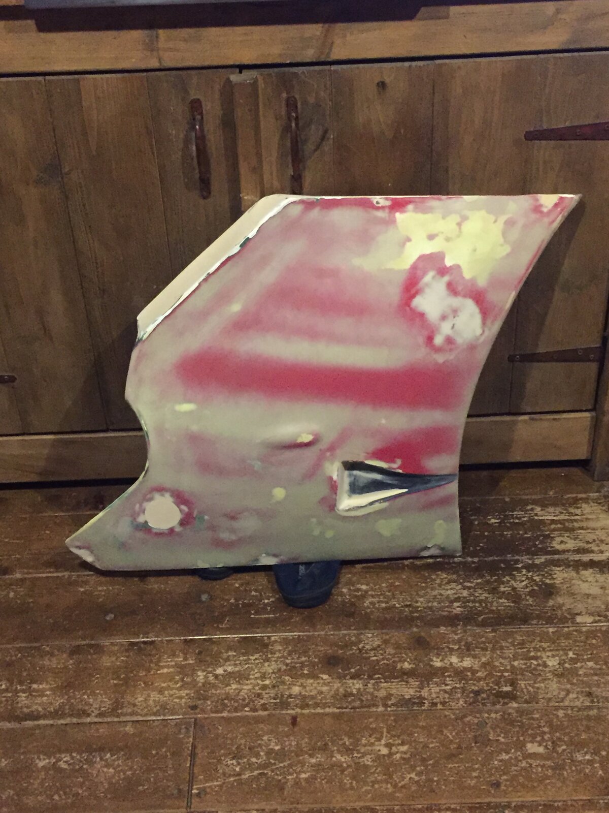

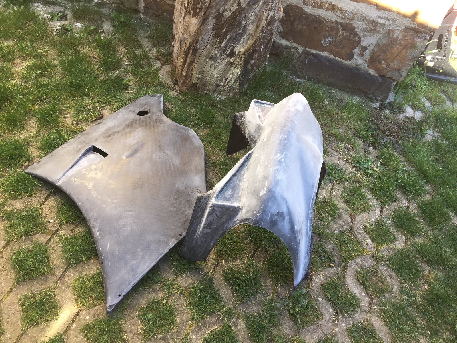

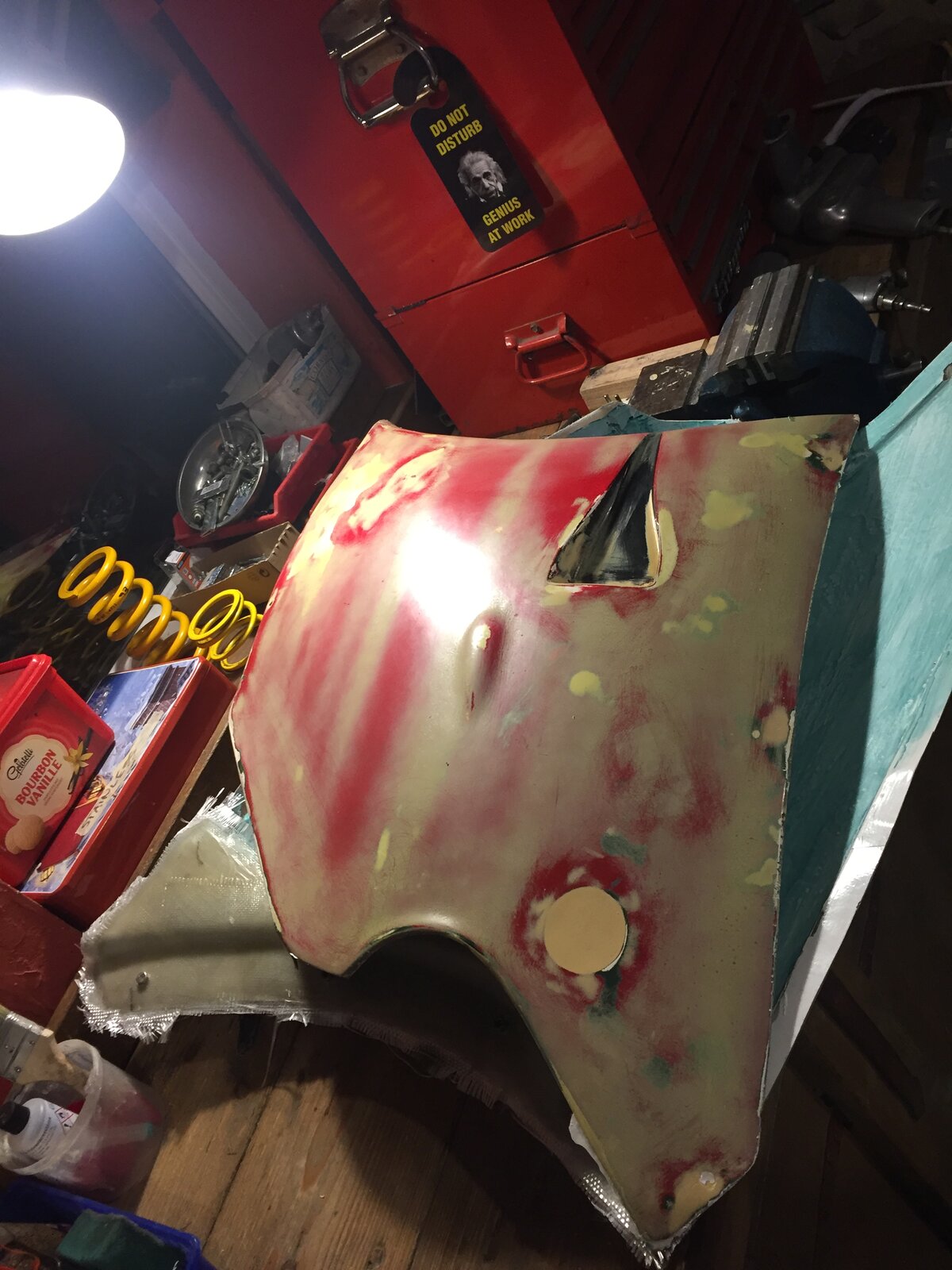

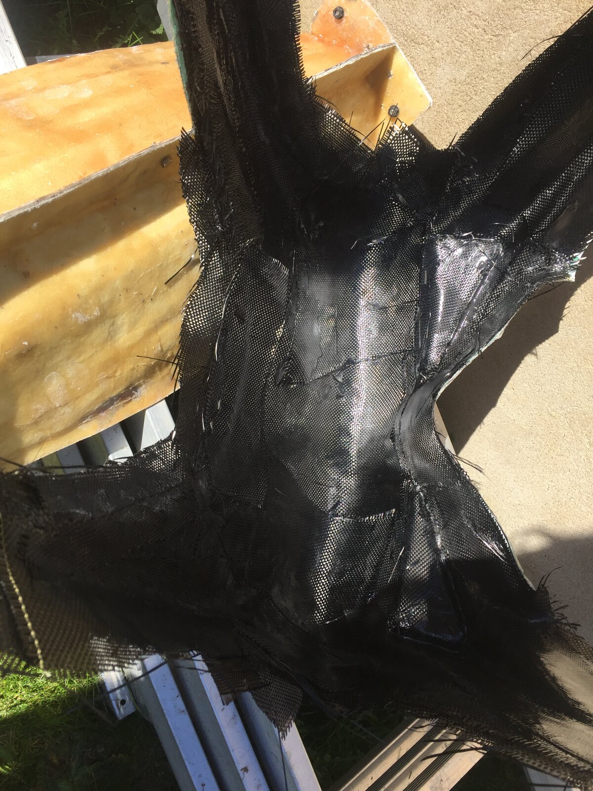

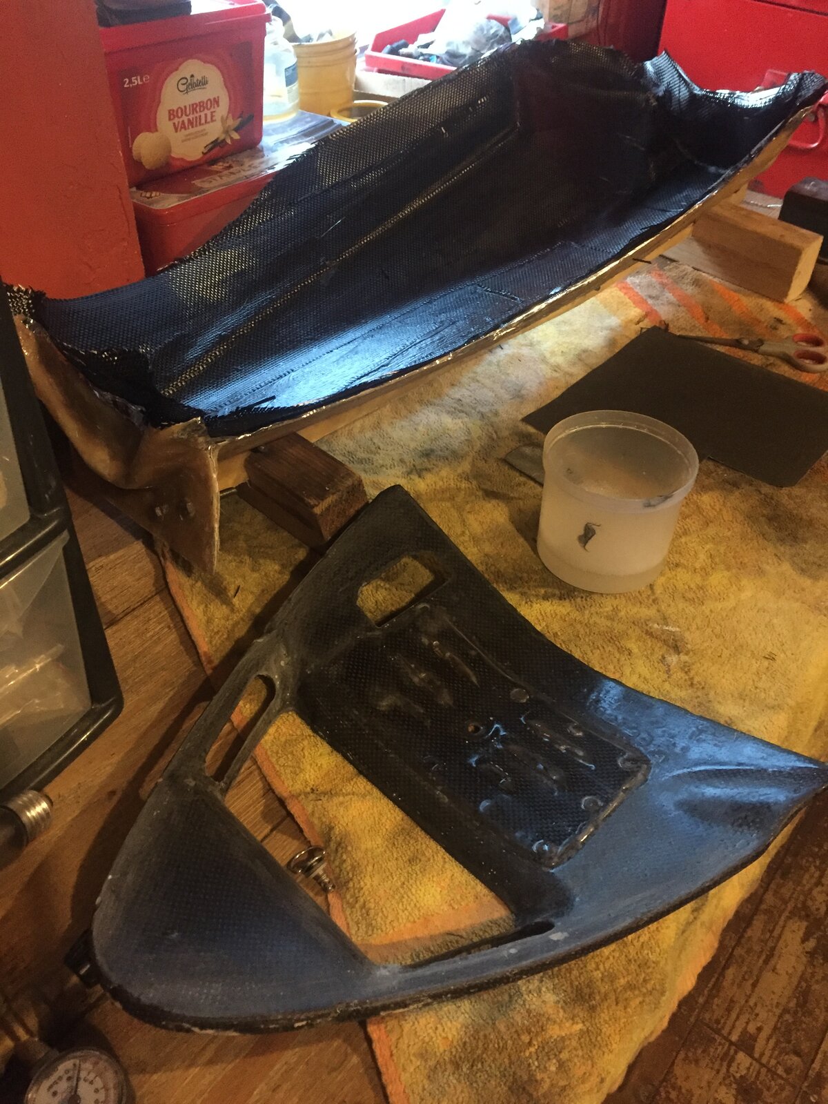

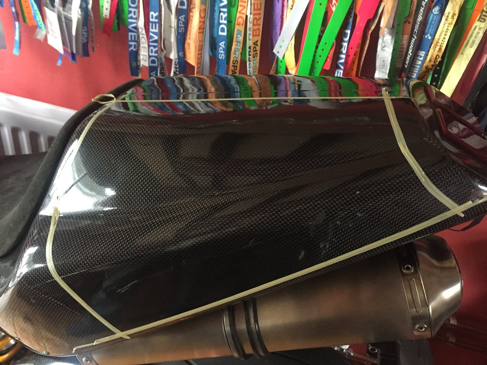

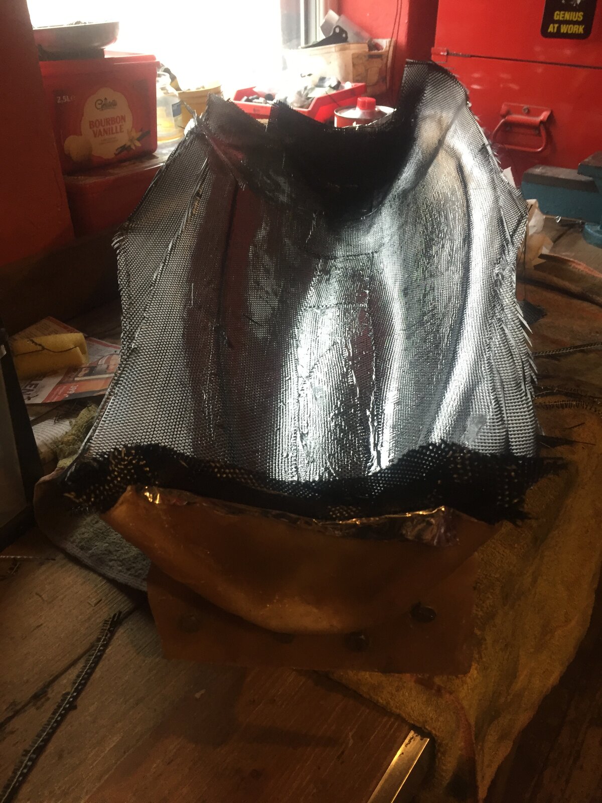

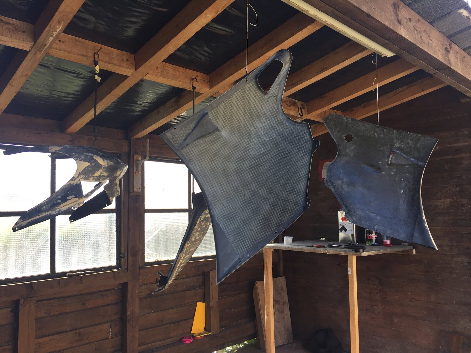

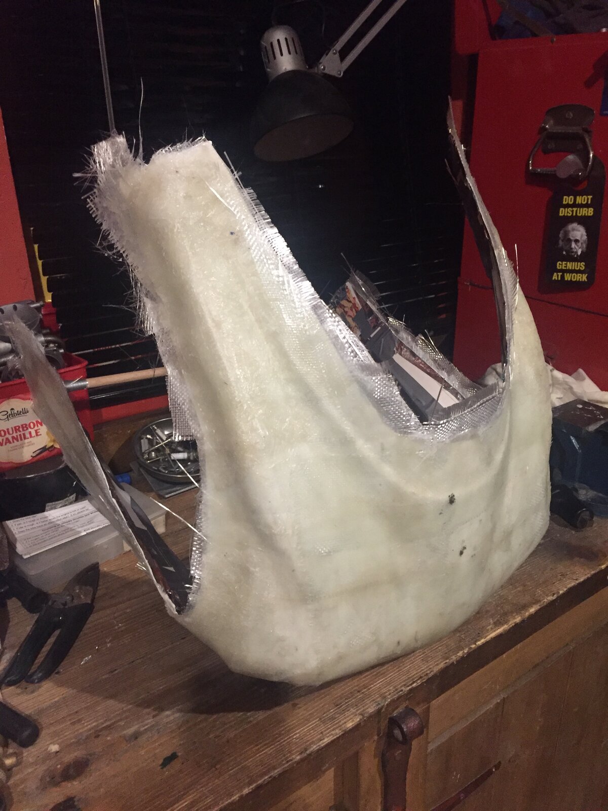

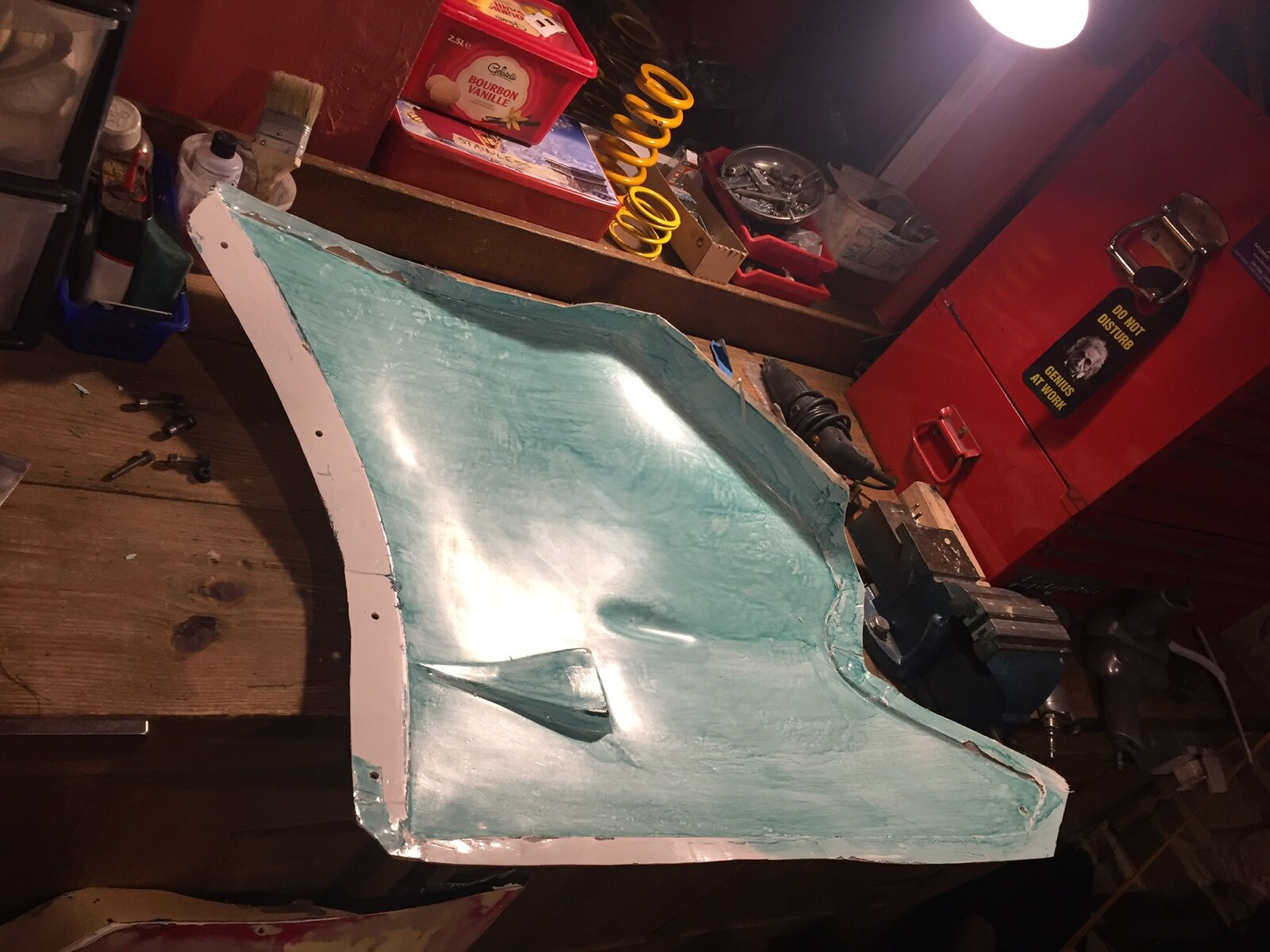

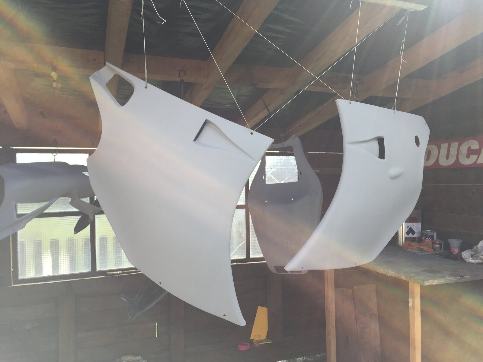

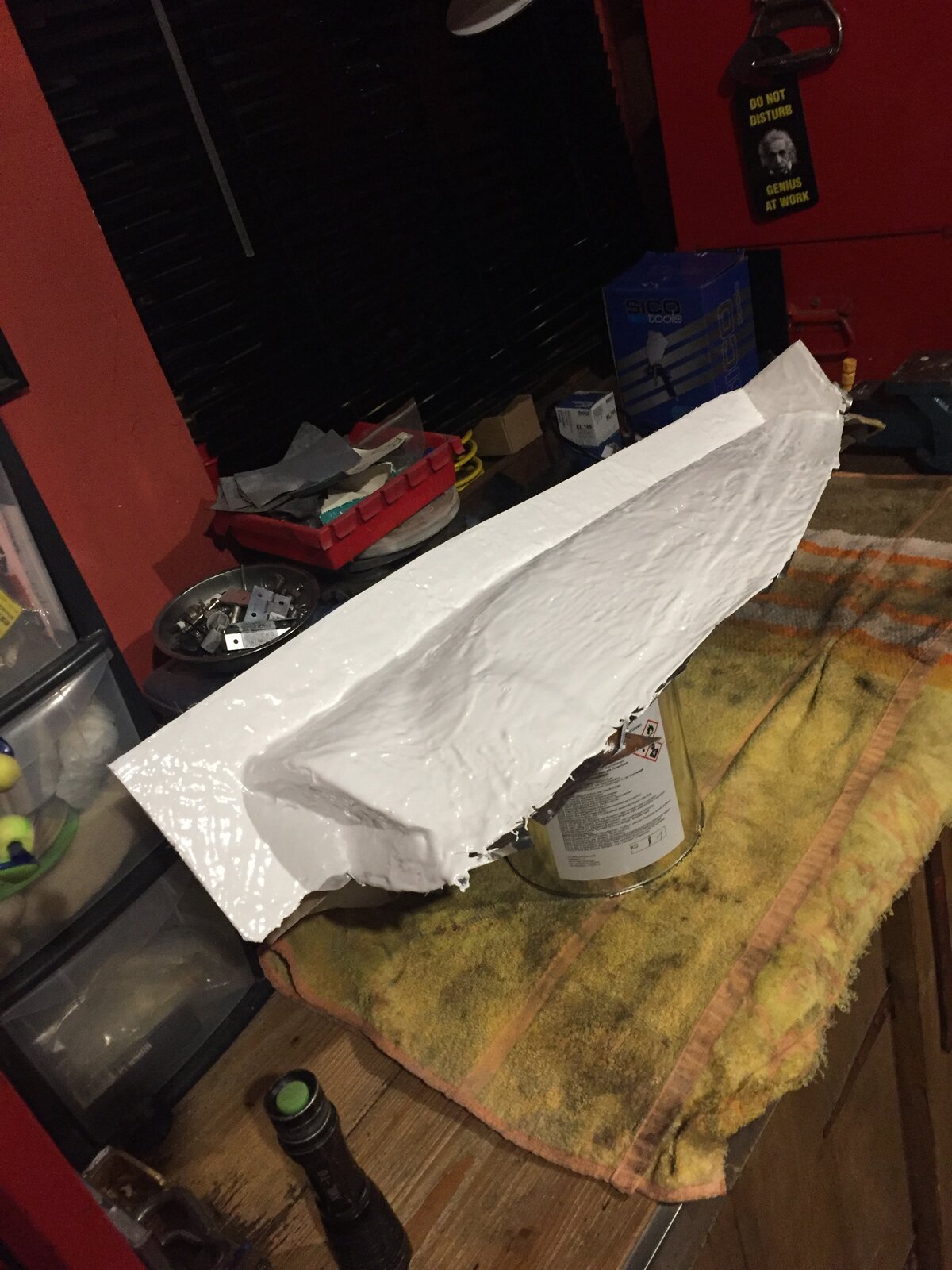

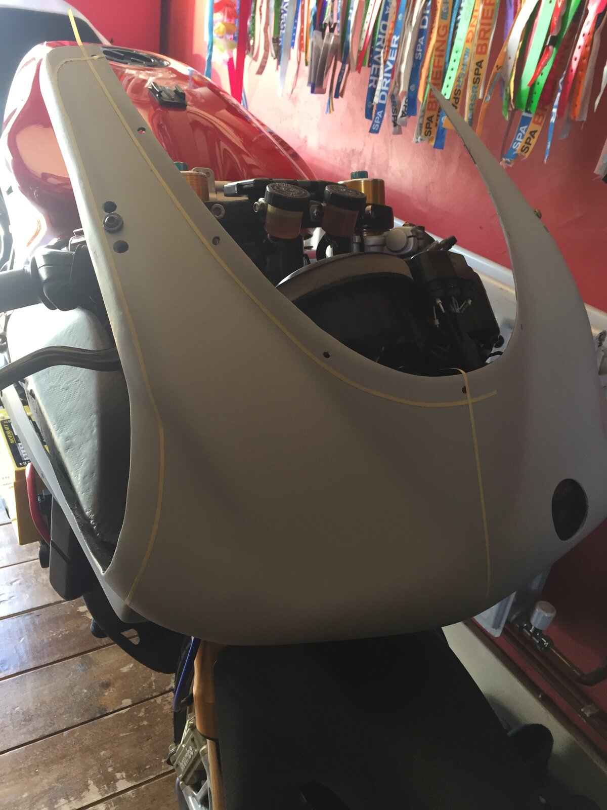

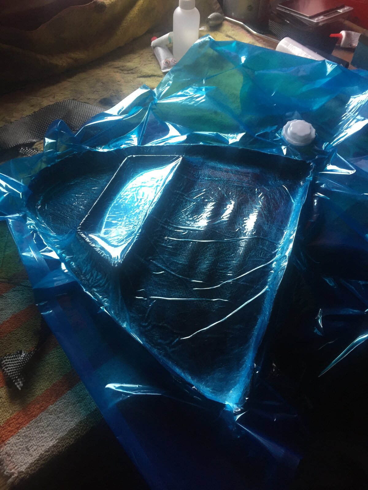

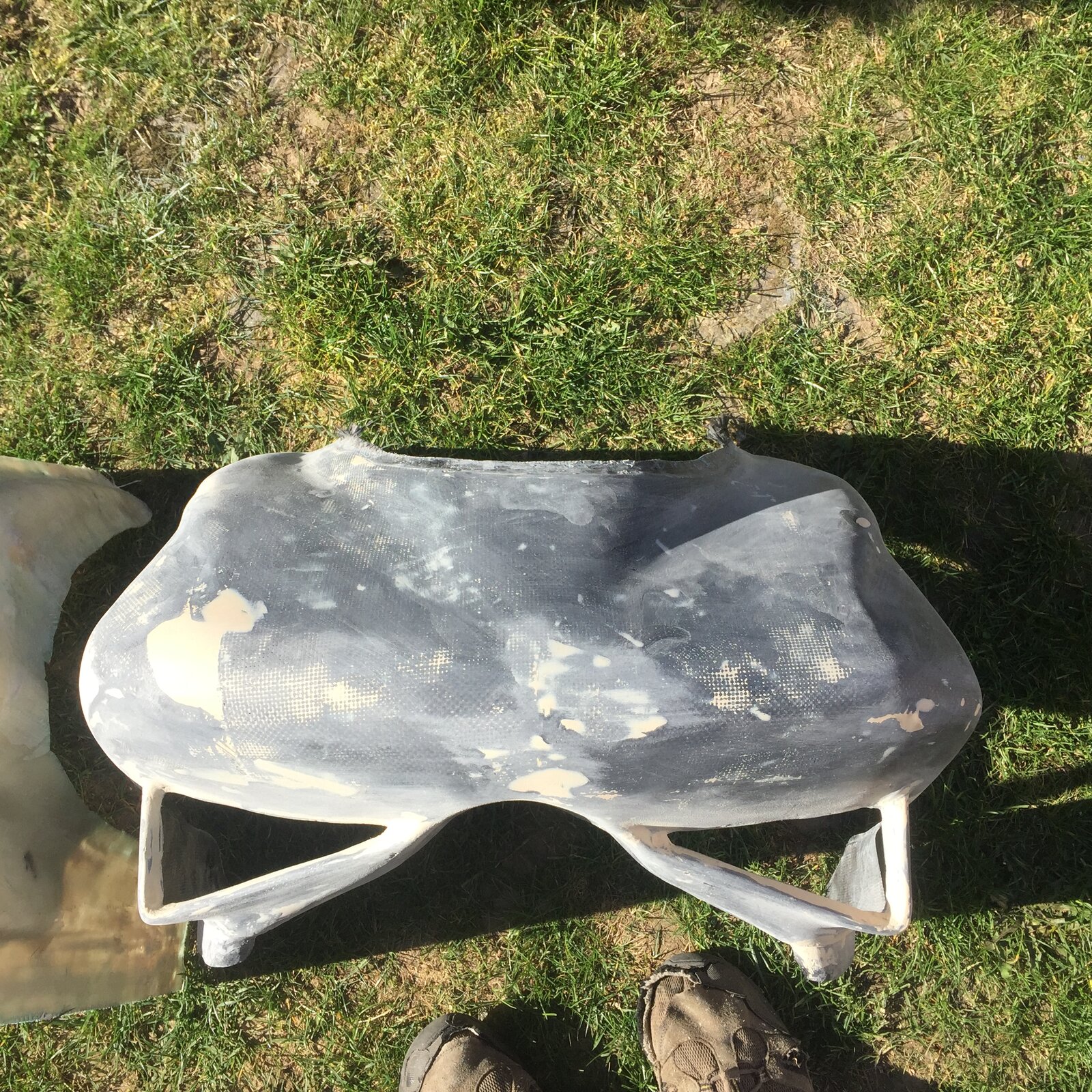

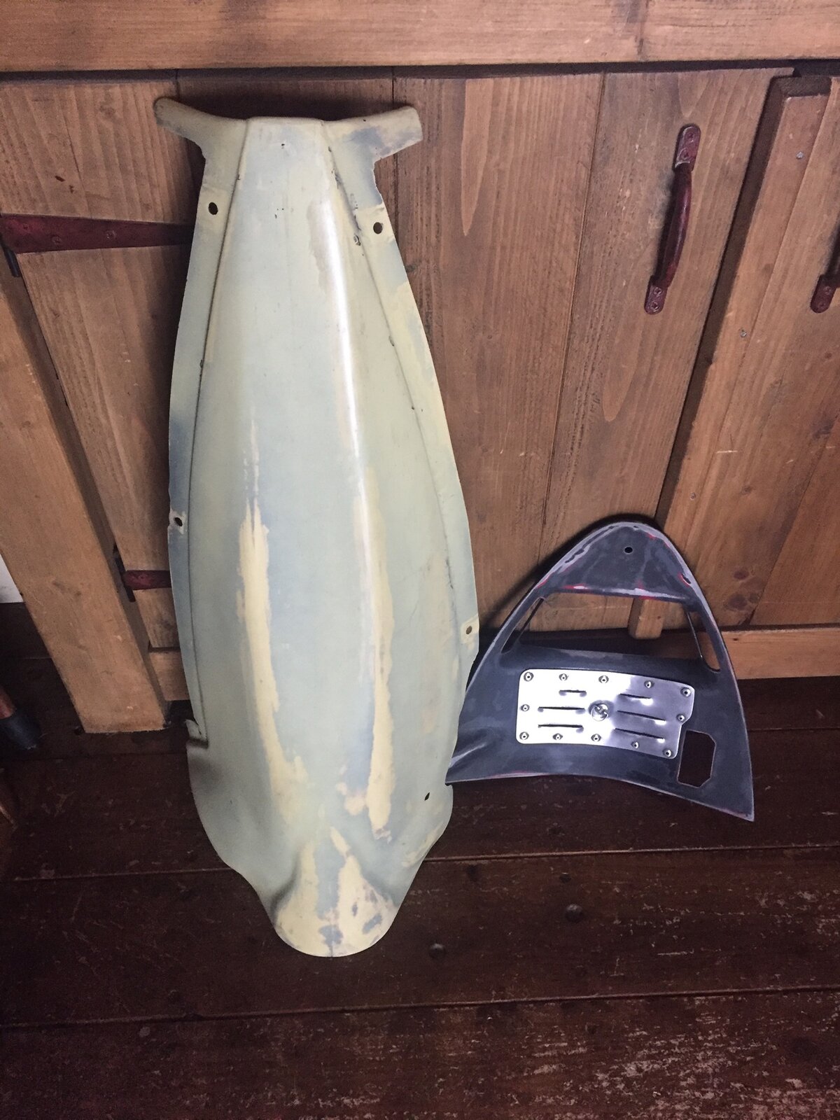

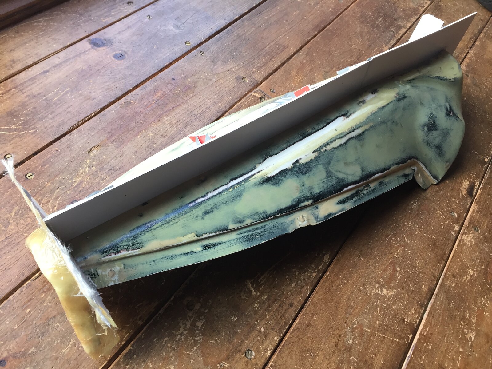

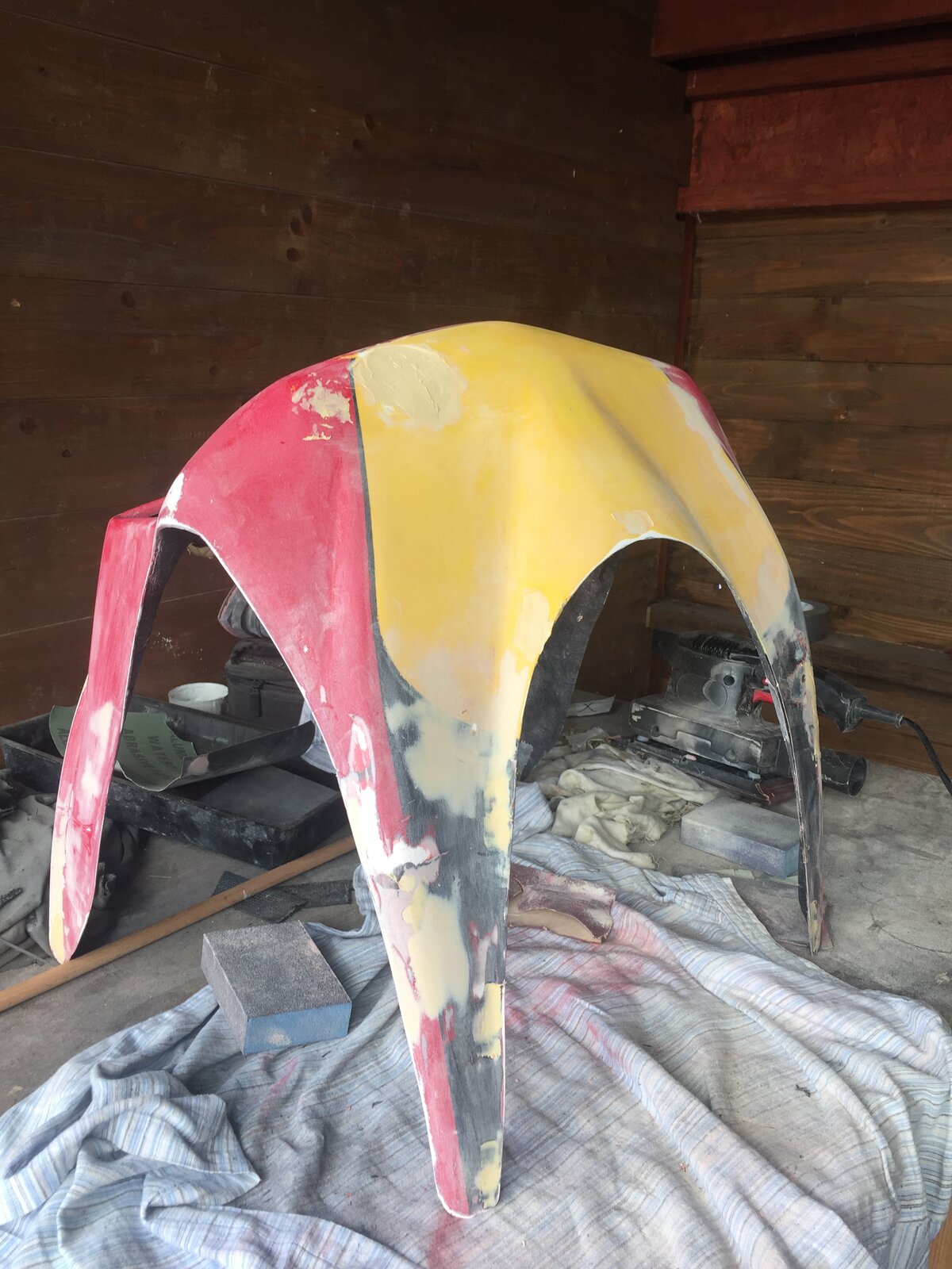

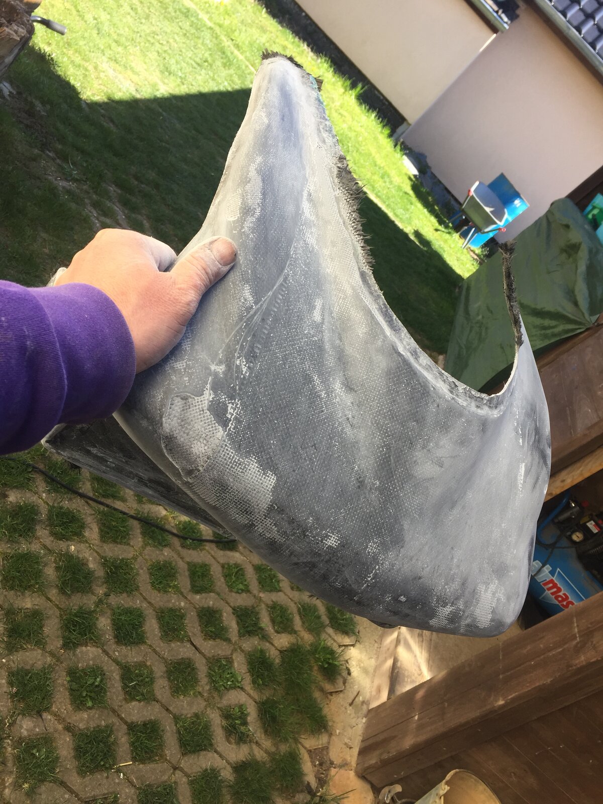

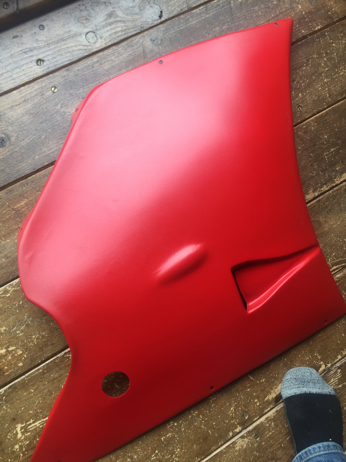

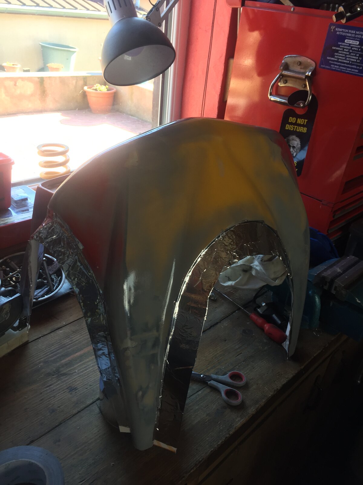

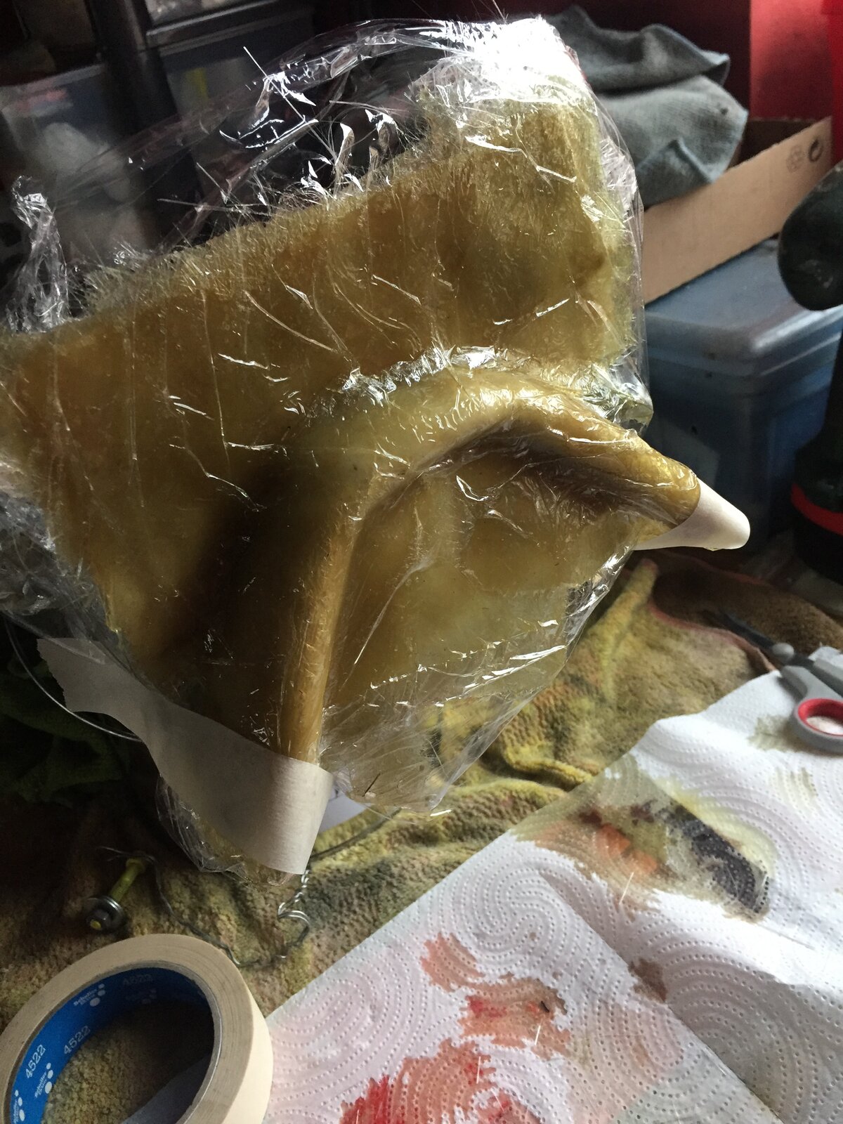

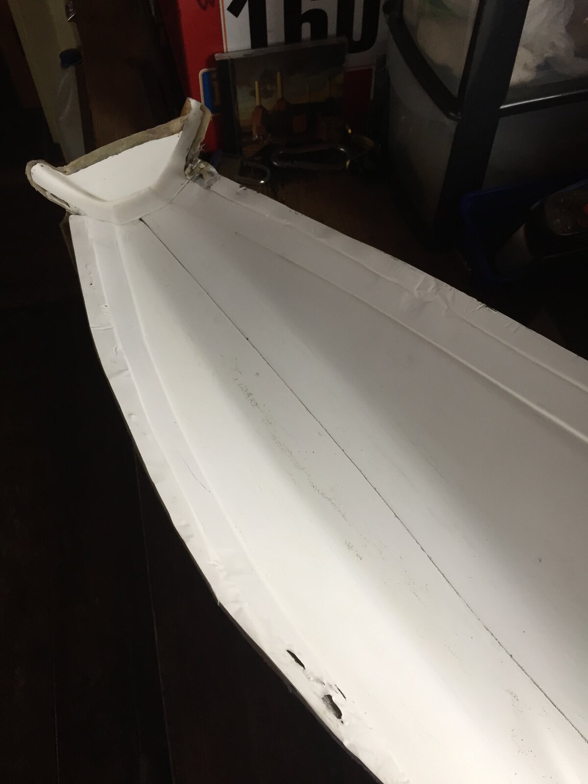

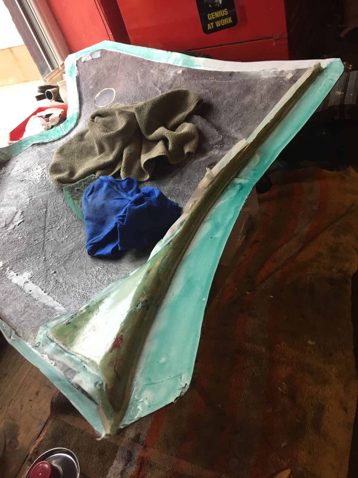

    Last winter my main goal was to make my own cf fairing. A lengthy and messy process that entailed making good and preparing my old gf fairing to be used as a plug for making moulds. Then after more prep using the moulds to wet lay cf to create the new fairing.
    Obviously it was not quite production quality but it weighs less than my very flimsy gf fairing and it’s been a challenge.
    There has been many other bits and pieces that I’ve done along the way.
    I’ll chuck some photos up for you to see.
  13. 08394C80-9F9F-416A-9988-05C1836019A9.jpeg 806C5F4E-3847-4C3D-ACE9-9E3130A04A7C.jpeg B6037756-1AFC-4E0C-BA1E-6704B7E88253.jpeg 4336E4E6-C412-4112-BE21-5D55C77B682B.jpeg 895DED63-8339-4460-A89C-CBF14979B0FF.jpeg 56E061AD-E4FC-4031-91E0-4DEC859CC375.jpeg 92EF288C-E1A6-4E25-BC5D-B5347340AC89.jpeg 7ED4F2EC-C16A-4E3E-9255-A18794BD64DF.jpeg

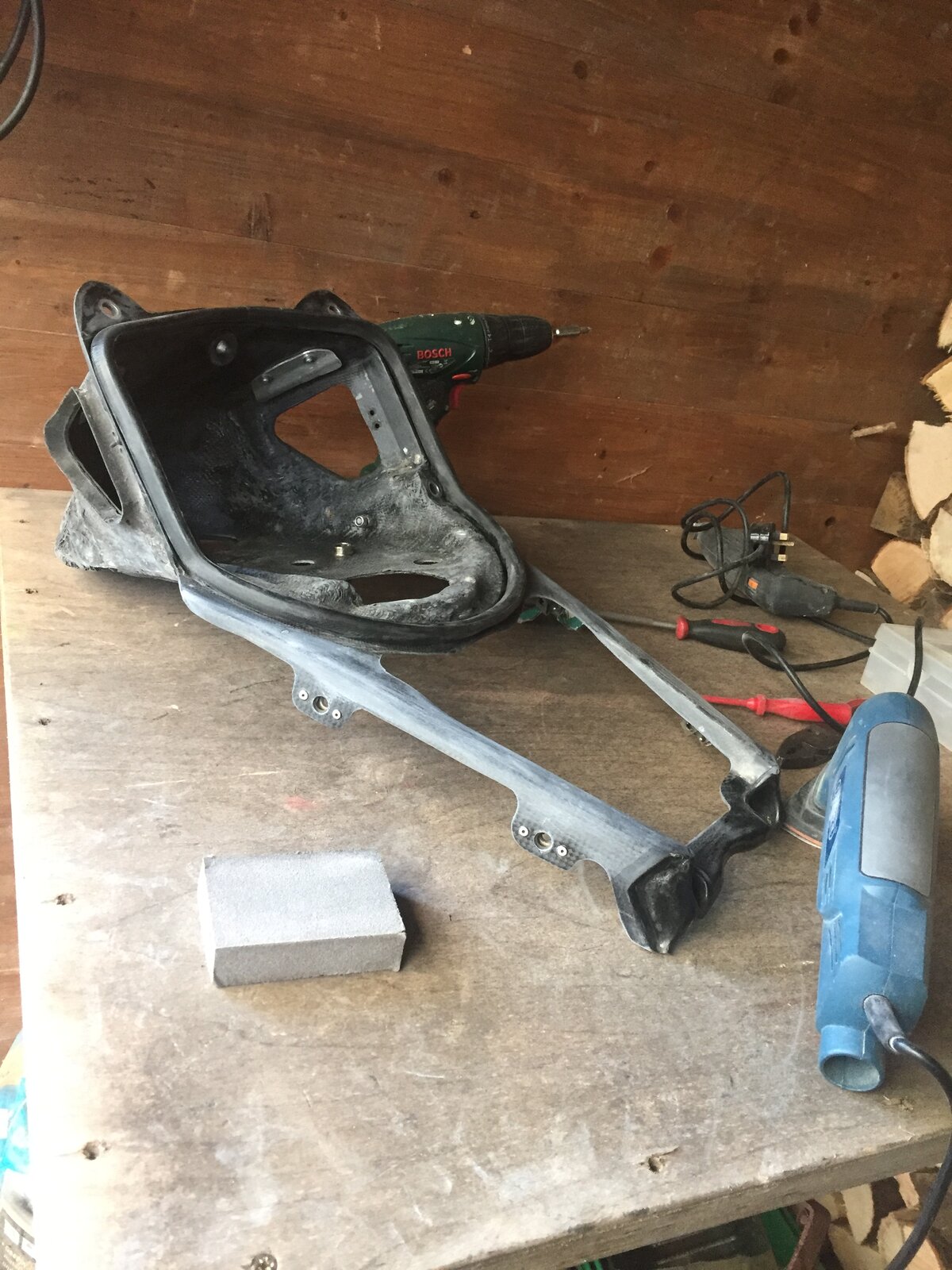

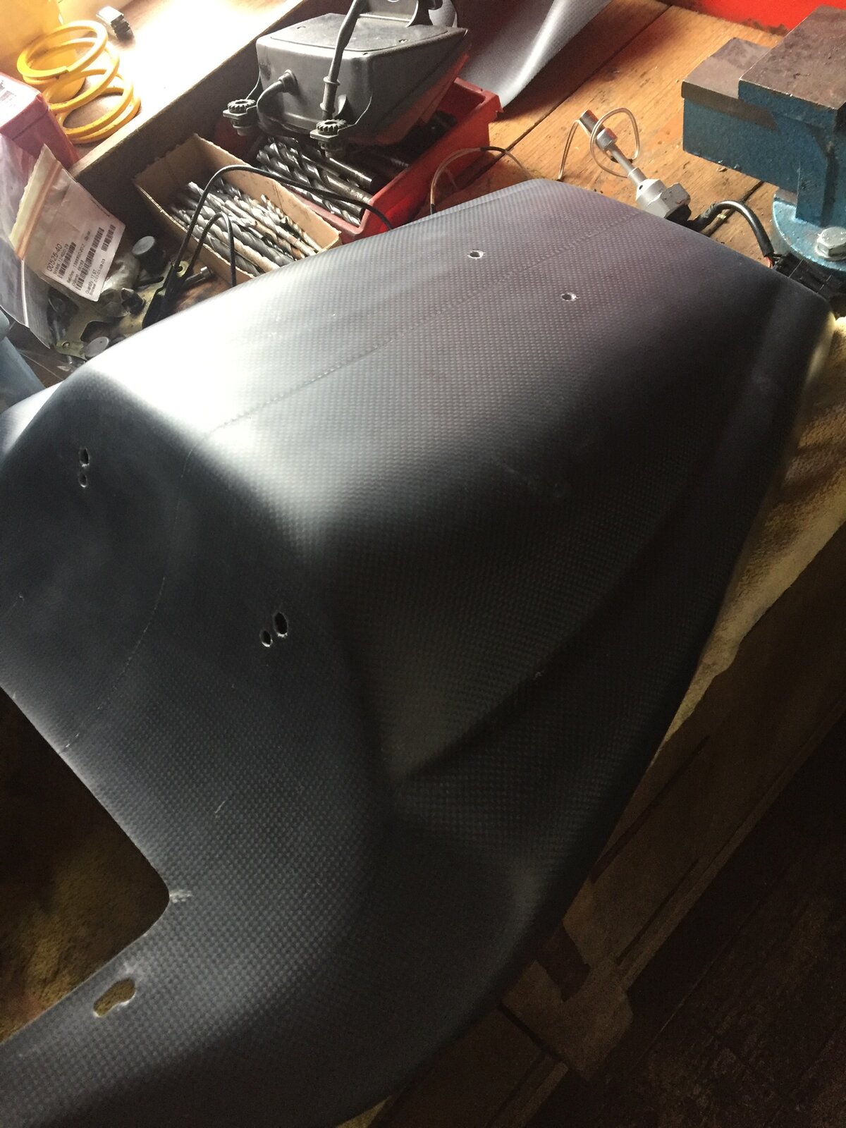

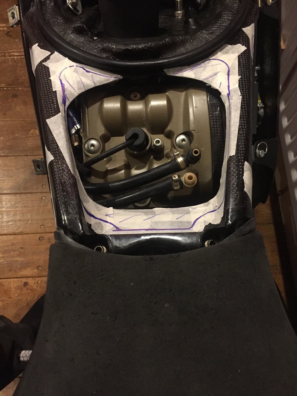

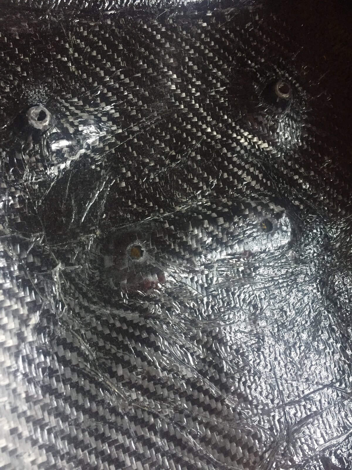

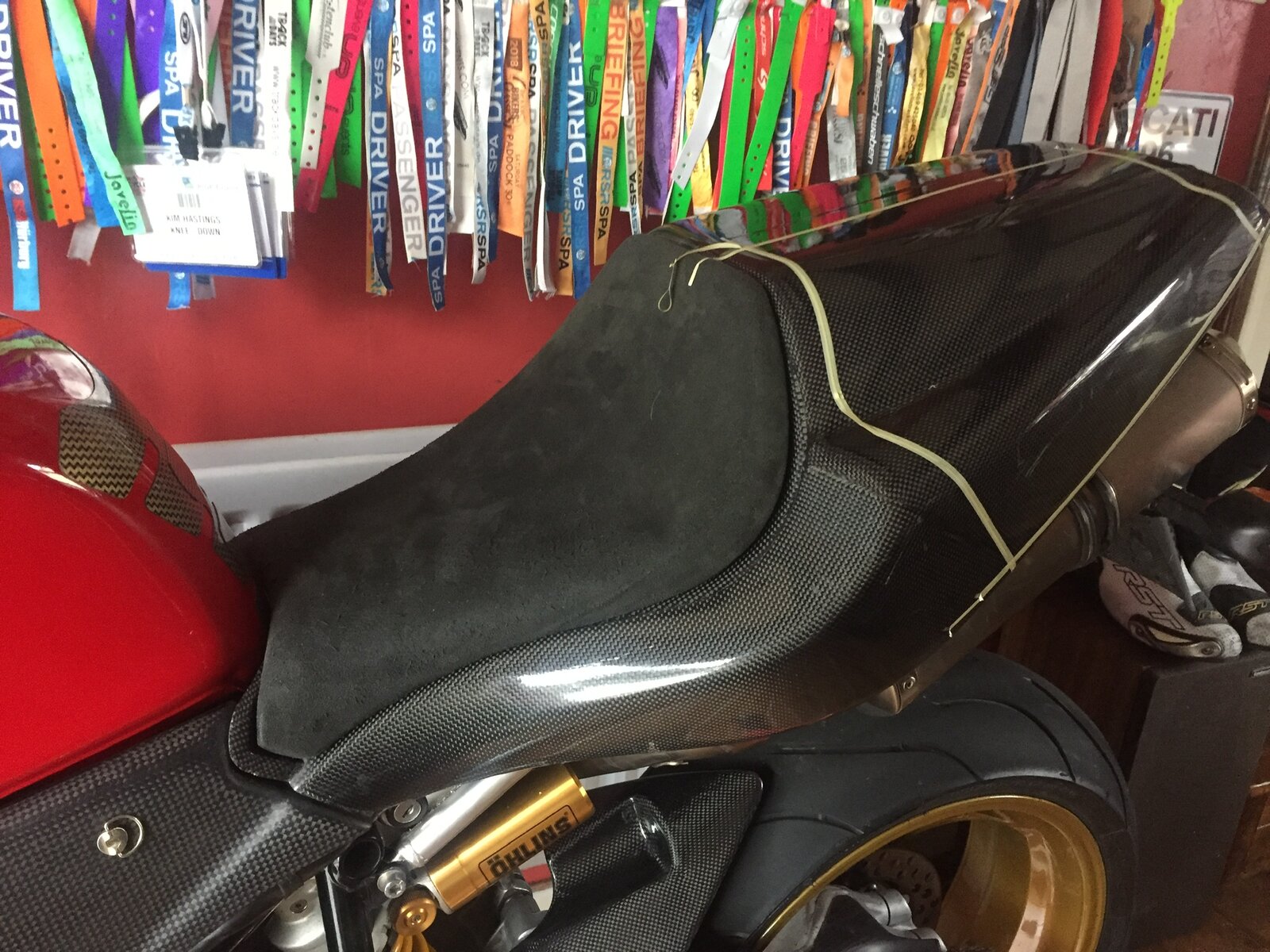

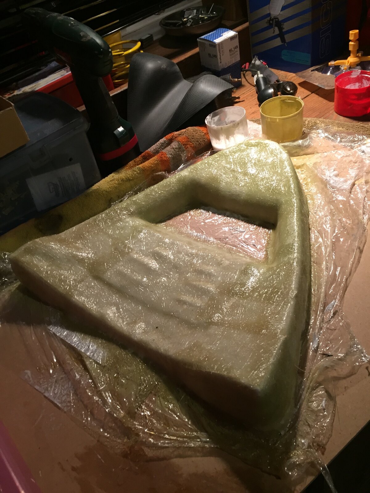

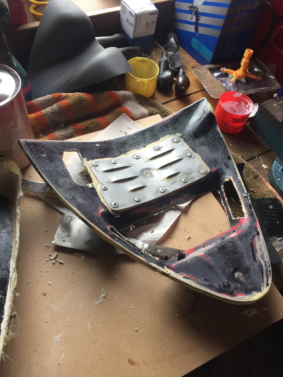

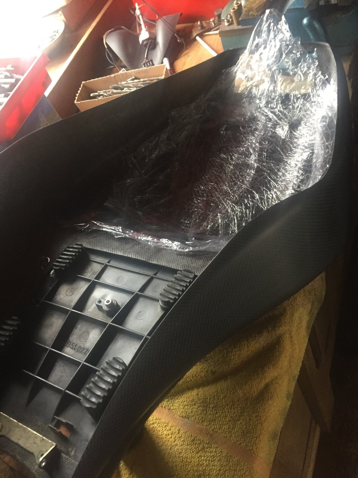

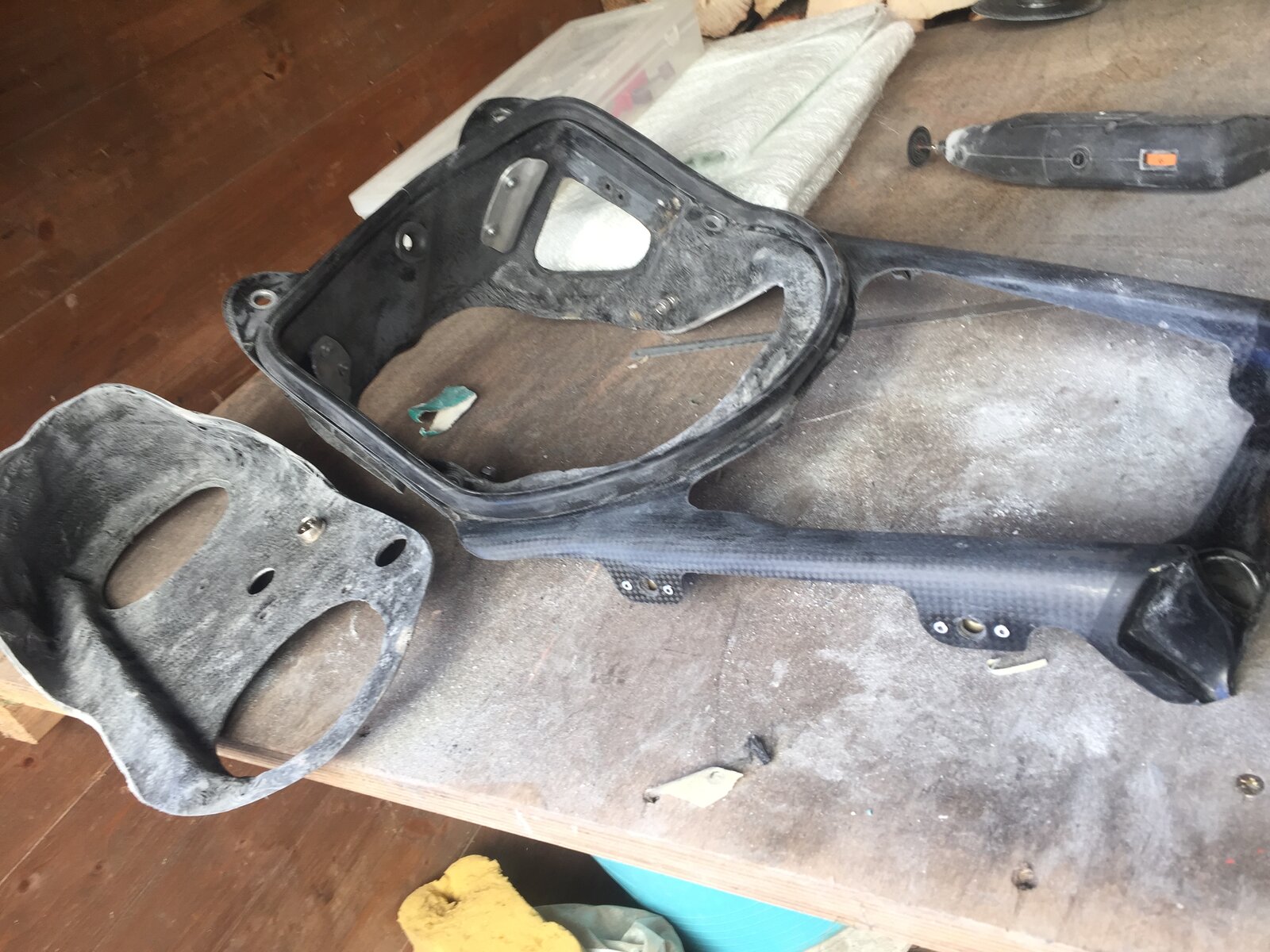

  19. The seat unit I picked up very cheap as it was damaged. So repaired and strengthened for my use.

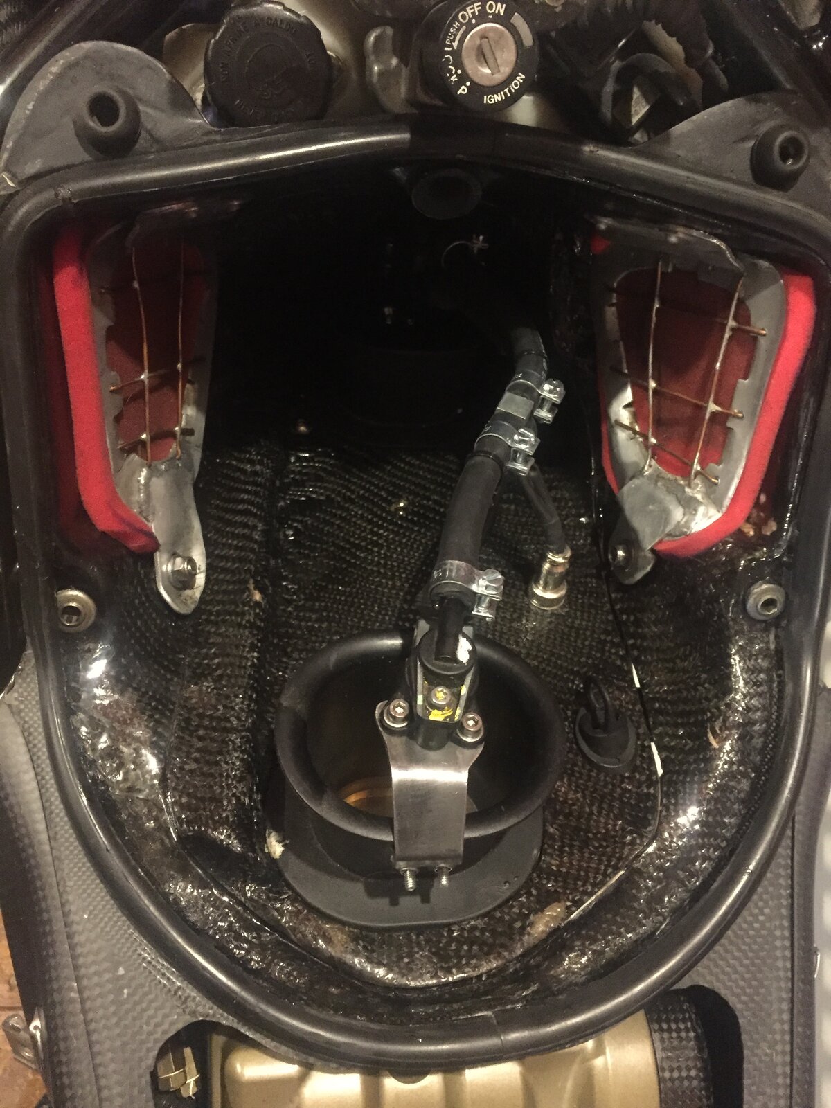

    068DF595-138A-4CF4-B1A5-7B972C94374D.jpeg A0C93C2B-C0E2-4E7A-90F3-A5DDD9D26851.jpeg AE552C42-D185-4911-BA0F-5664557C5F38.jpeg 81DD3A9E-43A2-418B-8E51-02421193C5AC.jpeg 9843234E-CEC6-4EAF-BC22-4E4F485122E4.jpeg D2BFDA46-9766-41E9-BC0D-387D9FEC499C.jpeg 1B0FB142-AEA7-4E8E-9F1B-1E91B420349C.jpeg 6A65F9A4-5D2F-43C0-9992-E9A38D5245F6.jpeg 500D9D07-DA38-44ED-B2F3-B9084BBEDE97.jpeg A5D5DB07-BDD4-47BF-B1F4-DF6DB91624FA.jpeg

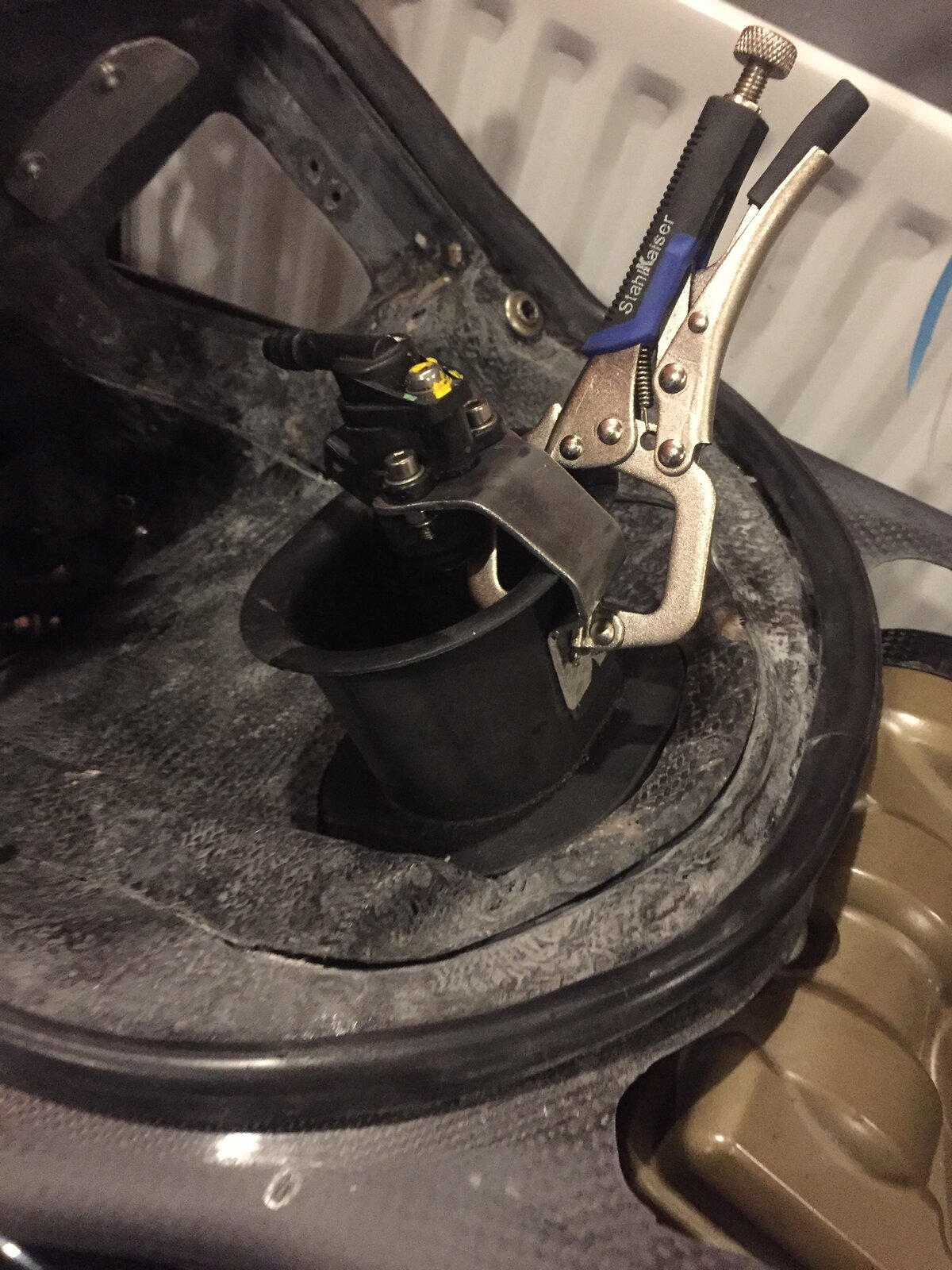

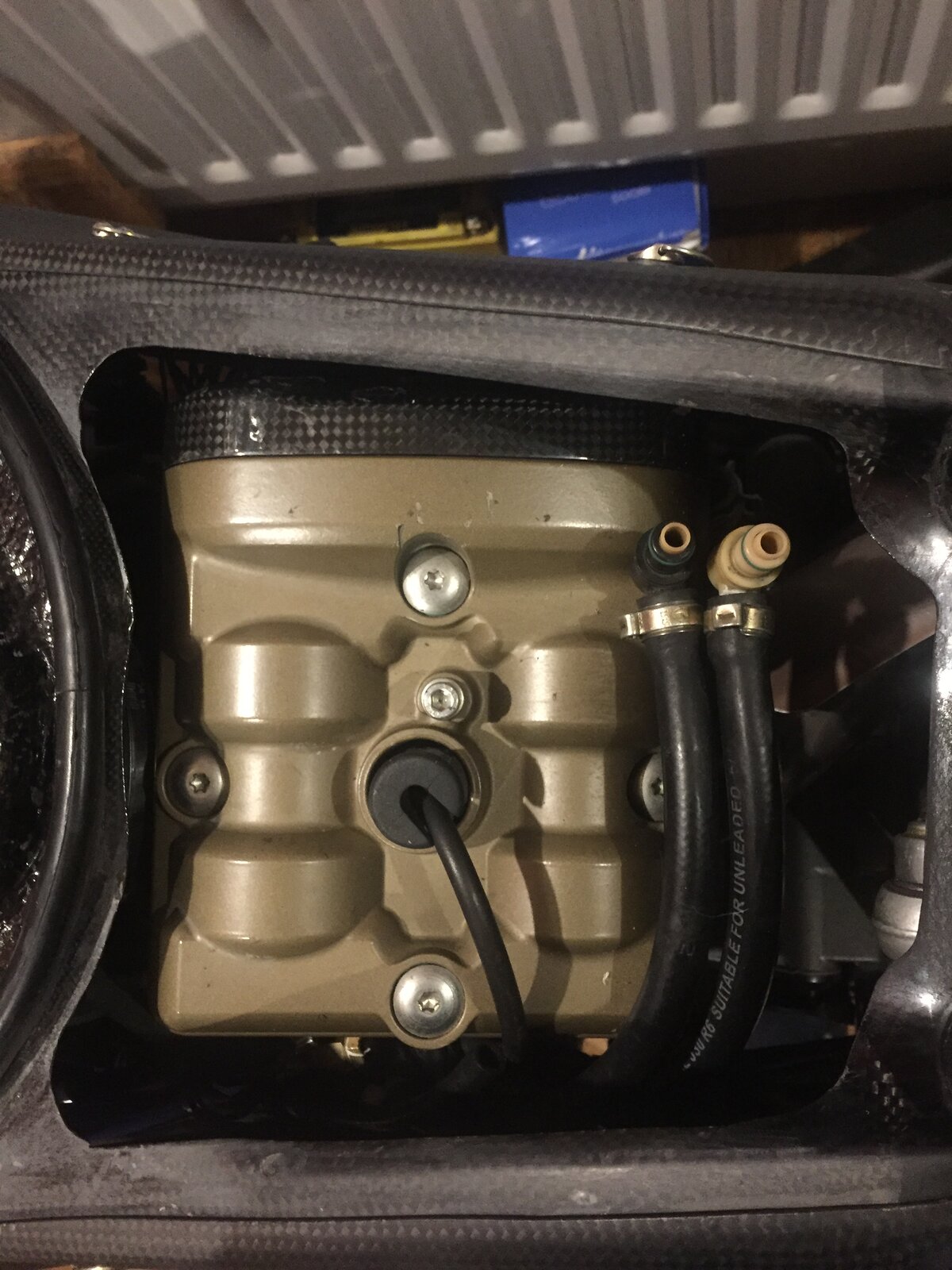

  20. How stiff are the injector mounts? I wondered if they might bend at full chat, or in fact if they vibrates with the engine running.
    Did you try on a dyno with the tank off to see what happens?
