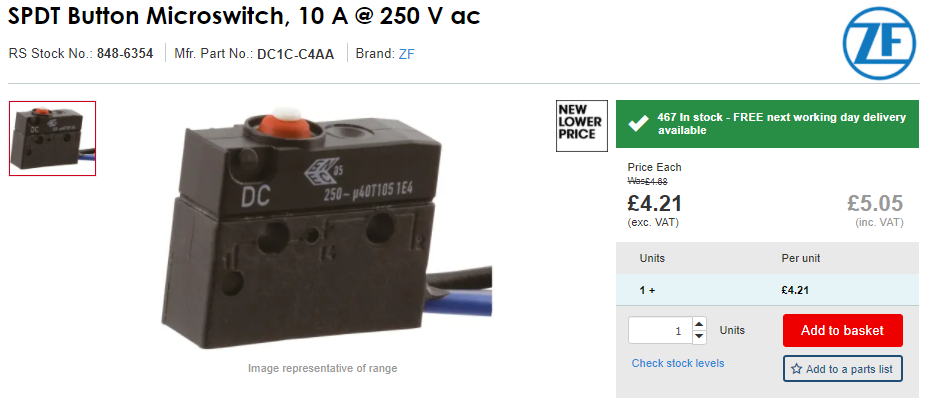

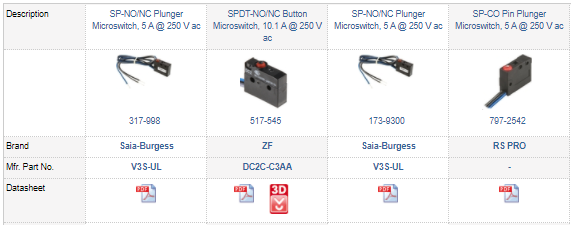

  10. RS Supplies are a good source and next day delivery for the plunger button switch on the front brake lever. I installed one similar to the one on the right below. The pricing is good and you can get the part number if you part remove from the lever switch. Mind the small nut on the other side of the long screw/bolt when removing.
  11. Many thanks.
  12. If you do use one, they come with a 3rd wire that you simply remove. Colour match to the existing. You can reuse the old sleeve also the bullets if removed with care.
