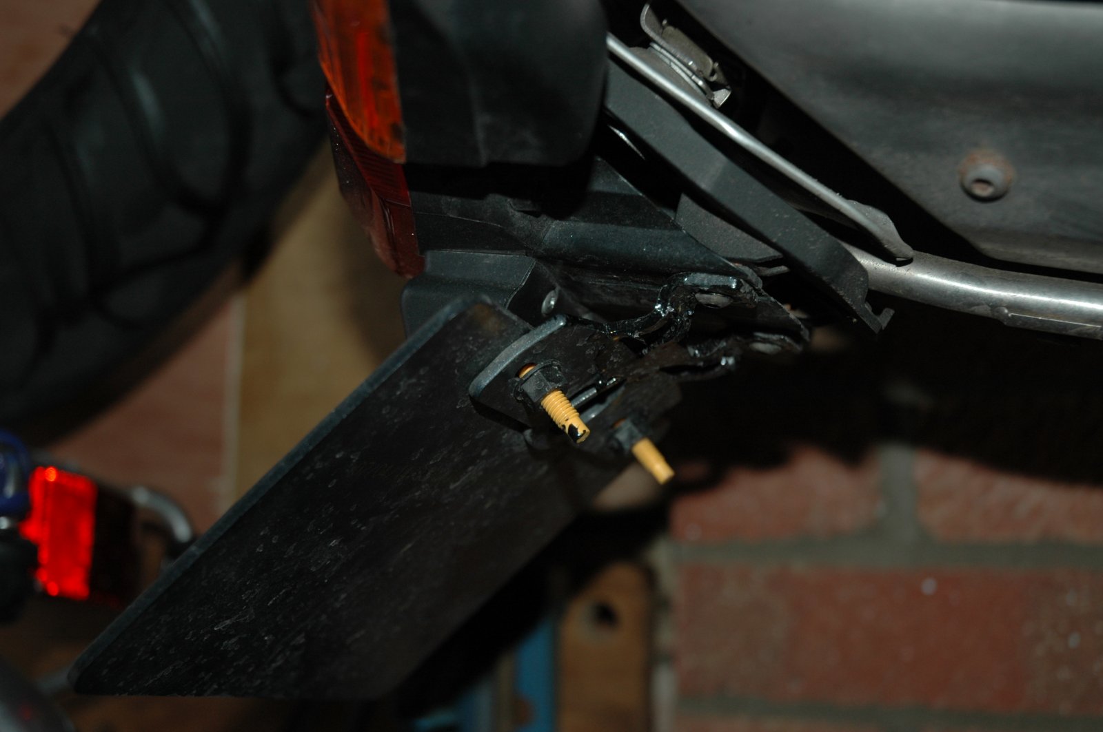

  10. I've cut down the Evotech one for the standard exhaust and bent it back....
  11. Here's a PIC..
  12. Yours looks a little further towards the rear of the bike than mine....looking at the gap between the two i'm still astonished that the bottom of the plate snagged on the tyre.
    There's probably room to move it back a few centimeters.

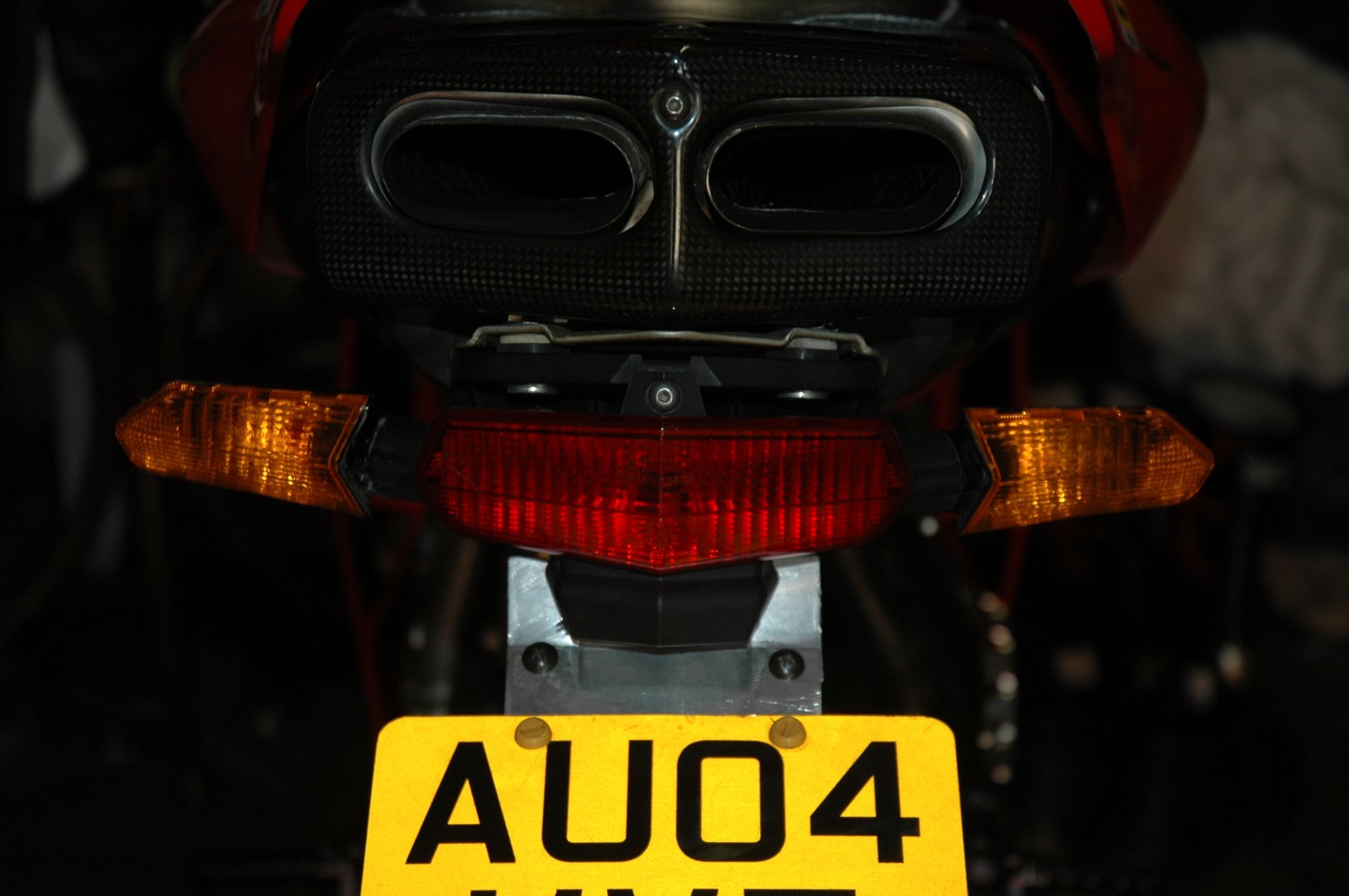

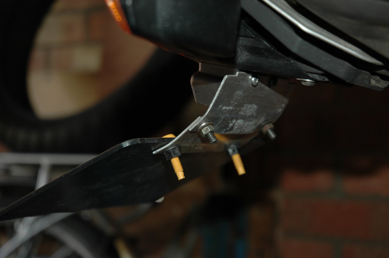

  19. Fabricated this as a quick fix this morning ,once I finish off the rough edges and get it anodised black at work it shouldn't look too bad.
    I know it looks a bit heath-robinson ,but I was getting to the point where desperate measures were required!...:D
