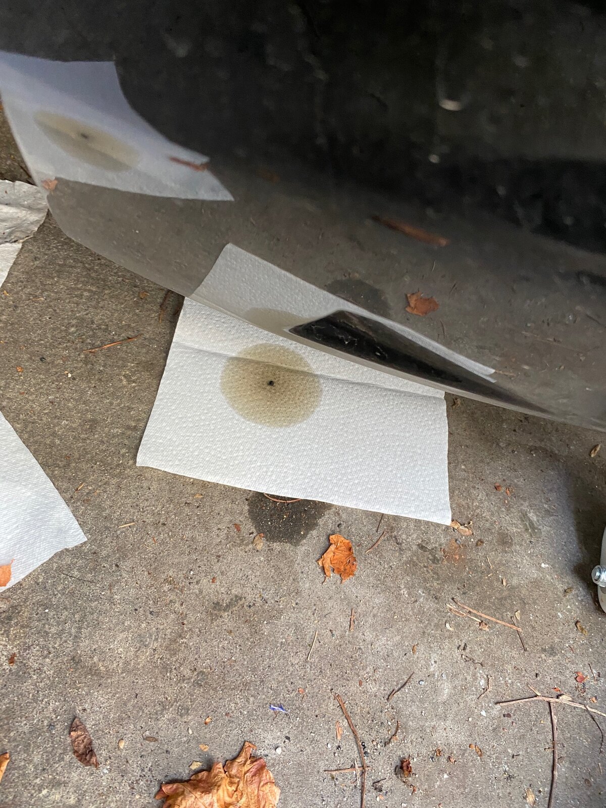

  14. Hi everyone,
    I just came across this Thread and I have the same issue. new bike 1260 s, Oil coming from the airbox after each ride.
    The dealer confirmed it s not an over fill, but has no clue what it could be.
    luckily the bike is still under warranty. tbh, I find it unacceptable that a brand new bike leaks oil (4000 kms for mine)
    as you have more experience with this problem, could you please advise on what to do ?
    did you contact Ducati directly (the manufacturer)?
    attached a picture of the leak
    thanks help in advance

  15. So my saga finally got resolved with new barrels / pistons.
    Initially what started the whole the leak was as above coming from the breather pipe but after inspection turned out nothing to do with airbox breather /overfil of oil but in fact the head rocker cover having a leak. This was on front piston so oil was actually running down the outside of the breather pipe. Just happens how its all positioned. With this resolved thought it was the end of it however then we noticed that oil was still being lost. Closer inspection there were signs of oil leaking out the exhaust port connection and a lot of soot on the exhaust ports. Main give away was the oil level dropping quickly within 500 miles and the oil streaks on exhaust join. This resulted in new barrels. From what I was told while same part number the casting marks were totally different. Since then no more leaks as long as keep the oil away from max level
  16. thanks for the reply. For now im not looking that much oil, but few drops here and there after each ride.
