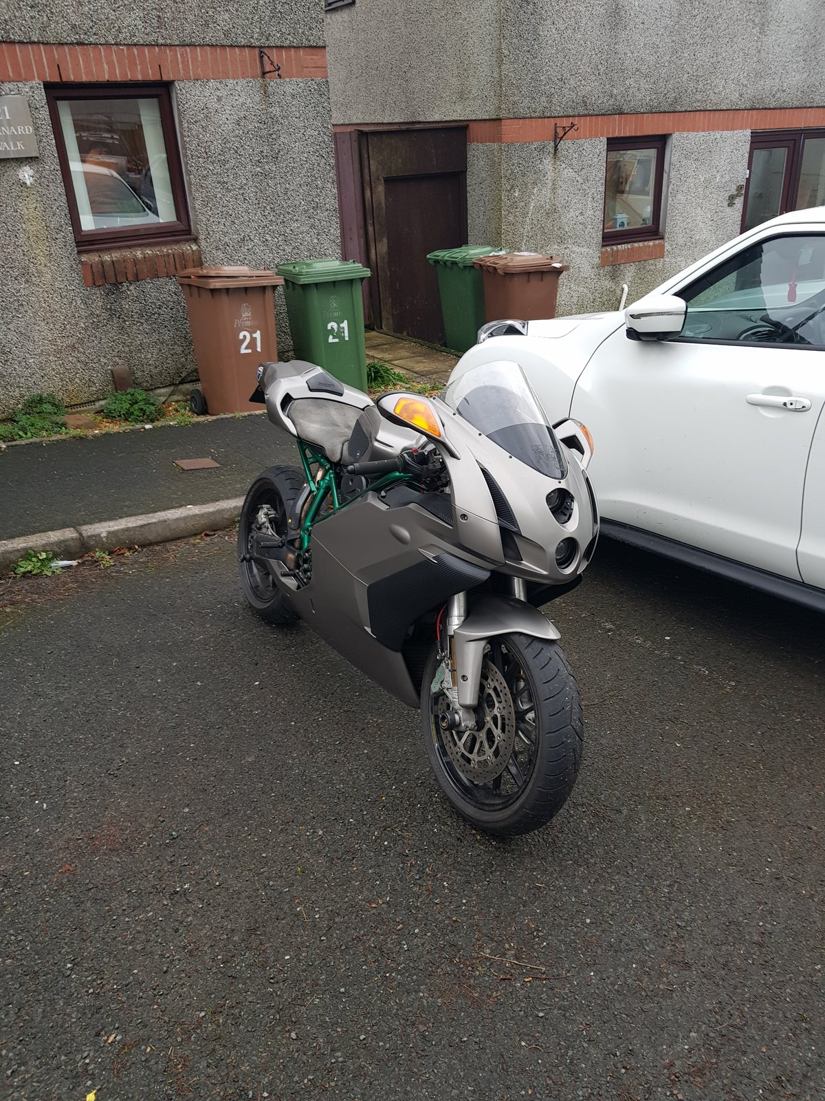

  1. Hiya and welcome....personally im not sure on the colour( but then i have a yellow one so who am i to judge lol) but salute you on your choice of bike! They are a hoot!
    Stick a few more pics up in better light ( with bins ;))

    It's still in GP shift so that shit me up when I tried to change up into 3rd.
    Couple of nigles, the horn doesn't work and the front brake isn't connected to the lights.
    I'm also a little worried about the wiring, anyone got an suggestions on how to clear all this up?

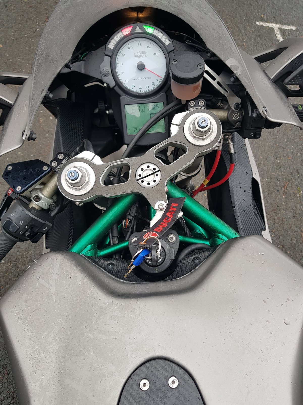

  3. Need a bit more info to really help, what else about the wiring do you mean?
    Is the front brake banjo switch connected? It's hidden in the pic?
    The horn is behind the side fairing on the clutch side, in front of the horizontal belt cover, could check if it's there and connected first?
    I used a race shift, is a head fook at first but once you've used it a while you'll be ok, alternatively, probably get a standard one off eBay pretty easy.
    Looks like a button might be missing off your clocks too.

  4. Also throttle cables seem to be in a weird route? Should be under the clocks , easy fix though:upyeah:

  6. When I got my 999, the front brake lever didn’t operate the brake light.
    @Derek suggested giving the connector in front of the tank on the right side a wiggle - hey presto :)
  7. When you remove the fairing lower to get at the horn, you’ll find there’s a metal peg at the front that needs a good tug to release from its rubber grommet.
    Be sure to smear the grommet with Vaseline or grease to make sure it’s easier to refit and remove in future.

    Where is the button missing from? I struggled the first time but I think i'll swap it back to standard shift to negate any stupid shifting mistakes. I realise the picture doesn't illustrate it well, it looks as though the loom has been opened up. I want to do it properly.

  14. Here's a photo from the front end, including wheelie bins, for those with a penchant for wheelie waste.
  15. Looks like it has a non standard Brembo radial brake master cylinder. I don’t believe these have the facility for a brake light switch, unless it is the adjustable ratio RCS type.
  16. Brilliant, that would explain the lack of brake light. So it's going to be a swap the master cylinder job?
    The guy I bought it from told me it had an updated front brake, seems like one thing after the other with this thing!
  17. There must be a way to do it. Whatever bike it came from must have had some sort of brake light mechanism.
    Pressure switch on the banjo??

  19. Perhaps, my thinking is it was bought seperately. Im more aware of how much time on track the bike has done and maybe this is a result of that.
    I really need a good sit down with the bike. I'd like to keep hold of that master, it's got a good feel to it. Otherwise I'm sure I could use a master from a 1098r maybe?
