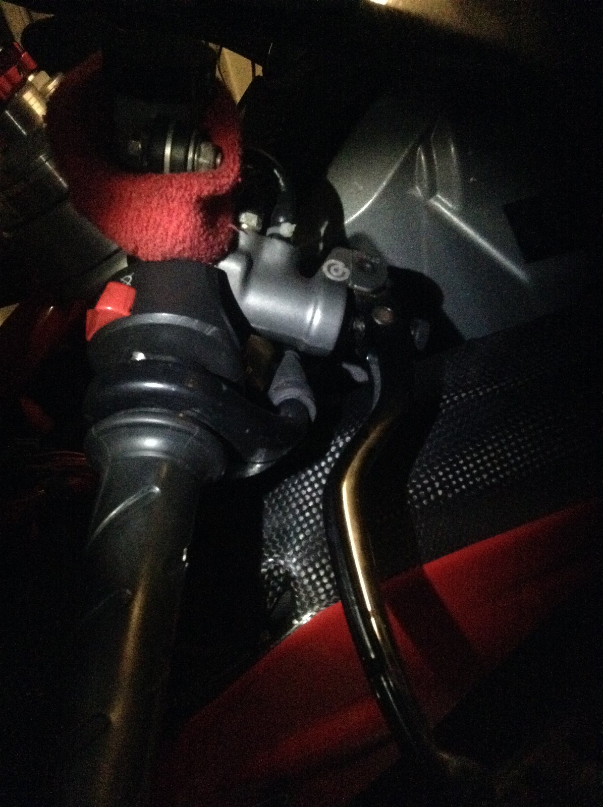

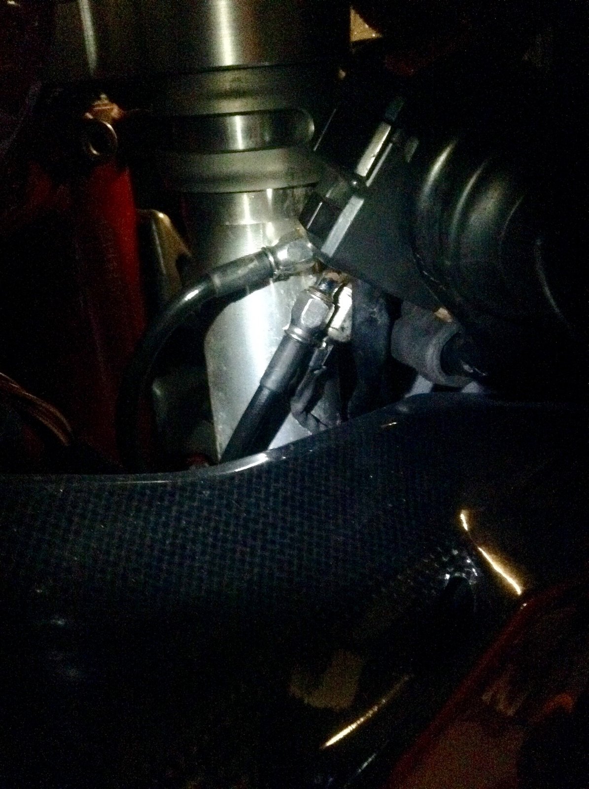

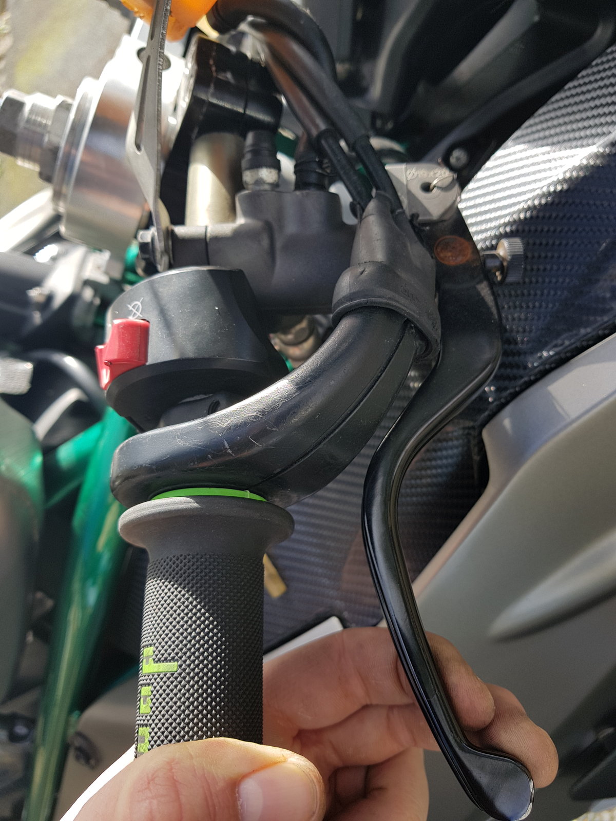

  2. Shouldn't be riding it on salty roads anyway.
